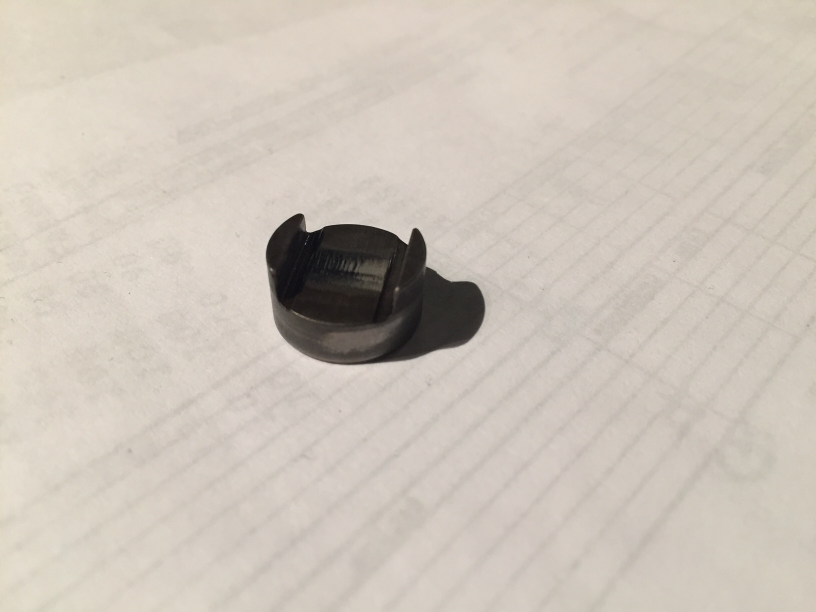

I removed the old rockers and lash pads and checked for wear and replaced with new parts. The old lash pads were genuine but looked different than the ones I purchased from Nissan. The old ones appeared to be thicker/taller, but the underside was recessed deeper than the new ones so it balanced out in height. The diameter of the new ones were slightly smaller which made me a bit worried at first, but they work perfectly fine. The parts are still available from Nissan in the US, but I'm not sure how many are left.
I'll take some pictures of the old parts and post them up.

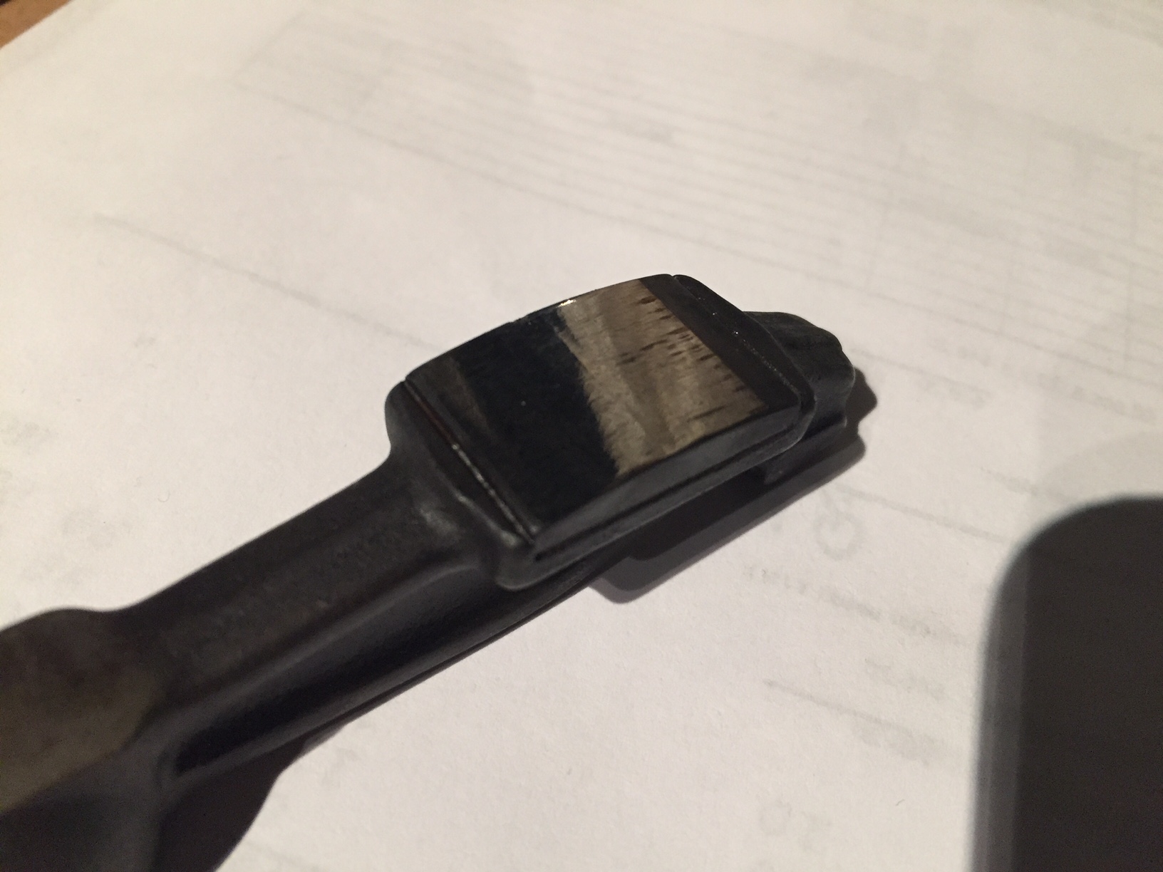

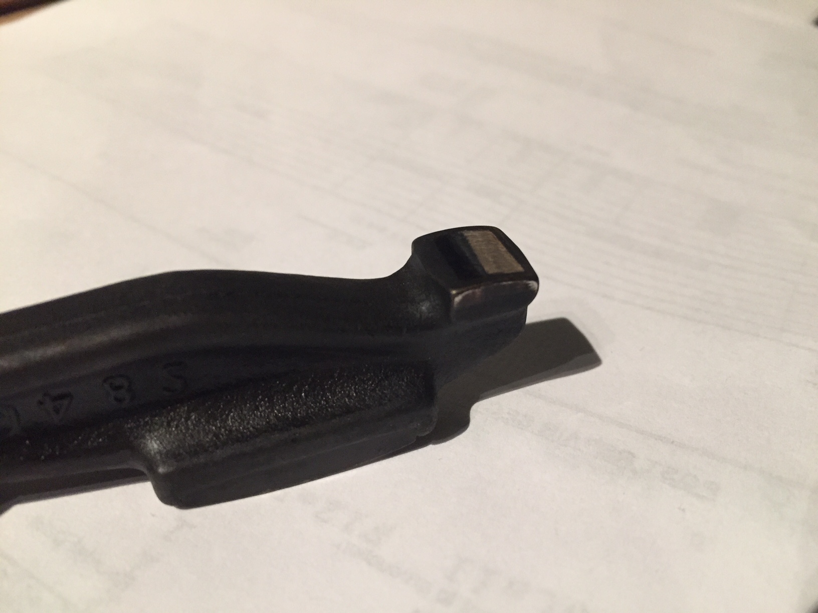

Wow.. that is horrible wear on the rocker arm wipe pad in the top photo. I've never seen a rocker pad wear offset like that on an L-series. Tip of rocker arm is worn offset as well. I think you would be well advised to check your Camshaft for wear. It looks like it has some taper wear.
Can you post up some more pictures of your old rocker arms and the wipe patterns?  It would be nice to see a selection of the old rockers instead of just 1. But the  top picture is a worry....
Have you physically checked the wipe pattern after installing the new rockers?  That old rocker picture has an asymmetrical wear pattern that could be caused by a worn Camshaft.

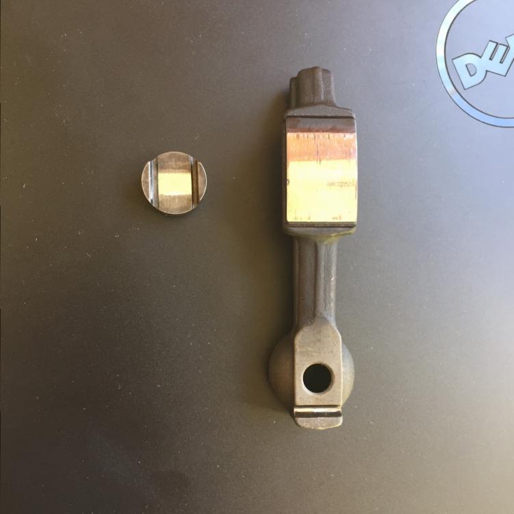

I think the reflection is making it seem that way. See picture below.
You can see the wipe was more towards on the adjustment side. If I remember correctly, the exhaust rockers where more centered.
I did check my wipe when installing the new ones by highlighting the rocker wipe surface with a red sharpie and hand rotating the cam.
I'll try to take a pictures of all 12 and post them up.
