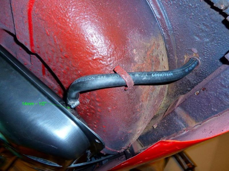

Looking at the recent thread showing tank vent hose replacement, this reminds me of what I found last year.
The photo here shows the vent hose location above the muffler. That grommet had popped out where
it enters the cabin. I reinstalled and then sealed it up real good. That was it. A real pleasure to drive with
the windows down again. Just another thing to check.
