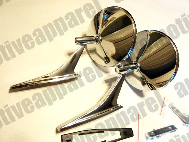

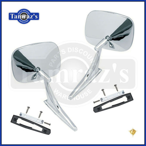

When I had my lime green '72 240z I bought a pair of chrome rectangular Chevelle/Camaro door mirrors.  Think I paid $50 shipped for the pair.  A NOS unit was not in the budget for that car but I never put them on.  In fact, I still have them in the garage.  A member on here or another Z car site had them on his Z and they looked good.  Another option would be GM round chrome mirrors.  Again, they run about $50 - $60/pair on Ebay and other sites.  For the look, cost, and functionality I think they are hard to beat.
Great option and look on both the above Hardway. I like the top pair because they look very similar to the original drivers side mirror, but I love the bottom pair for the clean retro look!

If anybody wants these mirrors 25 bucks shipped.  Like new   http://www.ebay.com/itm/like/131793979209?item=131793979209&lgeo=1&vectorid=229466&rmvSB=true
$_57.JPG?set_id=880000500F
I have these mirrors installed on my 76 Z.  They look great, I also have a set of the "original" metal sport type mirrors.  They are very similar.
These were easy to mount to the existing location.  I do not believe I drilled any holes or anything.
HINT:  Mine started getting loose/wobby after a few years.  The mirror to the mount (where you can adjust the mirror), NOT to the car itself.  I was going to superglue the "pivot ball" in place, but decided to remove the mirror first.  On the bottom of the mount, there is a screw that tightens the pivot ball.  I tightened those up on both sides, and it's all solid now.
I also like having 2 mirrors, evens out the look, and visibility.  Only 1 just looks like it's missing the other one.  Mine also had holes already on the passenger side, so I didn't really have a choice!
