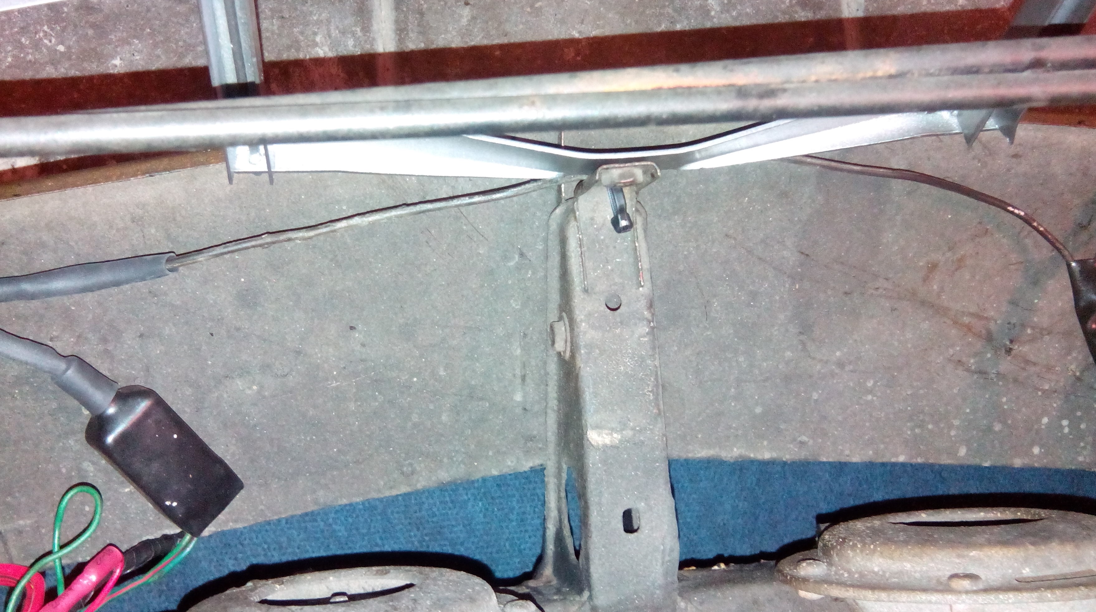

would it be possible for someone to take photos of the grille tabs on the front end of the body. I can't seem to get the grille installed properly.
Thanks!
Hi
They are not very clear in these phot's, but they are all I have. Hope it helps.

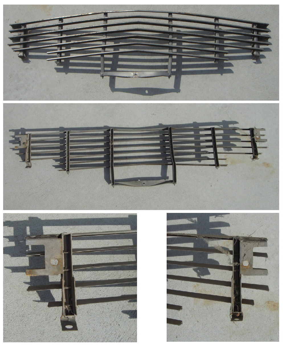

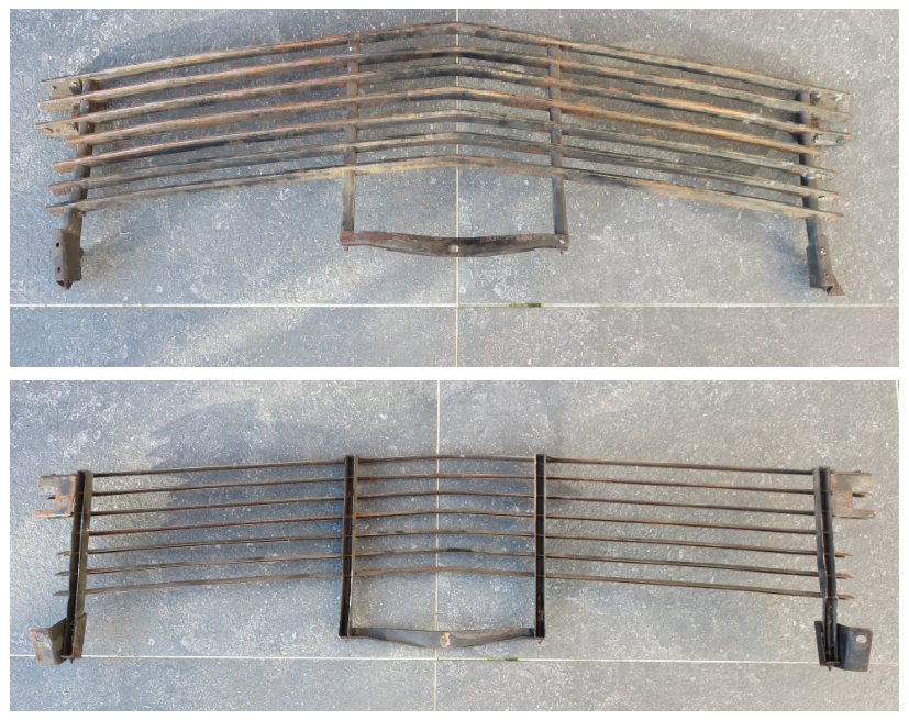

You basically have two types for the 240Z.
Type 1: The series I & II and the Euro model. See first set of photo's
The Euro model has 3 long, 1 very short and 3 short horizontal bars. You can see it in the photo I posted and in the photo here below.
Type 2: The 240Z Series III (73 model) is a lot different because of the differant bumpers mounts used on that US model.  You can tell them apart easily by the two short bottom bars and two extra vertical bars. See second set of photo's
Do you have a photo of what you have?
See photo's. Note in the 240Z grille US series1 photo a 280Z grille in laying on top. Its basically the same as the Euro except the fourth bar is the same as the bottom 3.
Edited by EuroDat
Typo
To give an idea of the time line. The grille changed after 4/73. If you have a 5/73 chances are it will have the model with the two short lower bars. The change coincides with the bumper and the heavy bumper brackets.
That grille was also used in the US 260Z, but it may have had some small alterations again to get around the 260Z bumper shocks.

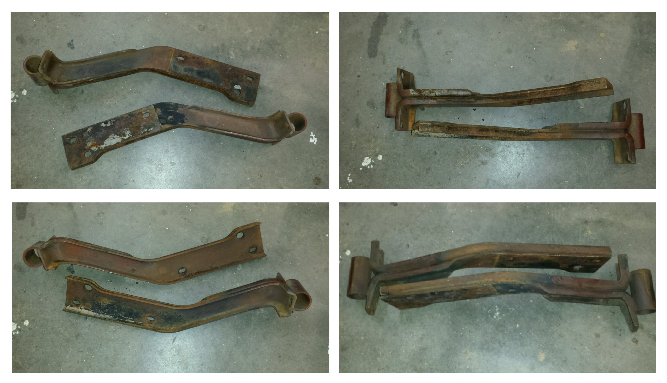

Here are photo's of the two styles of bumper bracket.

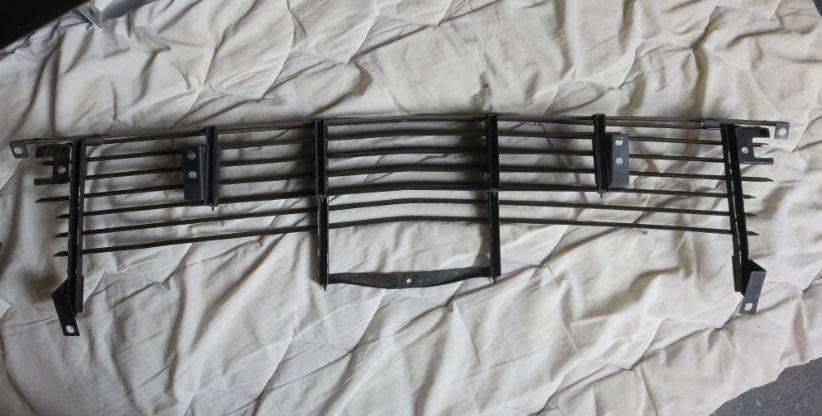

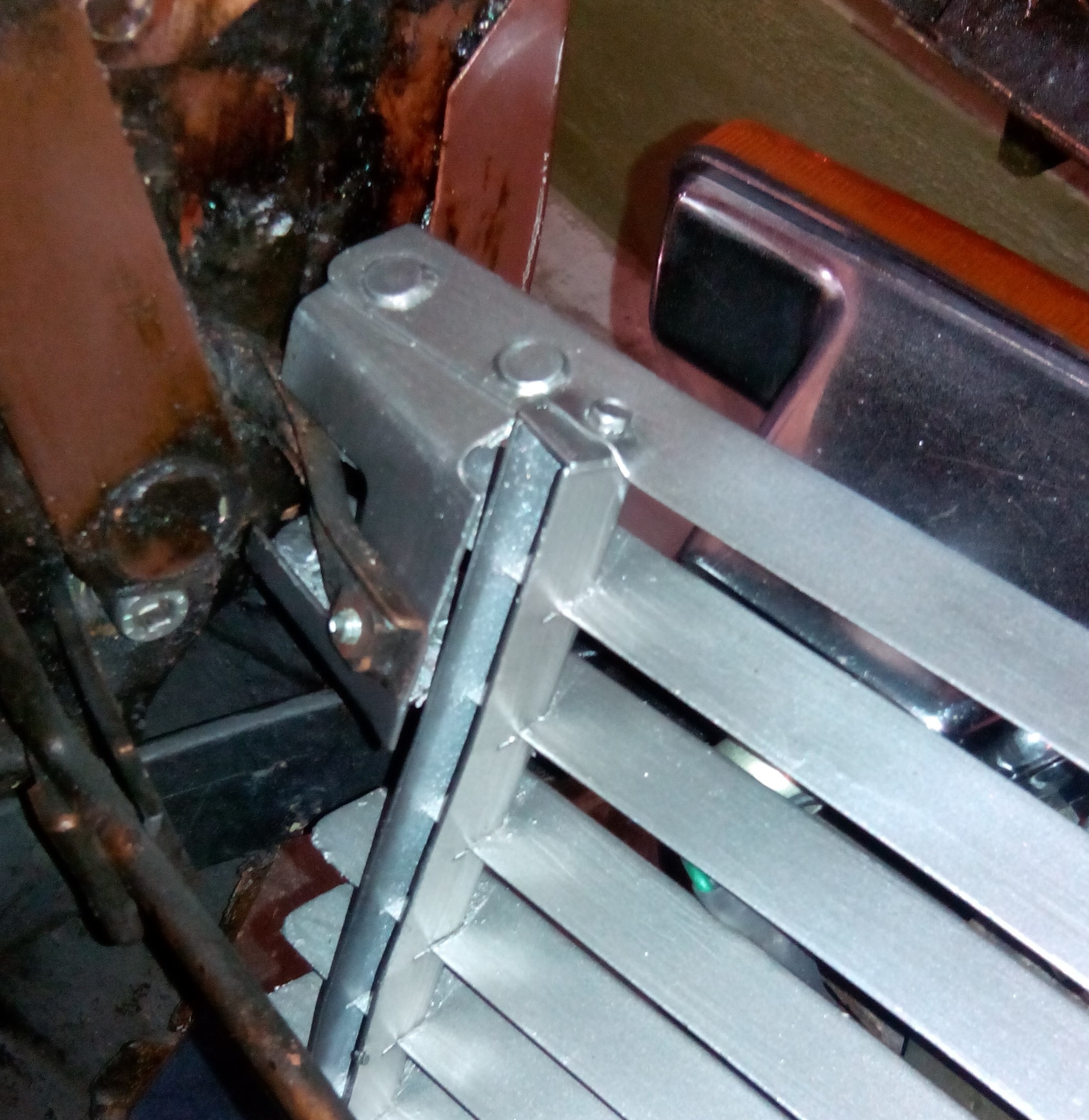

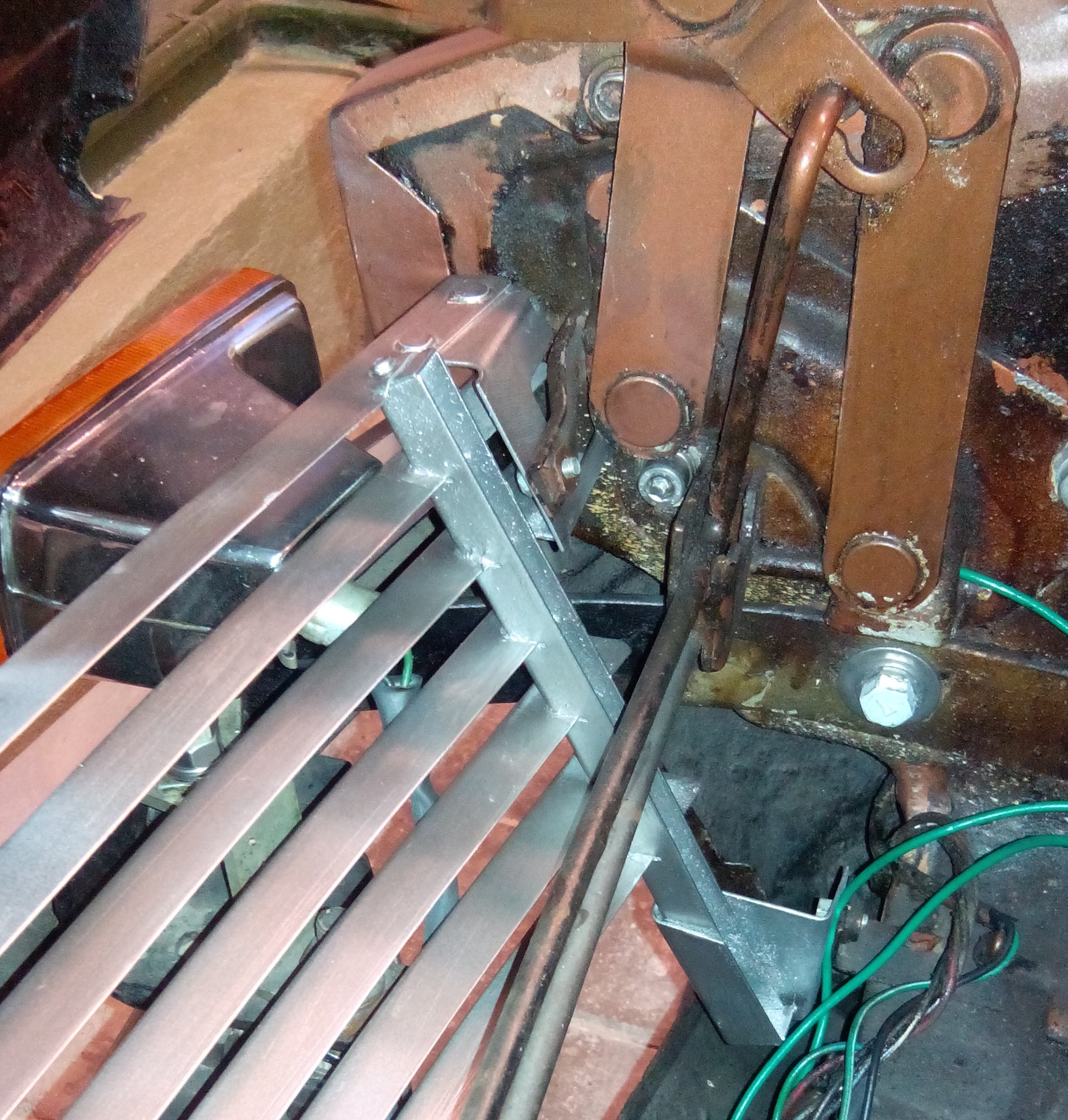

My bottom ones aren't even close, I think my grill is all mangled up. IMG_4590.thumb.JPG.06a4823b223f459624ca3IMG_4591.thumb.JPG.a0e822b8109f64b94c825IMG_4600.thumb.JPG.64ada59cad196732ad5d1IMG_4602.thumb.JPG.833b64aa77787f69e97ccIMG_4595.thumb.JPG.0035f944dec14a8277c57
Those 4 uprights that hold the horizontal grills in place are made out of the softest aluminum possible, they can be bent or twisted or broken with just two fingers, be careful.  Your grill looks pretty straight though except on the lower P/S.
That's a relief that at least its straight. The bottom two corners I can't do anything with, I tried pushing the top 2 tabs but nothing. I gave up before I ruined the grill.
It's kind of strange, the front of your car doesn't look like it has been banged up and straightened, it's weird.
In a pinch, you could make up a couple of strips of thin metal with two holes drilled in each, one for the screw hole on the mounting tab on the car, the other for the bottom grill hole, at least that would keep the grill from bouncing around.
