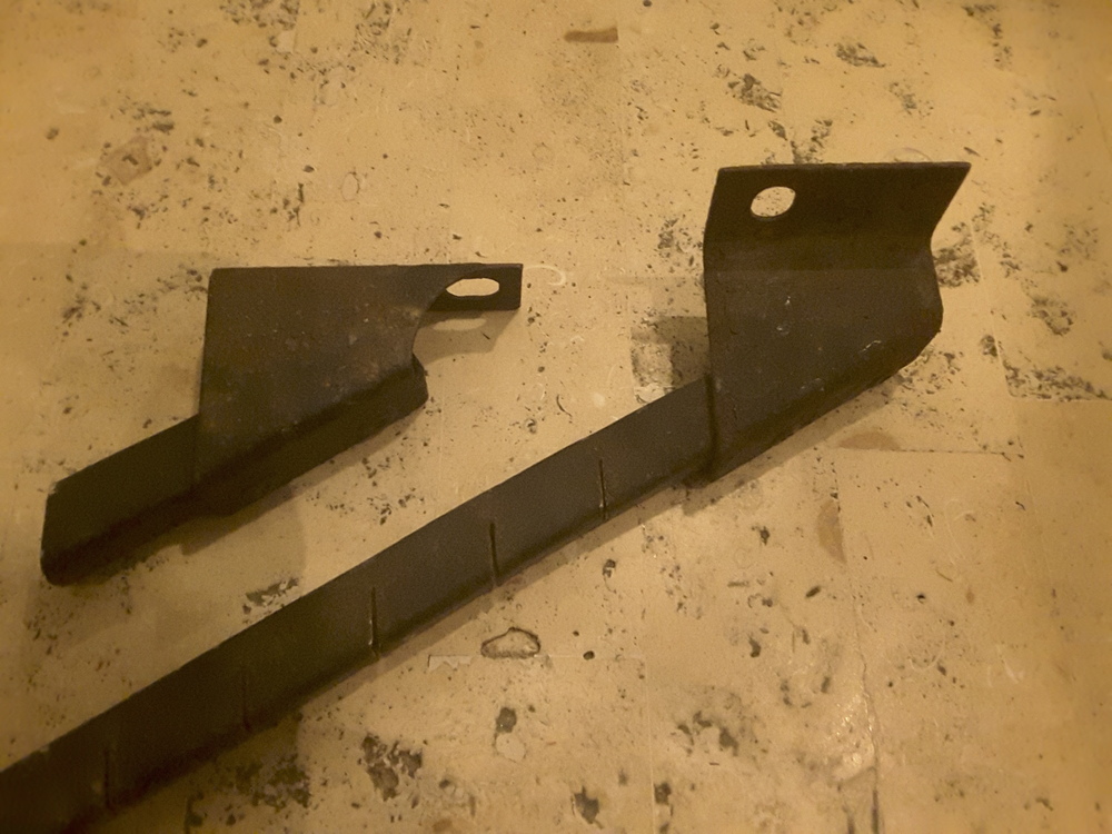

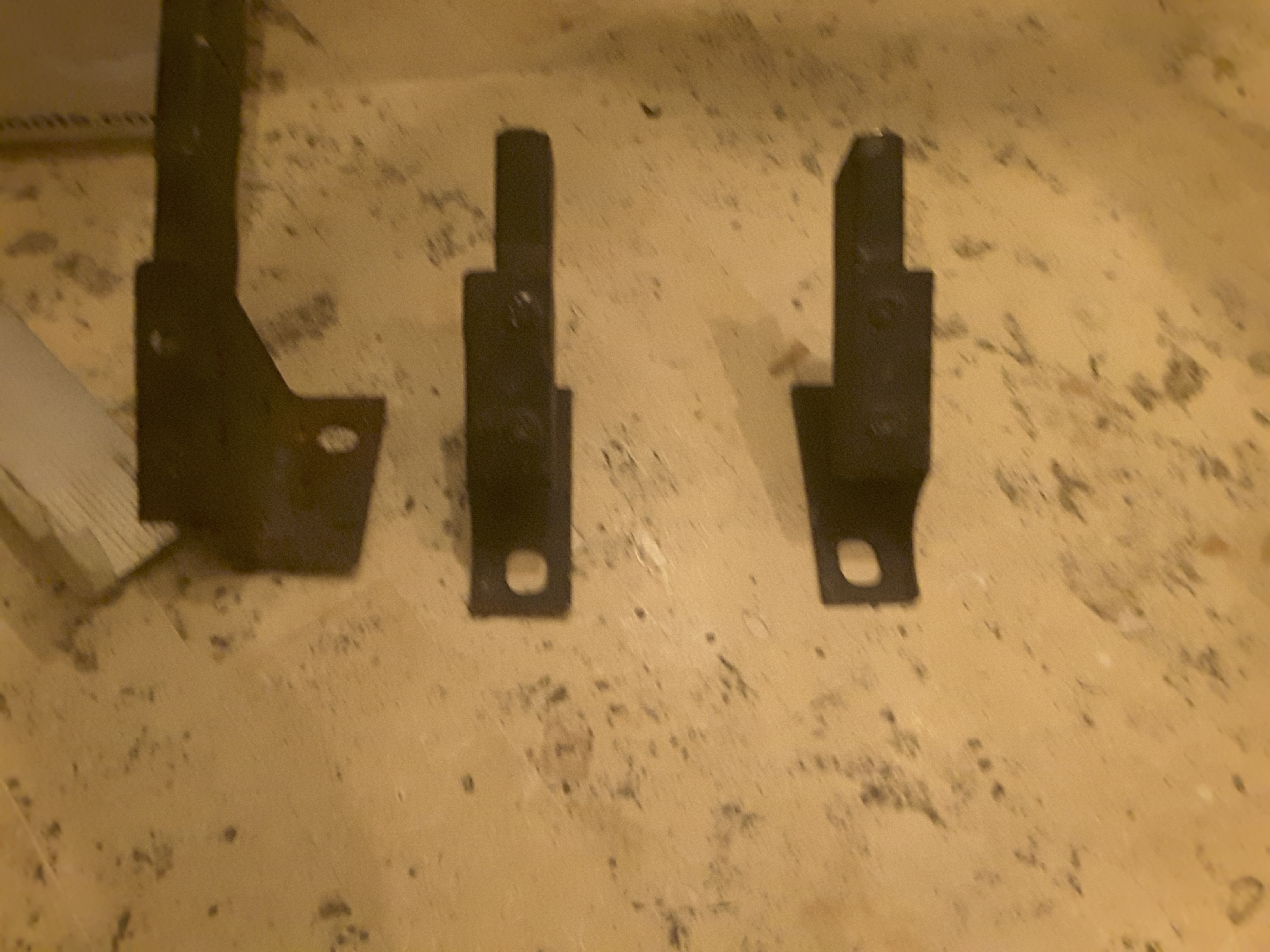

Here is a photo of the two you need and one of the type you have now. If you want them, they are yours. Pm me.
Thanks so much, Pm sent!
The parts are on the way. You should have them over a week.

You should be able to drill out the rivits and fit the correct bracket for your situation. The rivit holes should line up. I would try aluminium rivits because the vertical bars are aluminium and hard steel can distort the hole.
