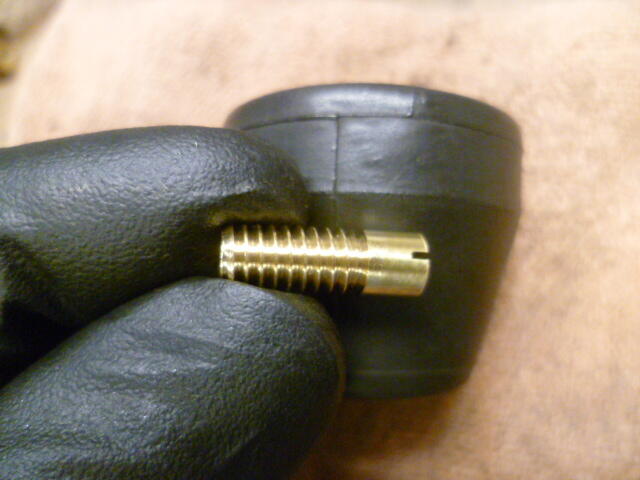

So my inserts were made on a lathe (because I have a lathe and I'm not afraid to use it), but you could probably find something store bought that would perform the same task.
My thoughts on that are... Brass has higher density than steel. And steel has higher density than aluminum. I used brass because it was the highest "bang for the buck" in the density department meaning that the insert could be made smaller to get the highest mass (as compared to steel and aluminum). If for some future reason, the ballasts I put in there are deemed too heavy, I can switch out to steel or aluminum in the future to lighten them up.

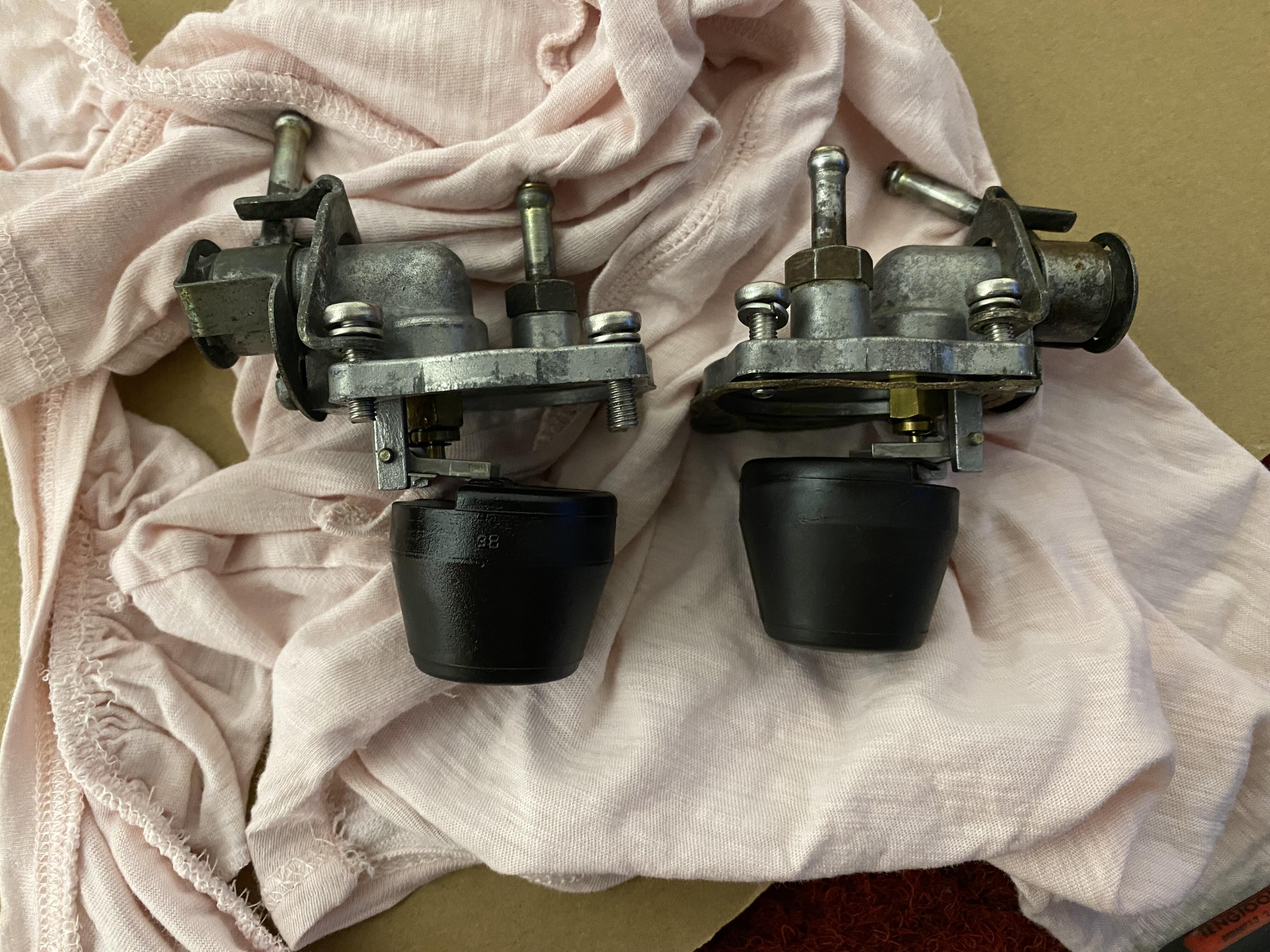

I read this topic with great interest. I have the same problem with my carbs as I can’t get the float level high enough. I’m aiming for 23mm below the lid but it stops at approx 30mm with the tang bend far down and the float high up at a «weird» angle. My car is a ‘72 (euro car) but it is kind of a crossover with lots of parts from the ‘71 shelf so it has the four screw carbs with two ears with equal length. If I have got this right this should be two short ears with two short valves (18,5)(?). The ears looks long but the pivot points are quite high up. This is definately confusing.
I have tried to come up with a solution for this but no luck so far. I’m thinking of adding weights to the floats as some of you have done. Does anyone has any experience with this over a longer period of time? Is this a good solution? And what’s the «ideal» weight?

When I went through the same thing, the only solution I could come up with was to add weight to the floats. This 4g brass plug threaded into the side of the float worked well:

I have a 1972 iwth a similar problem and the two different lenght ears. If you had to summarise the approach - and i wanted to just buy a threaded piece to use - what do i do/
Do i put a brass screw 4g weight (of whatever dimensions roughly you have there) into both floats?
How much do i sand off and is it at the bottom or top or sides?
And finally - have you put these in your car and has it solved the issue?

I have performed this procedure on a few carbs, but I think only one set has seen the road. Reports are that set worked well.
So I made a custom threaded piece of brass. Maybe you could find something generic instead of making something special.
I put it in a position where it did not interfere with the hinge molded into the float, and I did not want to put it upwards into the bottom of the float because of gravity.
Beyond that, I tried to put it into a "fail-safe" position on the float such that if it starts to work itself out of the float, it would hold the float closed instead of holding it open. Figuring that a float level too low would cause the engine to not run, while a float level stuck open could cause a fuel spill.
