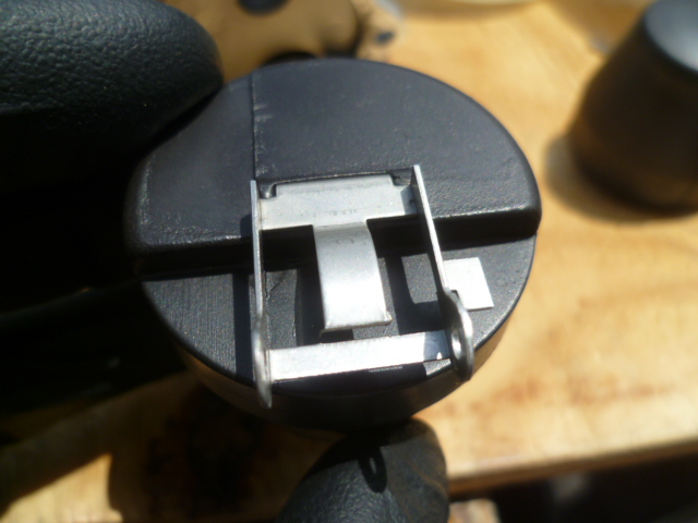

First attempt. Float tab looks like this:

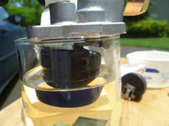

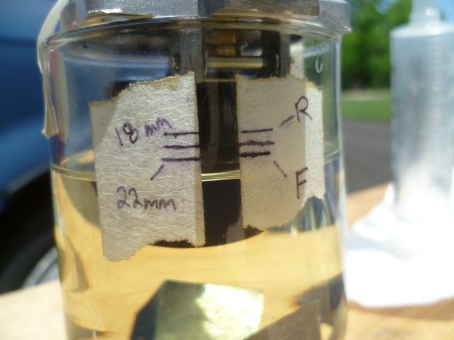

That float tab resulted in a fuel level and float tilt like this:

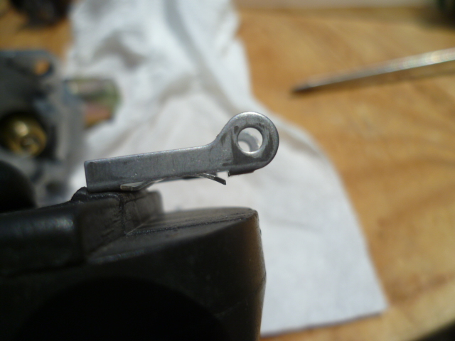

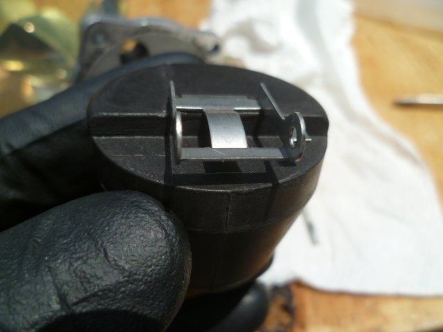

Bending the tab a couple times bought me to here:
Which resulted in a fuel level and float tilt like this:
I'm not quite hitting the lid yet, but I'm very close. And I'm still pretty far away from my target level. I don't think I've got the compliance left to bring it up to target without hitting the lid.
