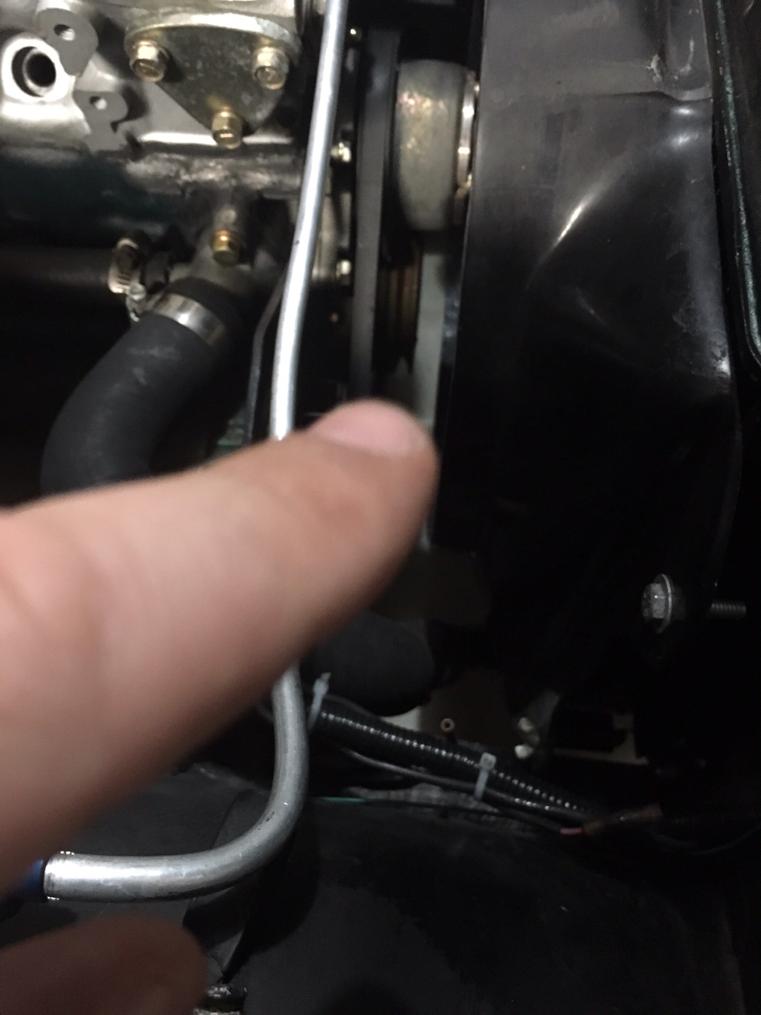

24 or 27mm or English equivalent . You need to turn it from under the car. If you lay down in front of the car and reach under there you can slip the socket on that big bolt . Just push the fan blades out of the way. Put your ratchet on there and turn.

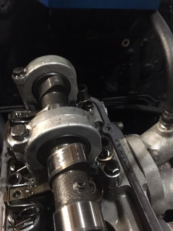

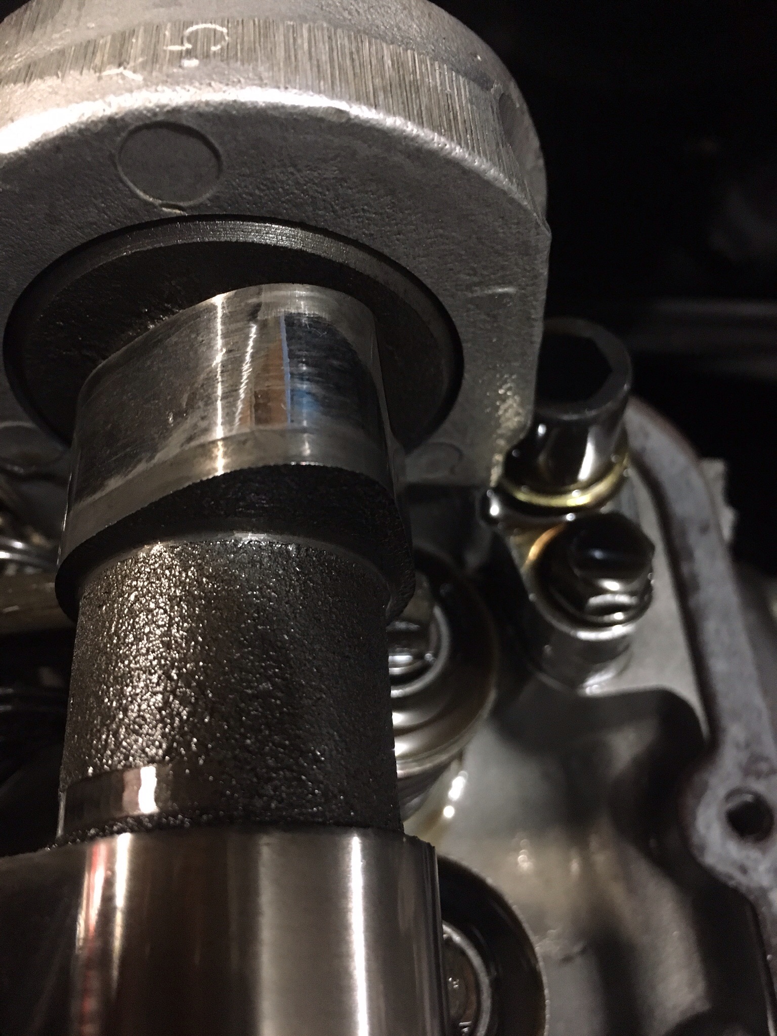

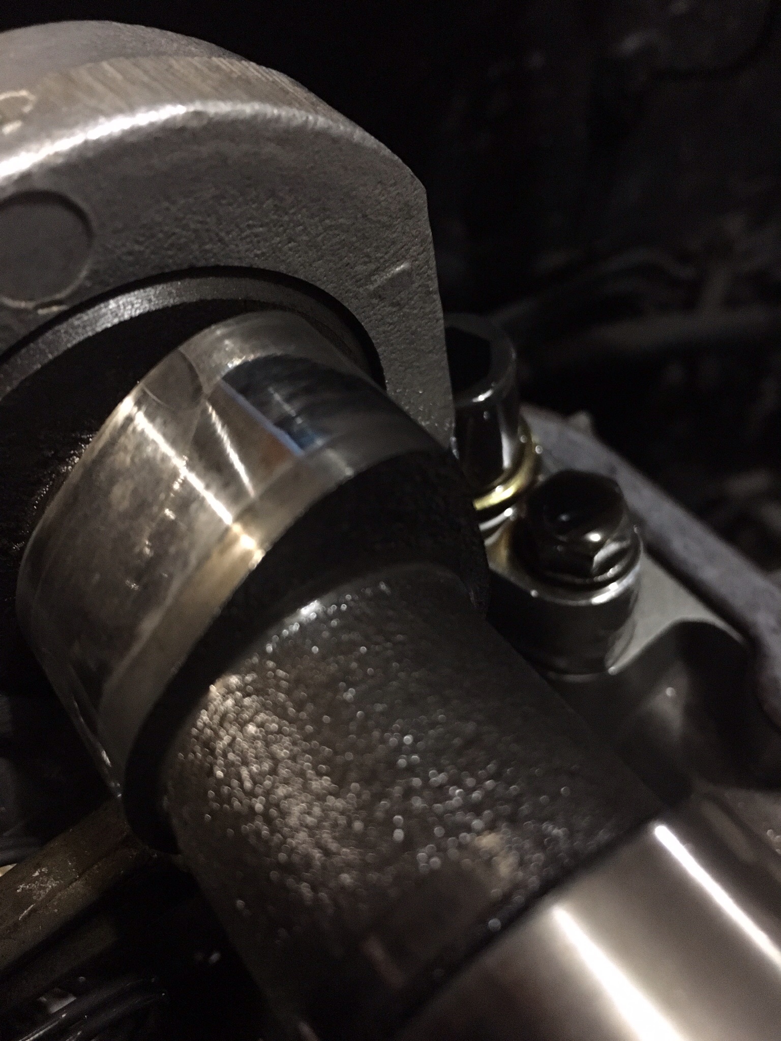

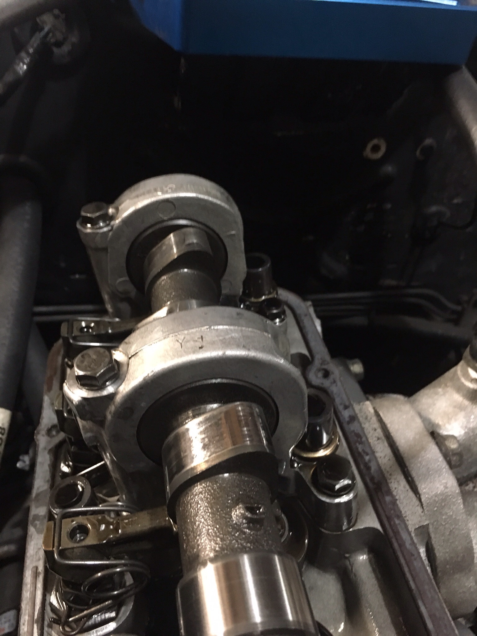

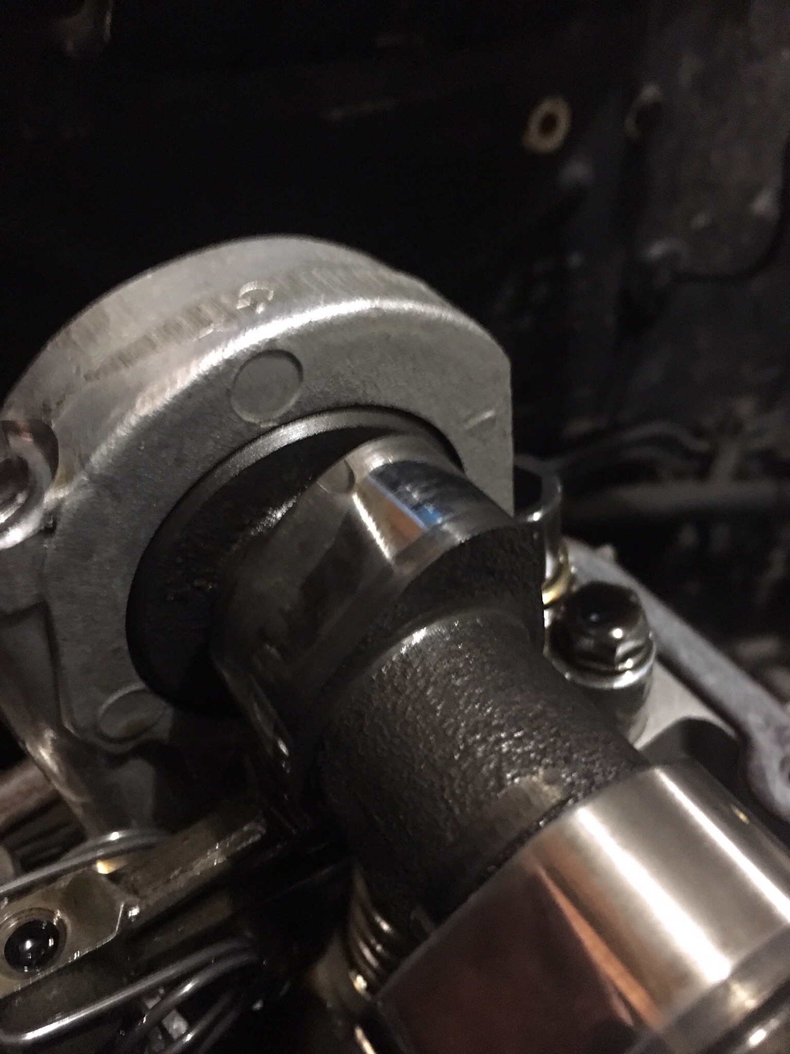

I thought the very last lobe looked weird and still can't make it out, but maybe camera is fooling me. One more pic directly on that lobe
I don't even have a 24 or 27 and I'll have to get a socket that is long enough to reach in there. Curious, how is it that in both of the videos I watched they are using the camshaft bolt to turn it with ease?

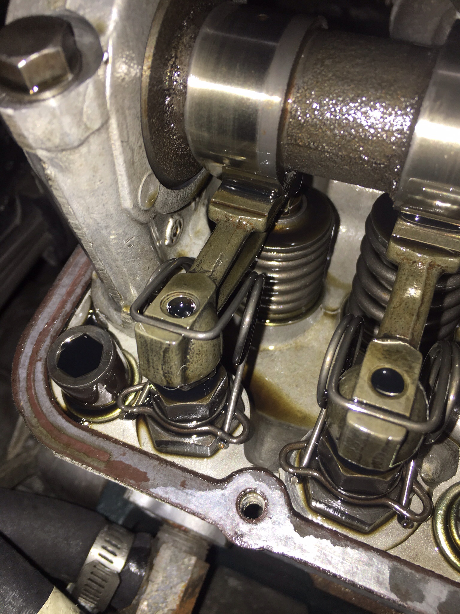

That rear lobe looks suspect to me. Now if you could post a pic of the rocker under it, the passenger's side where the contact pad is.
