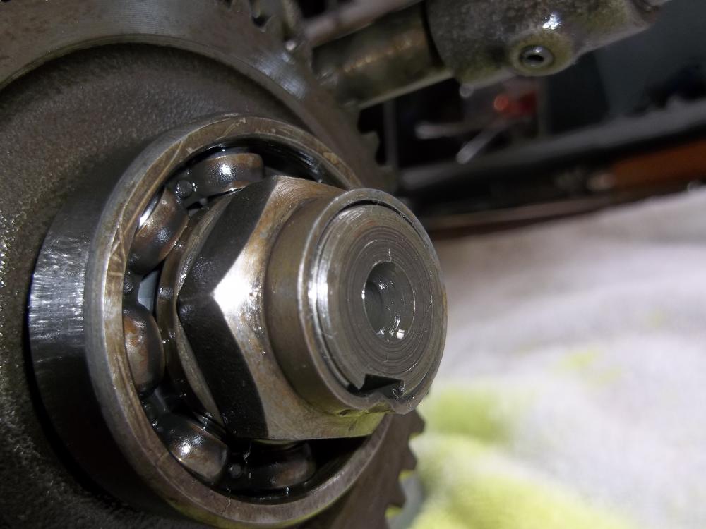

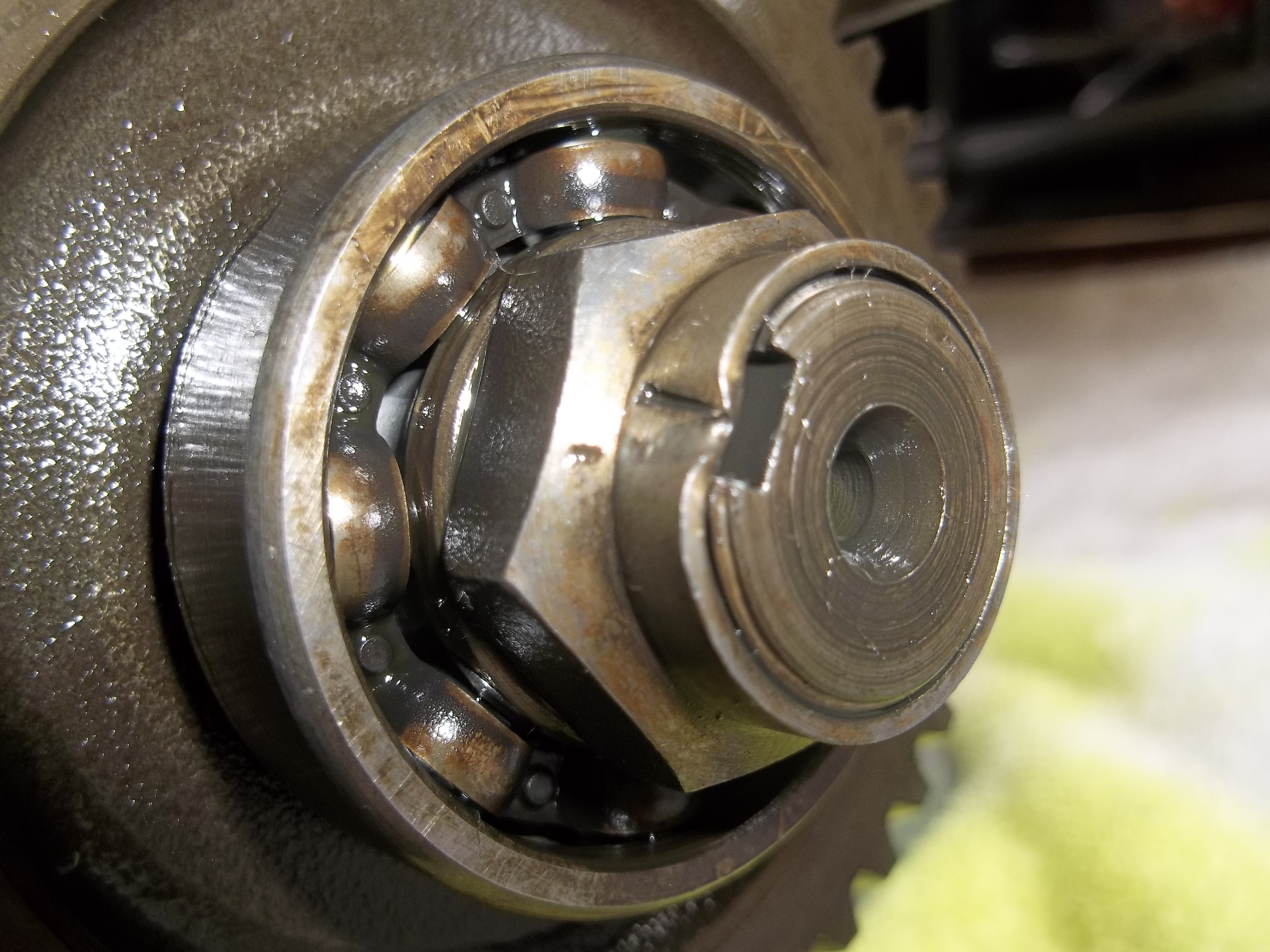

Dave WM Posted April 12, 2016 Author Share #31 Posted April 12, 2016 ordered the counter shaft nut from MSA for an 81 ZX from their website, they will ship in a couple days. I presume the procedure is to engage two gears at the same time to lock up the trans, the use a punch to straighten up the peened in part of the old gear, then remove by turning TBD direction. Use new nut to reinstall, tight to 75-90 ftlbs re peen over gear to lock in. Sounds easy but never having done it I suspect its not. Link to comment https://www.classiczcars.com/topic/55236-1981-280zx-5-speed/?page=3#findComment-492464 Share on other sites More sharing options...

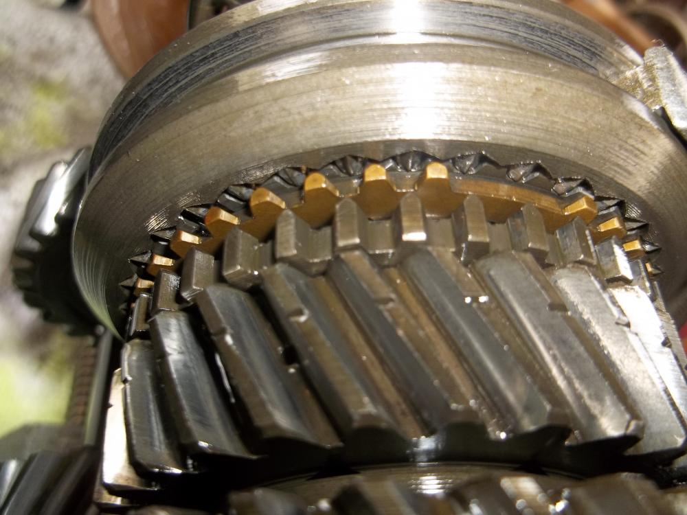

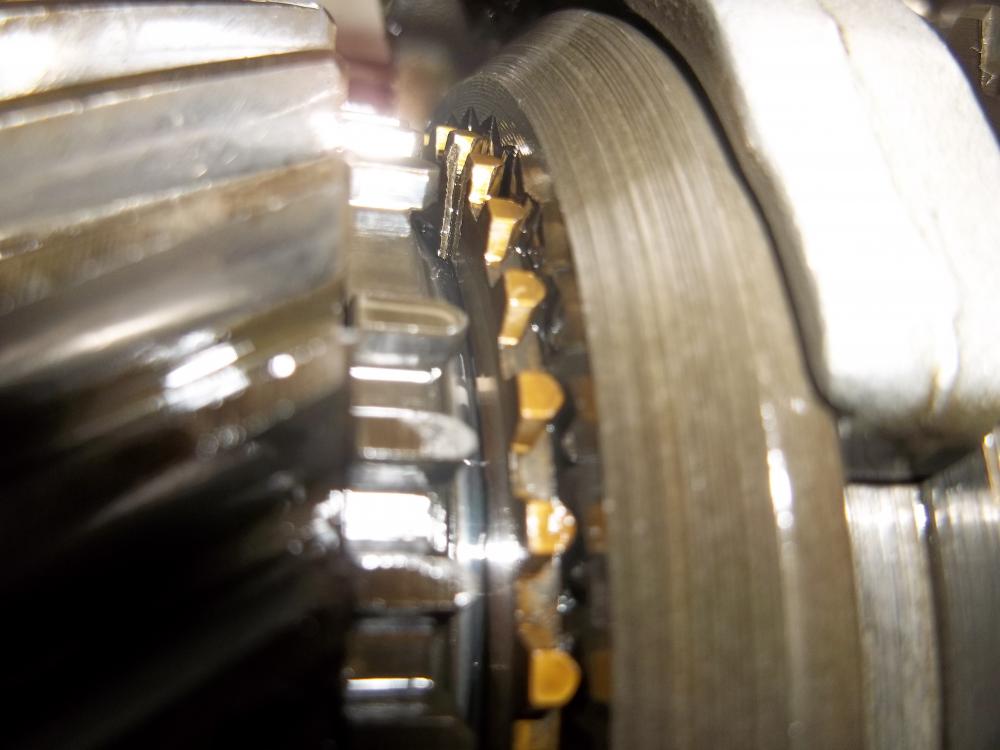

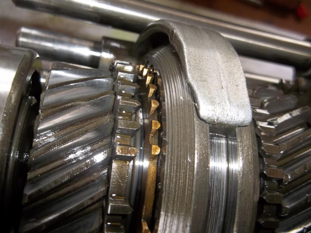

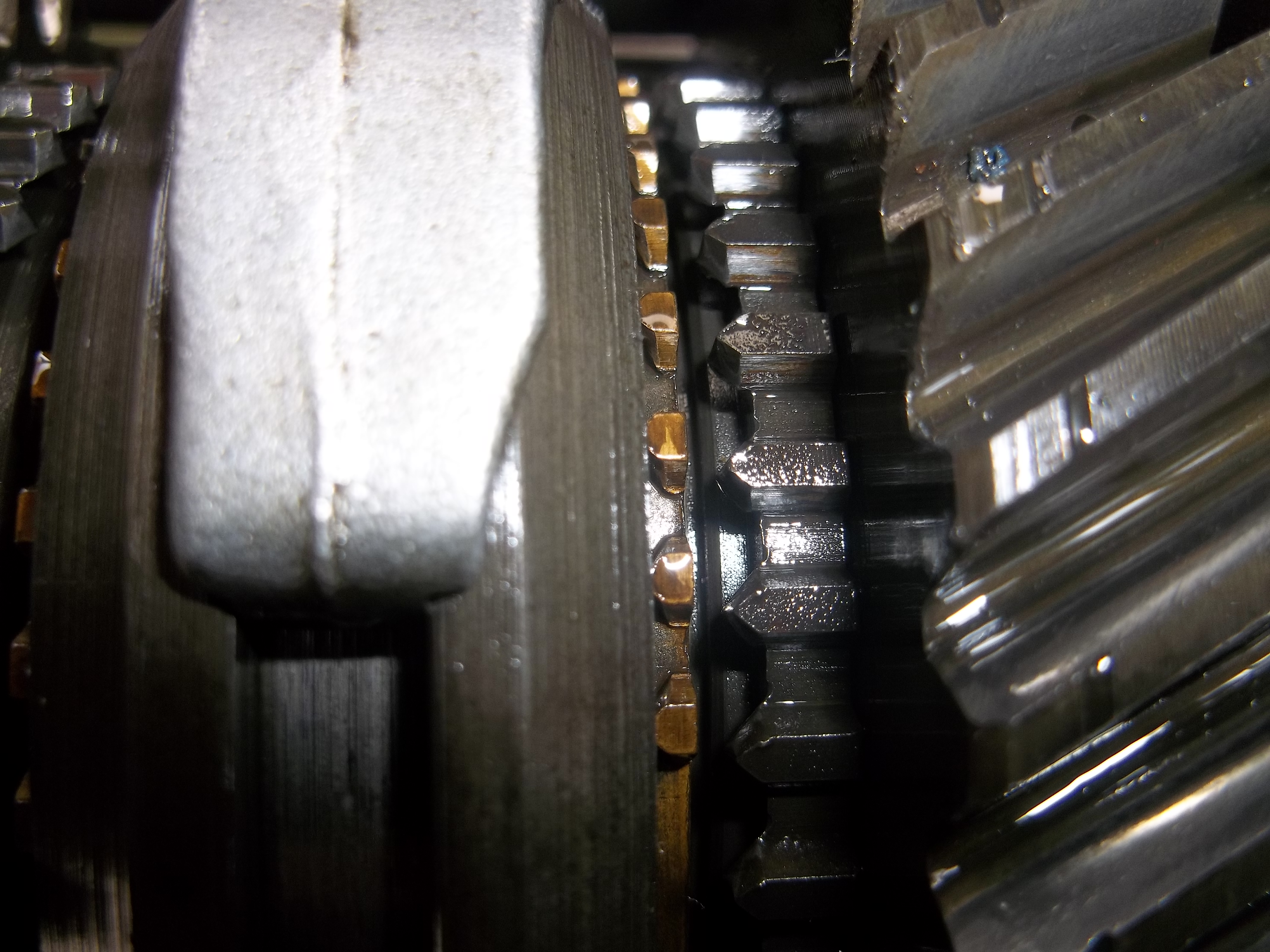

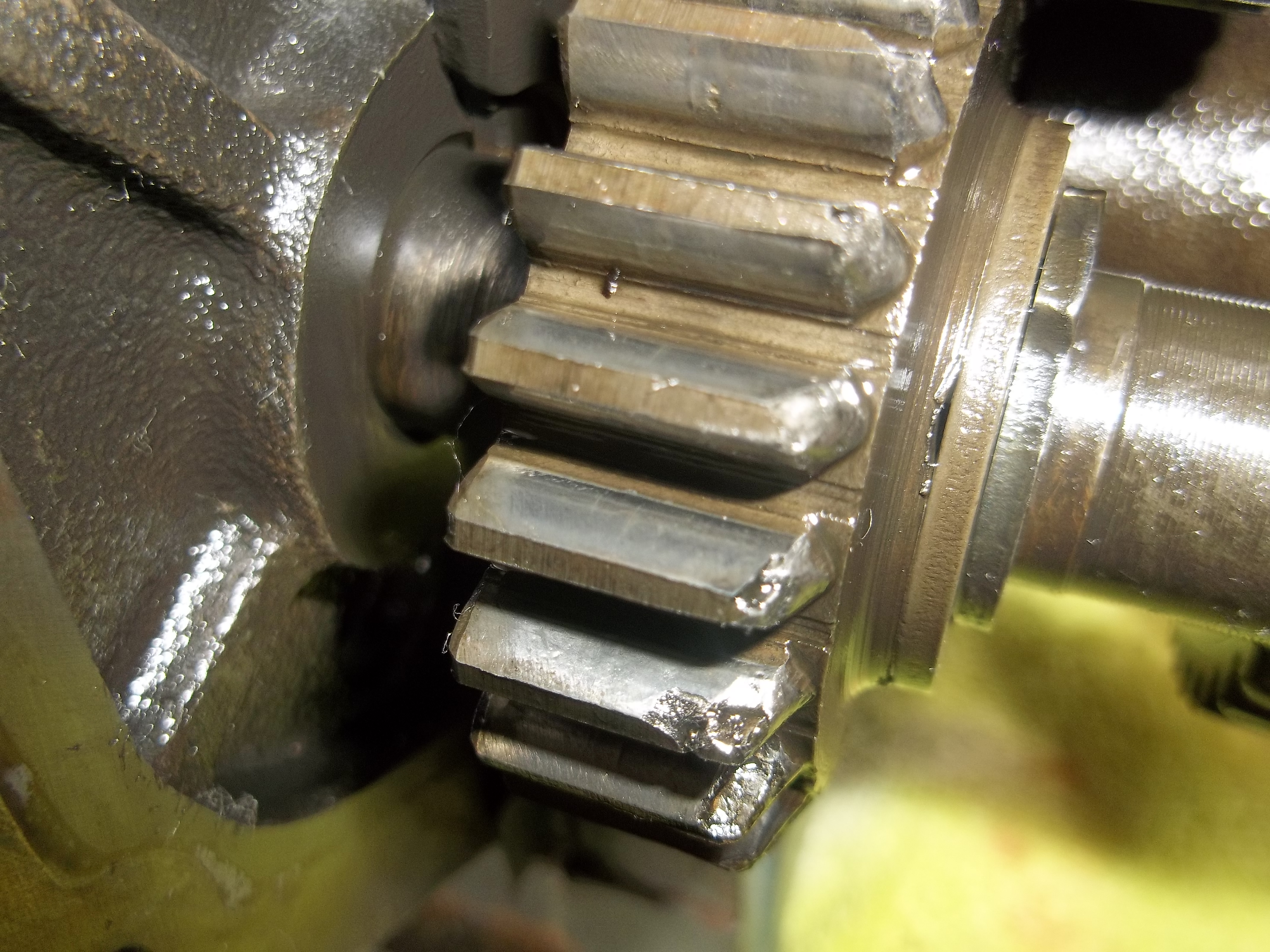

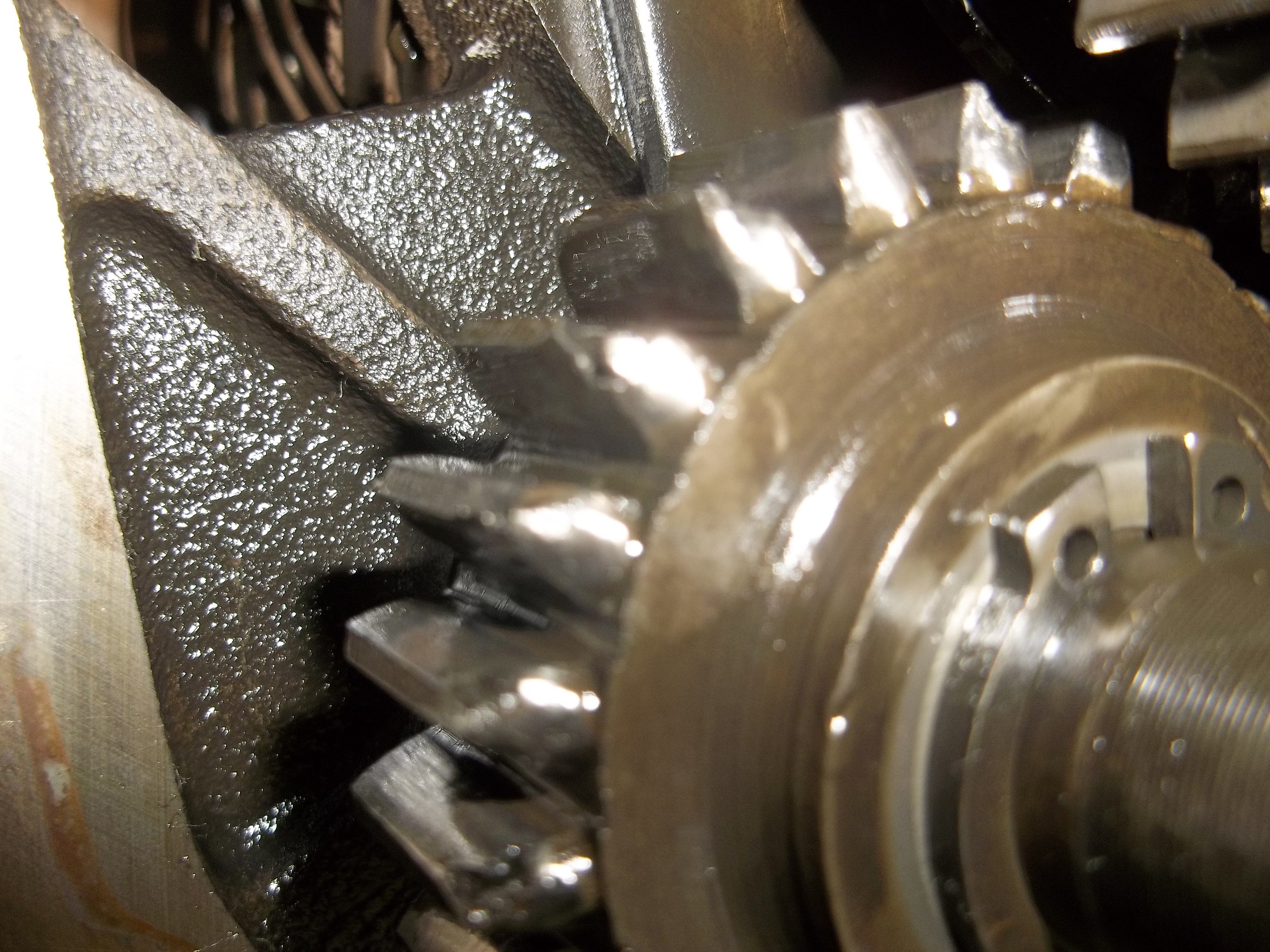

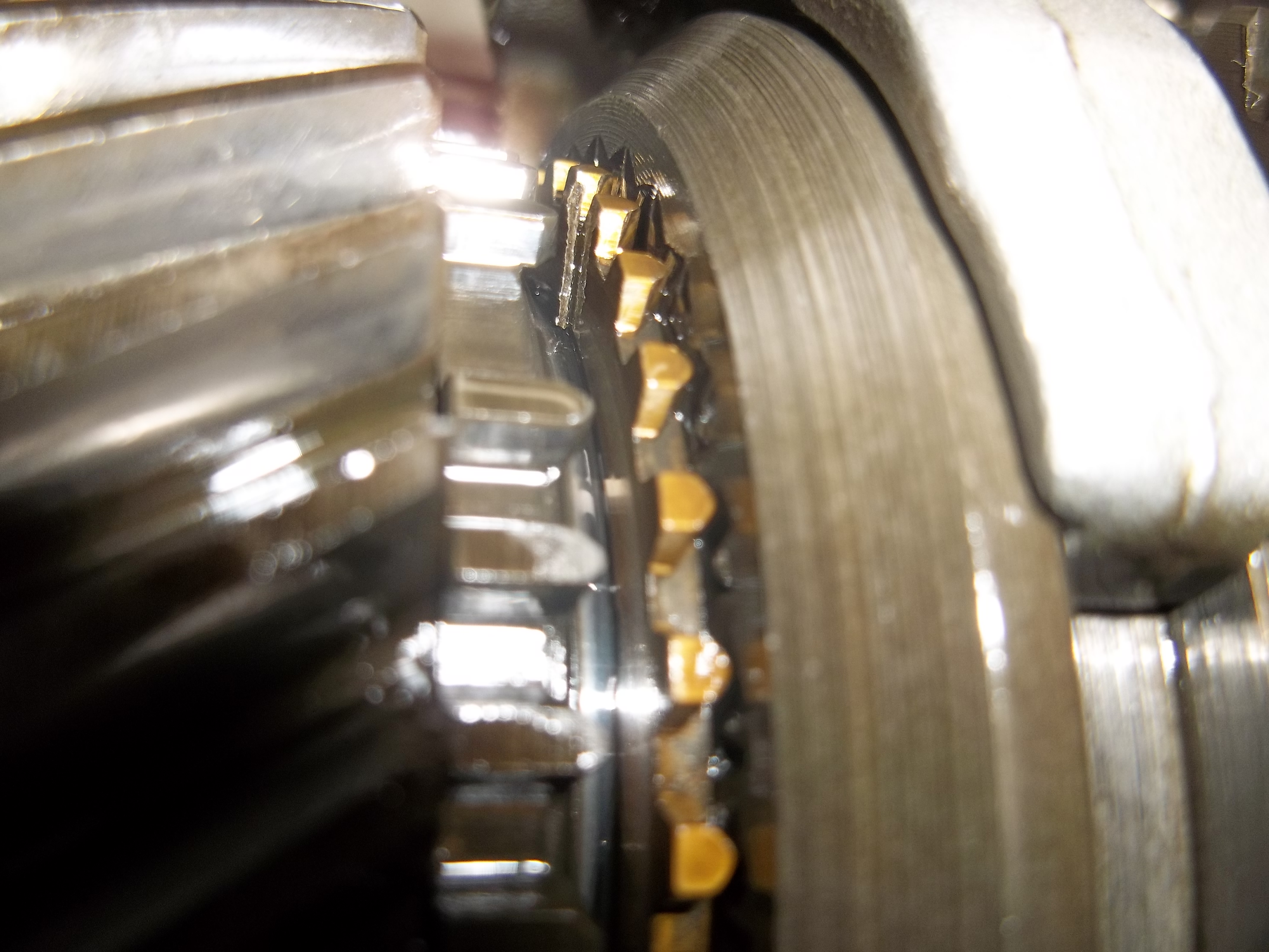

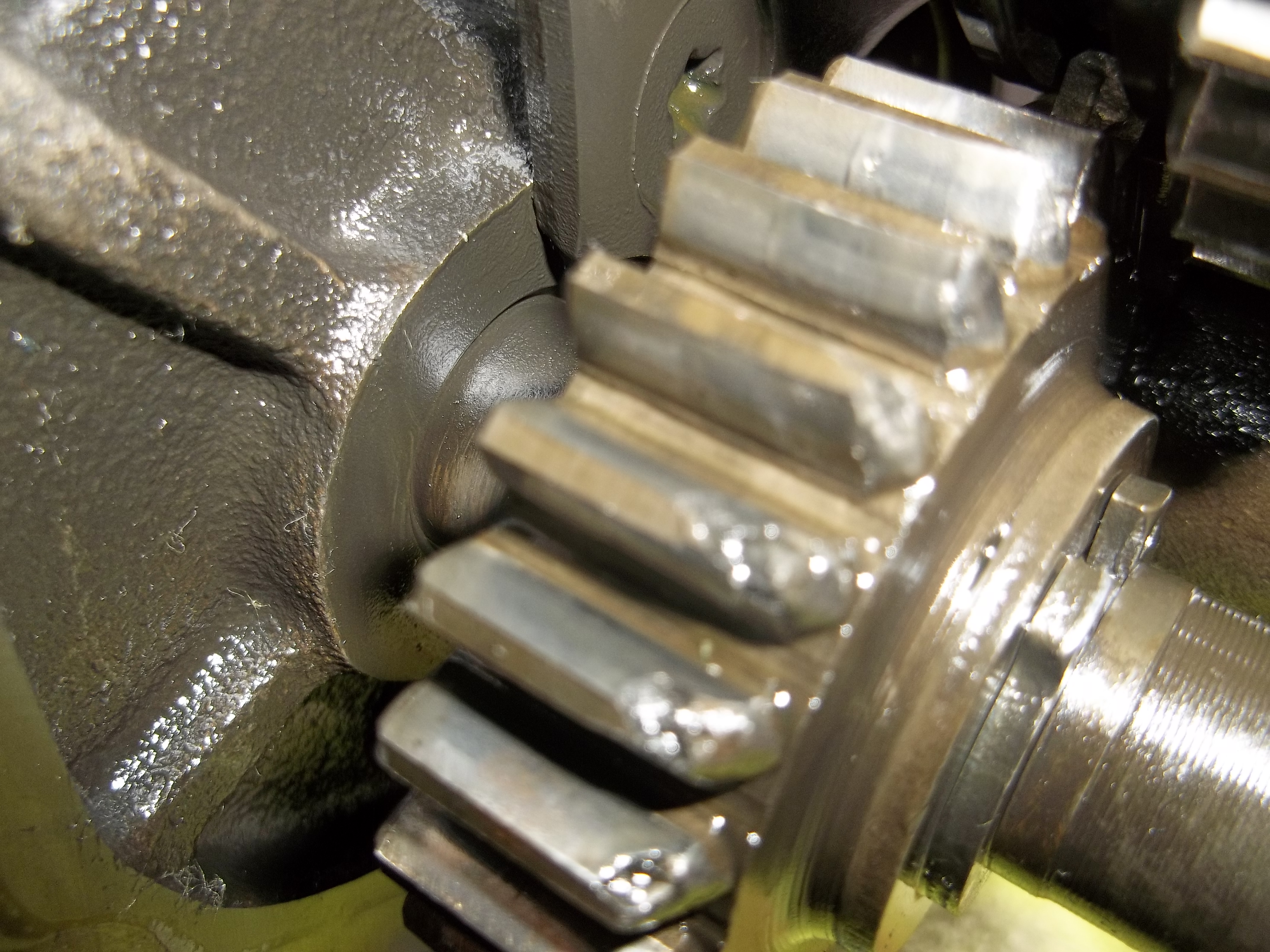

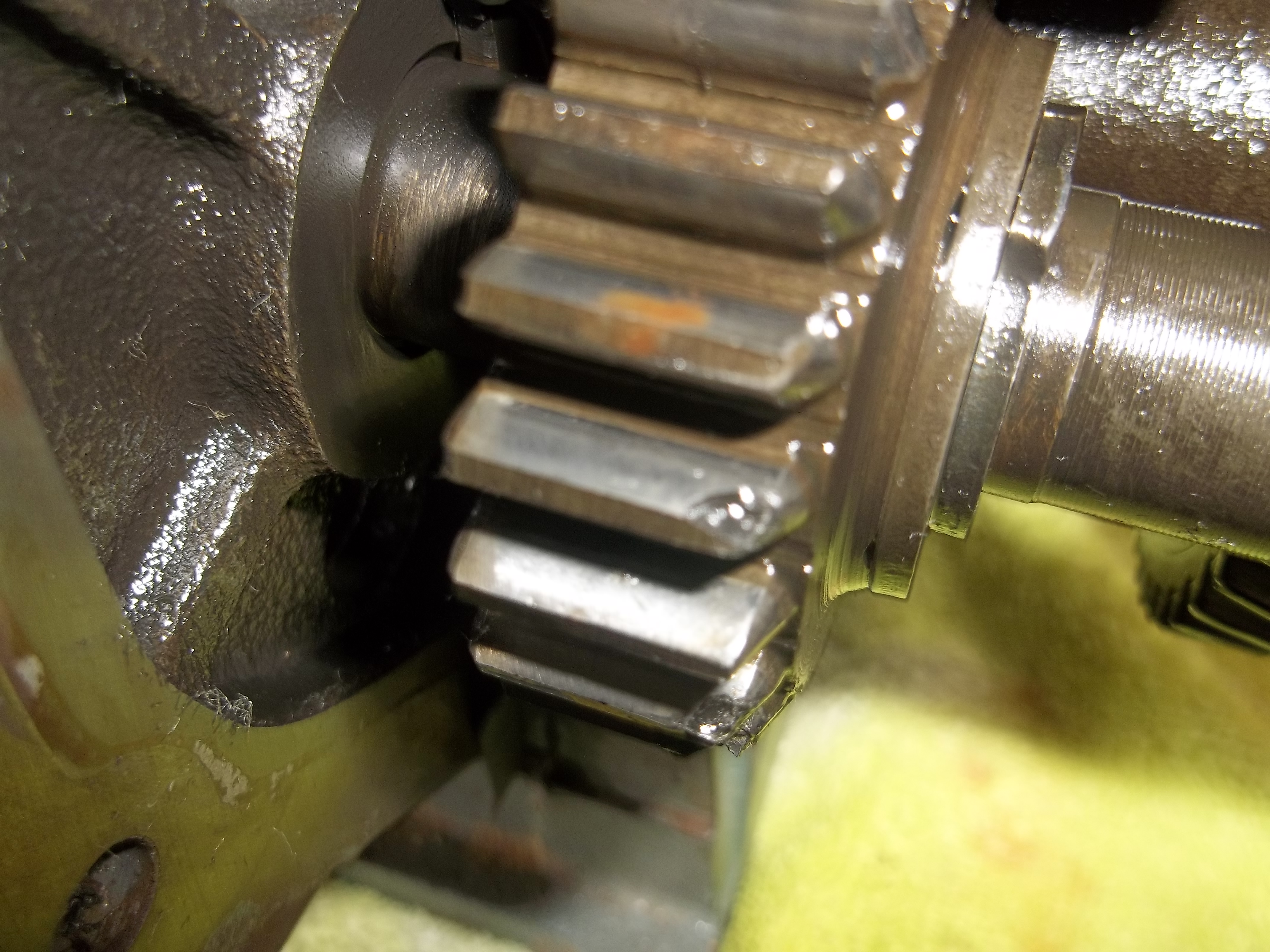

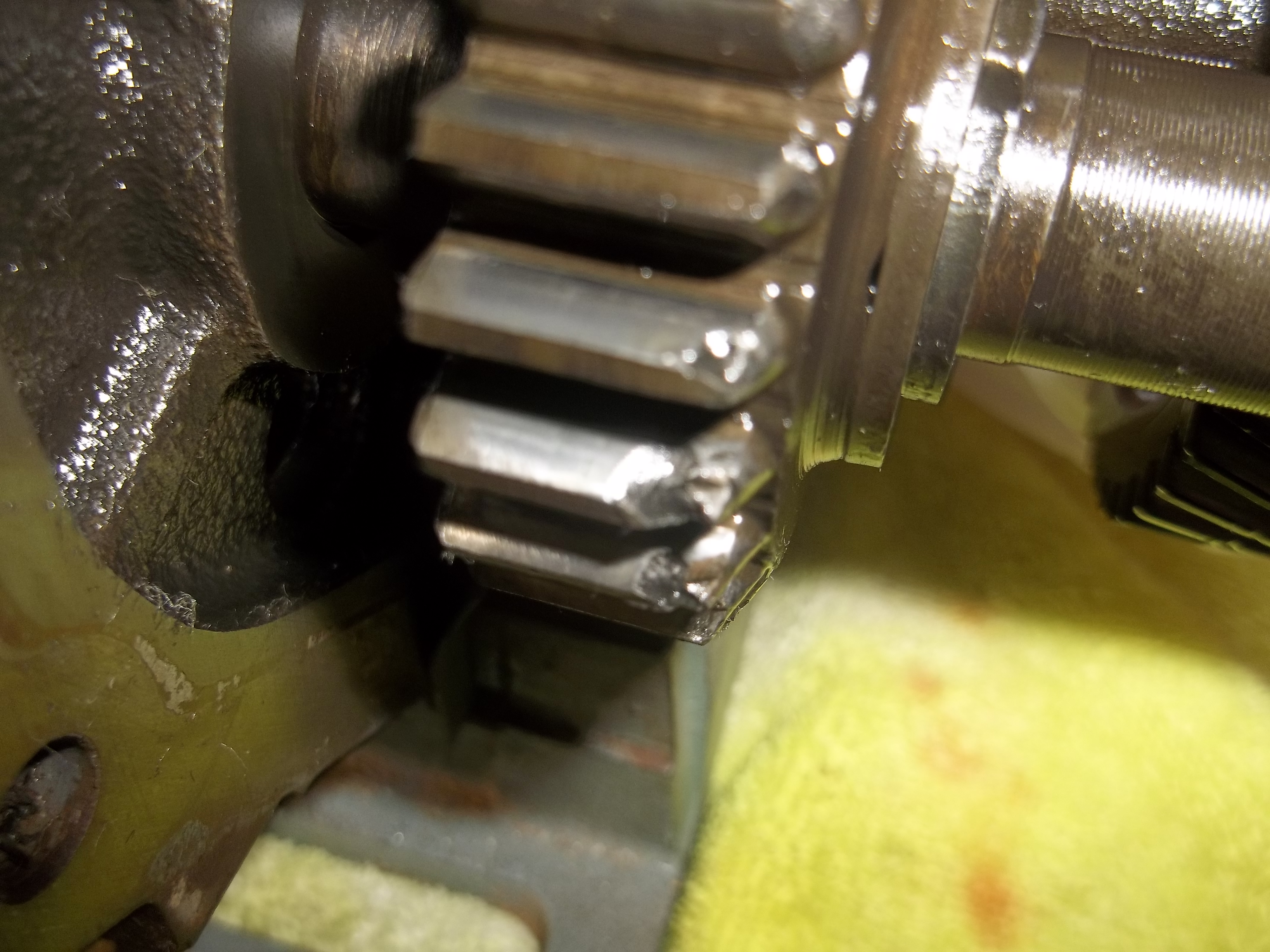

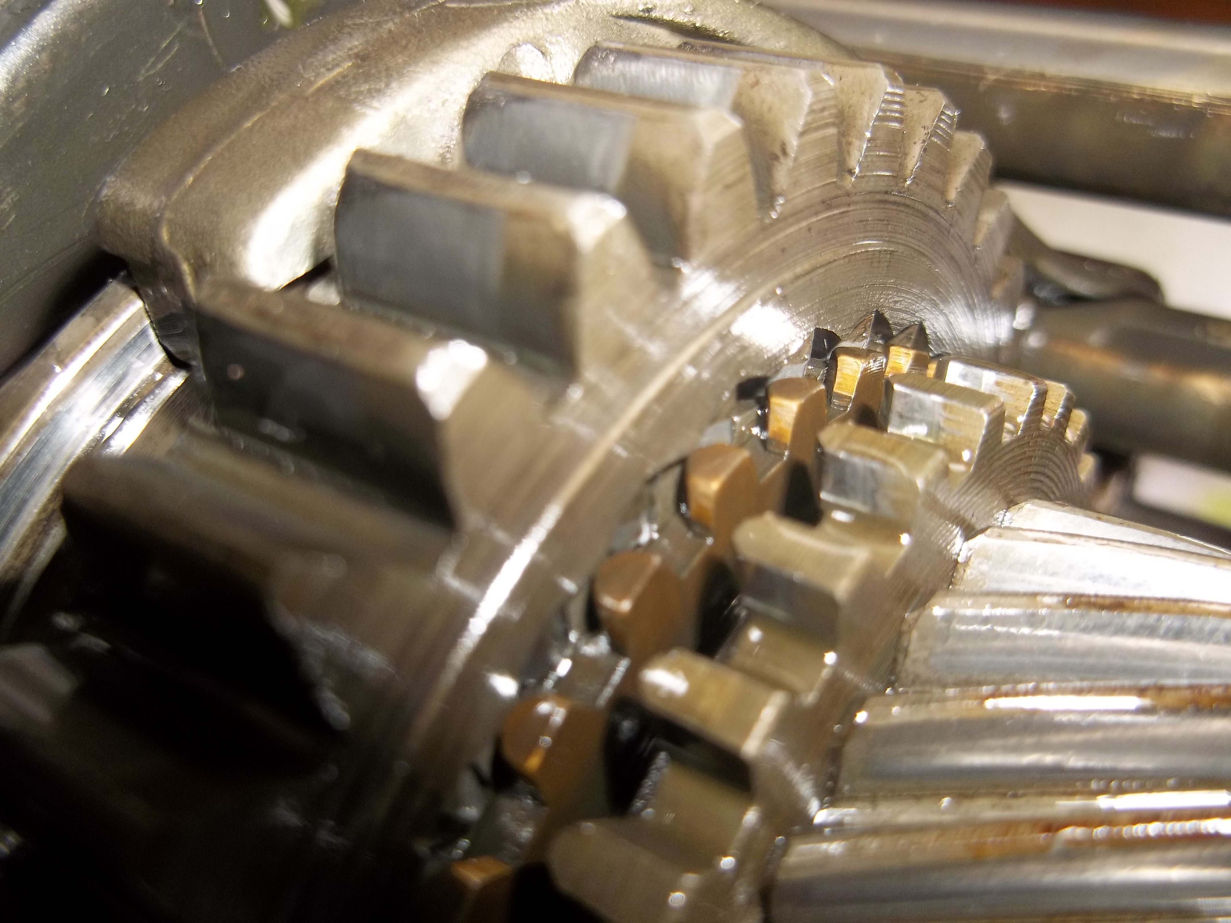

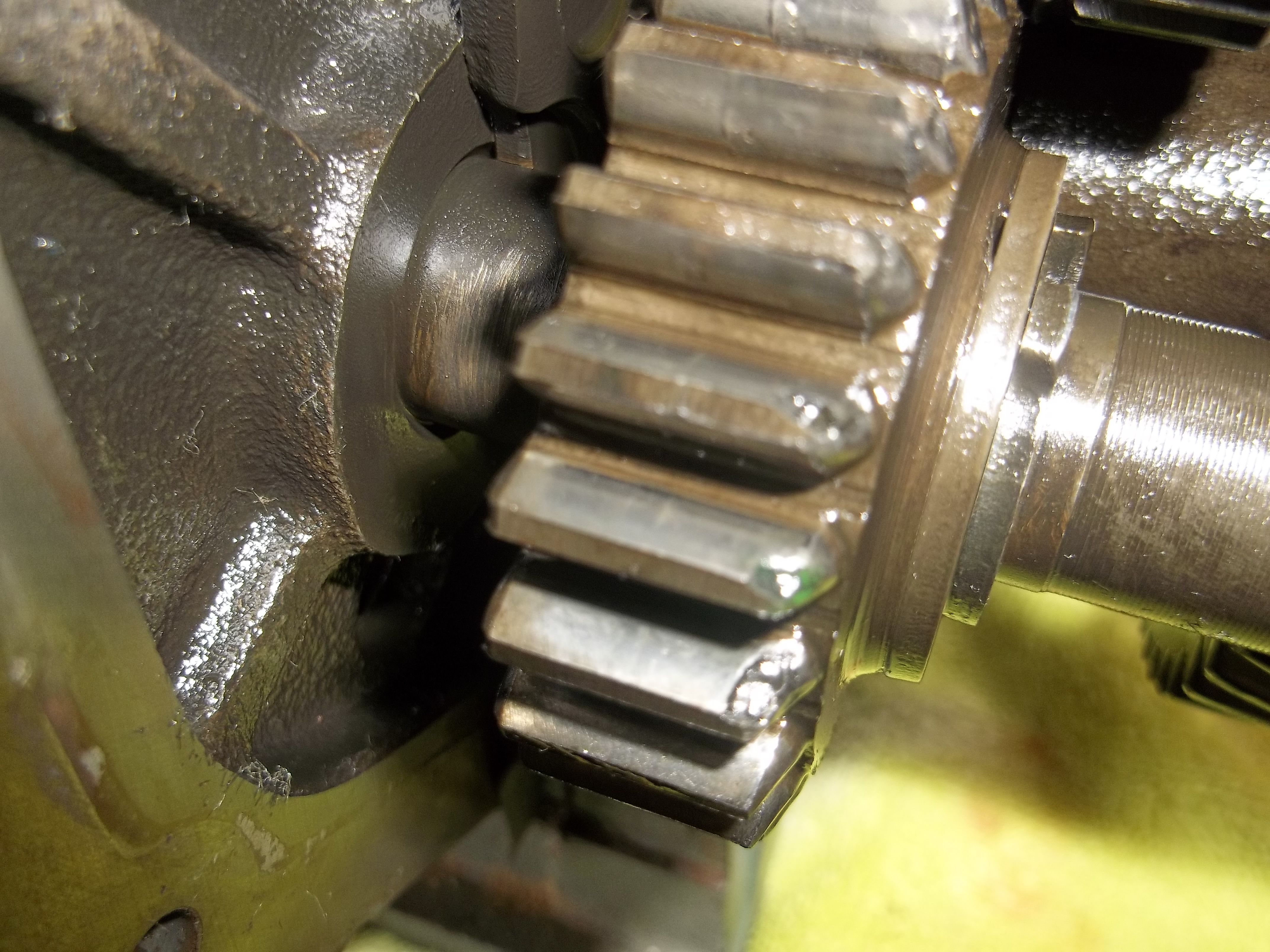

Dave WM Posted April 12, 2016 Author Share #33 Posted April 12, 2016 here are some pic. I agree I am at a point where the reverse gear is the only thing that I can SEE has issues, and not sure how bad they are. I am not too far into it right now. I included some pic of the reverse idler as well showing some of the good and some of the bad teeth. Link to comment https://www.classiczcars.com/topic/55236-1981-280zx-5-speed/?page=3#findComment-492467 Share on other sites More sharing options...
Zed Head Posted April 12, 2016 Share #34 Posted April 12, 2016 Looking back over your thread, I would really recommend that you run through the inspection procedure in the factory FSM. You started out as just replacing a broken oil gutter, but now you're sinking money and time in to what looks like an abused transmission. I suggested the the chipped reverse idler was the result of an angry driver with a bad clutch but on second look somebody really had to pull hard to do that kind of damage. They didn't care. Looks more like they were banging gears and missed the 5-4 downshift, repeatedly. I stole a decent picture from duragg's thread showing new synchros and good dog teeth. You need to look at them straight on. Look for symmetry and sharp peaks. There are clearances you can measure to see if the synchros are worn. Described in the FSM. Also, from what I've seen, the broken gutter happens when people disassemble the transmission. Looks like somebody's already been in there. Still looks like a good time to pause and ask what you're really expecting. I get a queasy feeling looking at what you're seeing. What's the history on the transmission? You can see the end of the thread on that shaft. Follow it in and see which way it turns. 1 Link to comment https://www.classiczcars.com/topic/55236-1981-280zx-5-speed/?page=3#findComment-492470 Share on other sites More sharing options...
Dave WM Posted April 12, 2016 Author Share #35 Posted April 12, 2016 No history, got local from a young guy, was already pulled. I don't even know if he had used it. I am not into it very much, I can see about checking closer with FSM for clearances. I would have no prob just doing that and if not too bad putting back together and trying it out to see how it goes before doing any more work. Link to comment https://www.classiczcars.com/topic/55236-1981-280zx-5-speed/?page=3#findComment-492471 Share on other sites More sharing options...
Mark Maras Posted April 12, 2016 Share #36 Posted April 12, 2016 Yup. What Zed Head said. That is an abused trans. It looks like someone tried to repeatedly stuff it into reverse with a bad clutch cyl. Even if I left the gears in it, I'd break it down (it's not difficult) and replace the synchro assys. and all new bearings. The chips and pcs. from the gear can do damage before they settle to the bottom. Also, the teeth on the synchros don't tell the whole story. The inside surface of the brass rings is a friction surface. It can show wear even when the teeth look OK. Link to comment https://www.classiczcars.com/topic/55236-1981-280zx-5-speed/?page=3#findComment-492472 Share on other sites More sharing options...
