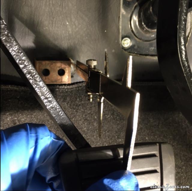

I replaced my clutch master cylinder and i;m in the process of adjusting the pedal per the manual.
"Set the upper surface of the pedal pad 8.9 in or 226mm from the metal surface of the toe-board."
If you look at this picture you will see that the caliper (which I set to 226mm) is not touching the pedal pad when the other end is sitting on that metal riser.
However if I measure from the firewall as I did in this picture the caliper does line up just about perfectly on the rubber on the pedal. (226mm from firewall to top of pedal). large.IMG_0357.JPG
What is the proper point that I should be measuring? Any help is appreciated. Thank you.

I think you are measuring to the wrong surface, have you downloaded the 260z FSM for the manuals section in the downloads area? Here is a pic from the FSM showing taking the measurement from the top of the pedal to the toe board surface (carpet & jute not shown would have to be folded back or removed). Don't forget to check for free play as well.
HTH
Mike
