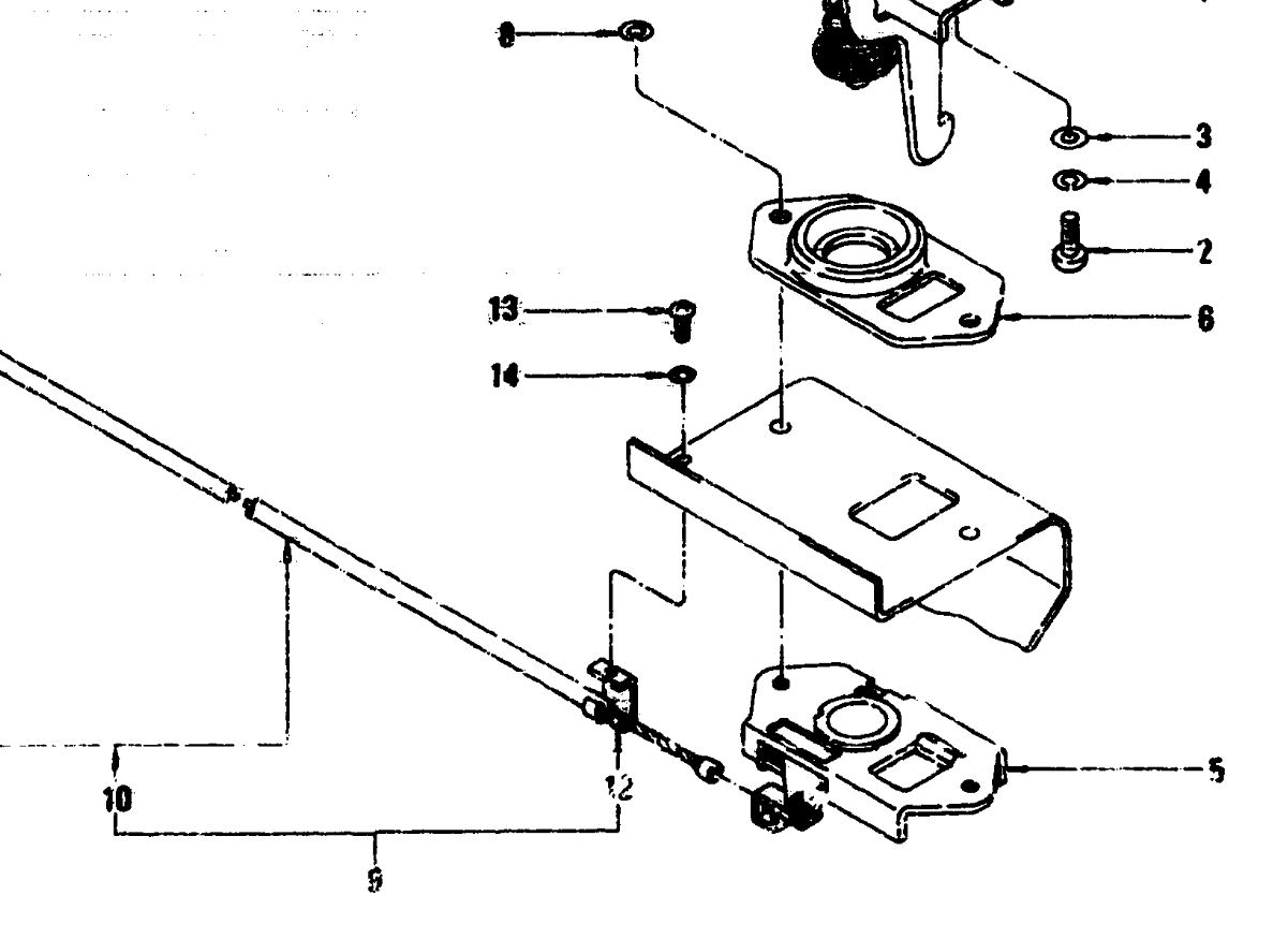

Here is a link to the parts info for the 240Z hood latch, also a useful resource to compare with parts of later model years when using the later FSM's.
http://www.carpartsmanual.com/datsun/Z-1969-1978/body-240z/hood-lock-control

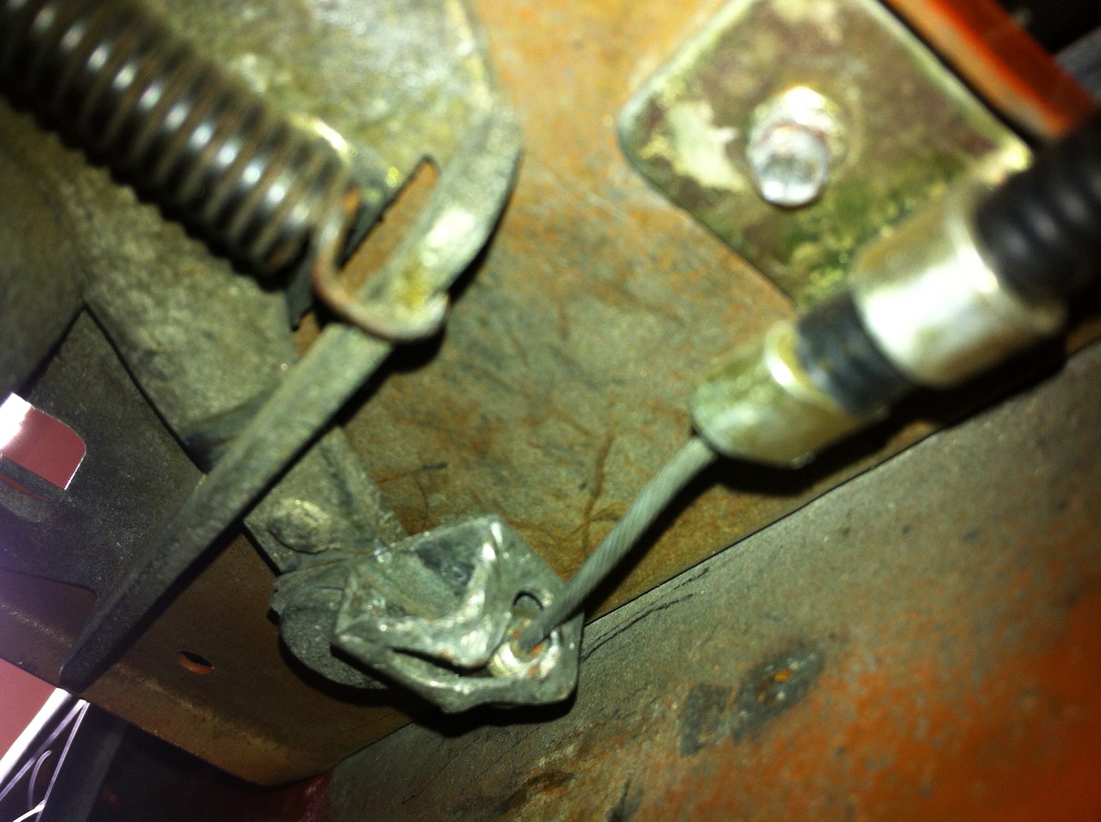

I am talking about the actual cable clamp, that screws onto the frame so the outer cable does not move. I am not sure what tool I can use to bend that back to hold the actual cable in place. What's happening is, I pull on the hood lock handle, and it doesn't unlock the hood lock. The whole cable is being moved, instead of the inner silver cable that does the actual pulling.
I think what I can do is, slide a bolt over the cable bracket as it is not round anymore, hit it with the hammer a few times, get it round again then insert the cable and crimp it down.
Here is a picture of what mine looks like and a cropped image from the parts manual.  The outer lug on the end of the clamp is actually deformed to locate the end of the sheath and the lug that is in line with the screw is the one that clamps the sheath, I'm not sure how much it is crimped as you don't want to crush the sheath to much.  Make sure the cable is clean and lubricated while you have it apart.
