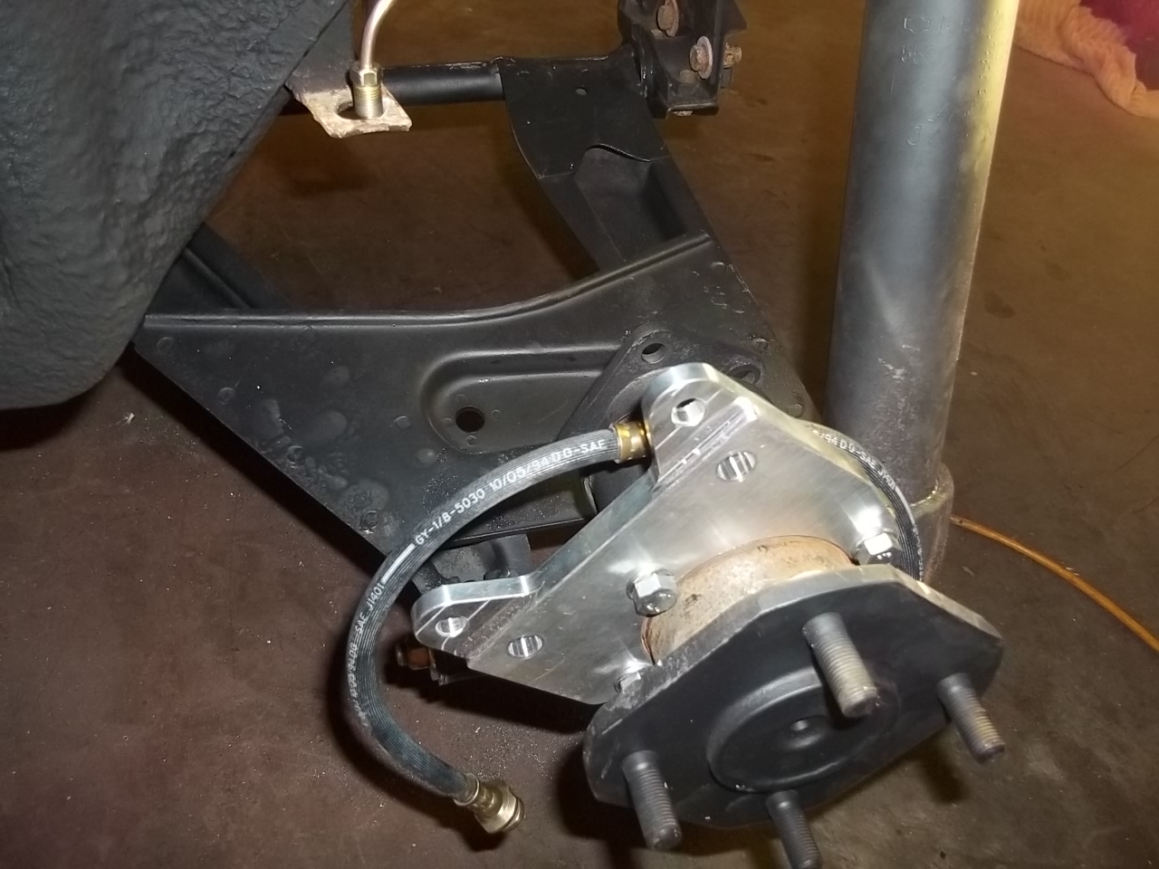

the flex hoses look new, but the date stamp on the is over 20 years old (see pic)
i have no idea what these parts are if i need to replace one of them, what did they come from?

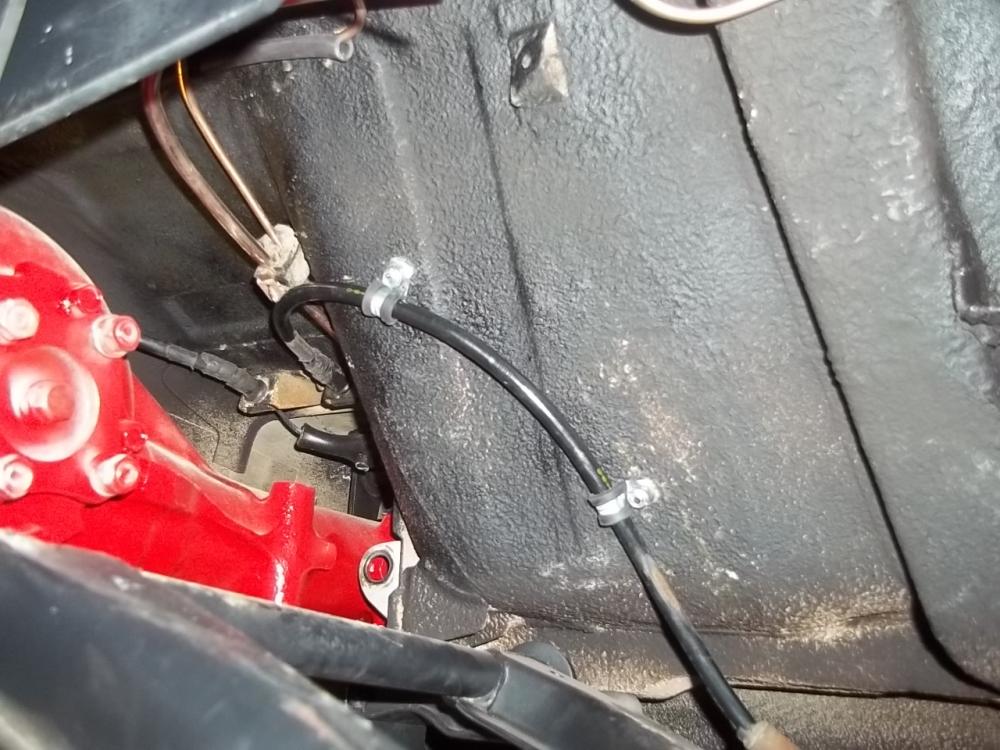

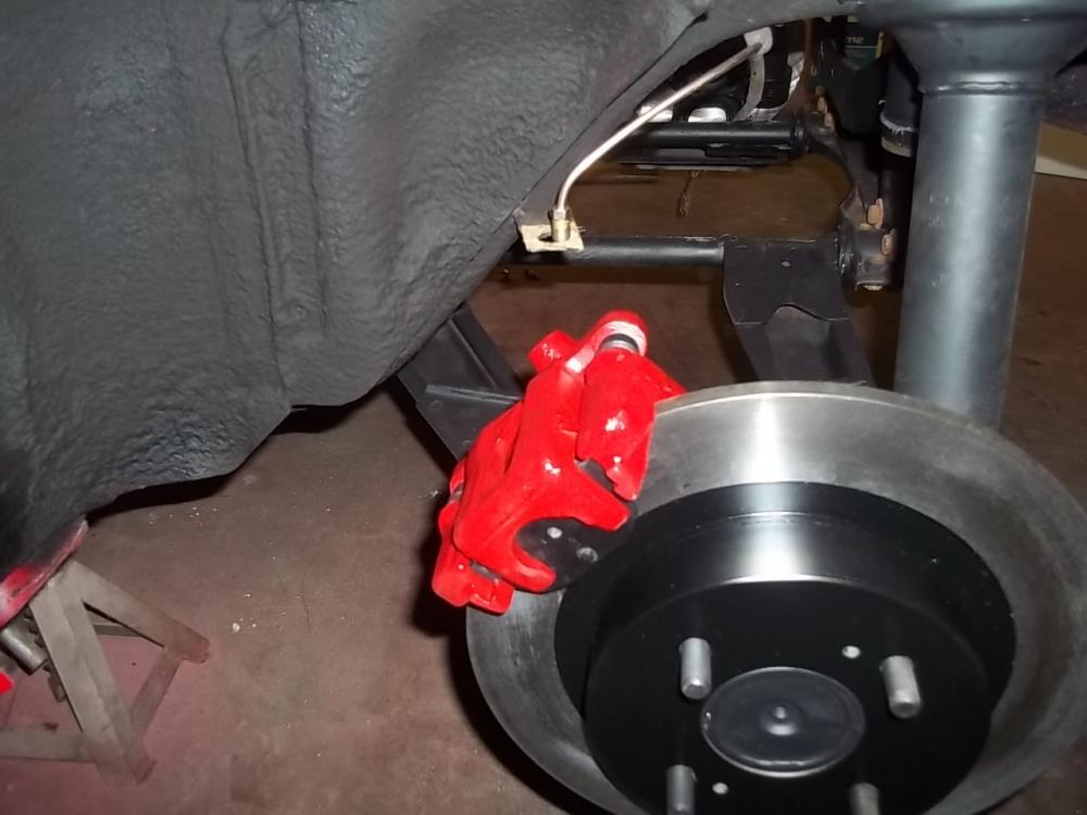

all most done with this conversion. had to find a new parking brake cable housing before going any further.
here is the cable re-routed and clamped to the body
lines up nicely. just need to modify the brackets a bit

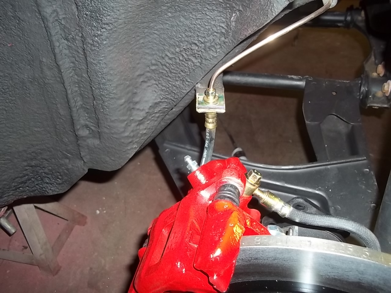

Hey, I just got this conversion in a week ago, I've got the drum backing platracks cut off, the adapter on, I cant figure out how to route the new brake hose. It looks like you have it wrapped under? Also I'm having a problem with my ebrake bracket, it's too small, is that why you had to source new lines?
i had to get the parking brake brackets at a wrecking yard. they are off some newer nissan. sorry, its been a while.from what i recall, i had to route the flexible brake lines between the brake cable and the bracket as seen in the photo directly above your post. if i remember to, ill take a couple more pics.
