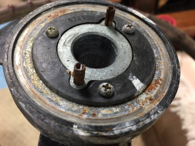

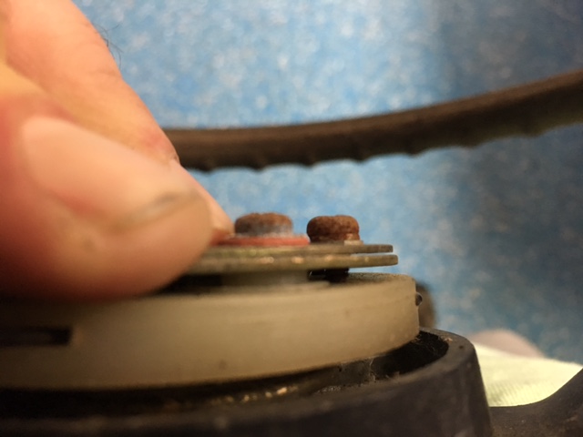

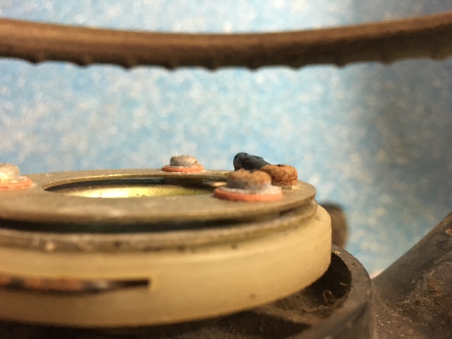

As Zed Head says under the horn pad is just a spring loaded sandwich if you will, that connects the circuit to ground. A simple emery sanding of the plated should fix that.

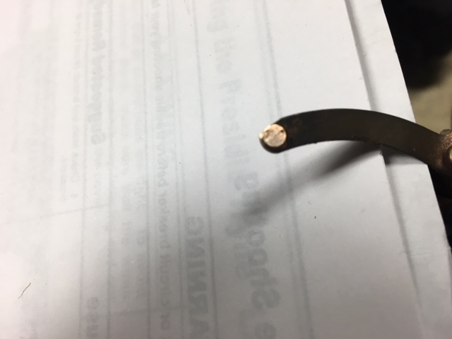

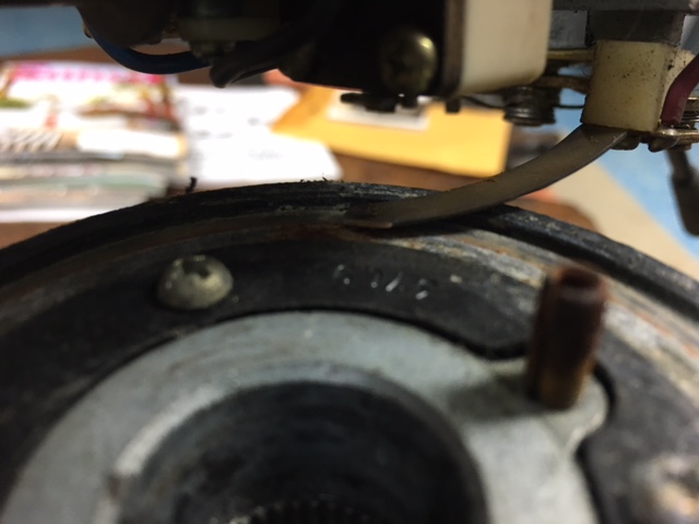

Also on the back side of the steering wheel is a spring tensioned contact that rides the outer ring on the wheel. This is how the signal is passed to the harness in a way so you can turn the wheel and not be twisting a wire, those contacts also need to be cleaned / sanded / filed. Might need to pull the wheel to get at the back side.
I suspect that is the problem. As you can see on the wheel in the pictures it gets corroded and loses the contact. This contact is connected through the three prong terminal going to the turn signal side of the switch. The Red/Black wire can be checked for continuity to the sandwich plate as the horn button is pressed.
I wouldn't expect you would need to buy any parts to fix this unless one or more of the above pieces is broken or missing. It should just need cleaning.

And Terrapin's pictures show what is even more likely, I think. Rusty, dirty contacts will open up as they heat up from current flow.  That contact is supposed to be always made, even as the wheel turns.  I think that you could check that one by pressing the button and turning the wheel.  You might get several beeps or it only beeps in one spot.  I had that problem on a Pathfinder, the contact had just worn away.  240,000 miles on it.  It was a different design but had the same purpose.
Terrapin you are always so helpful and knowledgeable! I appreciate the photos! The front contacts look good.. Not corroded at all! But I haven't pulled it apart or looked at the back side. I also was not there when my z guy was troubleshooting, so I'll have to ask if he pulled it apart? I was just there at the end when we tried to honk the horn.
