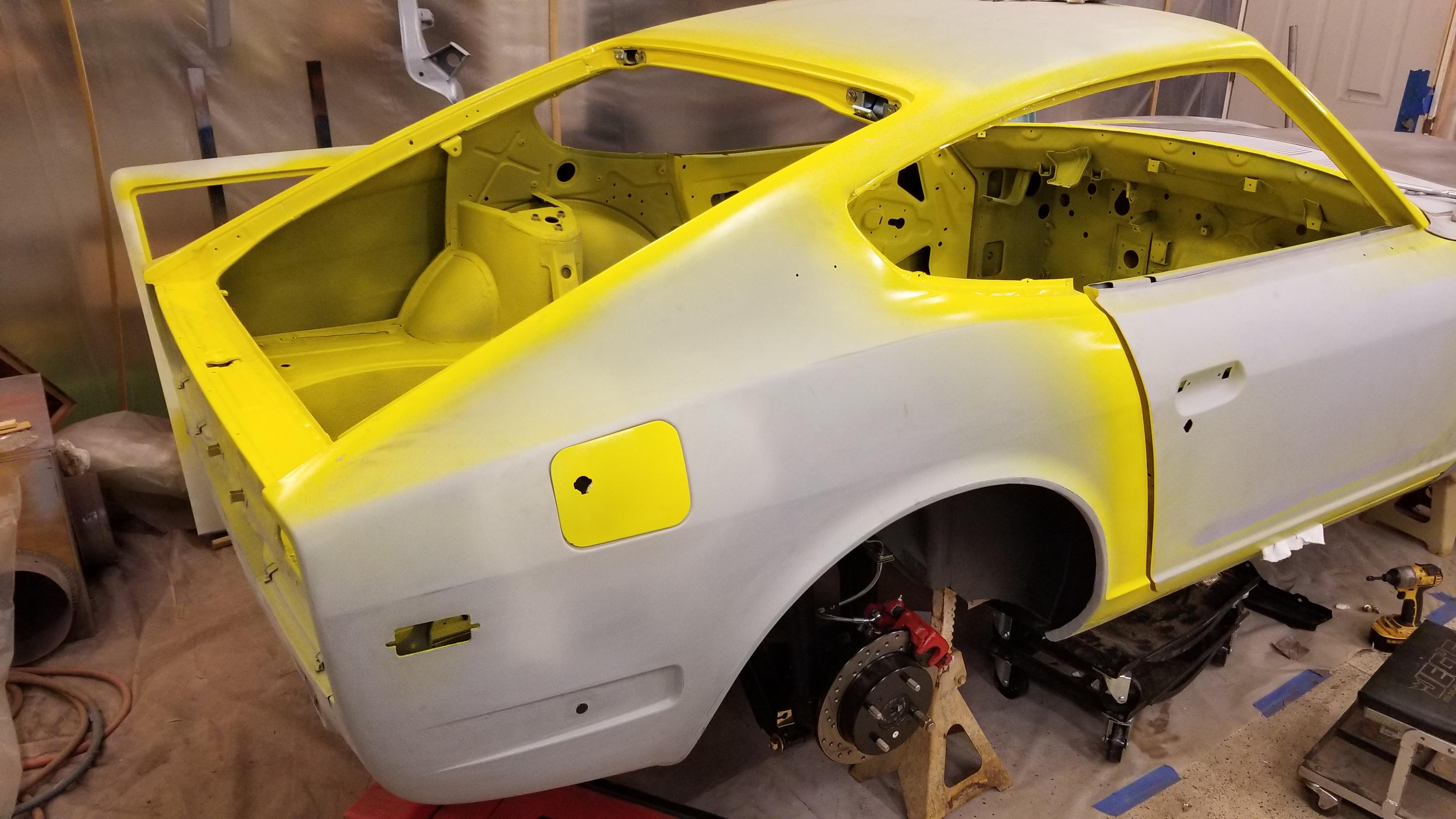

I started fitting the fender and assorted front end parts

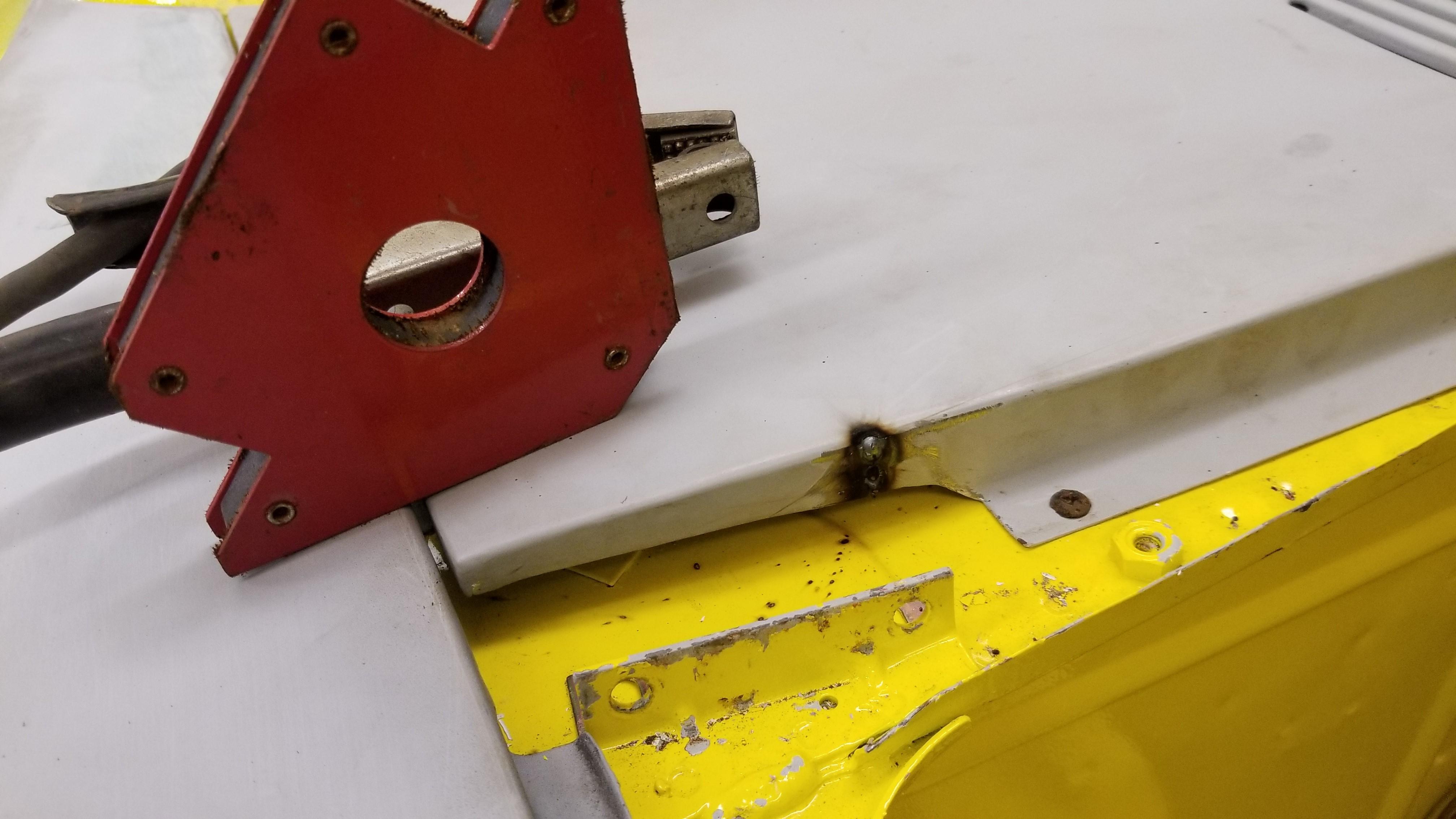

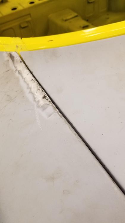

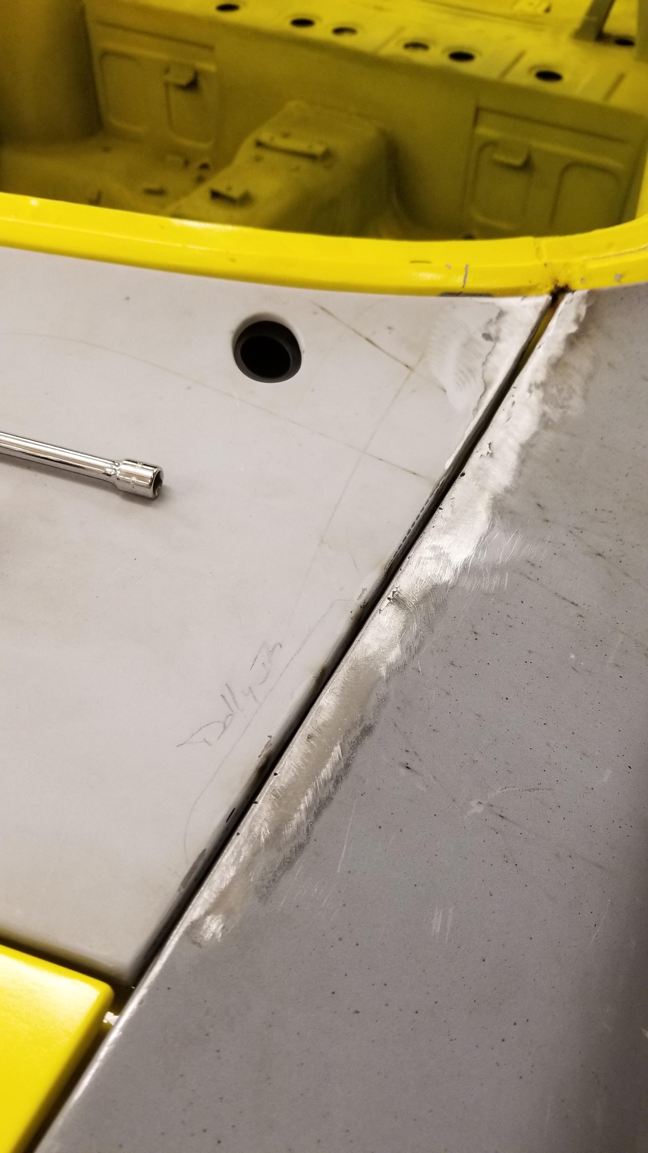

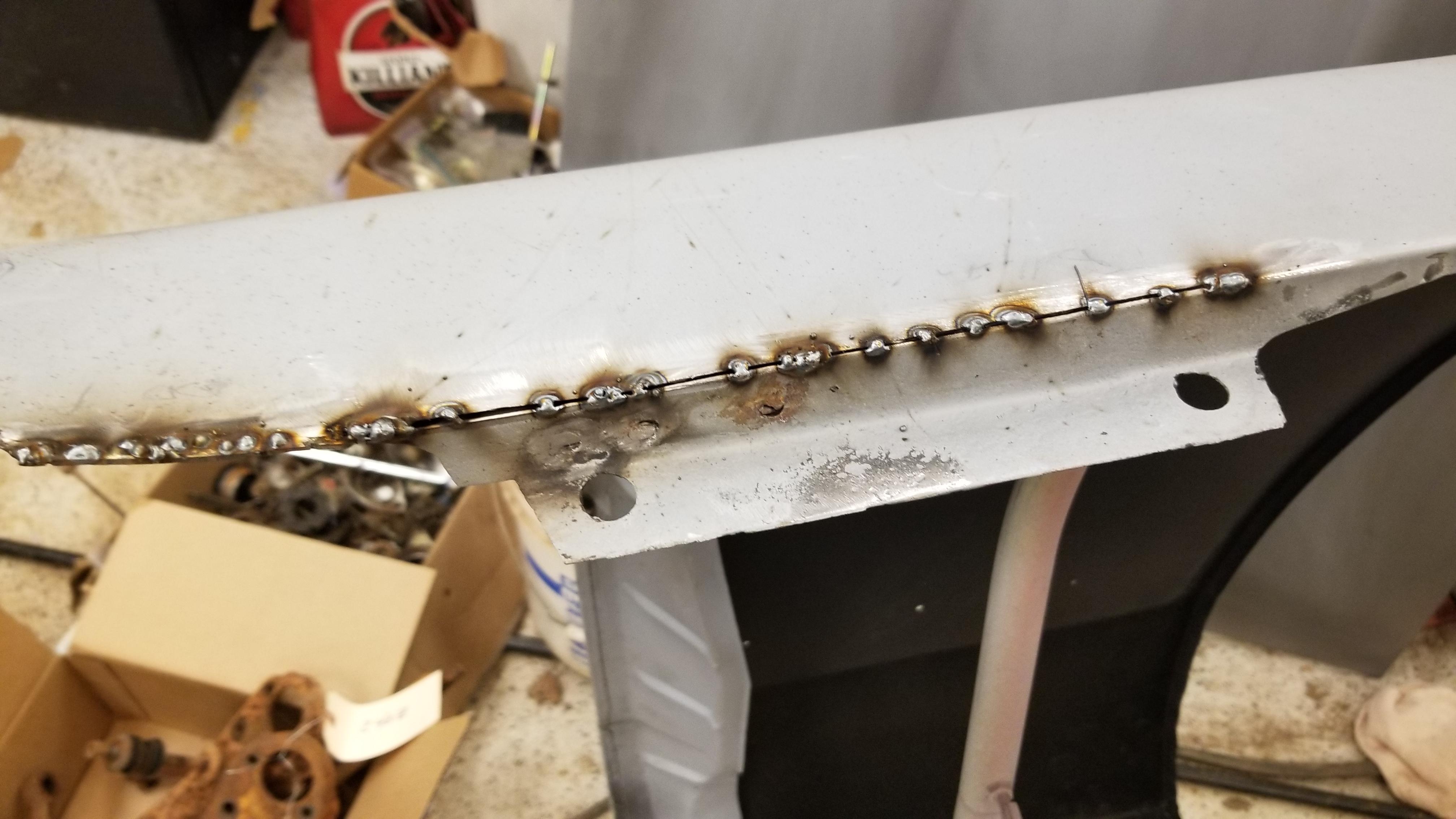

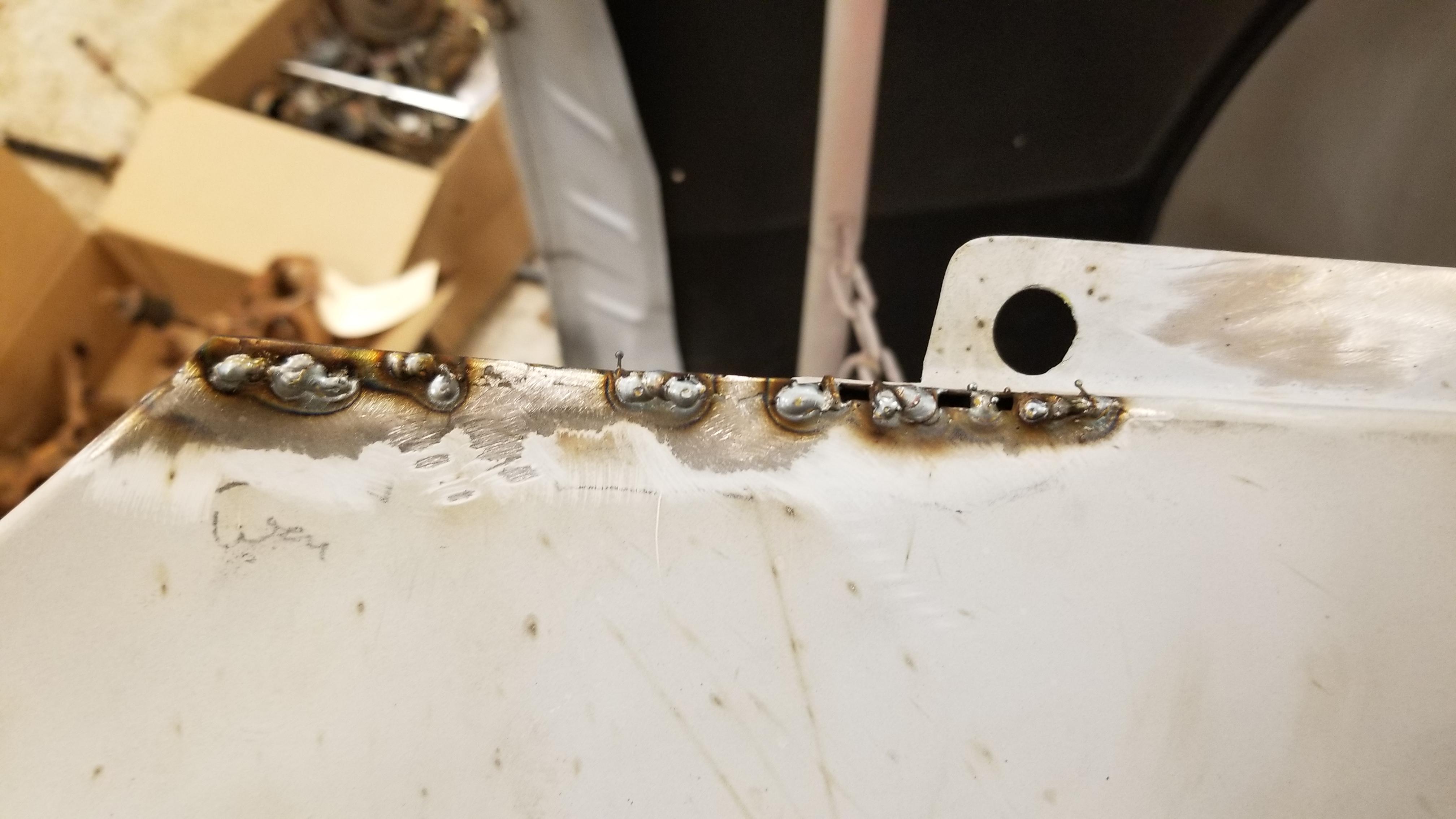

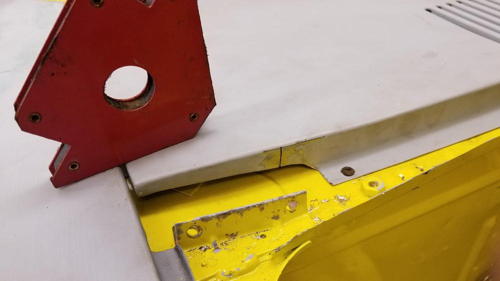

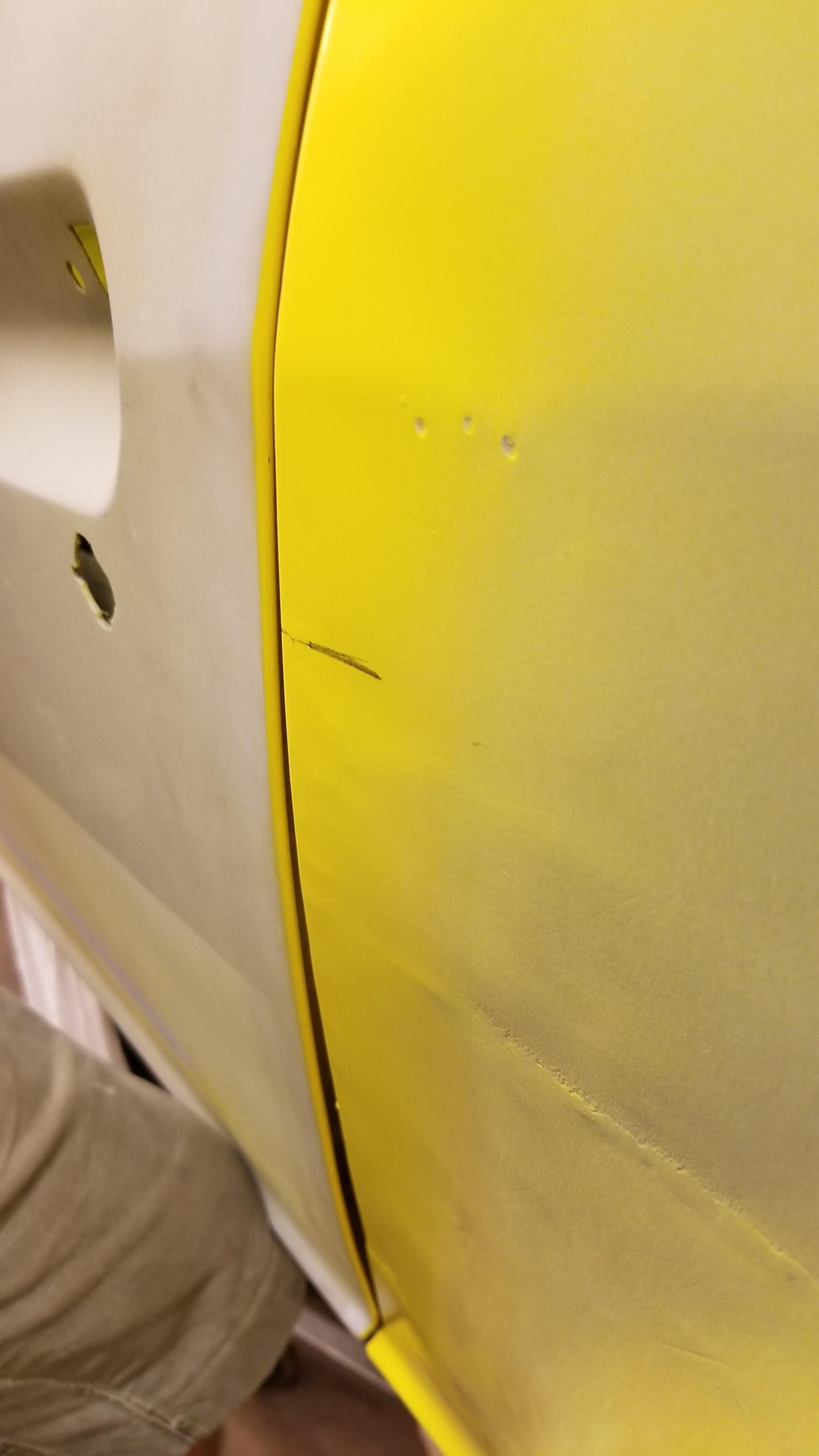

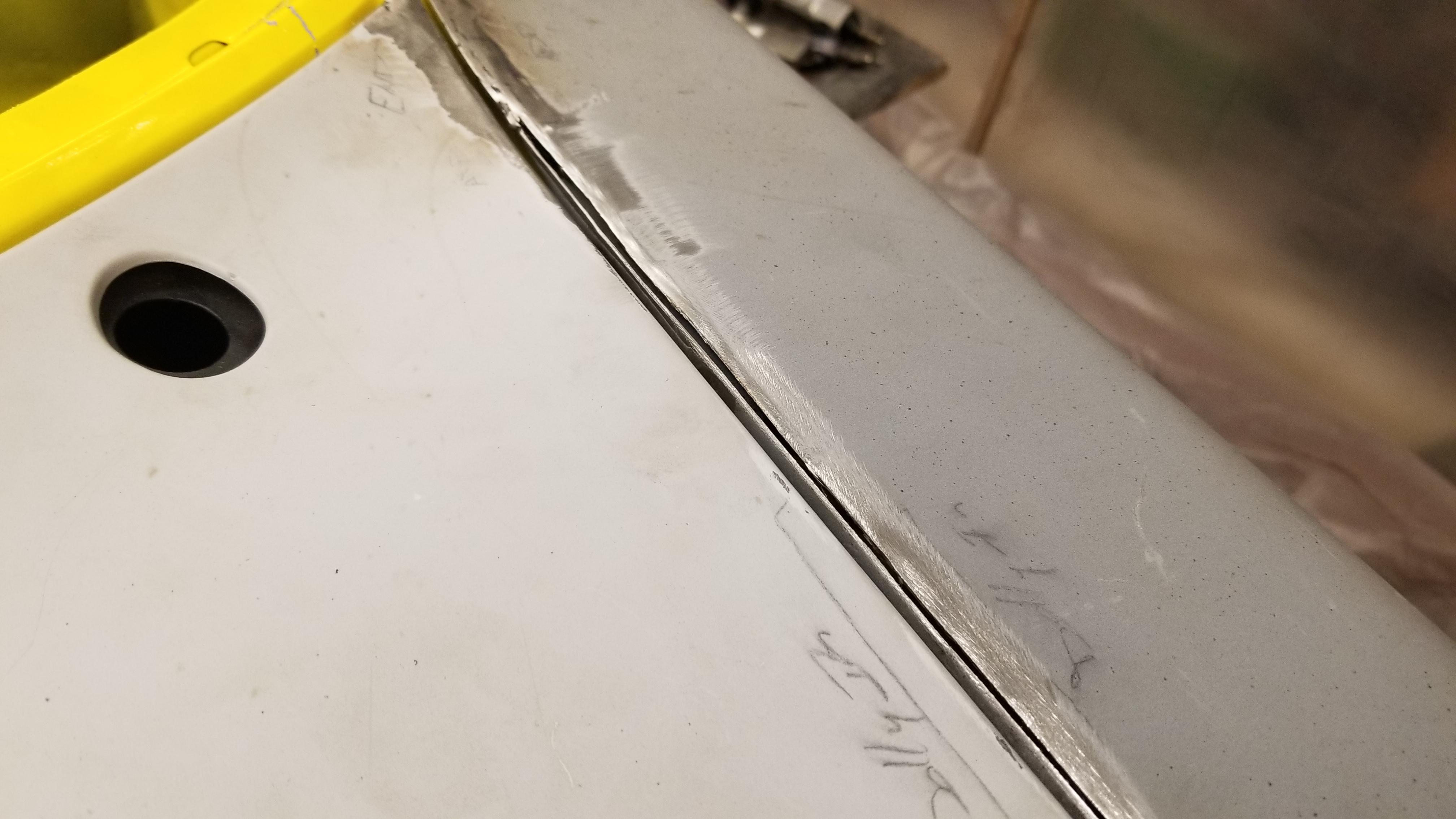

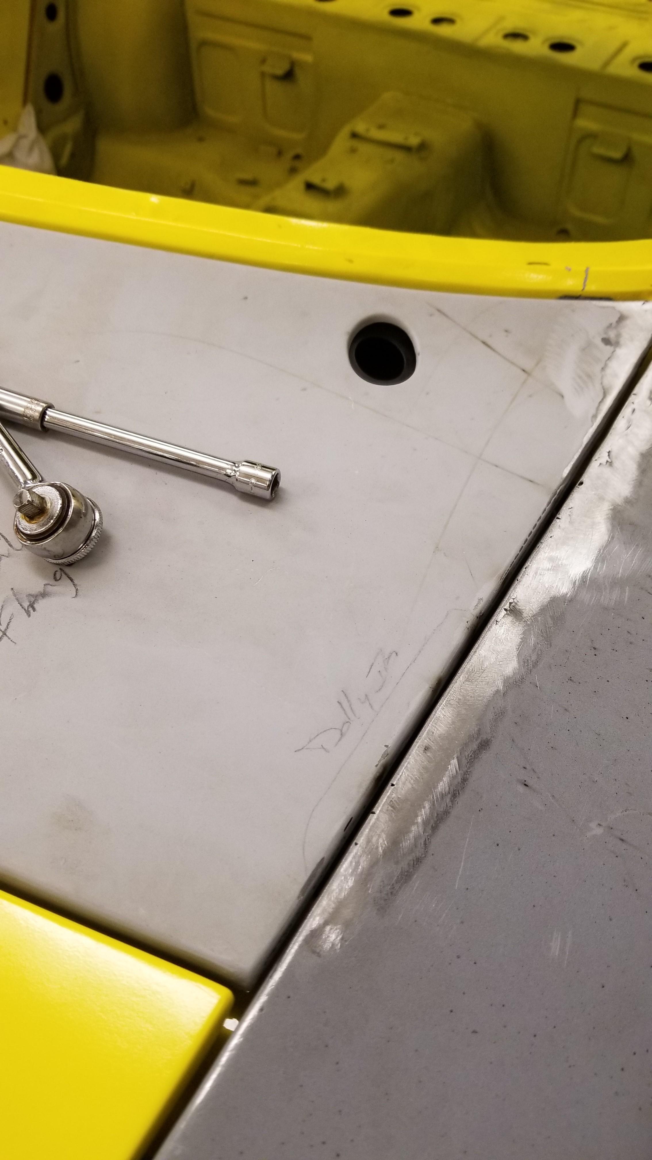

I ran into a problem with the fenders and cowl. the gaps weren't even and didn't run straight. So I added onto the edge of one side of the cowl and on the fenders I cut a slot in and made the panel flush with the cowl and welded it all back up

A little smear of fiberglass and some blocking and it aught to be good
This is the most assembled the car has been in NINE years! :wow:

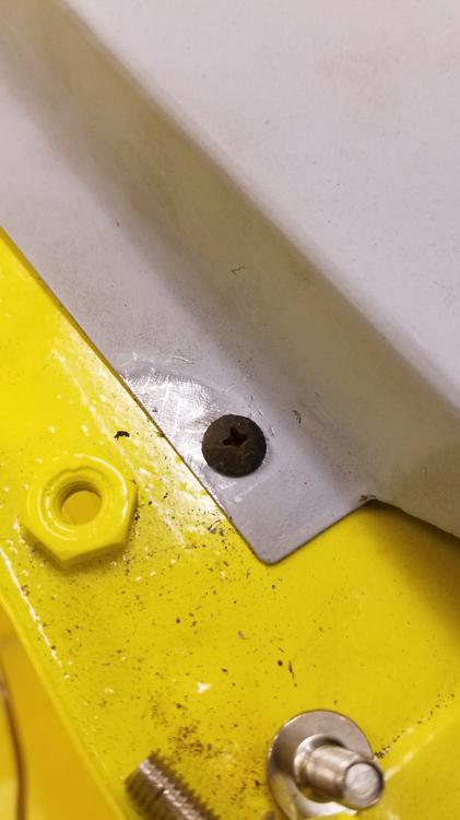

I was able to locate 4 cowl screws in my bolt boxes. What is the correct finish. Yellow zinc or clear?

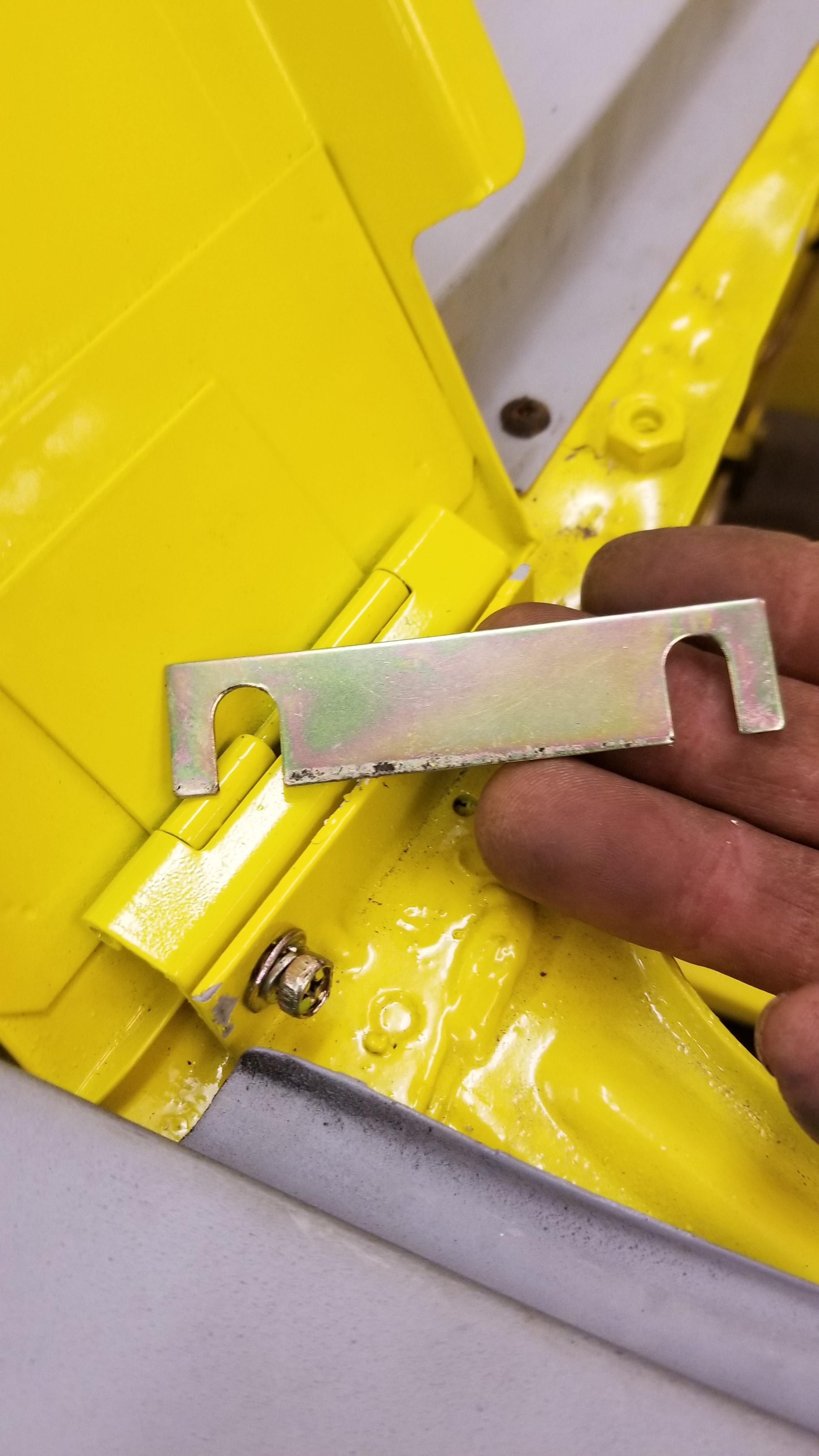

Also, does anybody have one of these inspection door shims. I have one on the car. I really need another or I could probably bent the bracket...

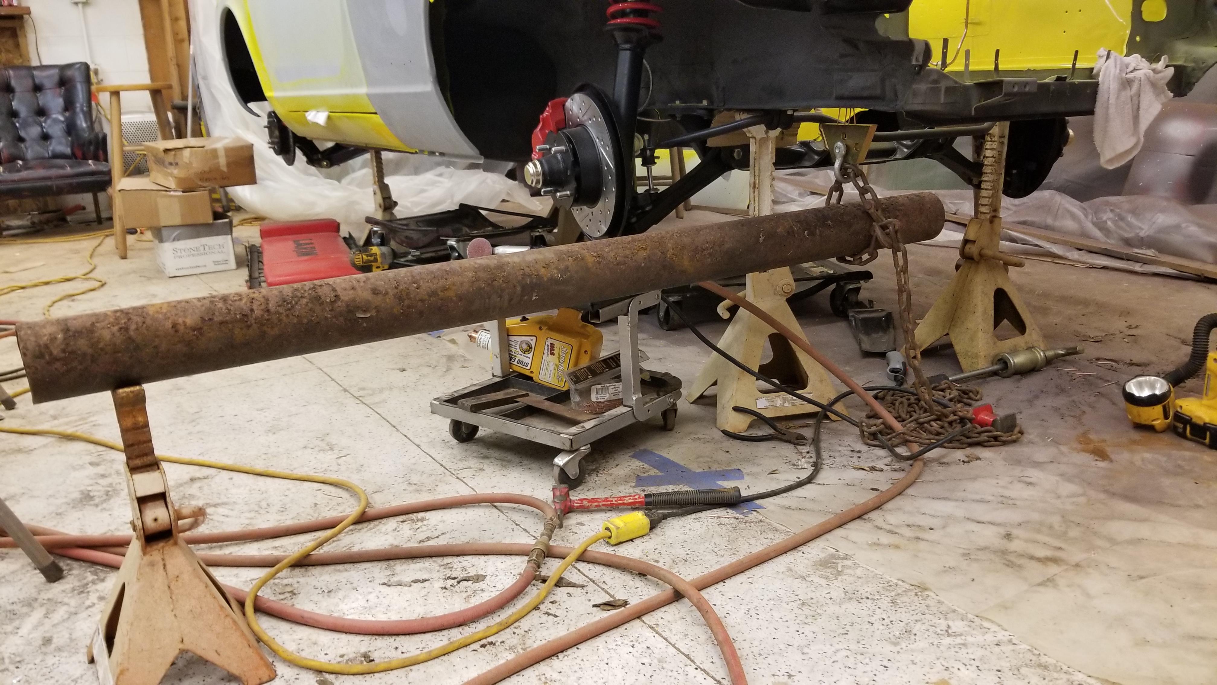

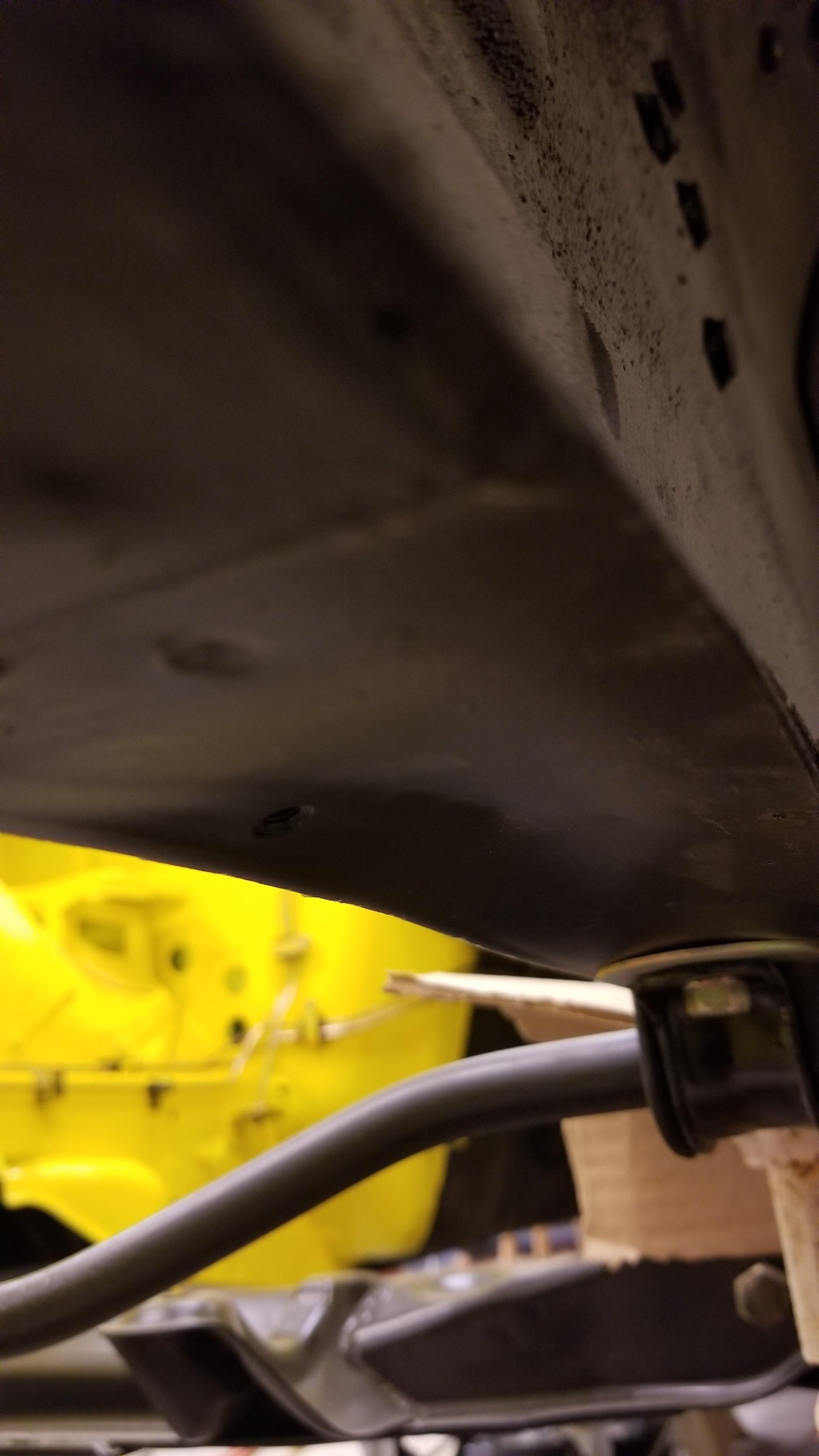

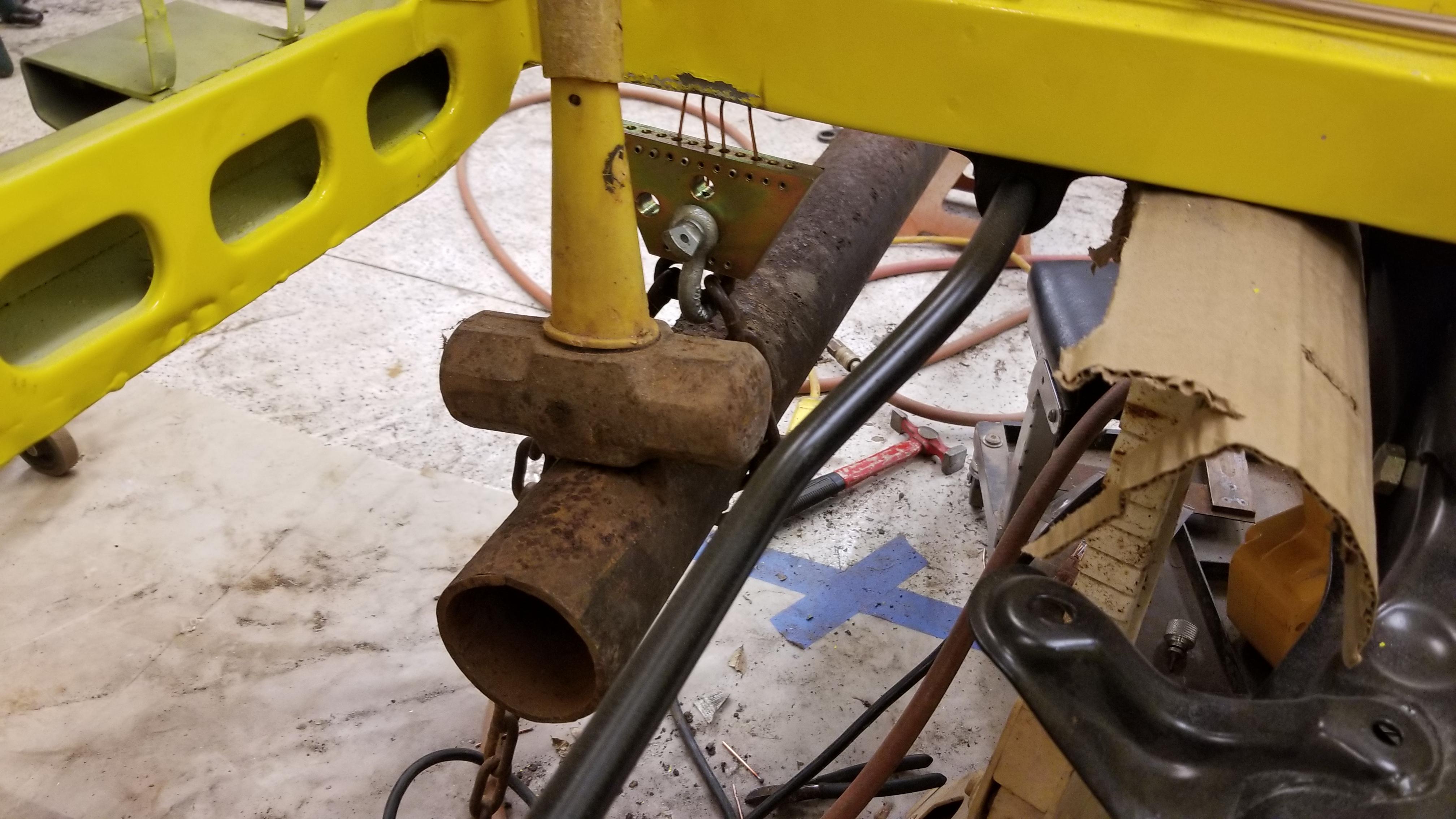

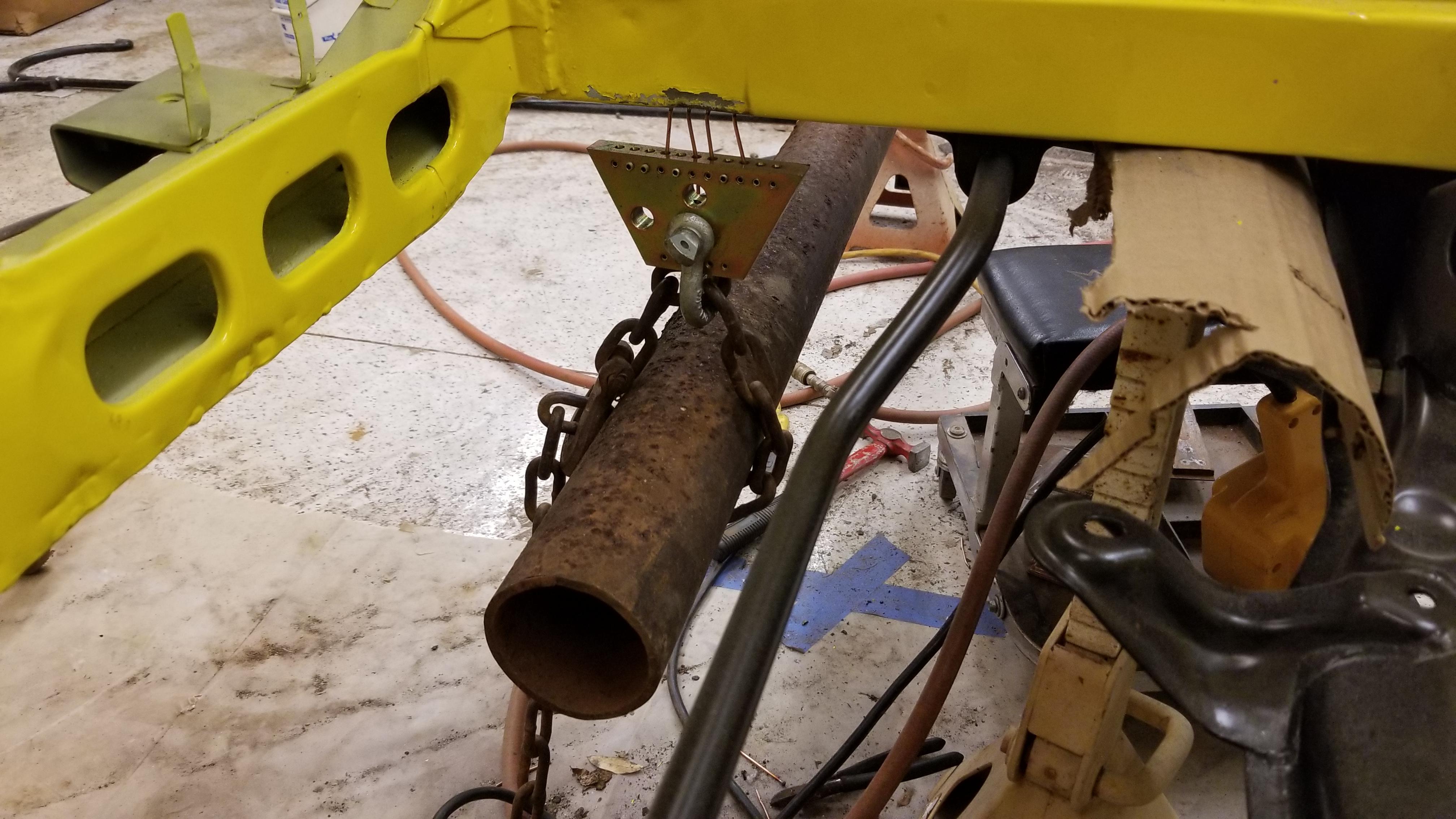

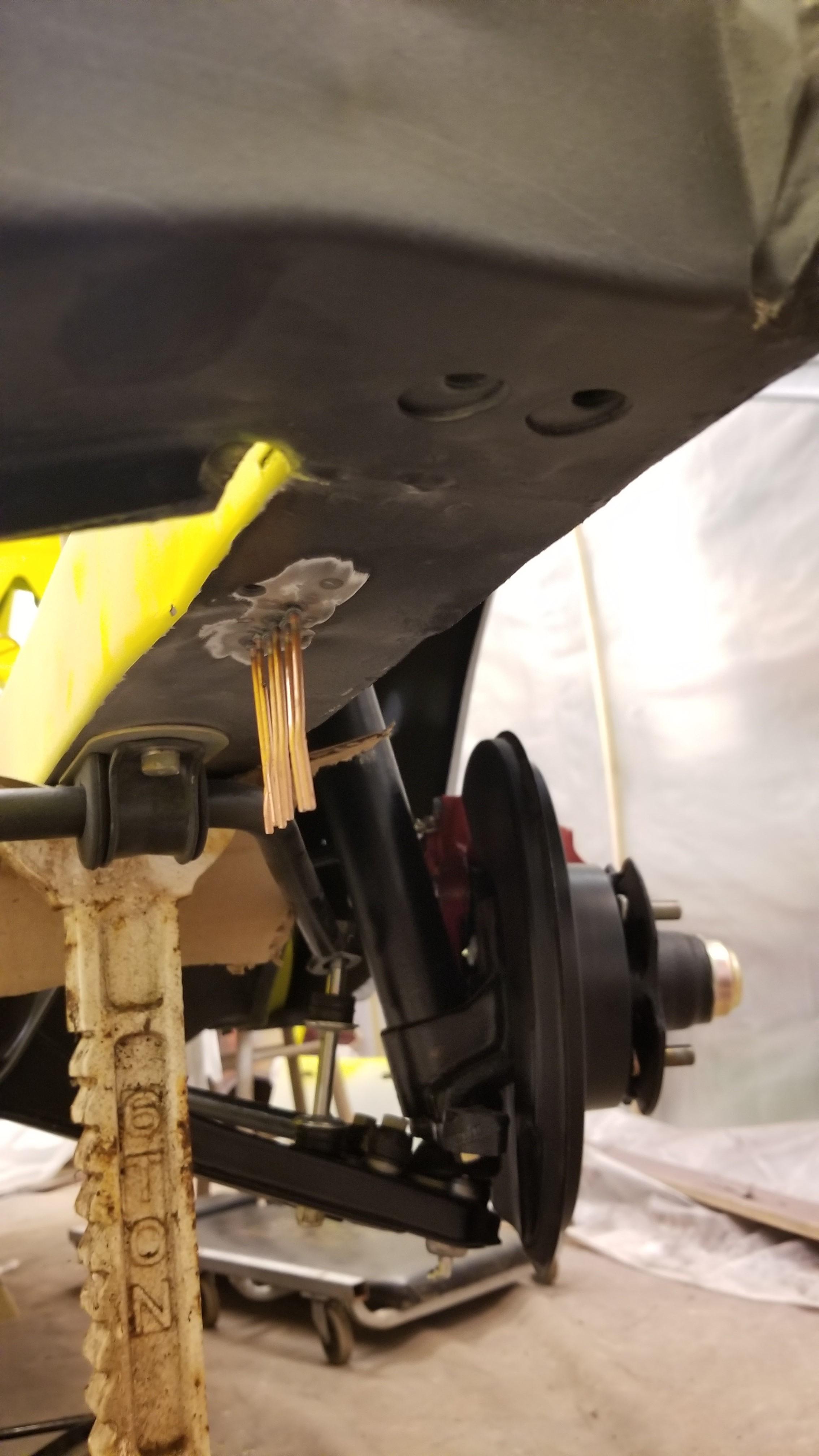

On another note, when removing the car from the rotisserie I dropped it about six inches onto the jack stands and dented the frame rails. Two steps forward ; one back
Ow. Ow. Ow.  That couldn't have been a good moment (looks like something I would do).  How well did the rail respond to the slide hammer?  Did you have to use any heat to get the metal to shift?
I came up with this. I believe there are a couple of layers of metal in the frame rail there. So a jack stand, a section of pipe, some chain and some studs welds and you get this
Add a big hammer
It worked pretty well but I will still dress them up a little bit with a thin layer of fiberglass

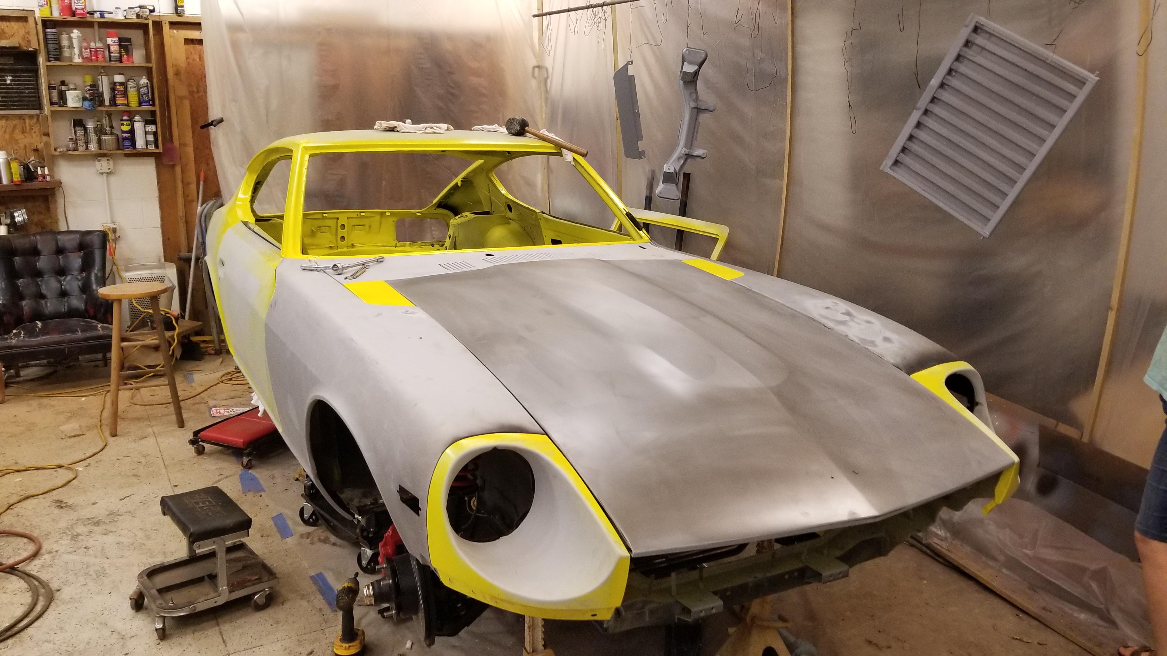

Worked on getting panel gaps right on the front panels some today. I think I got the hood pretty close. It sits just forward of the head light buckets, but they are pretty close. I also re-arched the hood using Jeff's method. It works good but be careful. It is easy to over arch the hood!

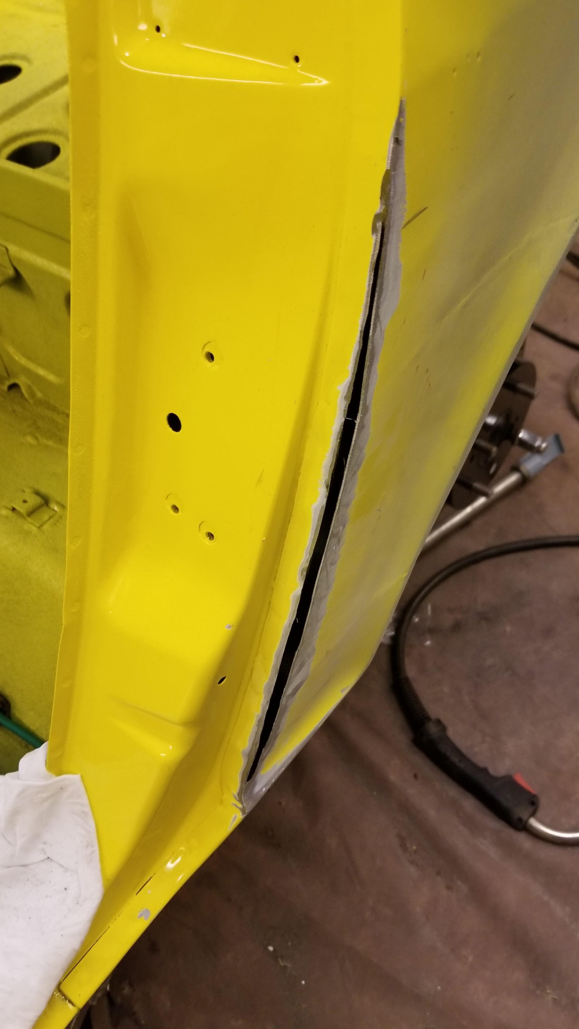

The cowl panel was sitting a little high compared to the fenders. I had crimped it when adjusting it. So out came the body saw and I added a slit. Got it flush and welded it back. As a word of caution it ended up too low after it cooled. I should have held it up just a hair to make it better when it cooled. I dollied it some and got it back to where it needed to be. I did both sides this way.

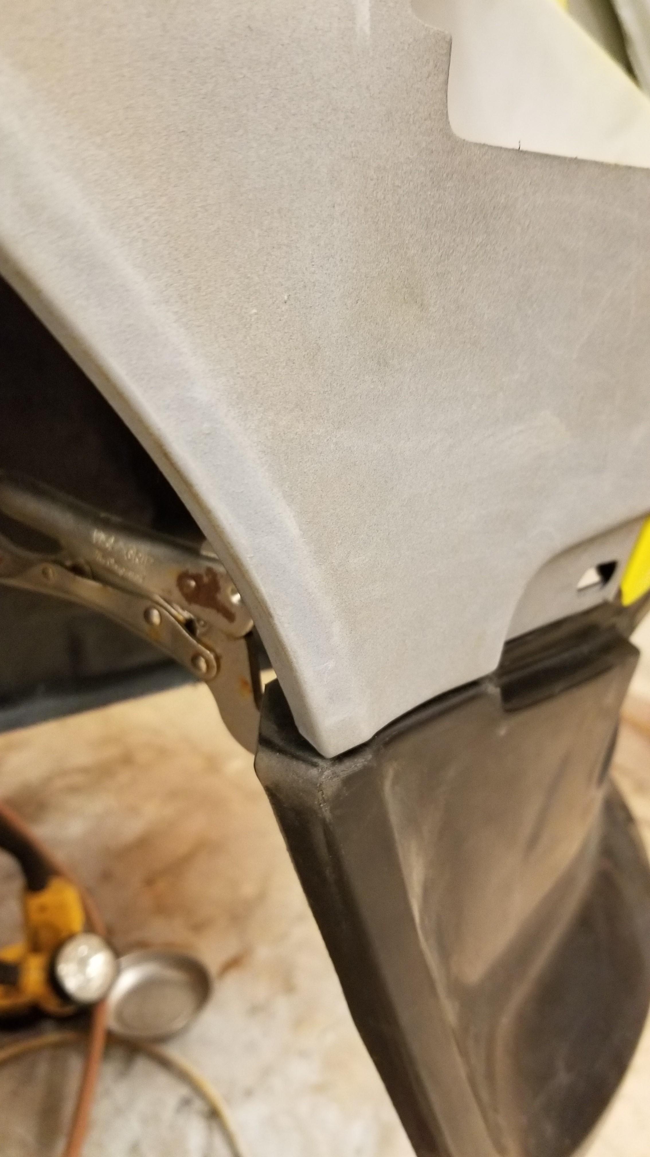

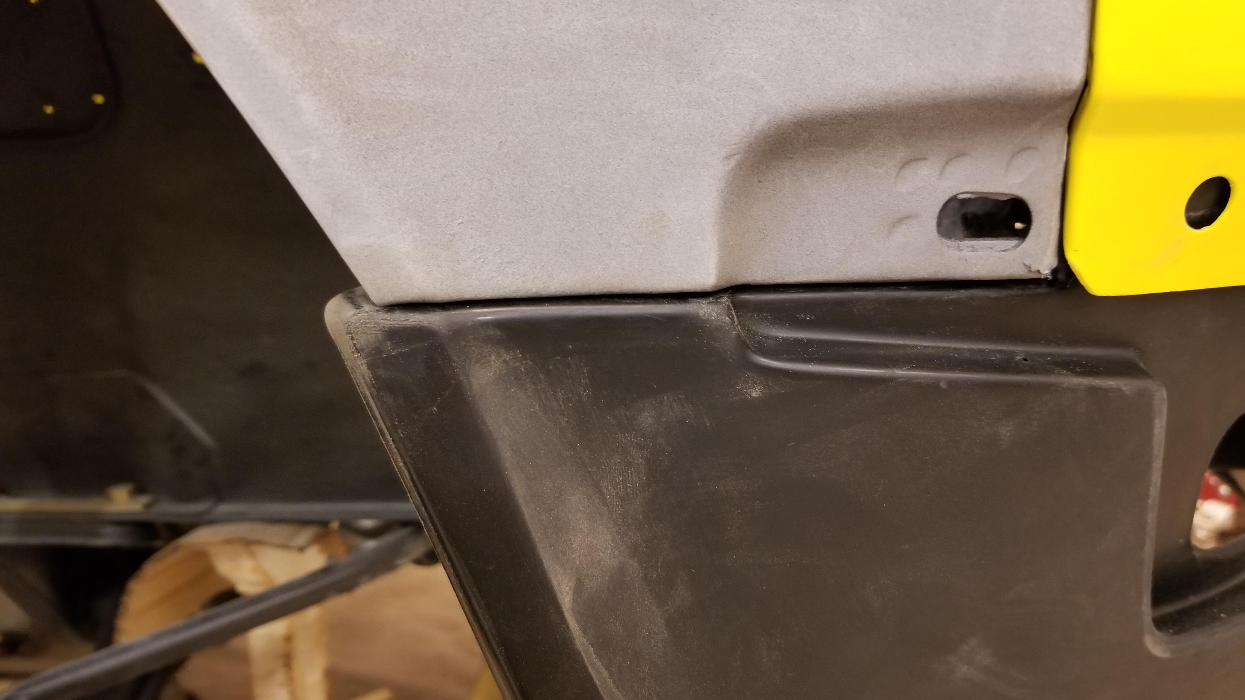

Also I hung the new air dam on the front. It's a Xenon urethane dam I have had for a while. I don't like the way it meets the front fenders. Has anyone else had this issue? How did you deal with it?
I pushed the air dam forward so the back edge lined up well with the wheel arch and with a die grinder removed enough of the urethane so the bumper recess lined up with body bumper recess.
I could also do that with the edge of the wheel arch where it's too wide. Good idea! Thanks Chris! :beer:
Where the air dam curves around the front at the turn signals, did you put the air dam on the inside or the outside of the sugar scoop? I have it on the inside currently...
