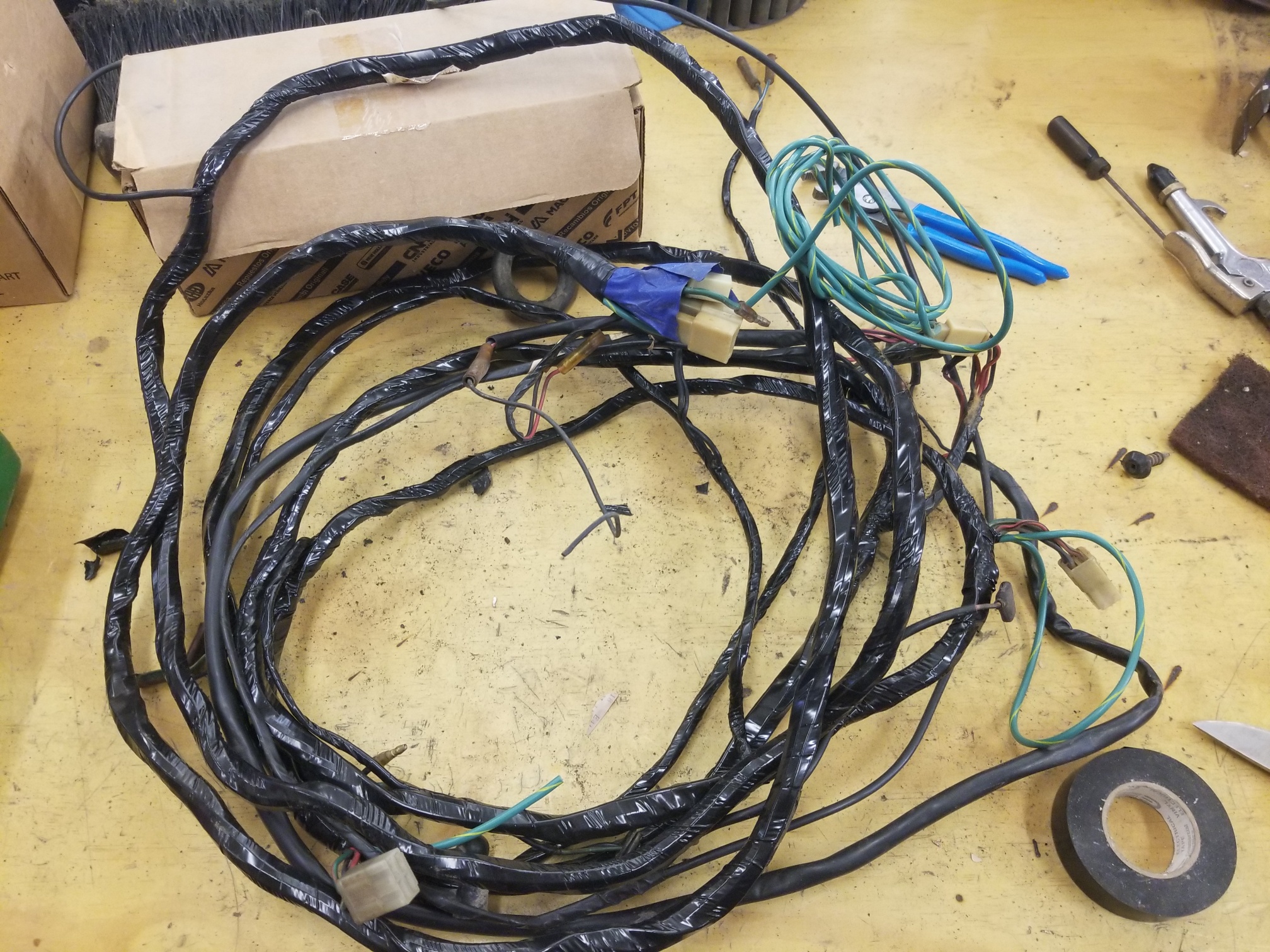

Today I started on the rear body harness

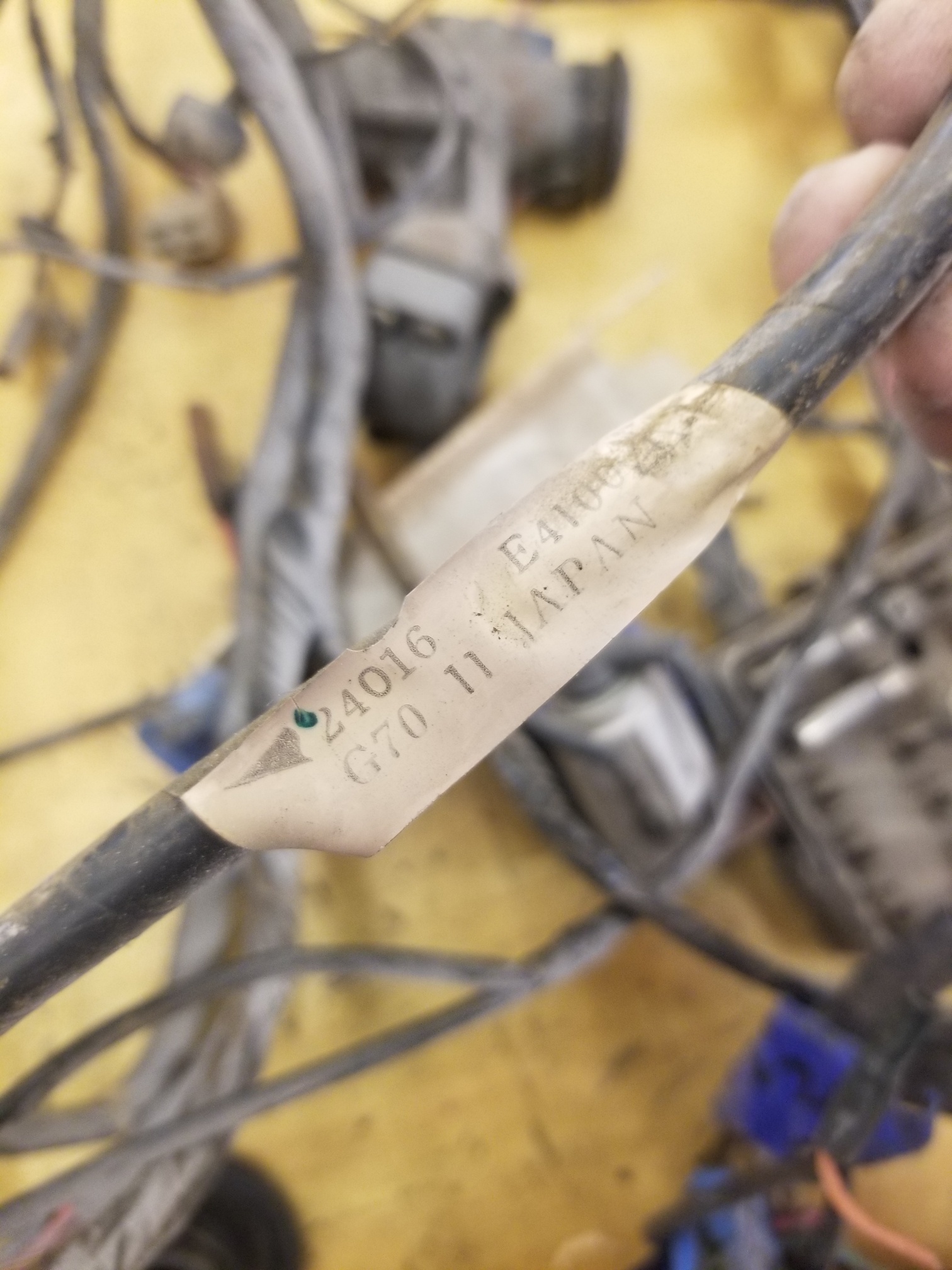

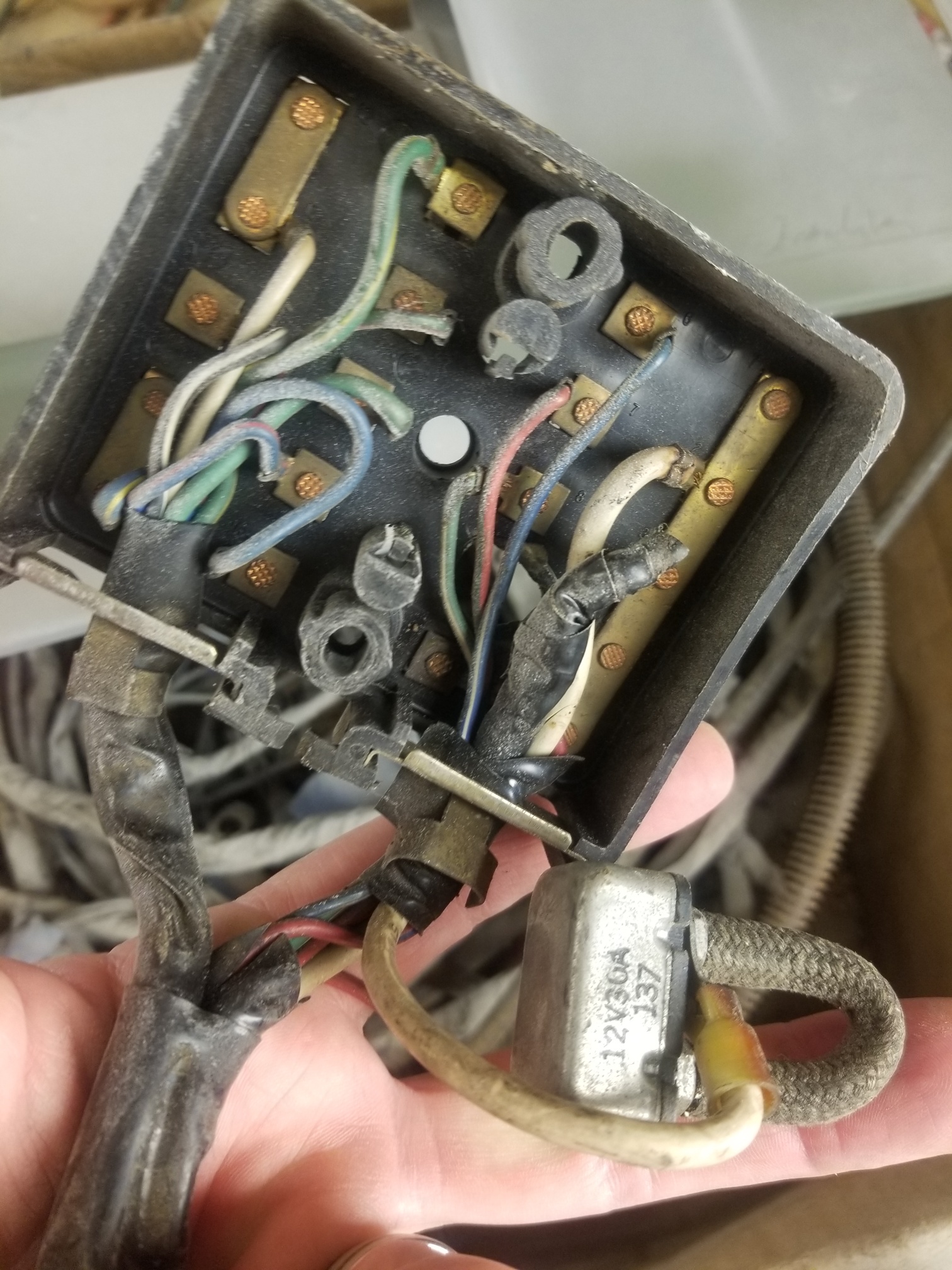

This is the fuse box that came out of the car...unfortunate

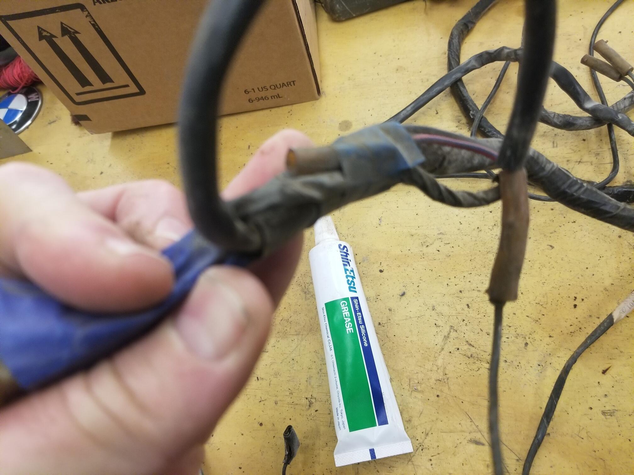

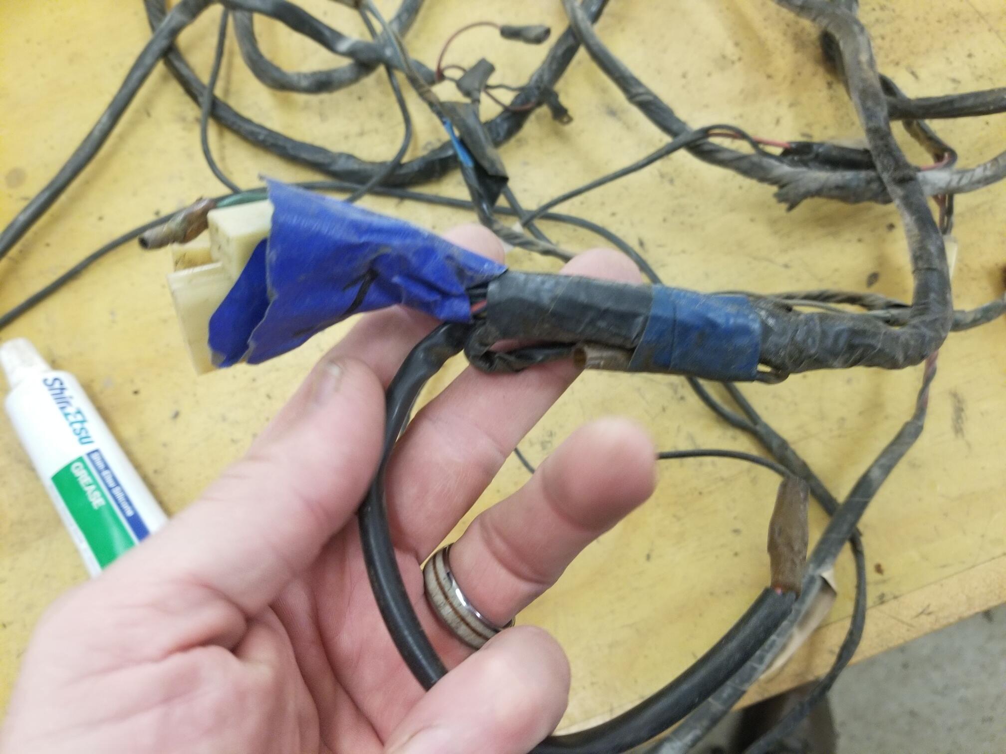

Fuel pump wires tied back with blue tape

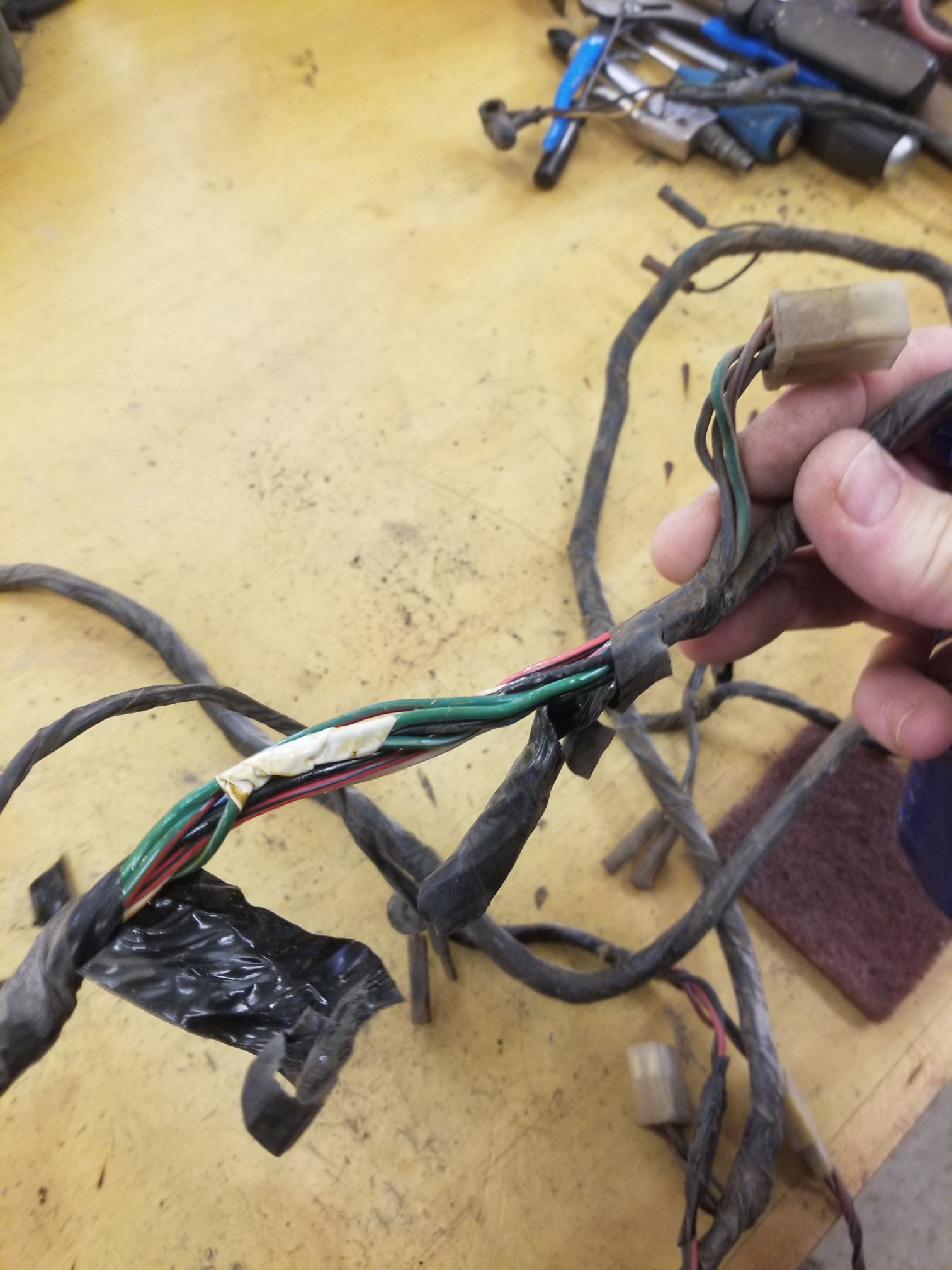

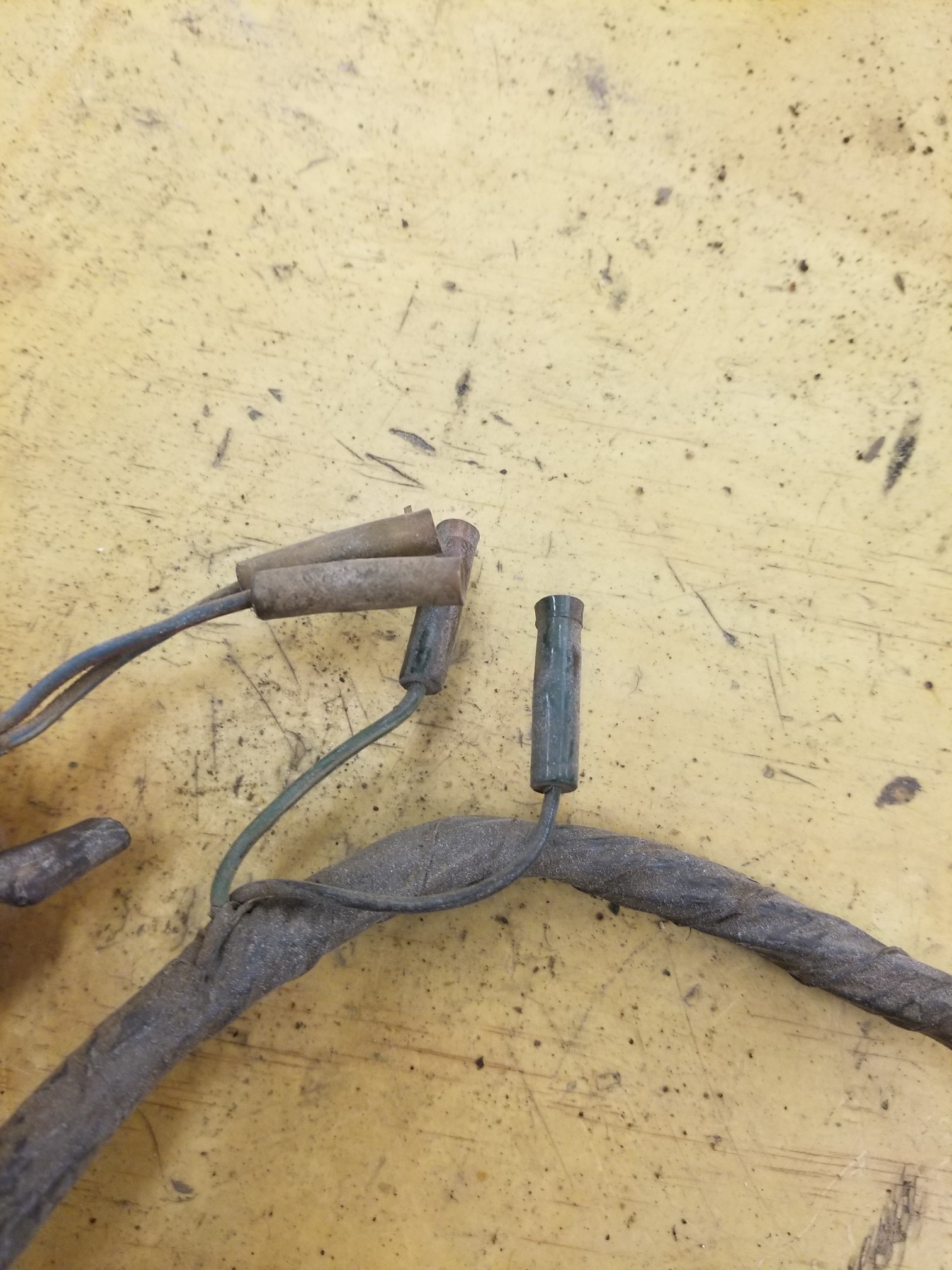

I believe this a junction in the harness

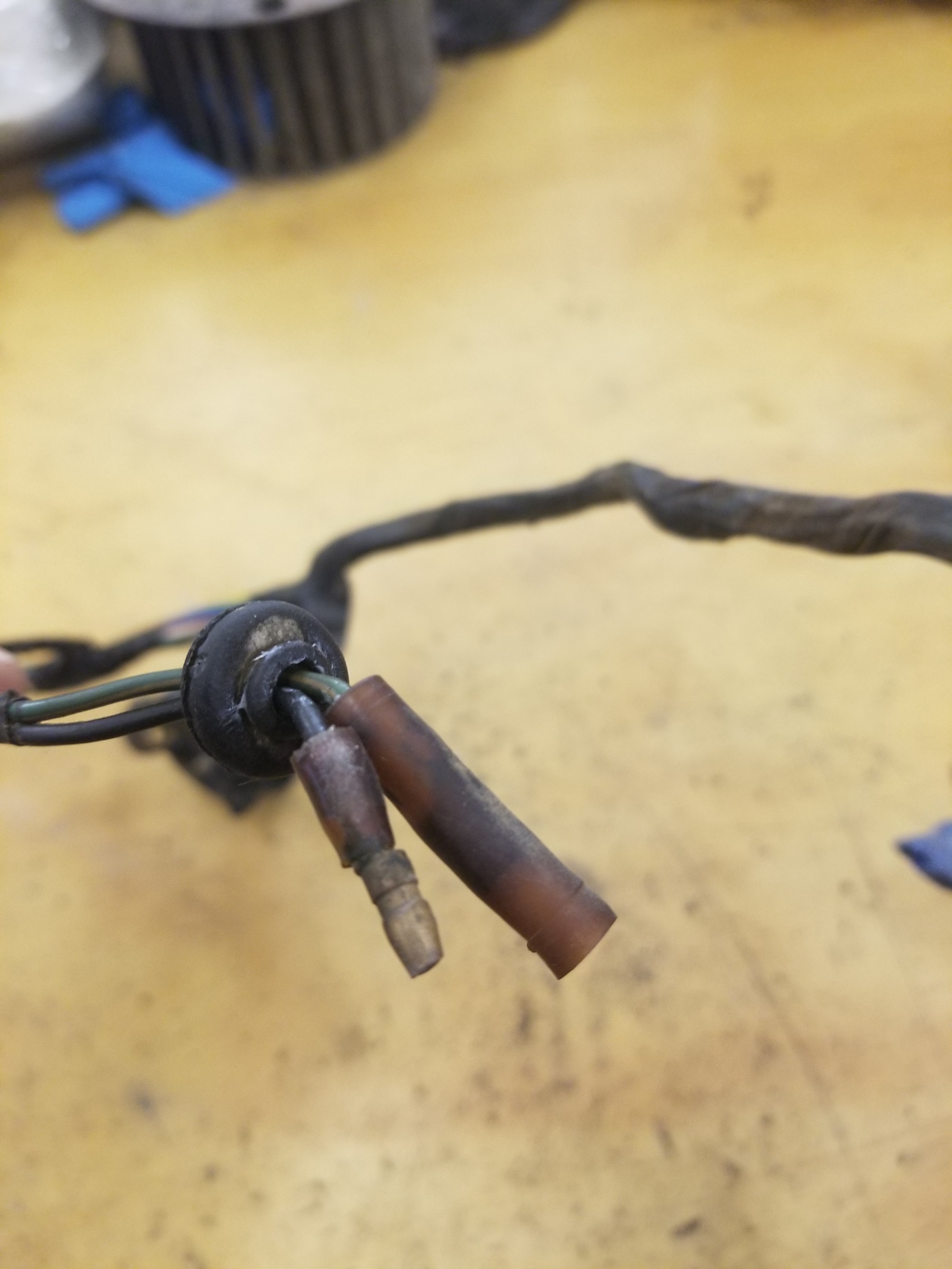

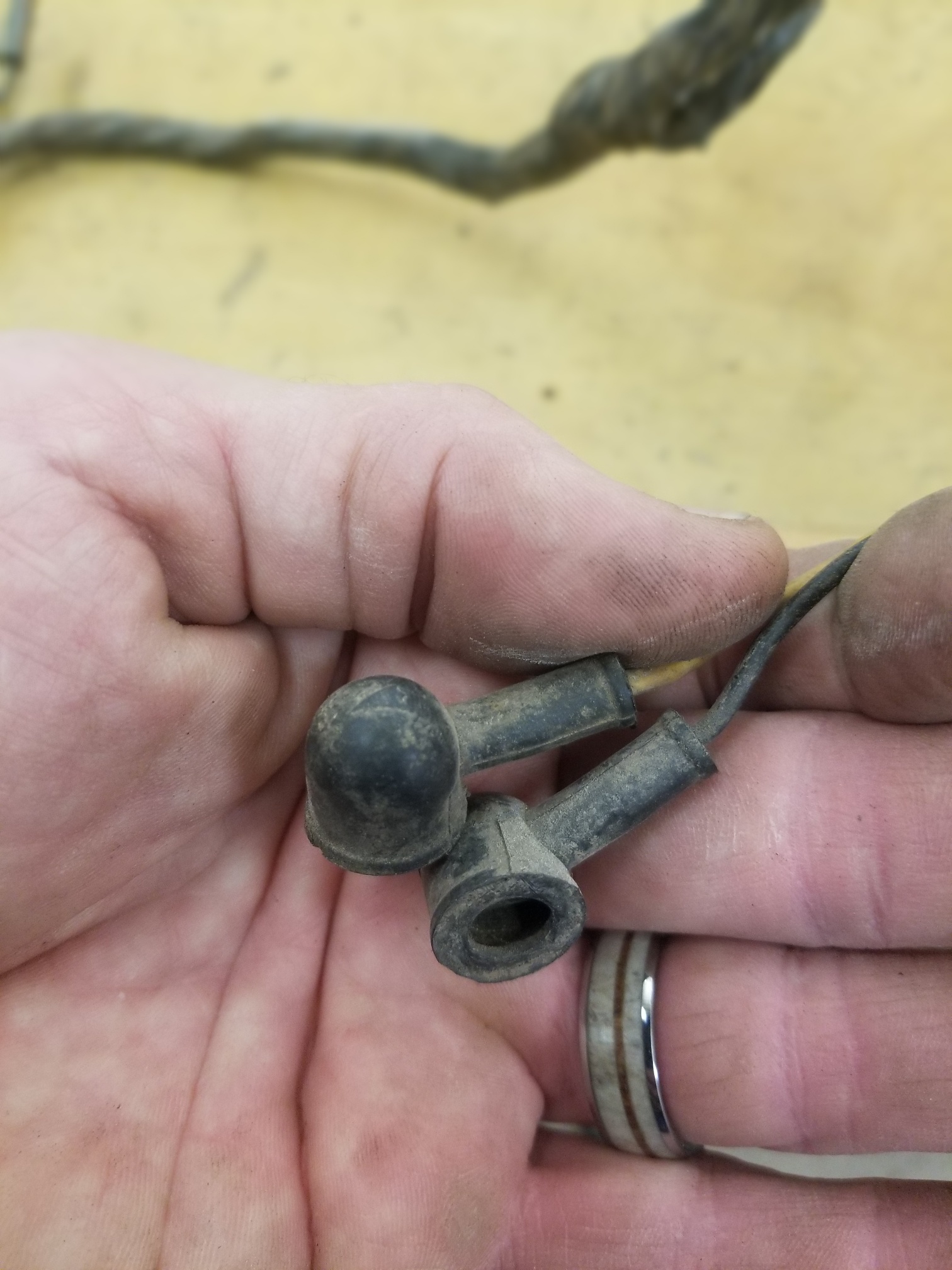

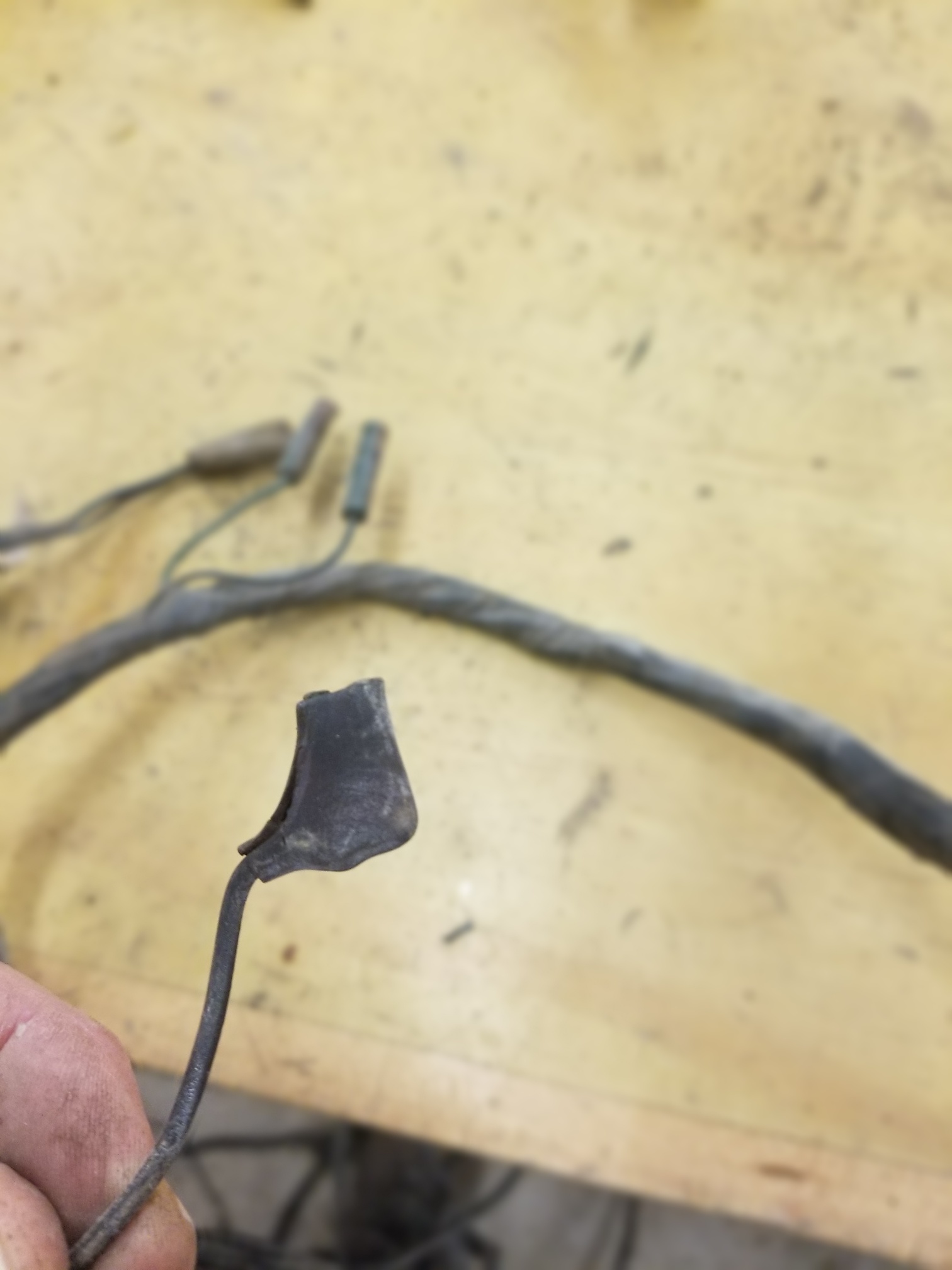

What do you do with all these insulators? They are all rock hard. Do you just replace all the terminals??
@SteveJ
Edited by Patcon
I've used mineral spirits to soften the rubber and wintergreen oil to keep the rubber soft. However, I just googled "rubber softener" and found that many are using silicone spray. Soak the rubber piece in silicone spray (it contains a plasticizer), seal it in a baggy for 3 - 7 days and voila, refreshed rubber. It's worth a try.
I have boiled parts in water with some wintergreen oil. I had so so results. Better but not super pliable.
I am open to ideas. It would be nice to find a way to soften up some of these pieces so I didn't have to replace them all.
  • Agree 1

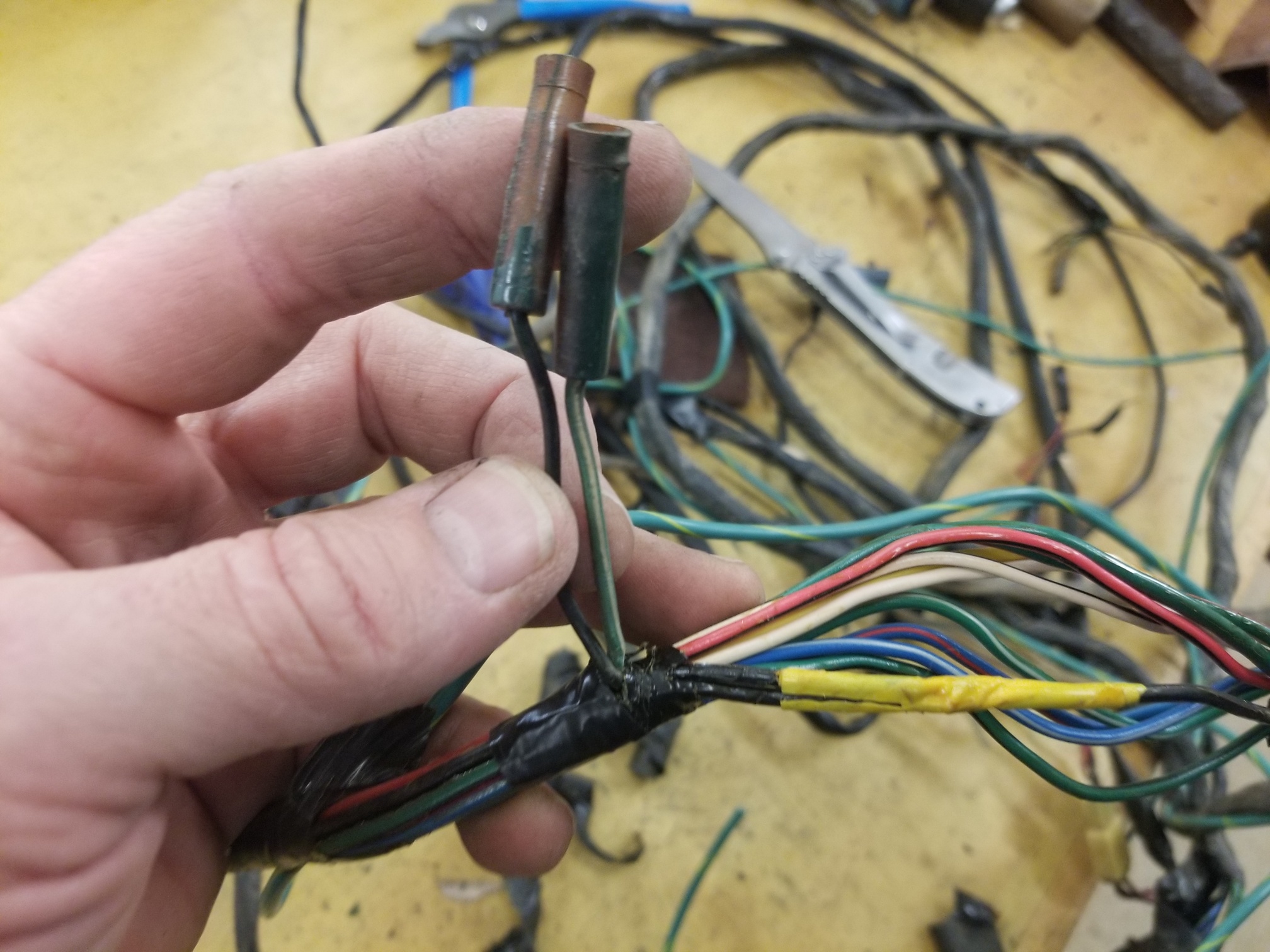

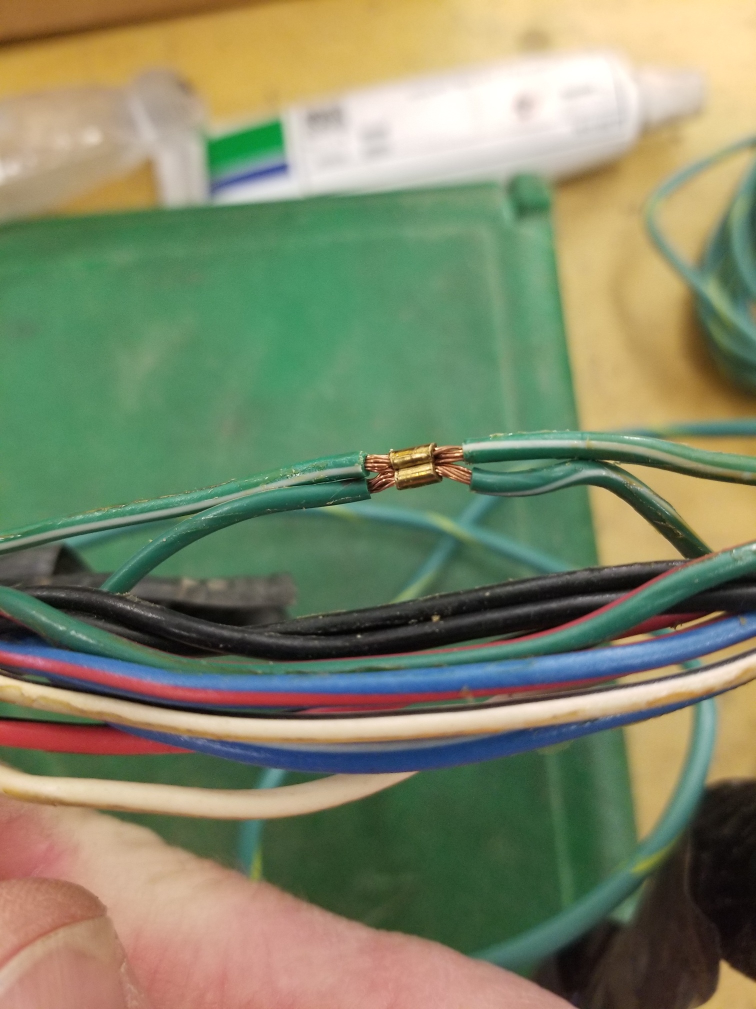

There are lots of crimp splices in the rear body harness
Everywhere there is a crimp they wrapped it with a little yellow electrical tape

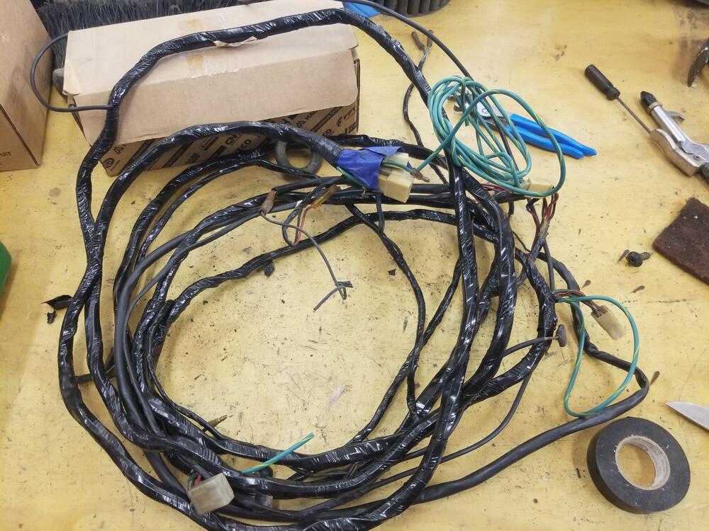

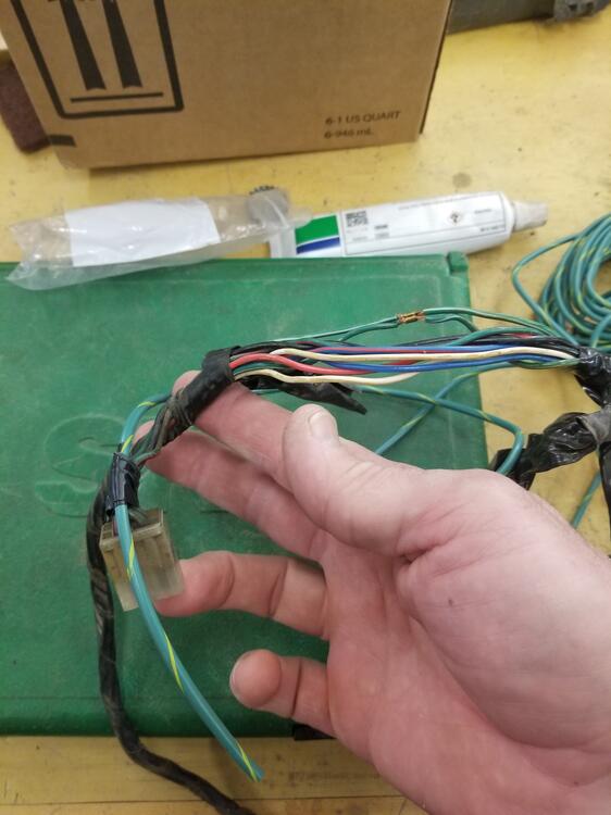

Harness all rewrapped with an extra green for the Euro tail light set up

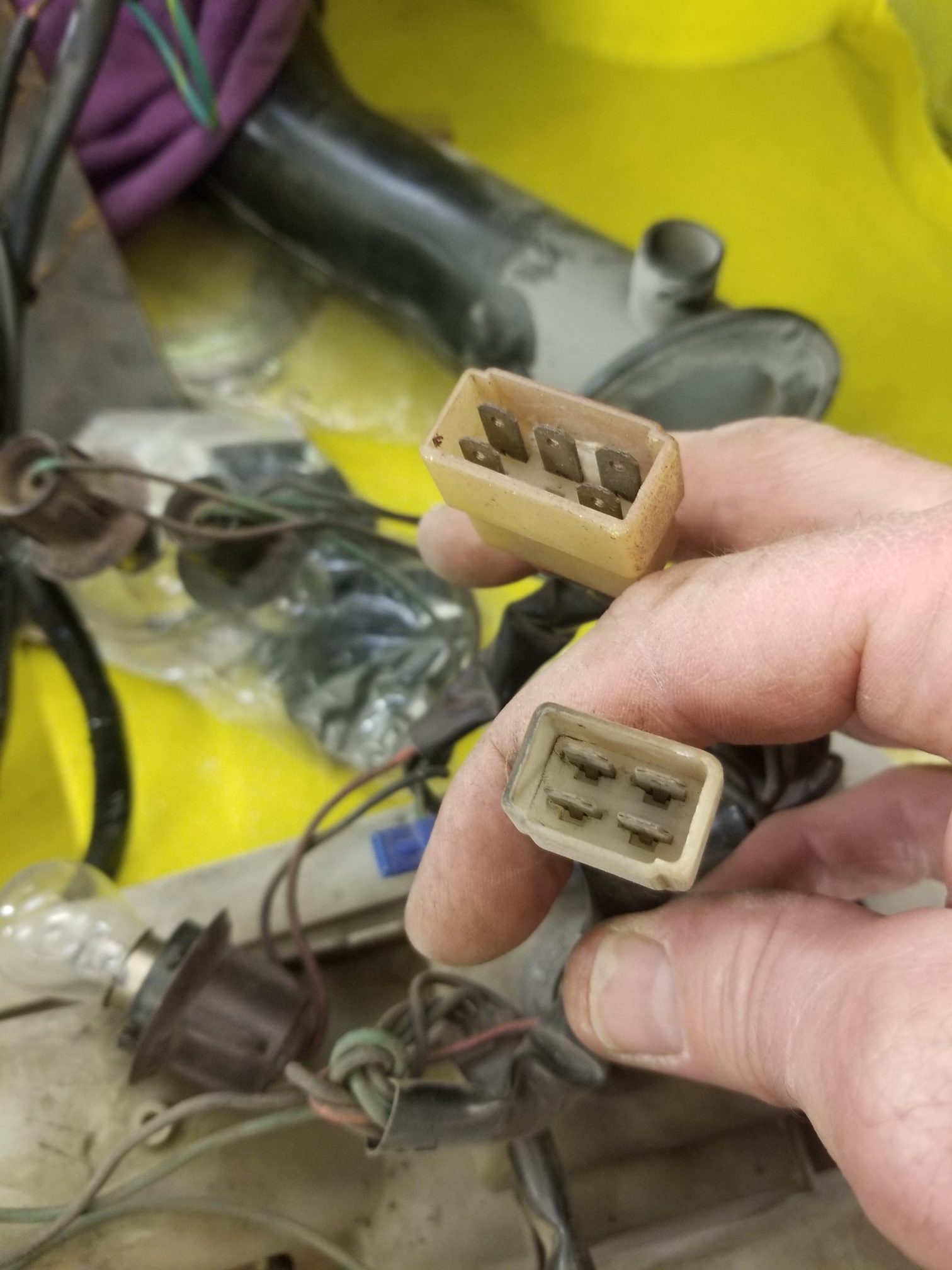

As a side note the lamp harnesses have different plugs US to JDM. The JDM has a six wire plug with 5 wires in it.
