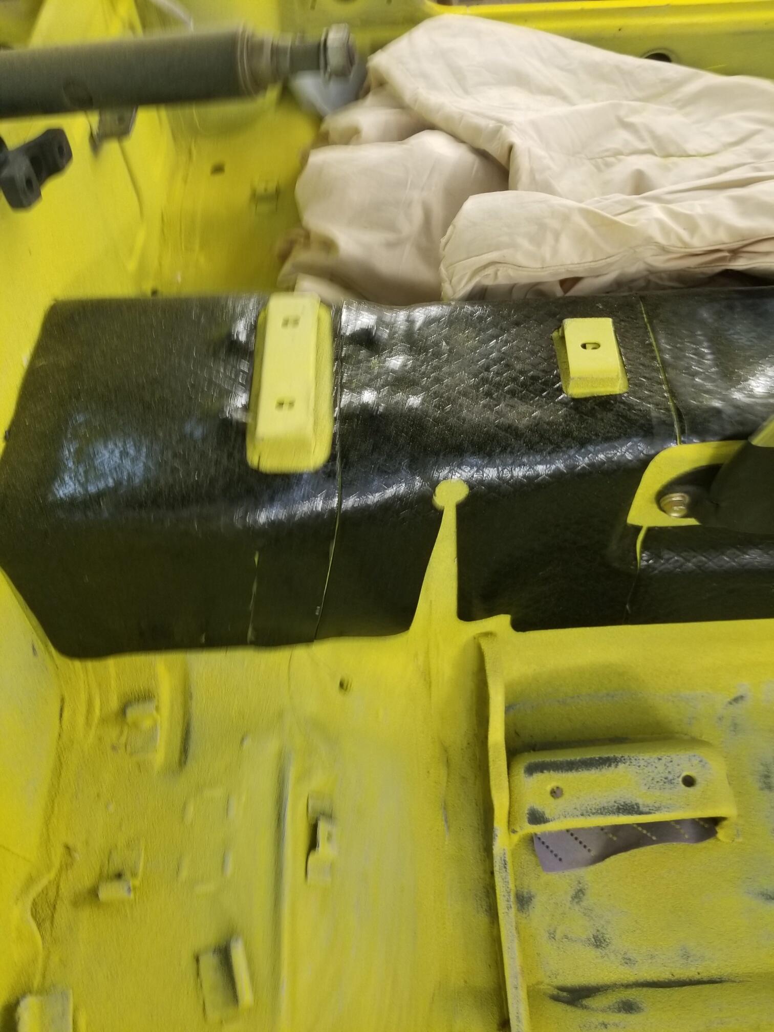

So I worked on tar mat some. I used the Wurth tar mat @Zup recommended in another thread. One box is just enough to do the tunnel. I will have to get some more later for the floor boards and hatch floor.
The patterns I used are in the resource area
Here is  the rear pattern over the mat. I layed the mat out and used some clear tape to seam them together. Then I used a few pieces to tack the pattern down.
I used this ruler that has a brass edge to help on the long straight cuts. Everything else was freehanded
All cut out
This is installed. I have that roller tool to get it stuck down properly. The film on top has been peeled since then. I didn't take any pictures of that

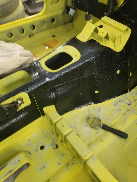

This is the larger front piece
I had to scrap out some areas on this. If I were going to do this again, I would be more selective on where I used the scrap. My scrapped out section was near the top edge of the tunnel and that made it difficult to hold together on install.
I used a blue tape line to mark the overlap point

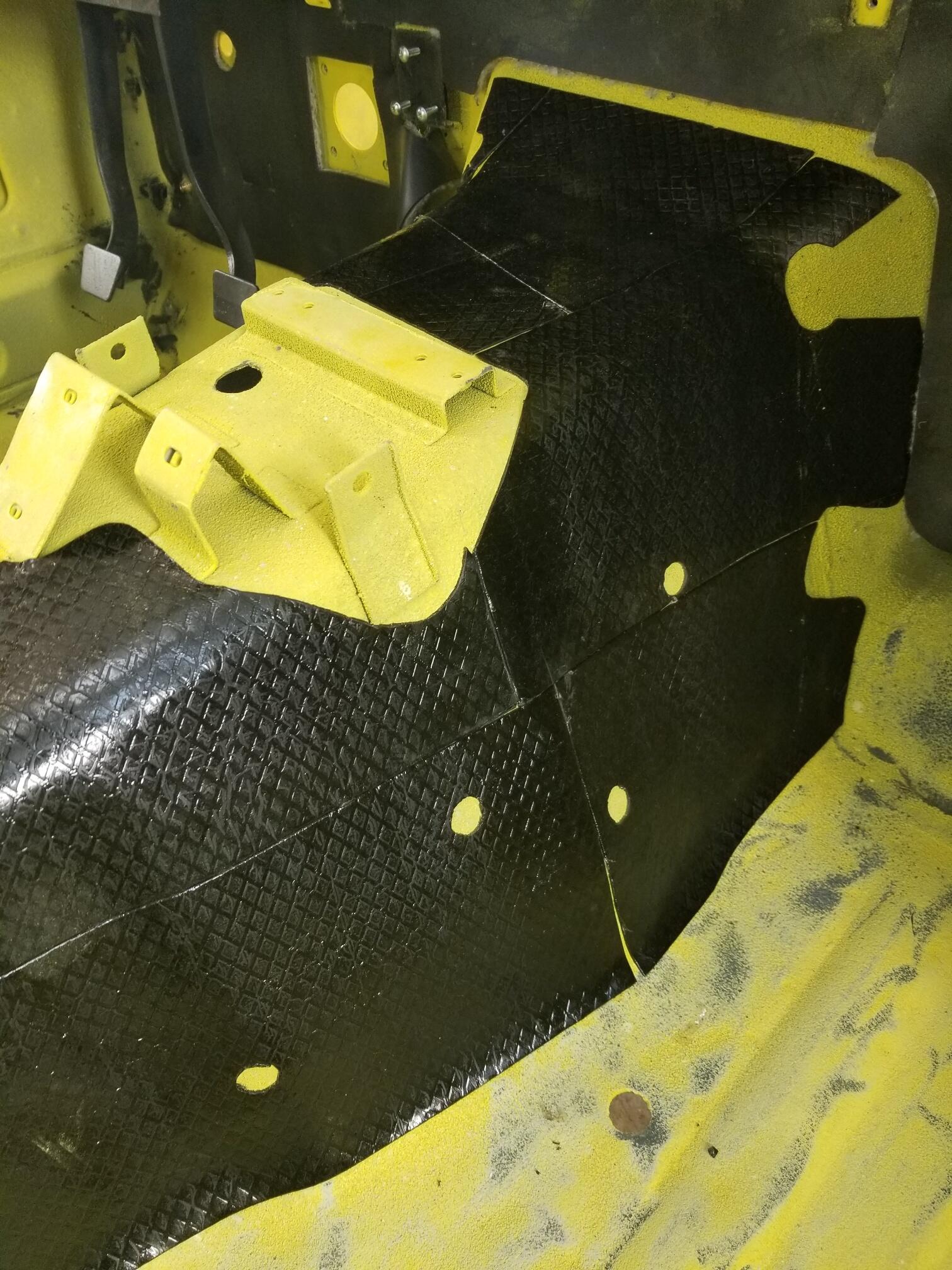

I made a little progress today
Here is what the tar mat looks like all peeled

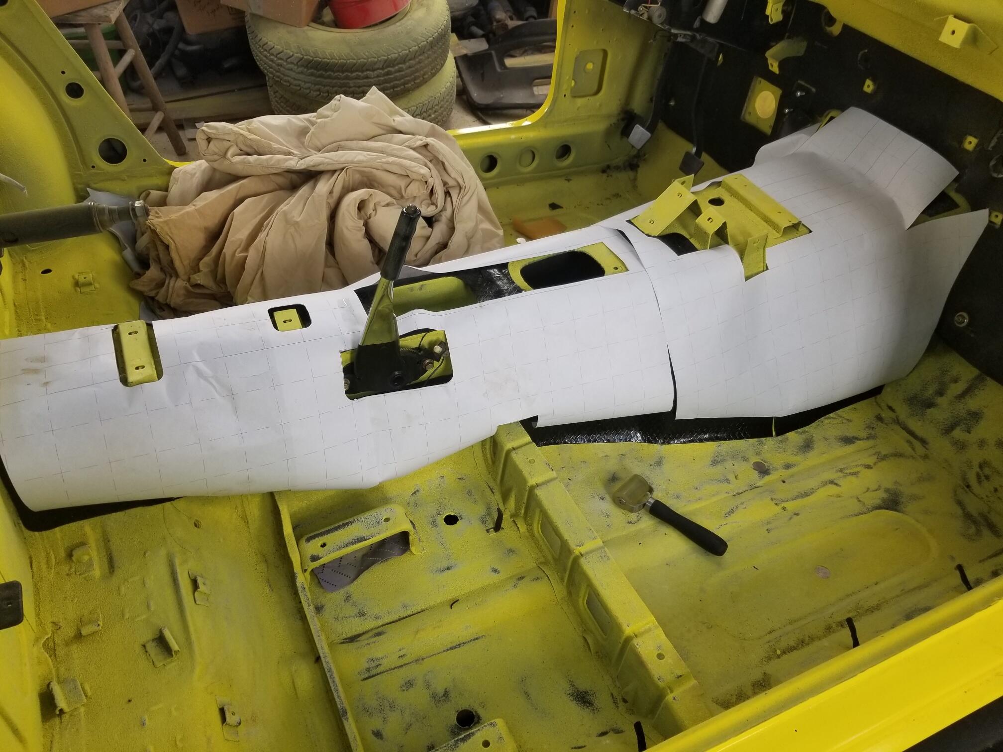

Here are my templates for the tunnel jute

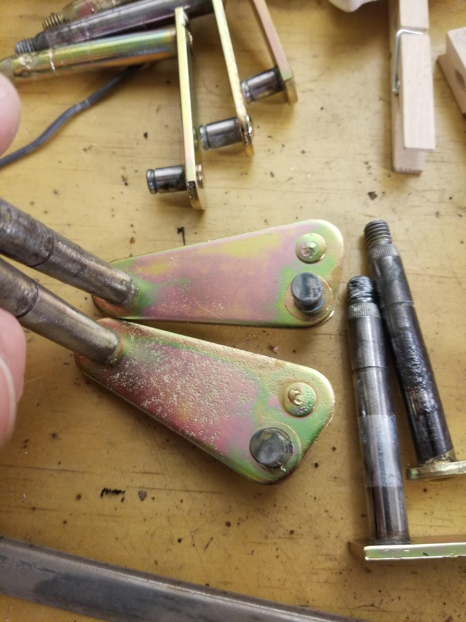

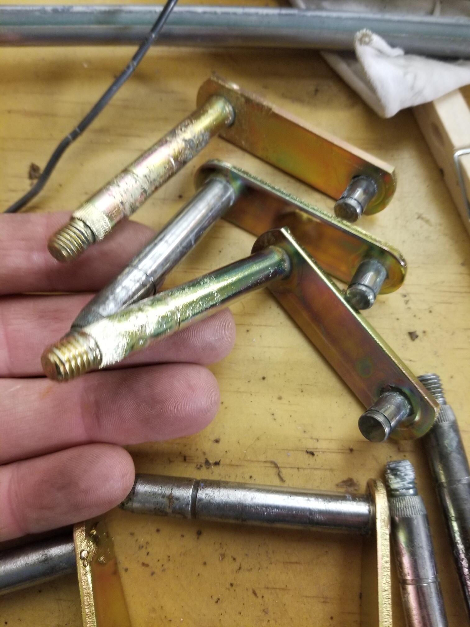

I also did a little plating on some wiper parts

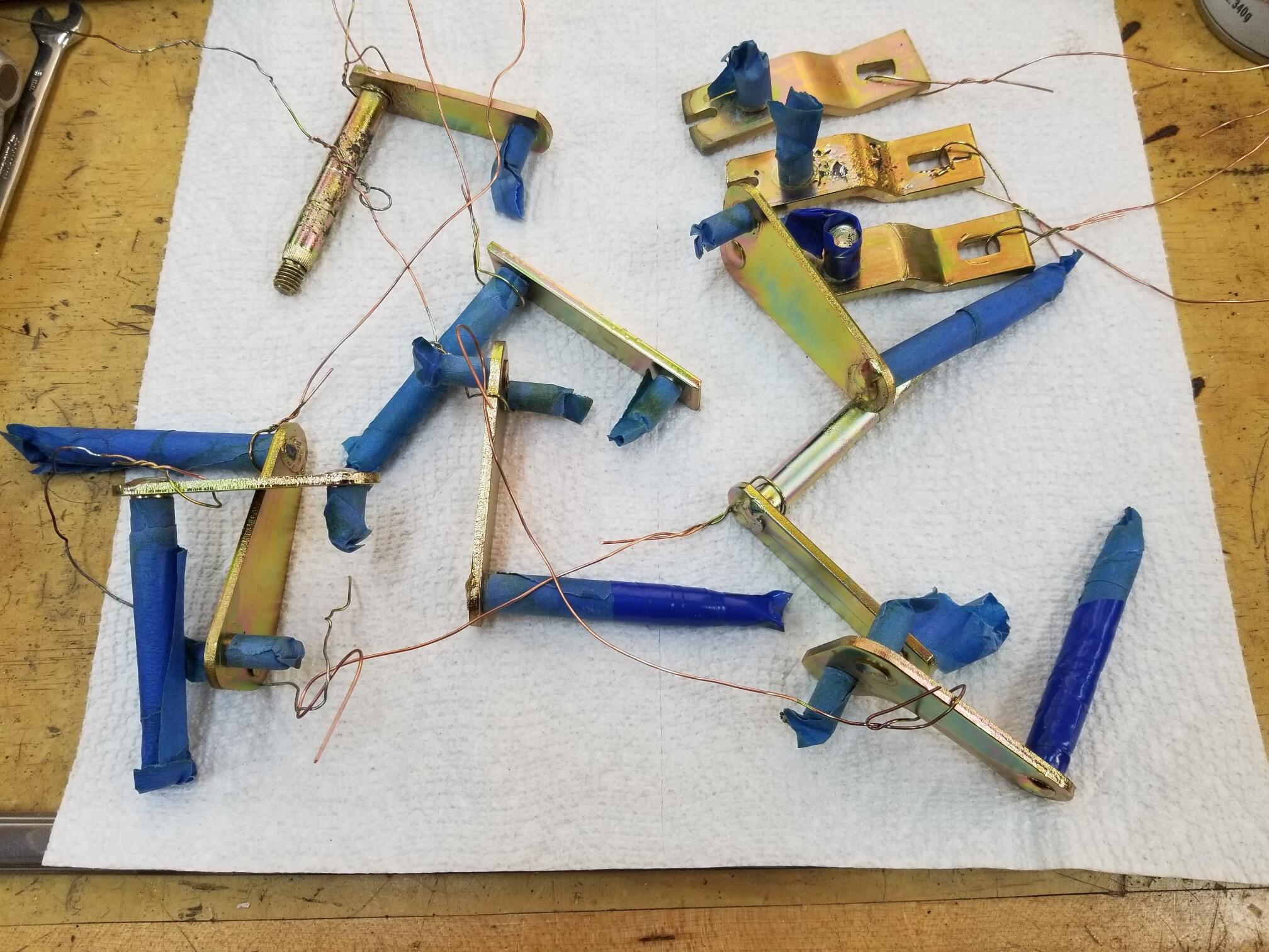

Here is the plating from yesterday

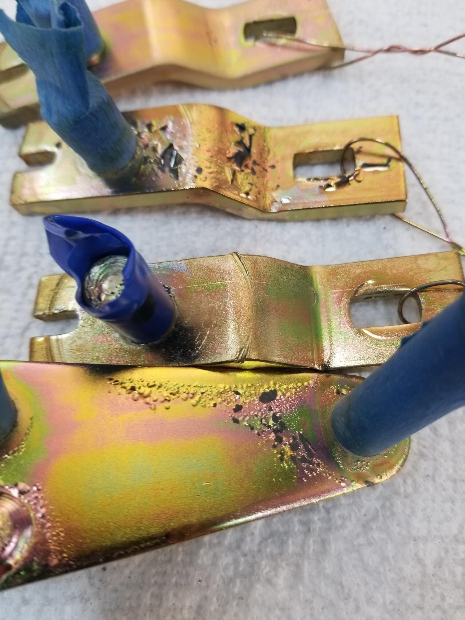

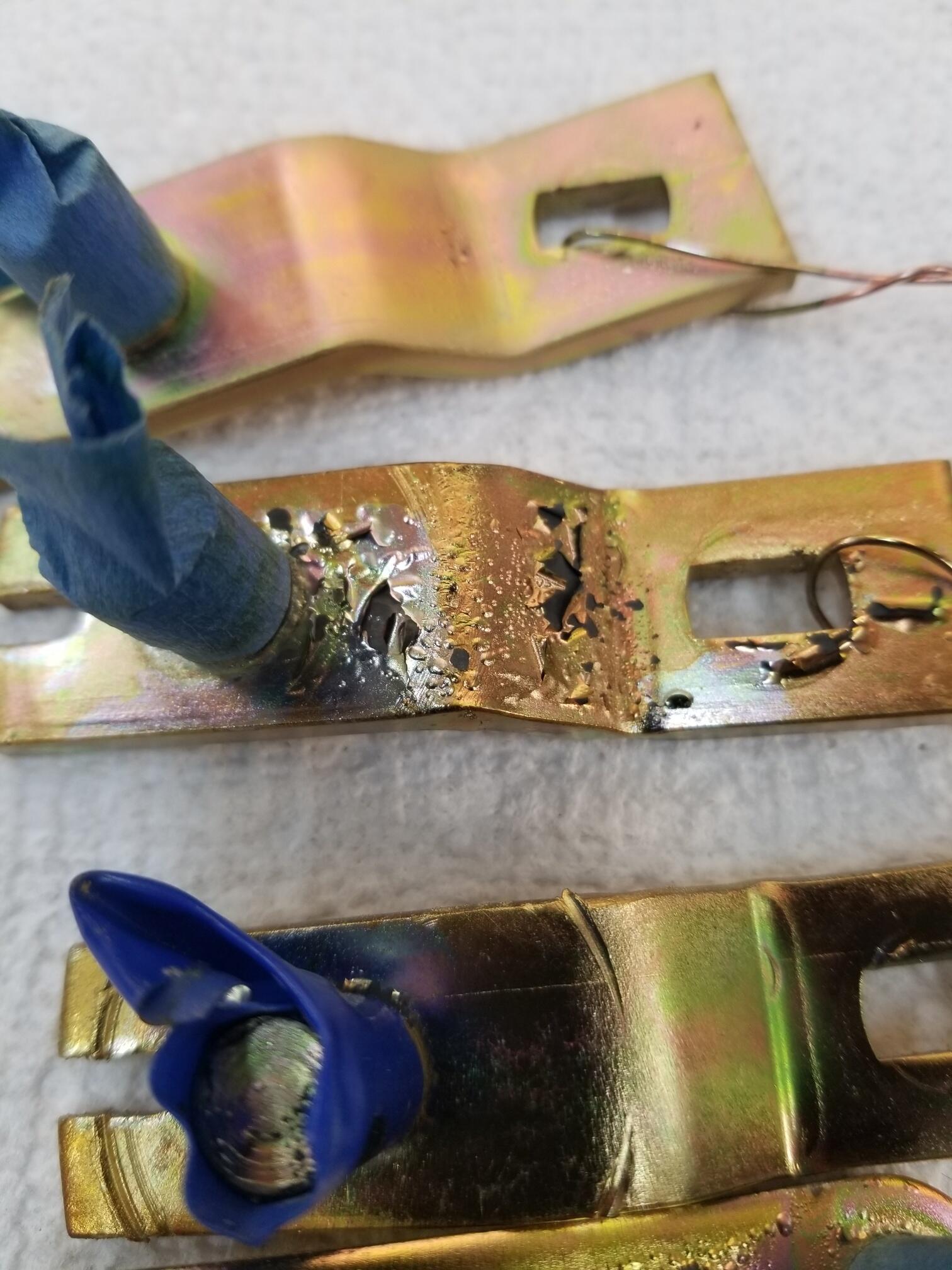

Wiper arms. I plated these myself because I had to wrap the chromed sections and I figure that was easier for me to do in house. It's always a challenge to get the tanks up and running when they've been sitting for a while
These first few items blistered really badly. They didn't look this way until after 24 hours.
I will blast them and replate later
The later items seemed to have worked ok
7 hours ago, grannyknot said:
What do you think that blistering was caused by? Some left over grease?
I have several suspects:
Tank heater wasn't on but several other items seemed to do ok
I added brightener and if you over do it, it can cause blistering
My current was pretty high on the first few pieces.
I suspect it might be a combination of things.
