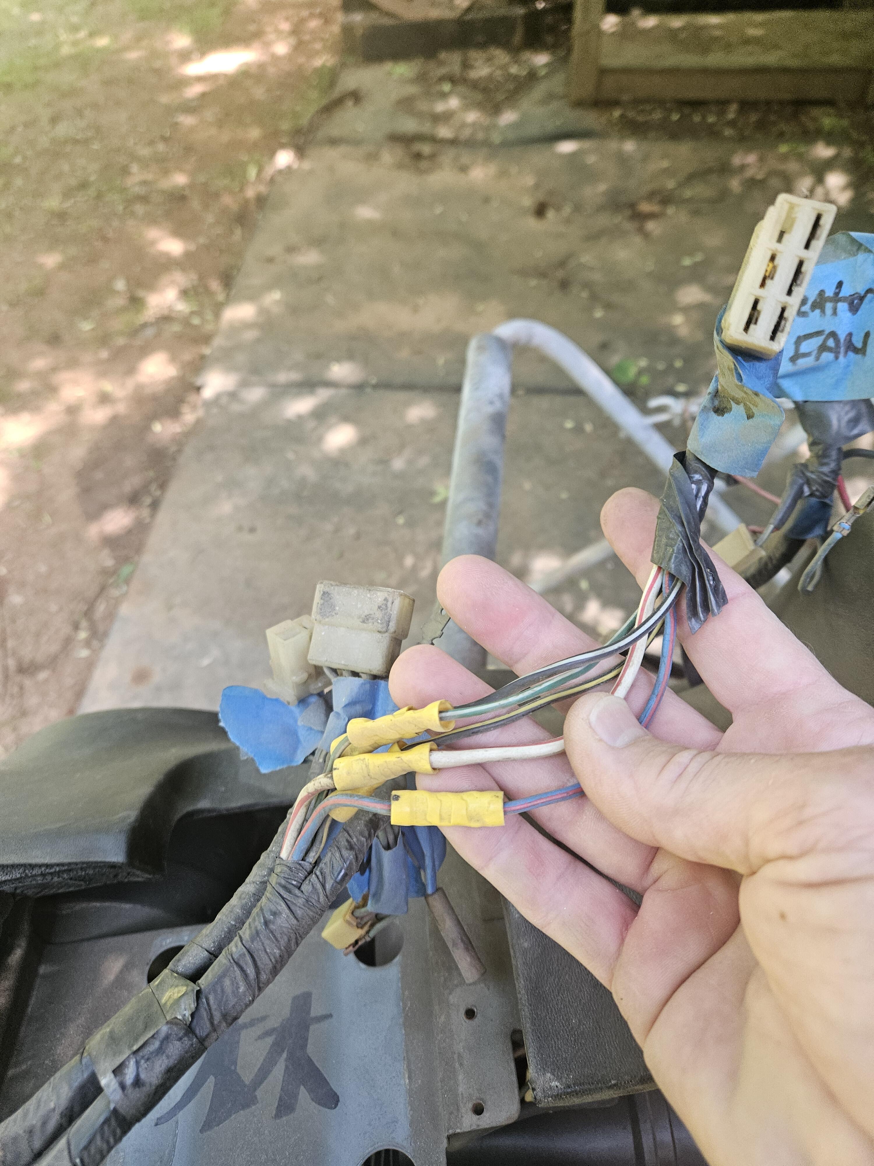

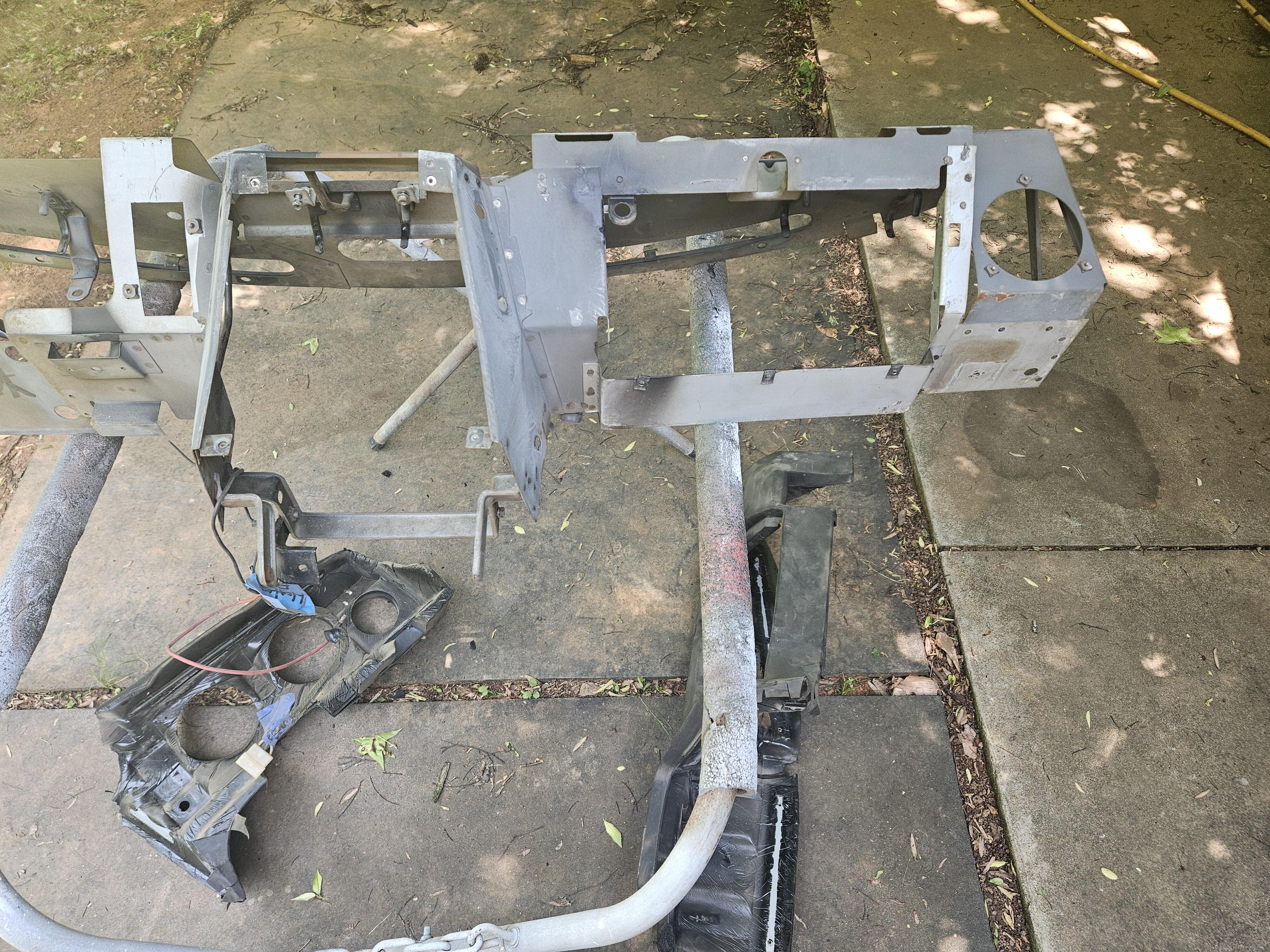

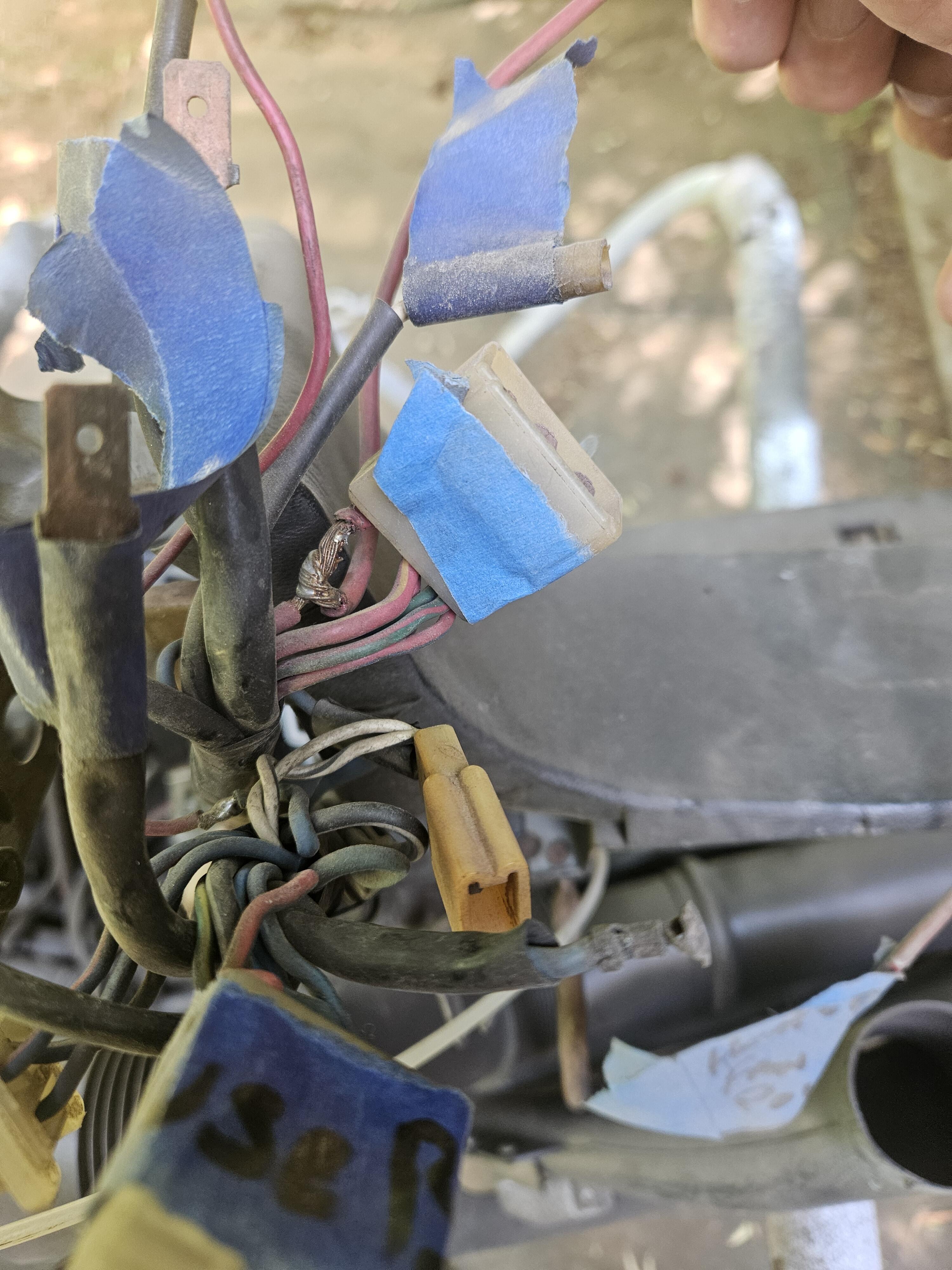

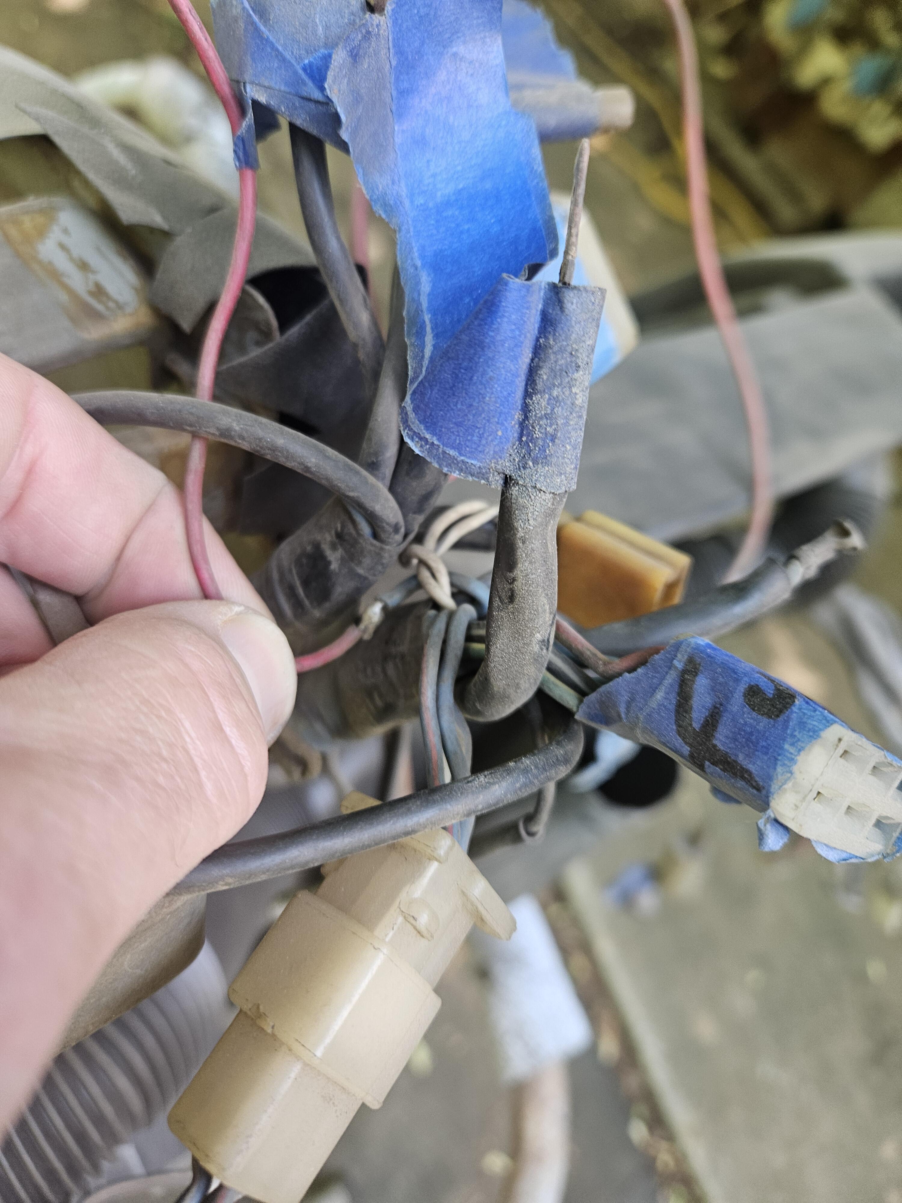

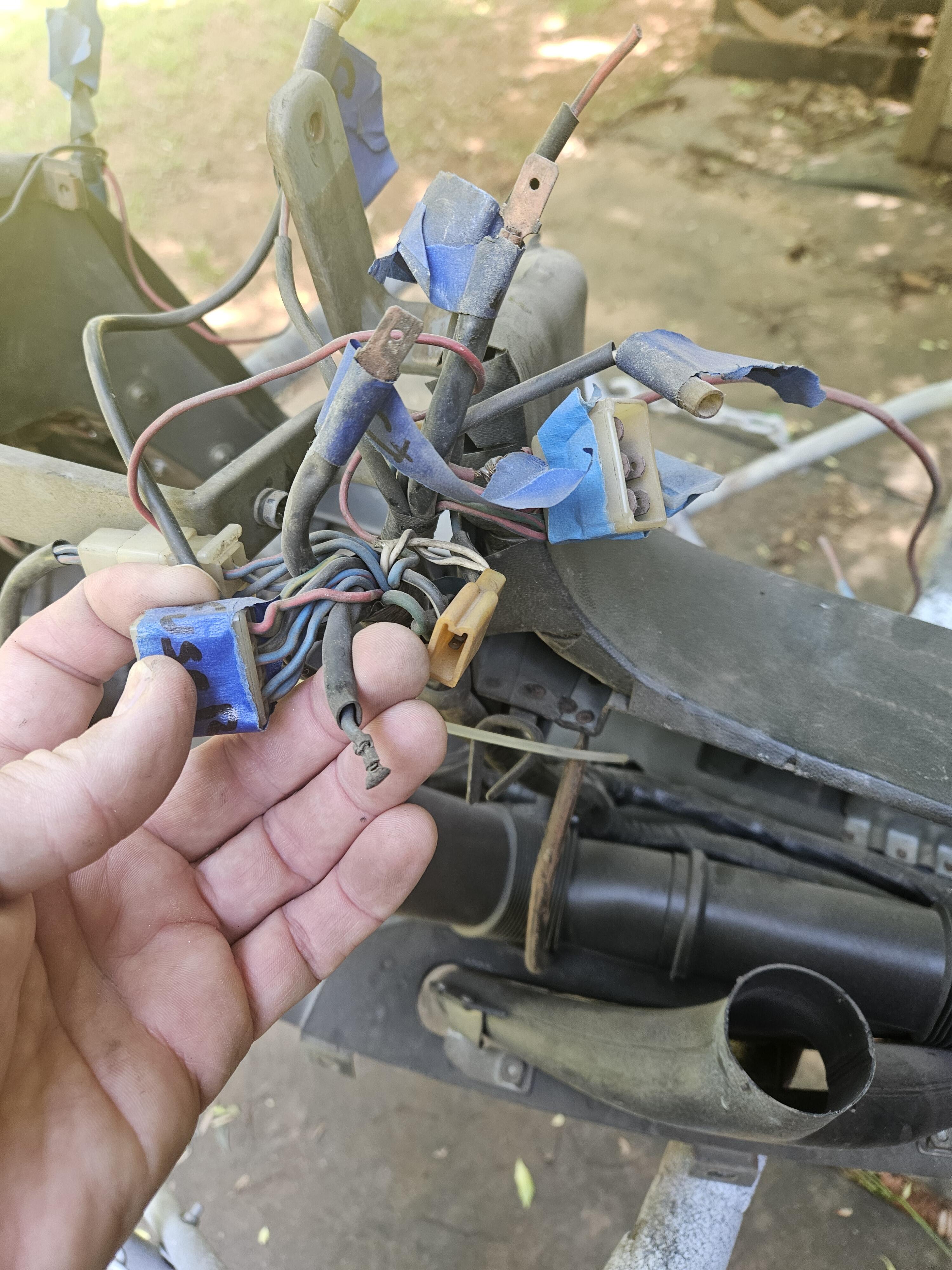

Now for my next challenge is the dash harness. I'm really starting to dislike PO'ers.:angry: The dash harness has lots of hacks in it.
There appear to be 3 different dash harness from 9/70 - sometime in 71. I have other dashes I could use harnesses from but I don't know if they would work. Can anyone give me details on what changed and how hard adapting a 71 dash harness would be?
I think I would lay that harness out on a board and go through it from one end to the other. Check every connector and bulb. Once you get it laid out it isnt quite as daunting. When I got mine all back together, I was having an issue. It turned out to be one terminal on a connector at the passenger firewall was pushed out of place. I was panicked it was something deep under the dash!
I have a box of gauges, and maybe a partial dash harness. Let me know if you need anything. Great progress!

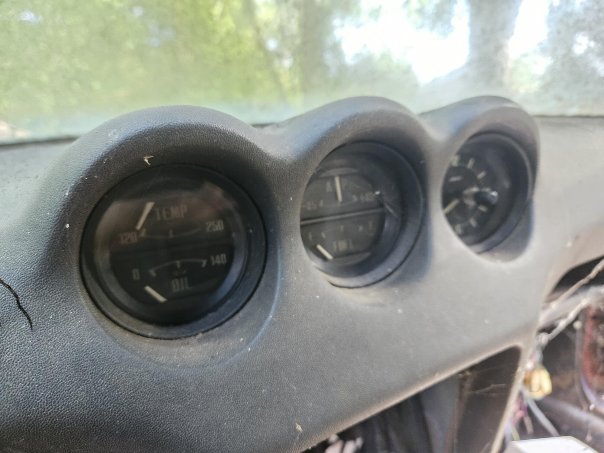

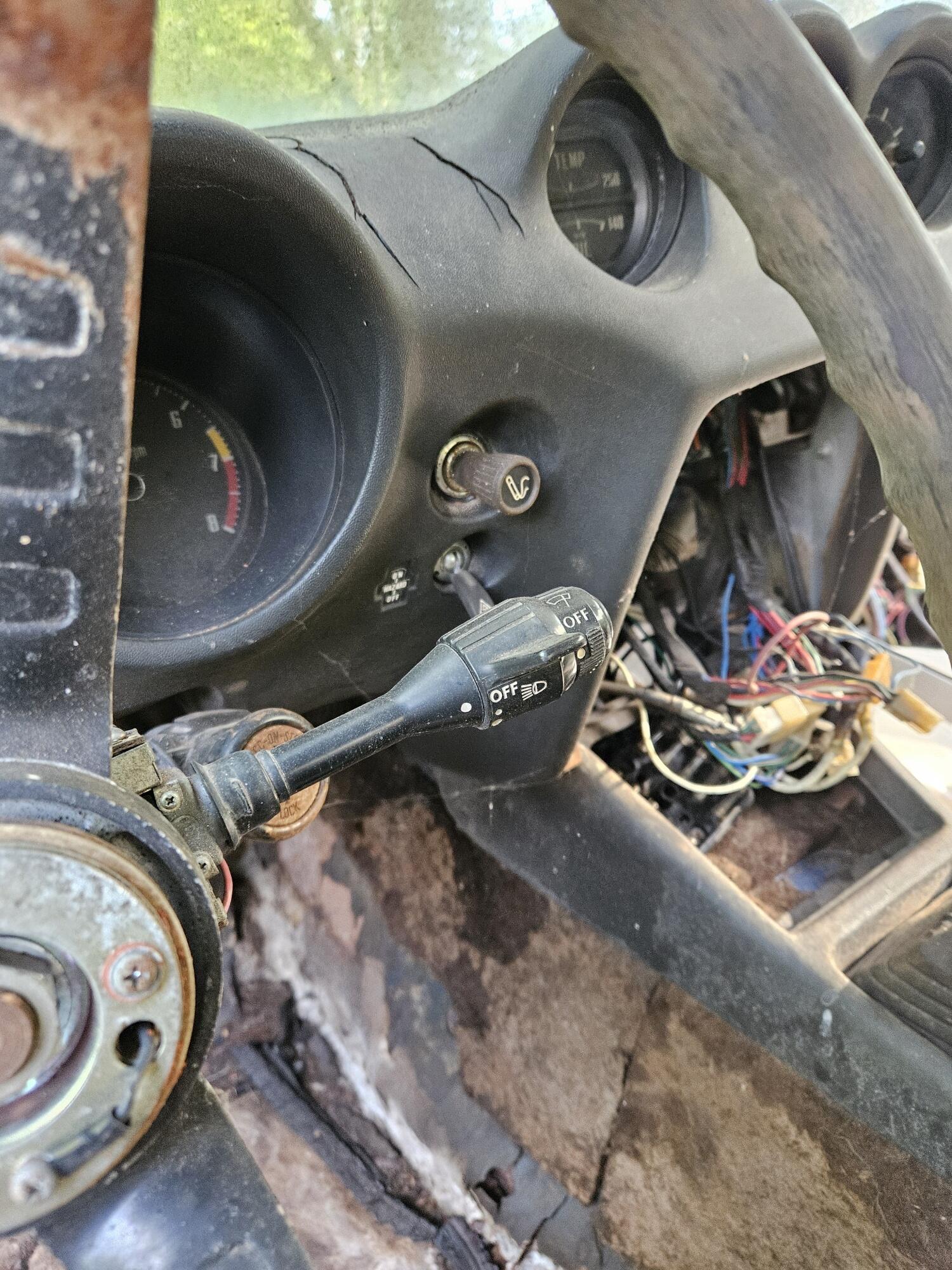

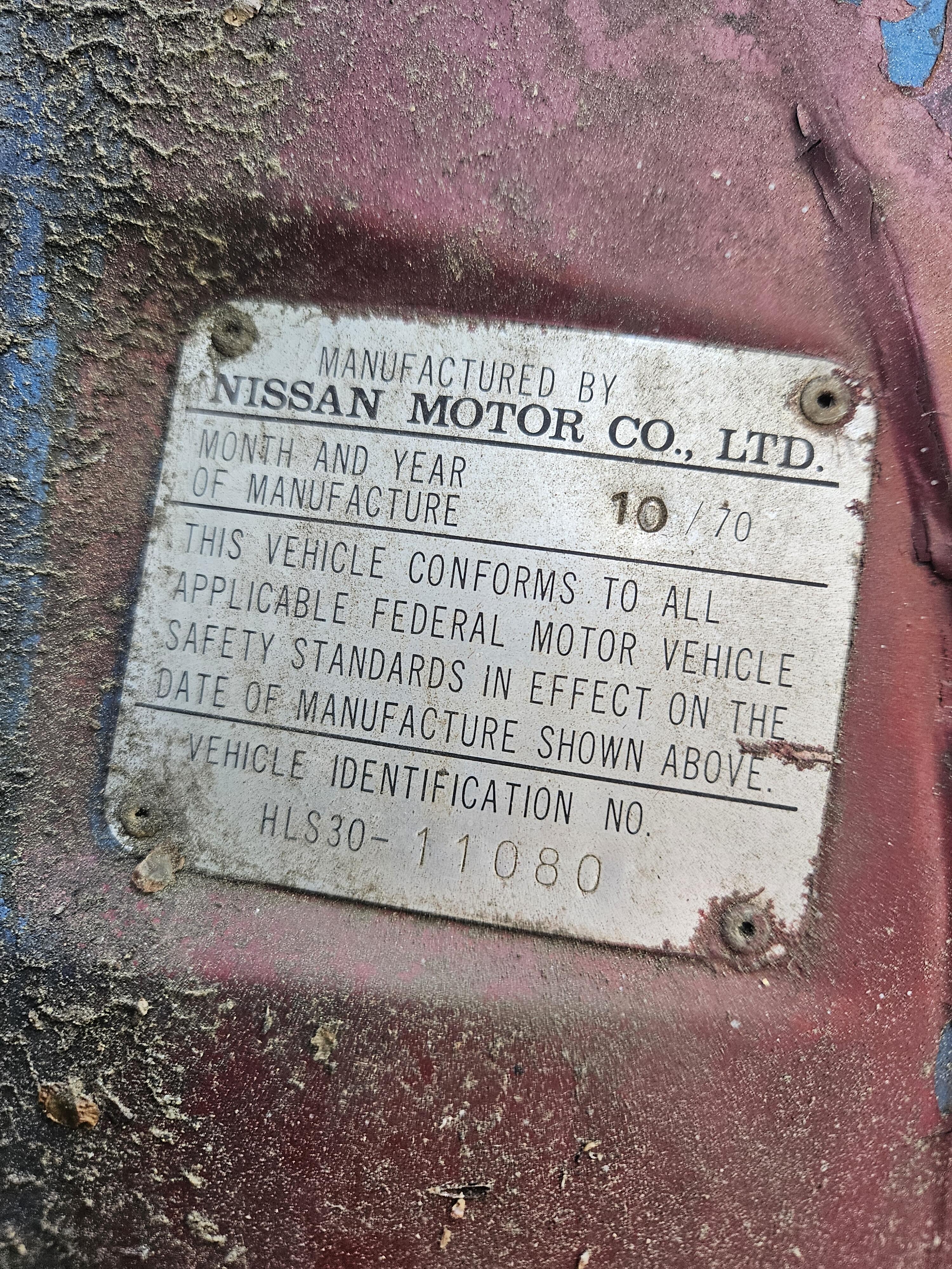

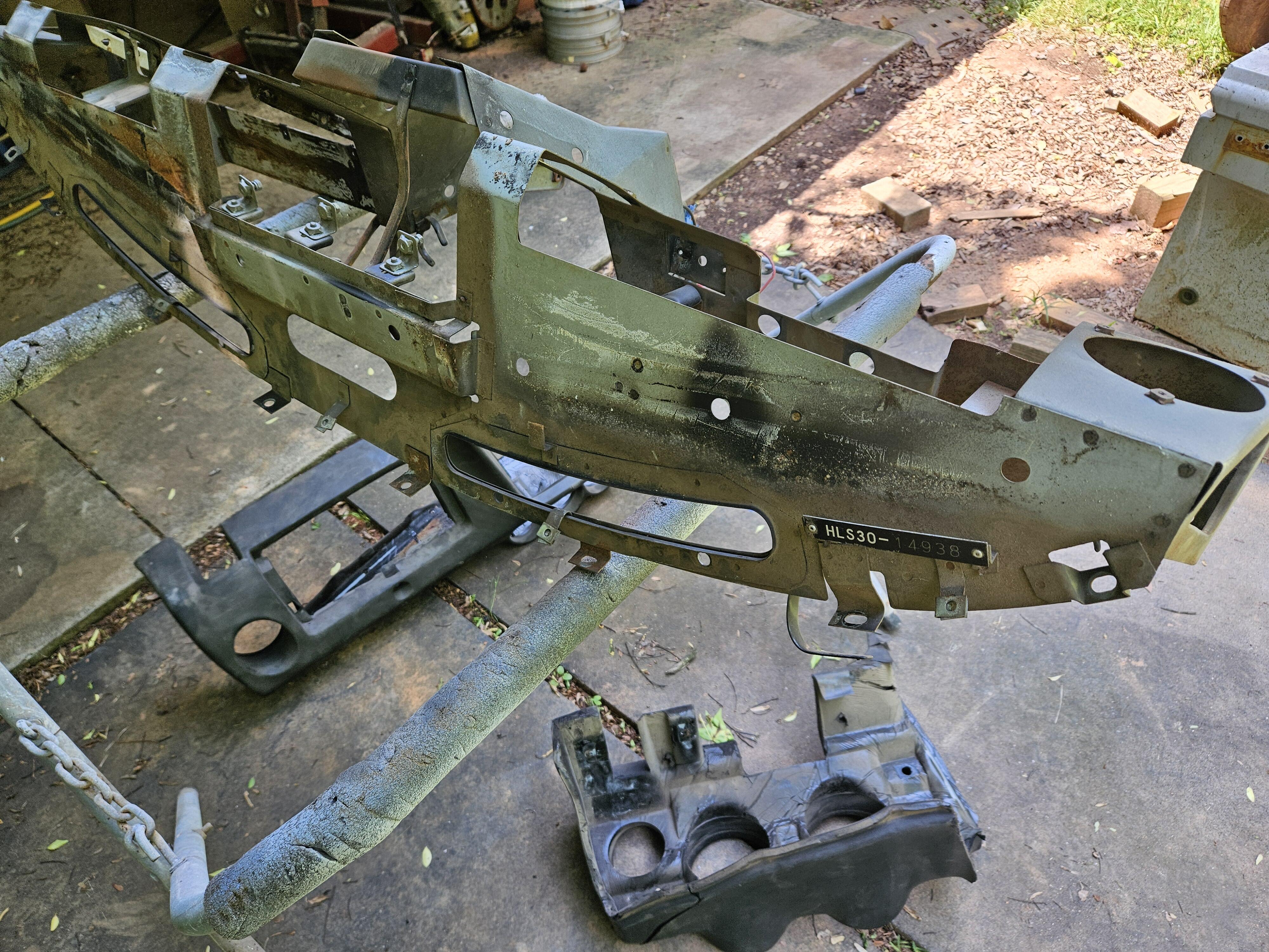

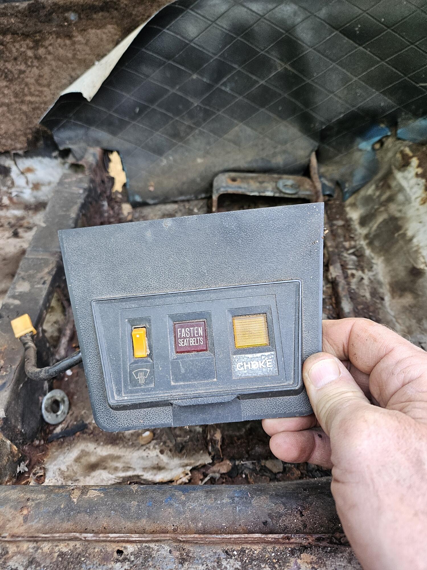

So later dash in an early car?
This is in the "Brown Z"
Cody had suggested a great plan. Cannibalize the Brown Z for the dash harness I need and anything else so I can get Lily done for now. They are only a month apart. But I saw the dash and hazard label and then I started wondering what was what?
