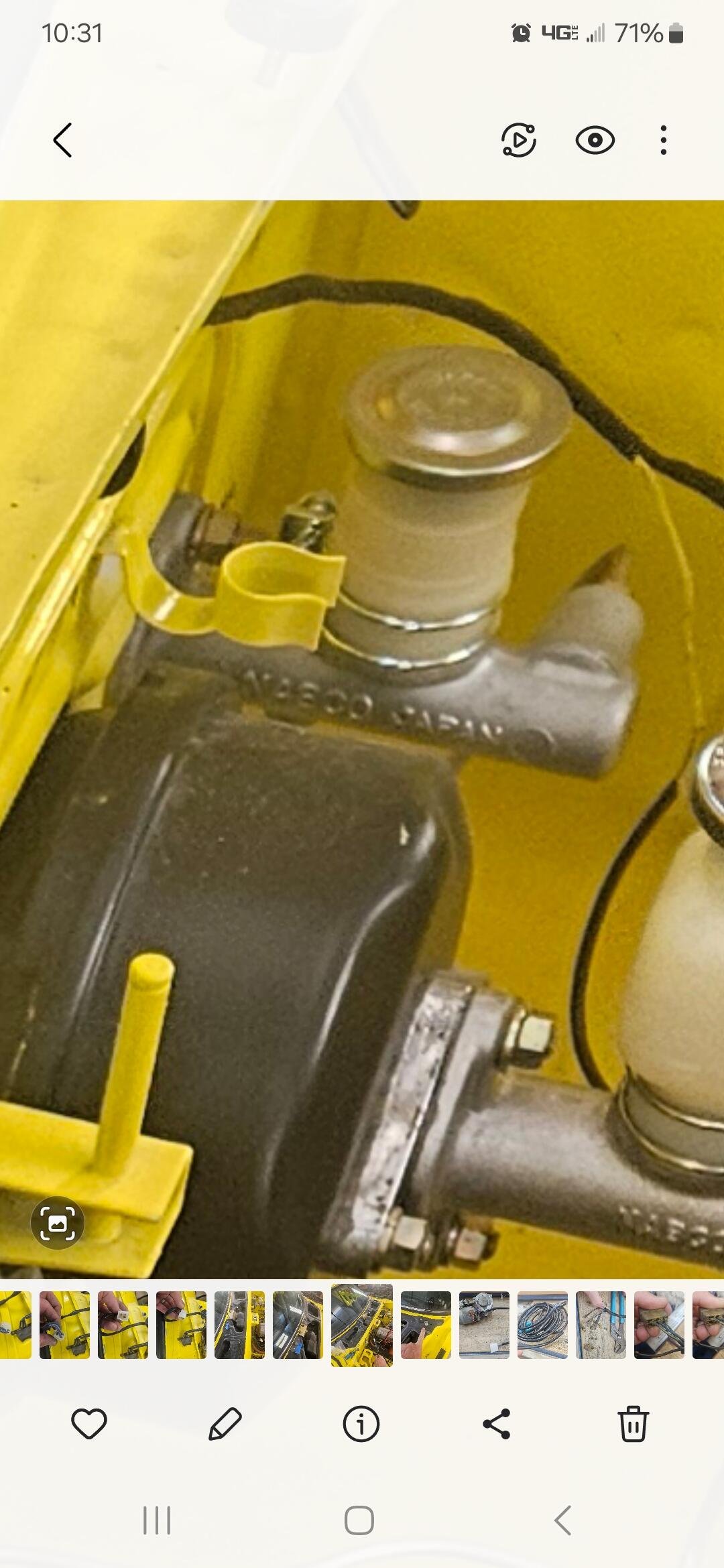

And as for your clutch... Which style clutch master are you using (early or late*)? Have you got a pic?
And same thing goes for the clutch as goes for the brakes... When you're foot is not on the pedal, it is important for the master to return to un-actuated "at rest" position. If it does not return to "at rest" it will not bleed or work properly.
* Early has the reservoir in front of the output hard line connection, while the late style has the reservoir behind the hard line output connection. Both have a valve inside, but they operate differently.

And that clutch M/C is the later type. You can do a kinda-sorta bench bleed of the clutch master by loosening the flare nut on the outlet and just let it gravity bleed into a rag. If fluid doesn't flow, I suspect it's a problem with the linkage.
If you loosen the nuts that hold the clutch master onto the firewall, does it a) push away from the firewall, b) remain pulled tight against the firewall, or c) it's kinda neutral?
It should be neutral with a tiny bit of slop in the linkage. If it pushes away, you need more play in the linkage and may not be opening the internal valve.

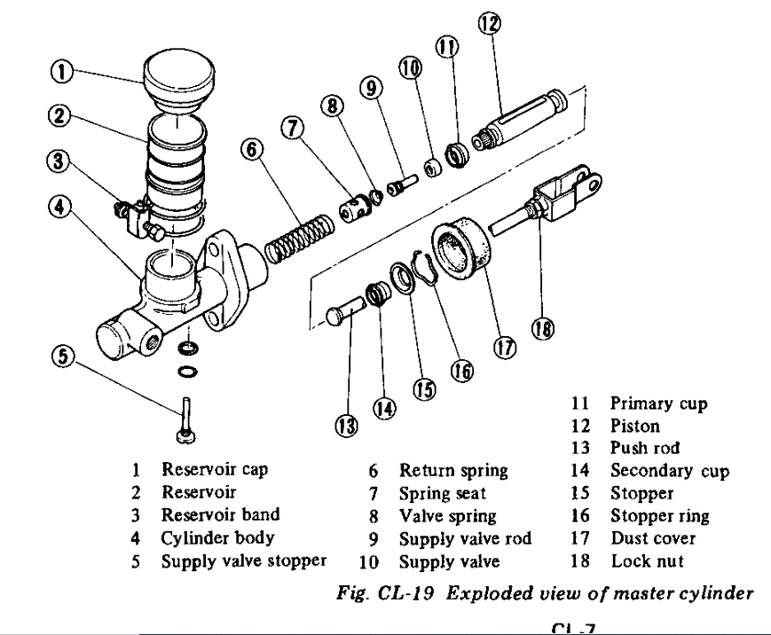

I recently couldn't get my clutch to bleed (just after I couldn't get my brakes to bleed), and the problem was the little slider valve found on the piston assembly.  No pictures, but the little valve for the clutch master cylinder is much easier to get to than the one on the brake master cylinder.  it has a little spring on it.  Should be easier to disassemble and make sure it is not sticking.

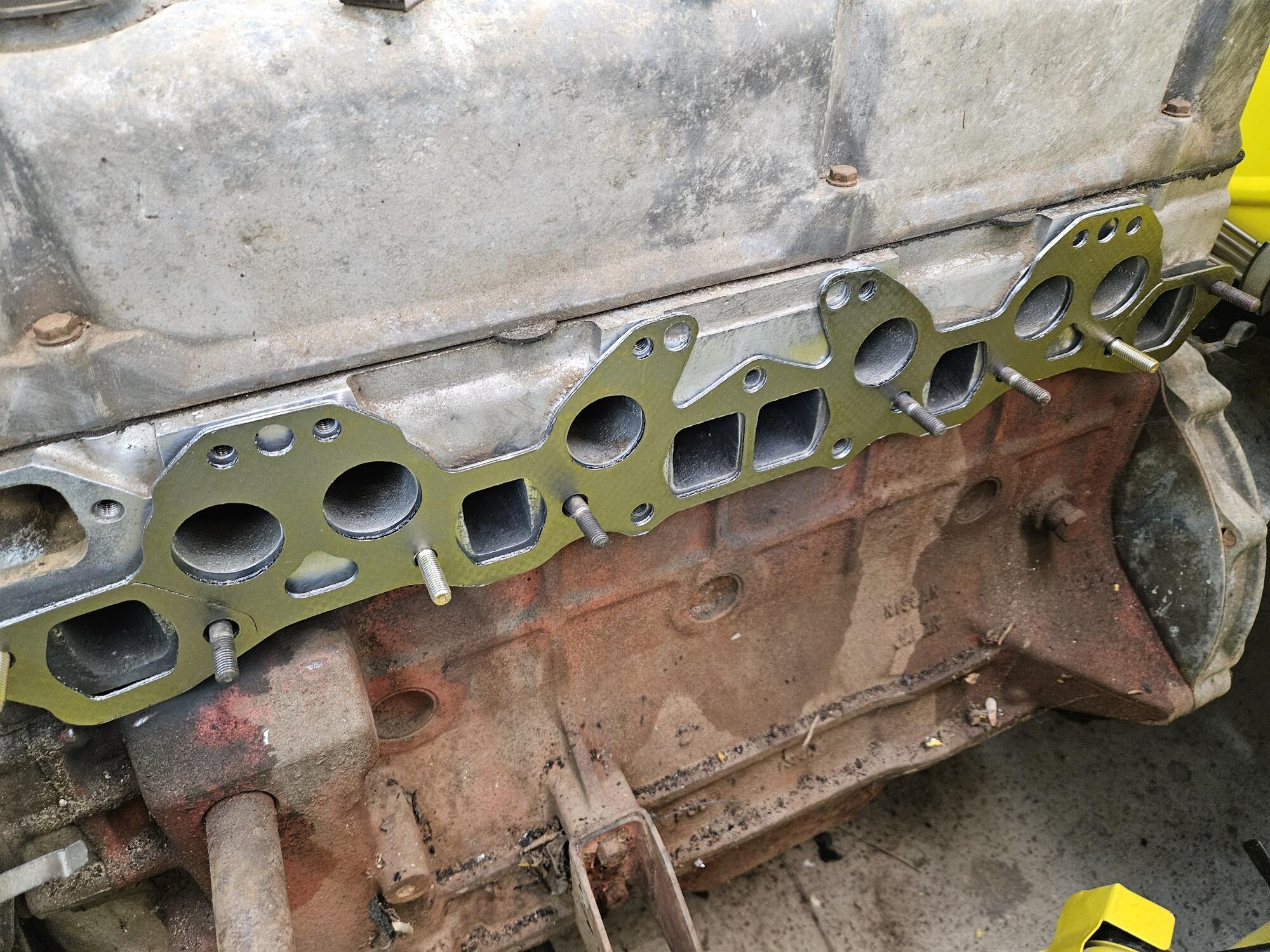

Got the head gasket surface cleaned up
Manifold gasket?

1 hour ago, Zed Head said:
Referencing this nice exploded view and my comments earlier, #9 is the valve that got stuck.  #10 is a rubber part that fits on #9.  When the rod portion of #9 seizes in #12, then the cylinder operation stops working properly.
I don't know exactly how it works, but I think #9 works like a one way valve - it seems to close the circuit, which then allows the main piston and primary cup to move fluid.  When #9 is stuck in the "open" position, fluid just flows back and forth, and no force or movement of fluid is generated.
