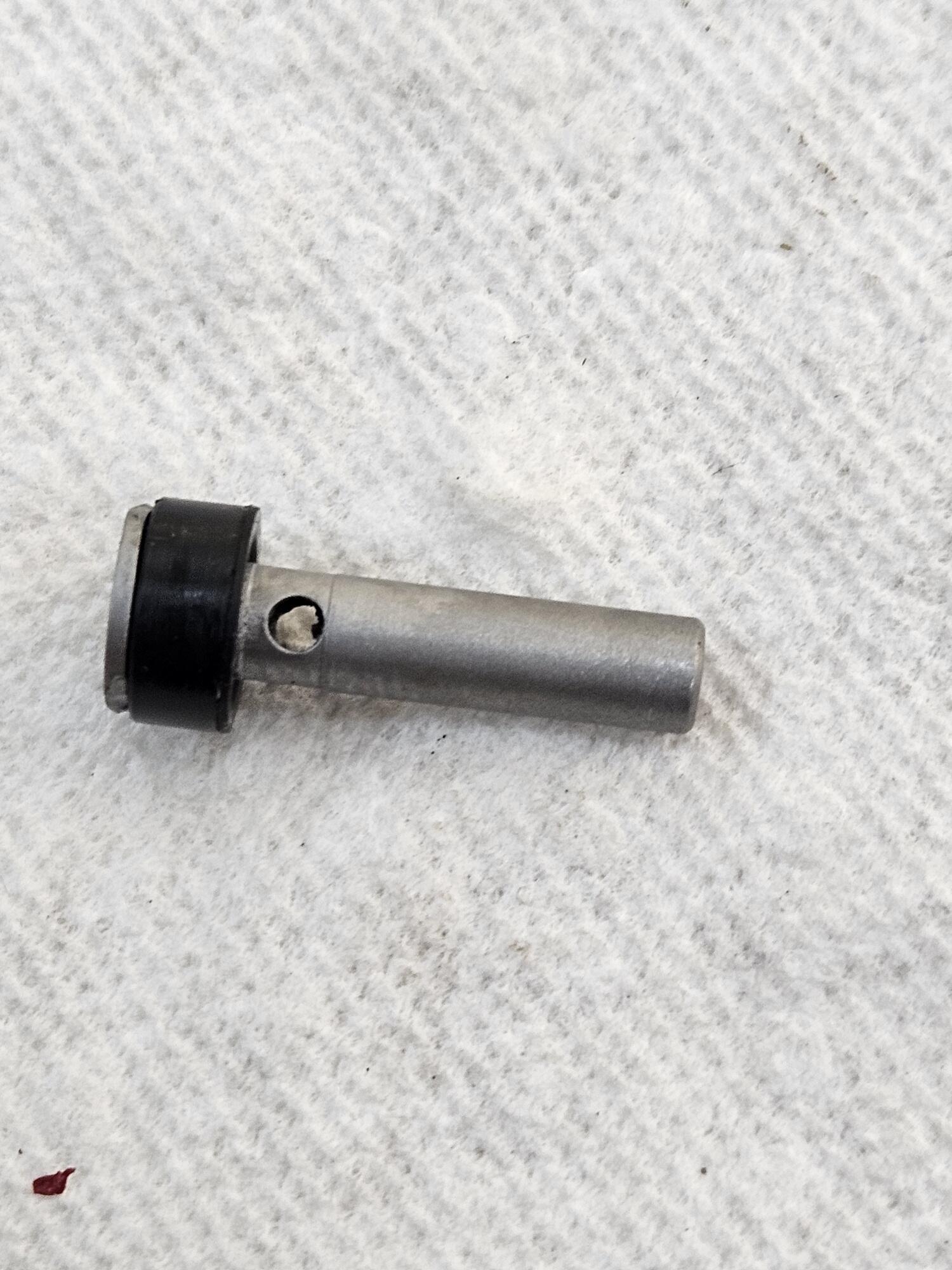

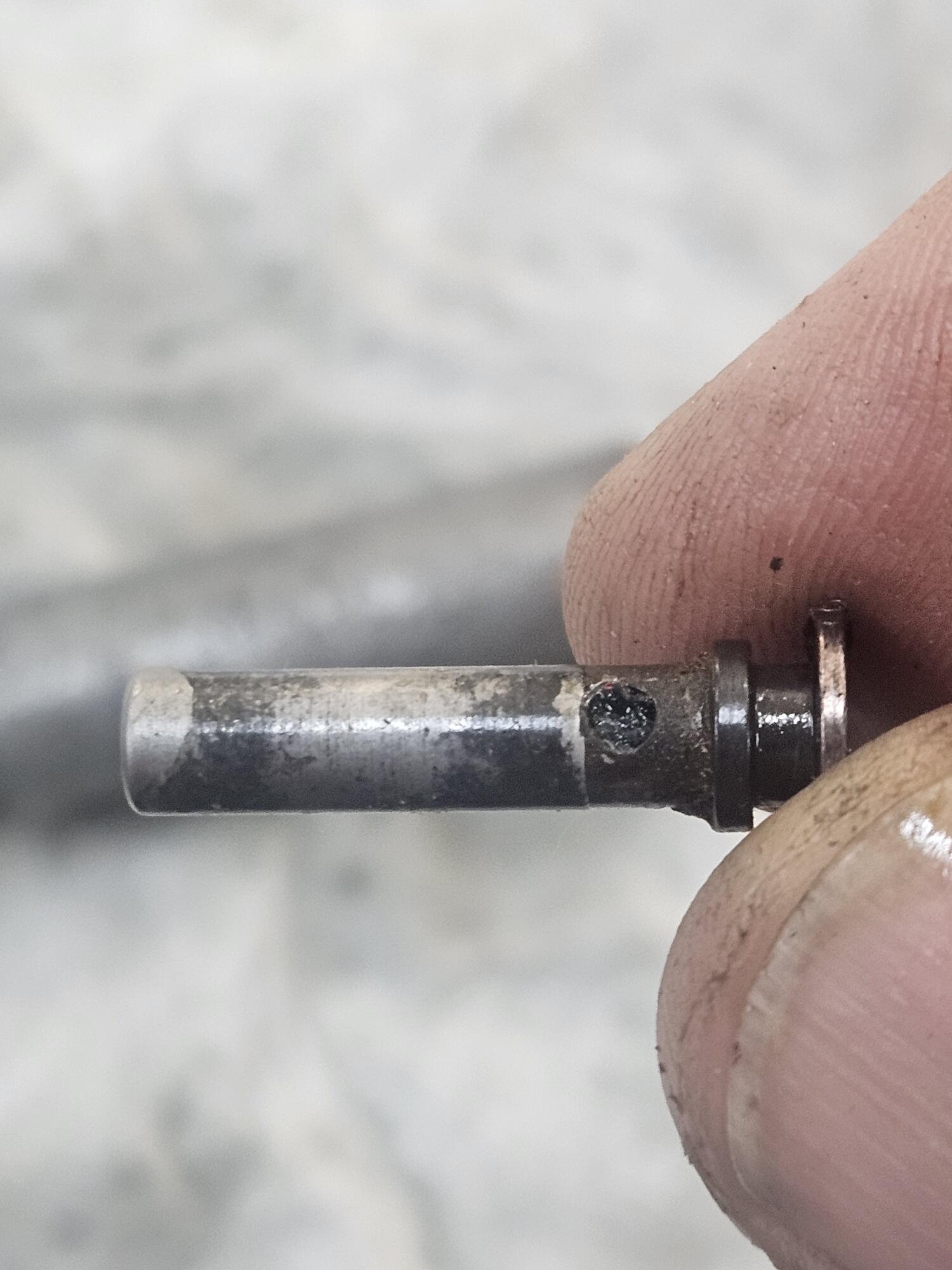

I posted some pics in that other thread detailing the valve in the brake master cylinder. The later clutch master cylinder is the same concept. Here's a couple pics.
Looks like this:
This screw cuts across the master inside and opens the valve when the clutch master is at rest:
Opening the valve with the tip of a screwdriver:
You can see daylight through the valve when it is pushed open:

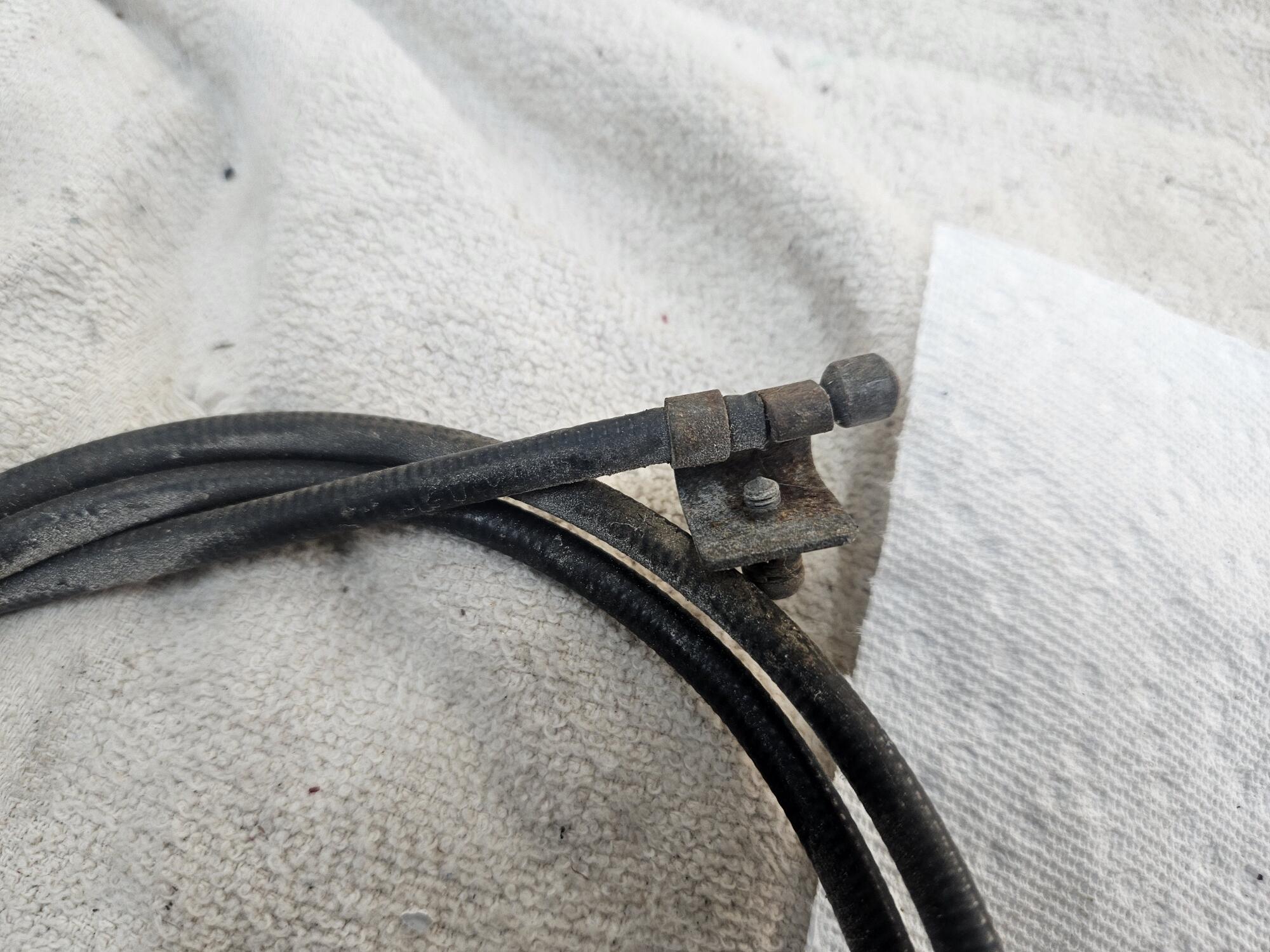

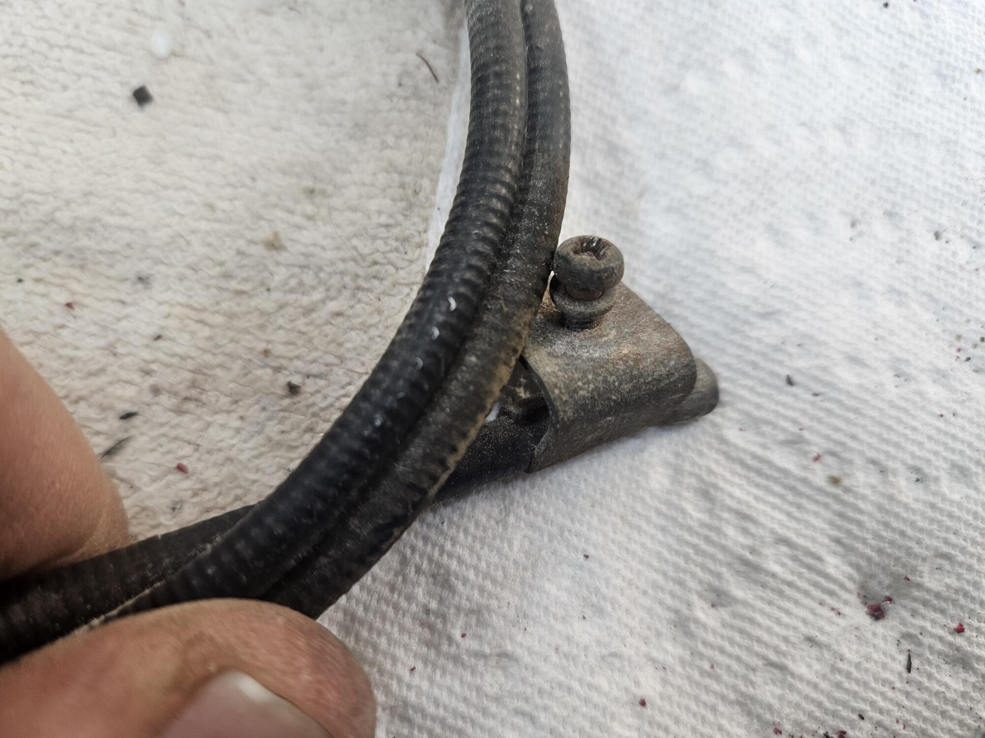

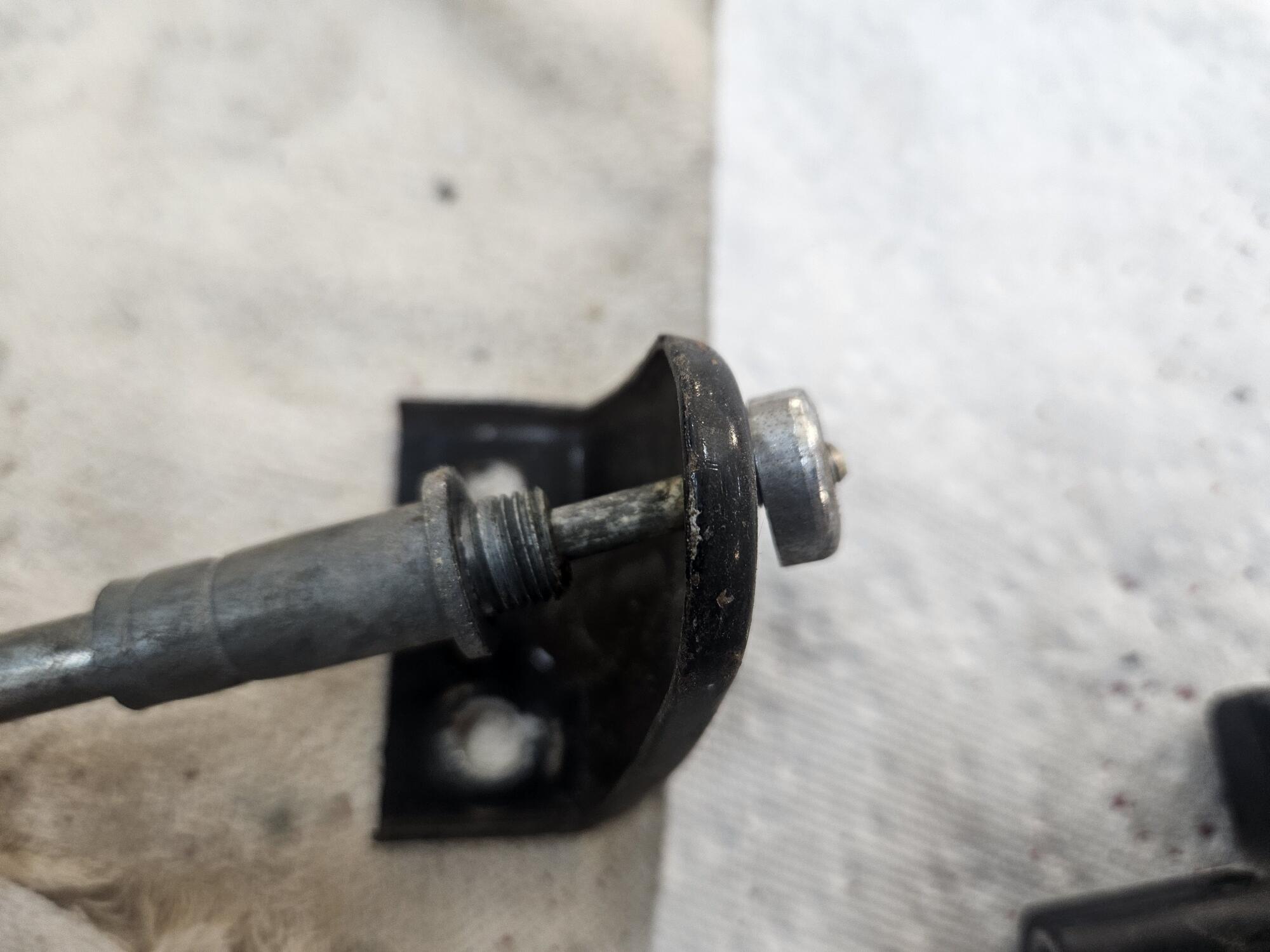

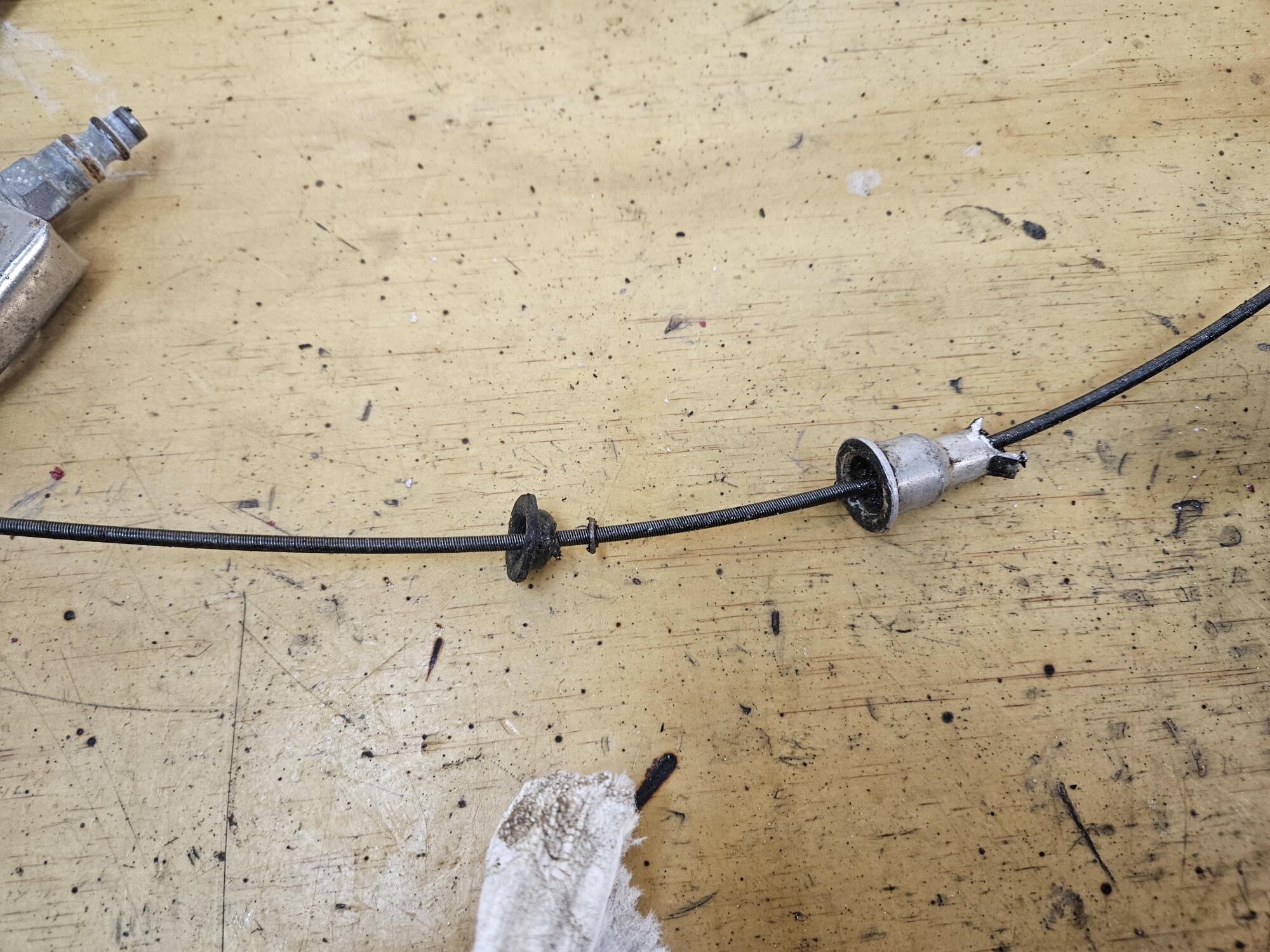

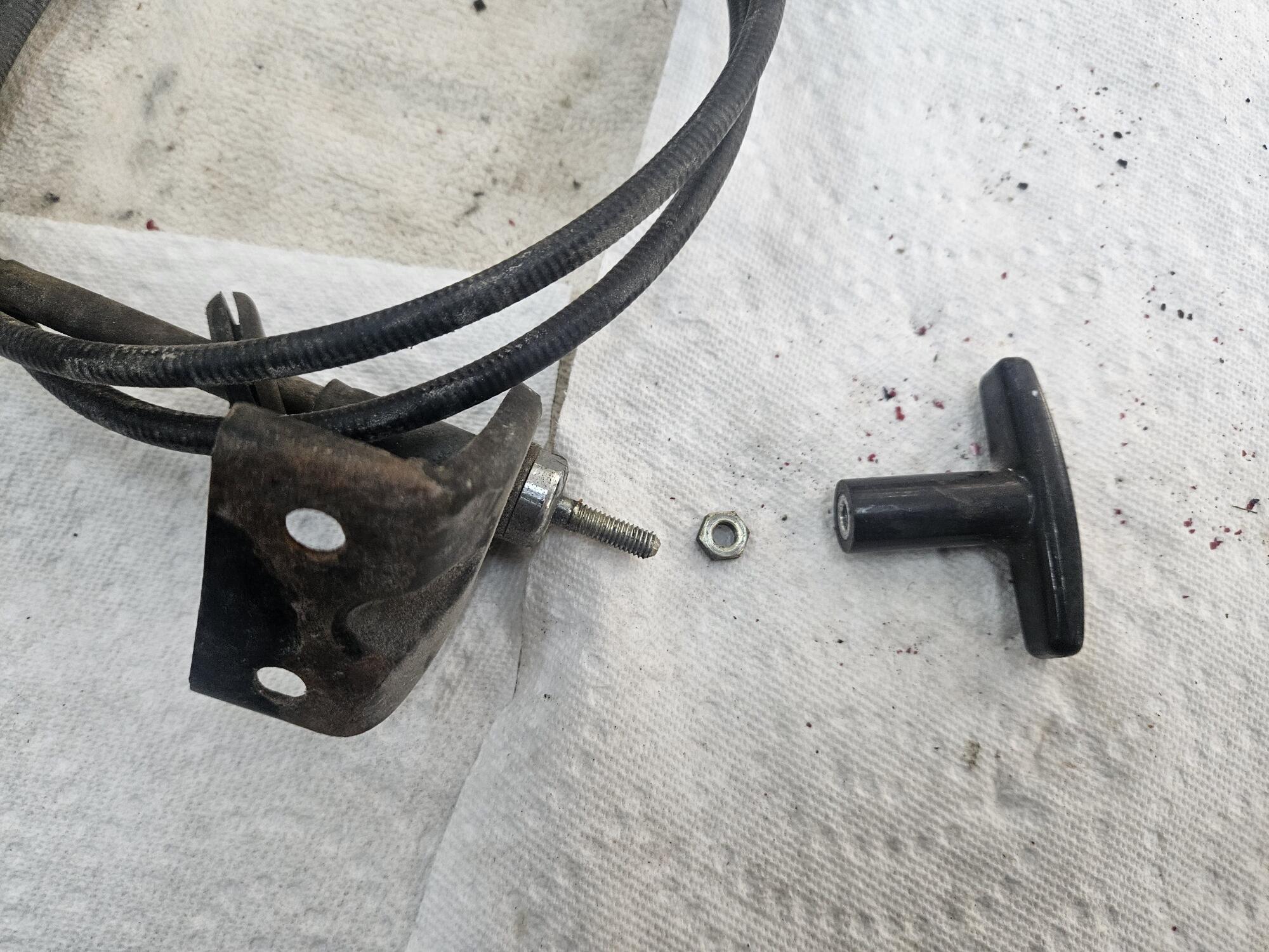

Found the hood release cable and the speedo cable and started reworking them.
Plated a few things today for these parts

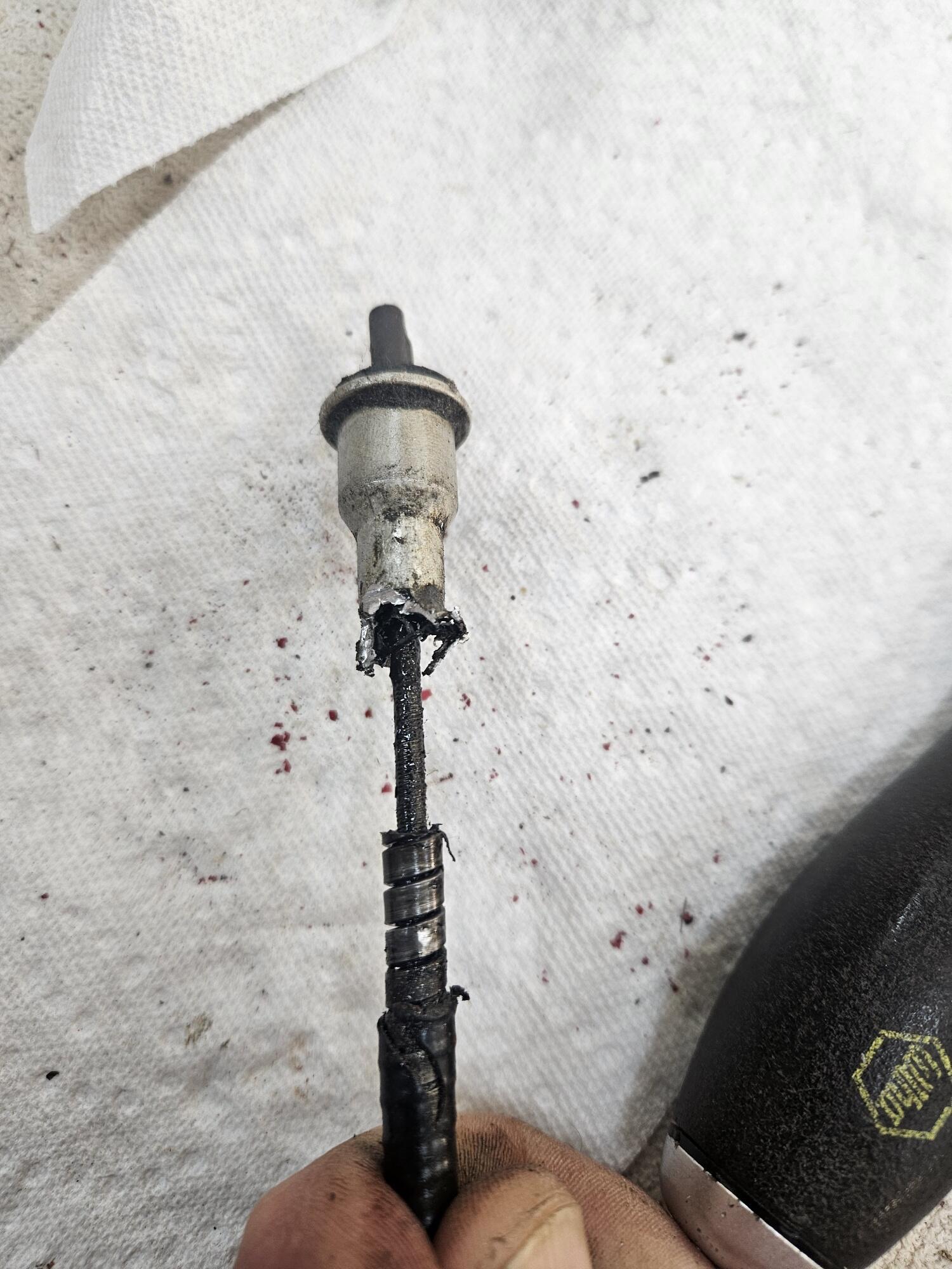

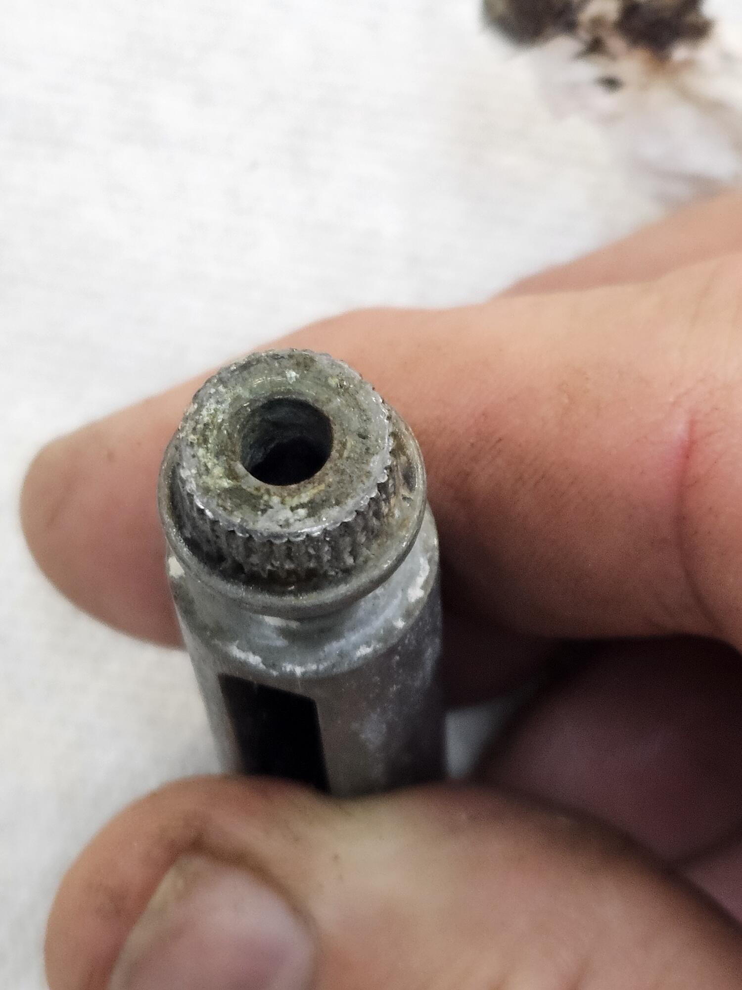

Cut the end back on the speedo cable. The jacket was already cracked here and pulled off with the aluminum end

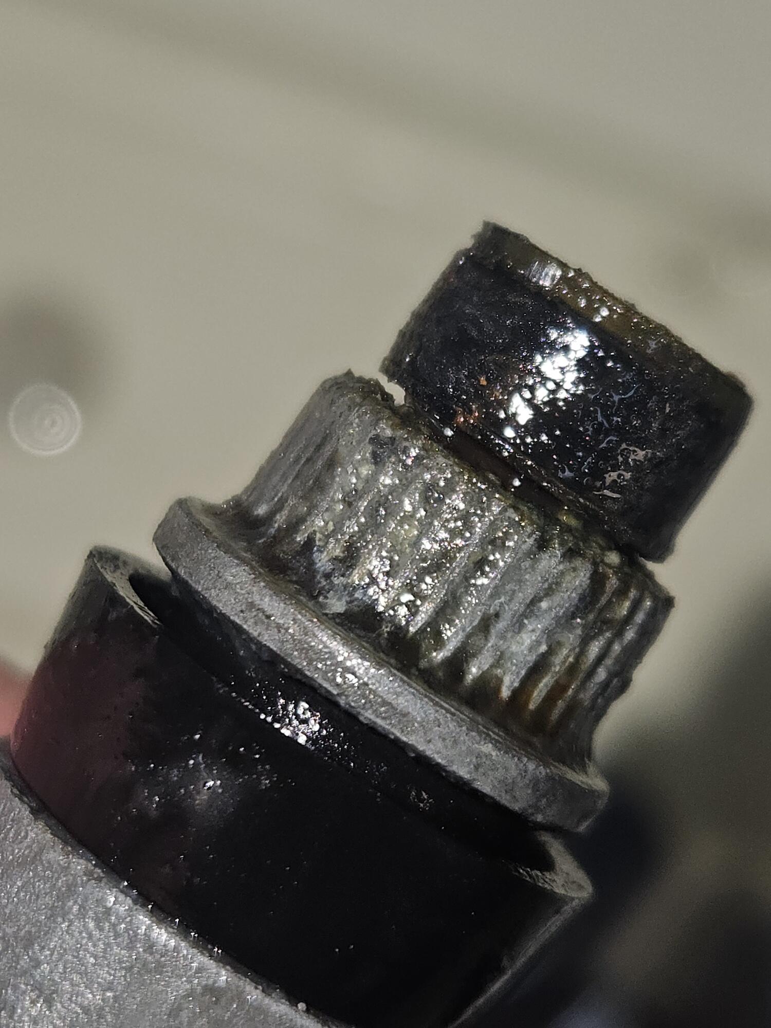

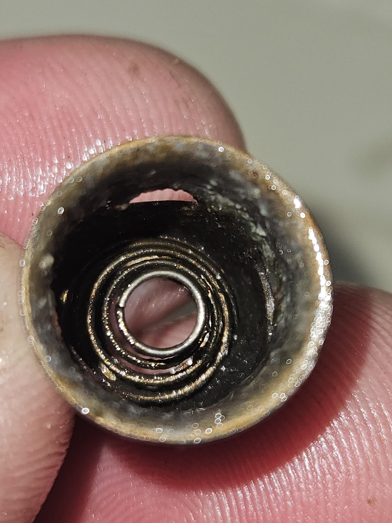

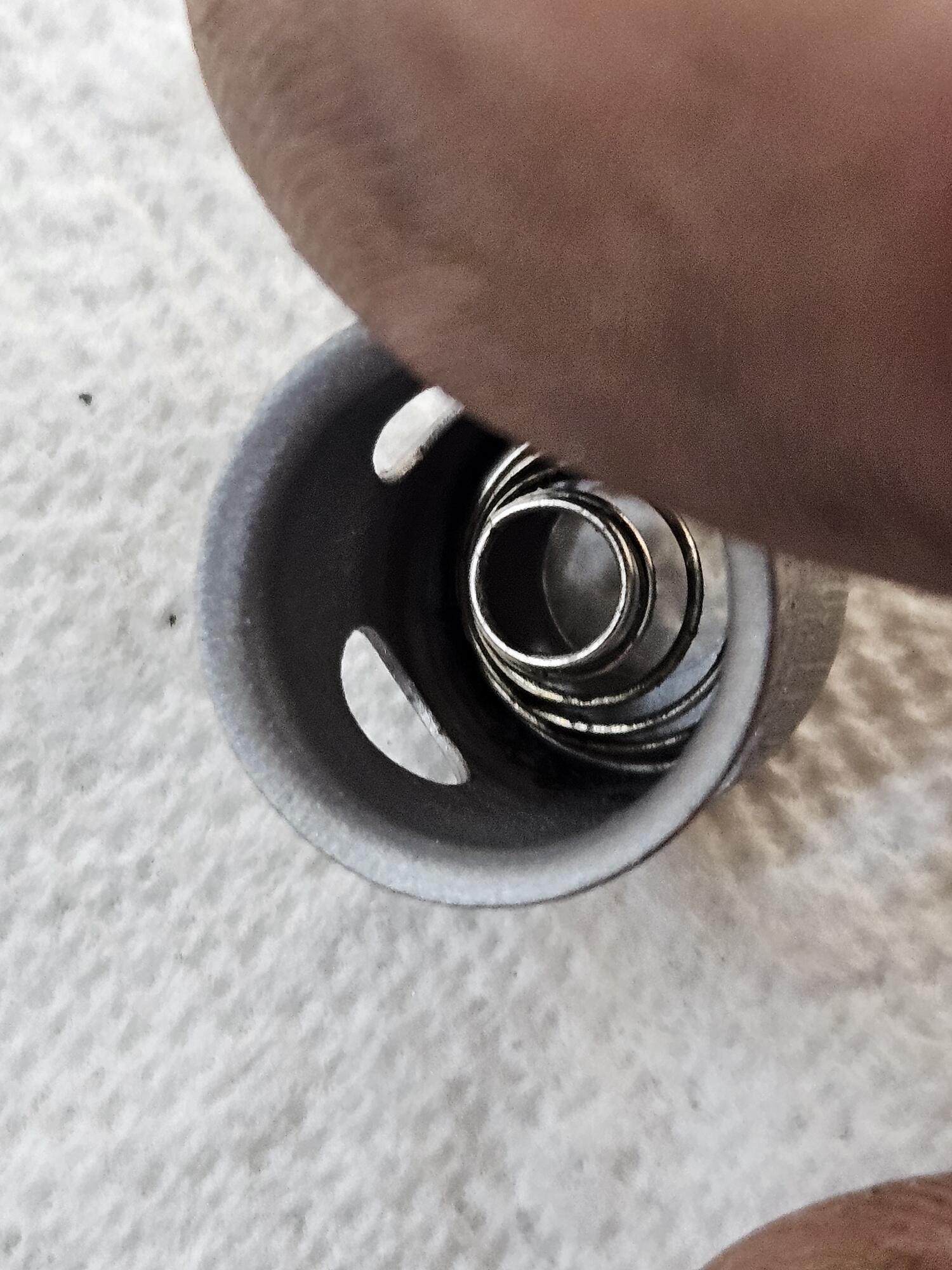

The clutch master appeared to be adjusted correctly, so I pulled it off. I tore it down and it was evidently one I had that I rebuilt. The little piston that allows neutral fluid flow at rest was seized up in the larger piston. It was also full of grease from when I forced it apart! So no fluid flow there...
So a little bead blasting and all good
