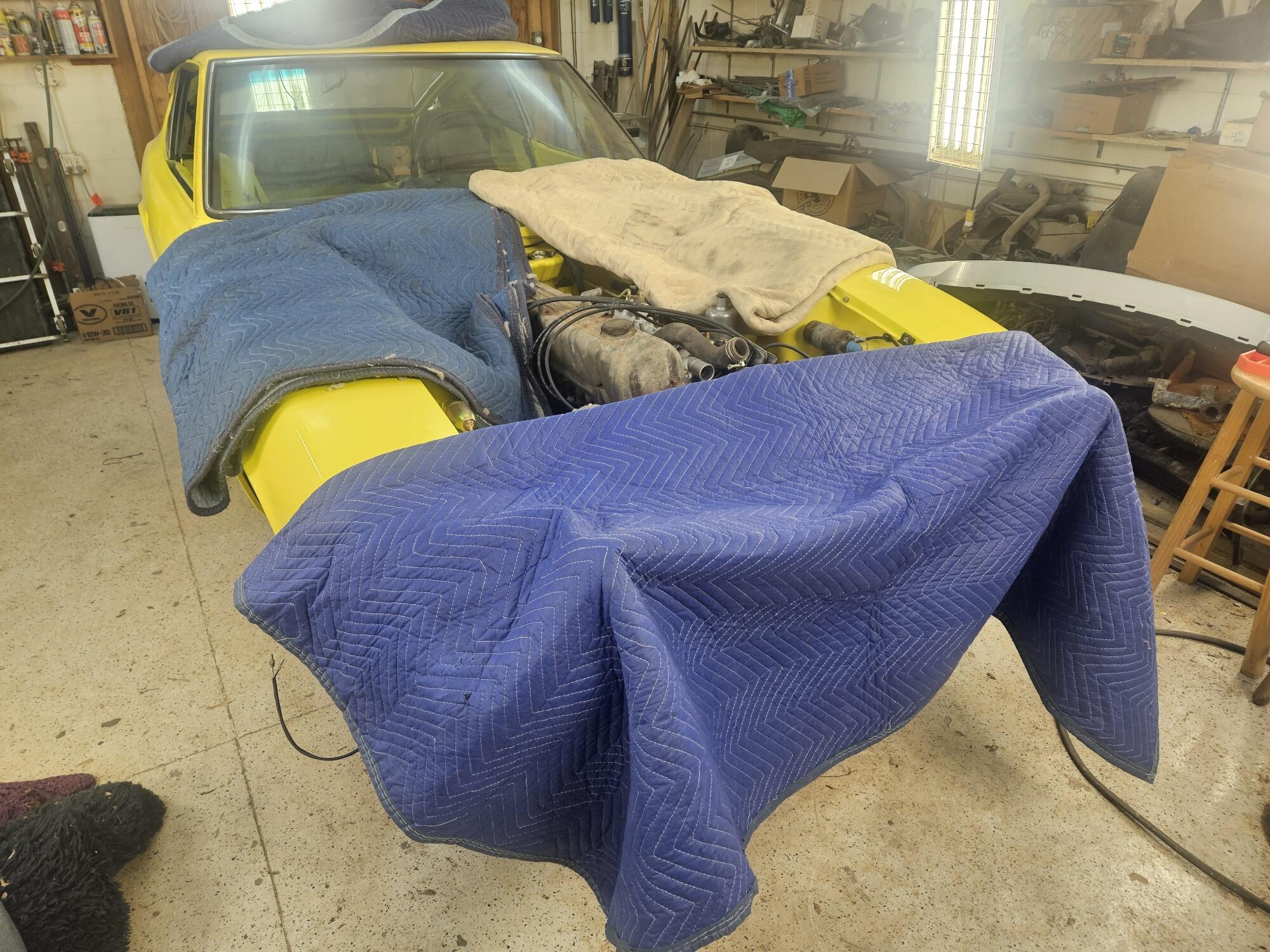

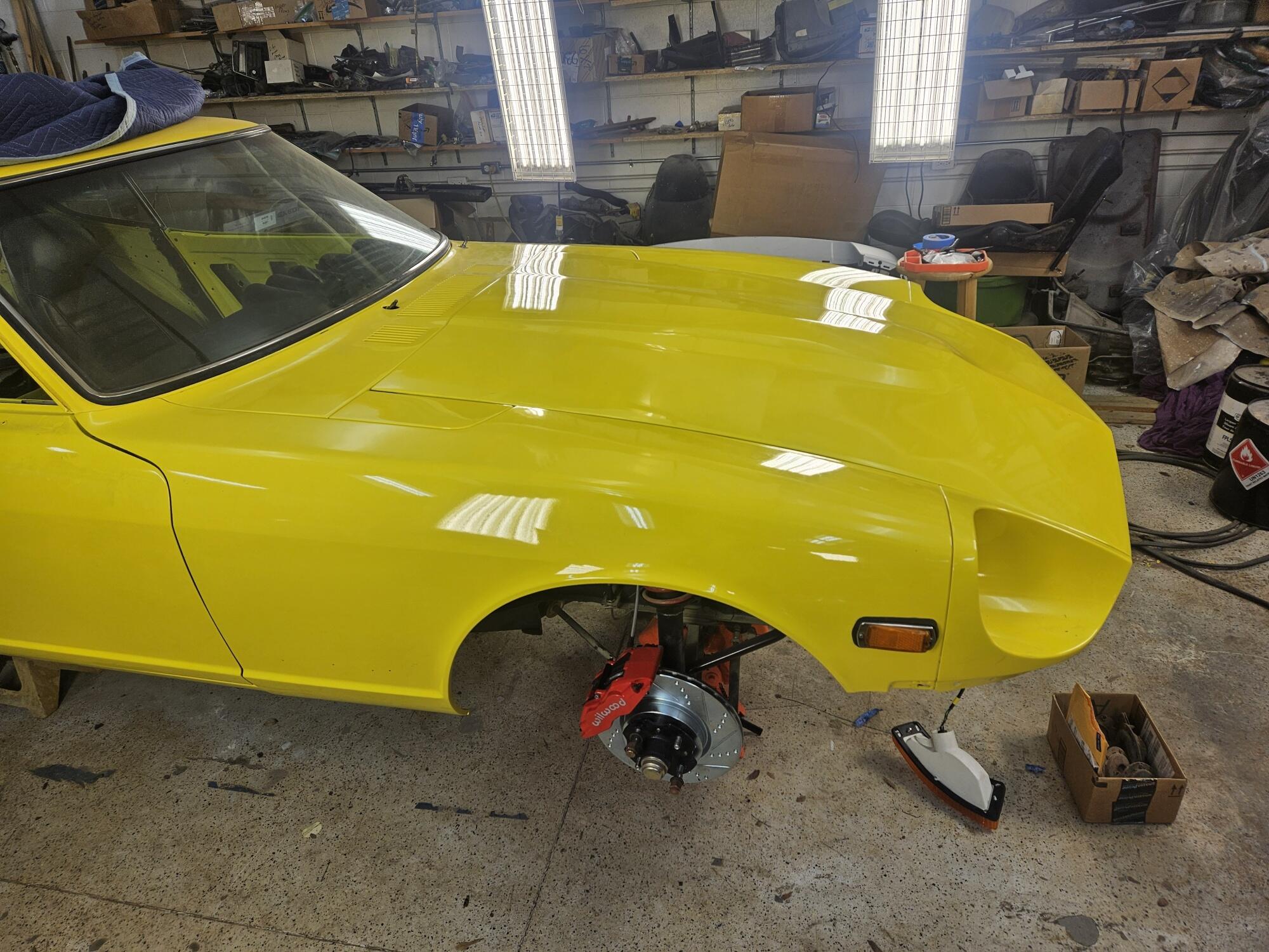

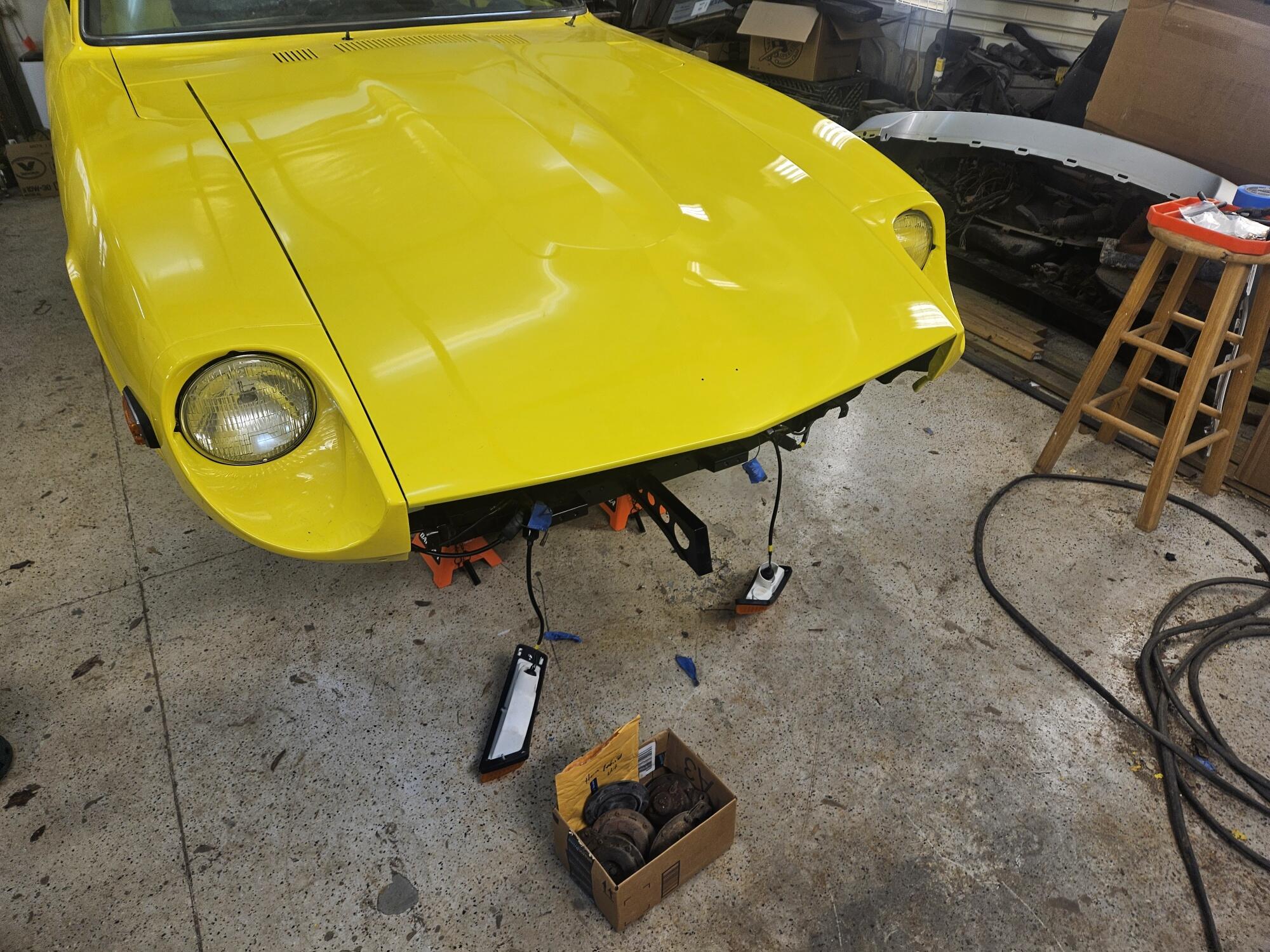

Got the hood on today
The paint chips incredibly easy. Way too easy it seems. It will probably have to be reworked at some point. We'll see

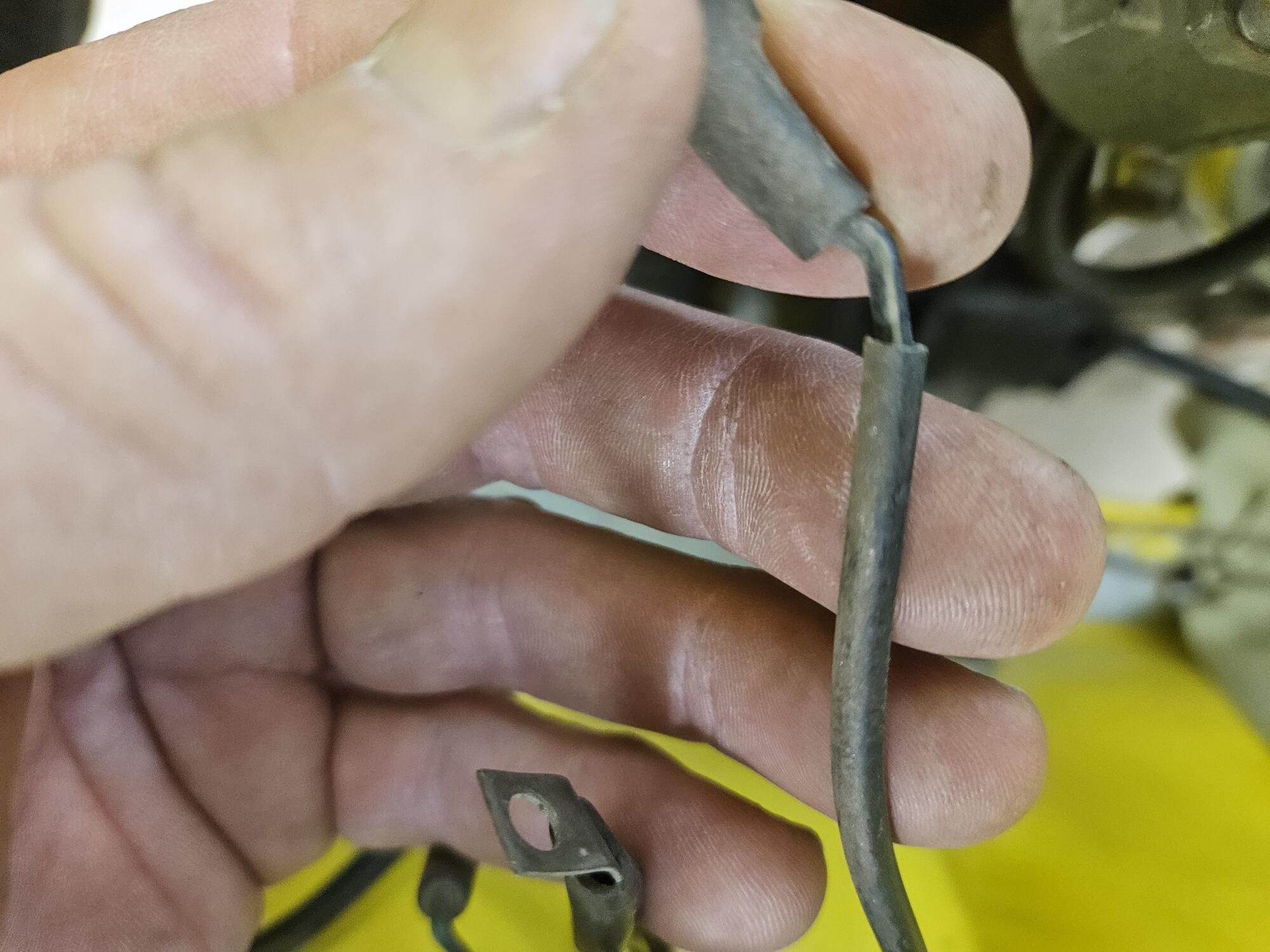

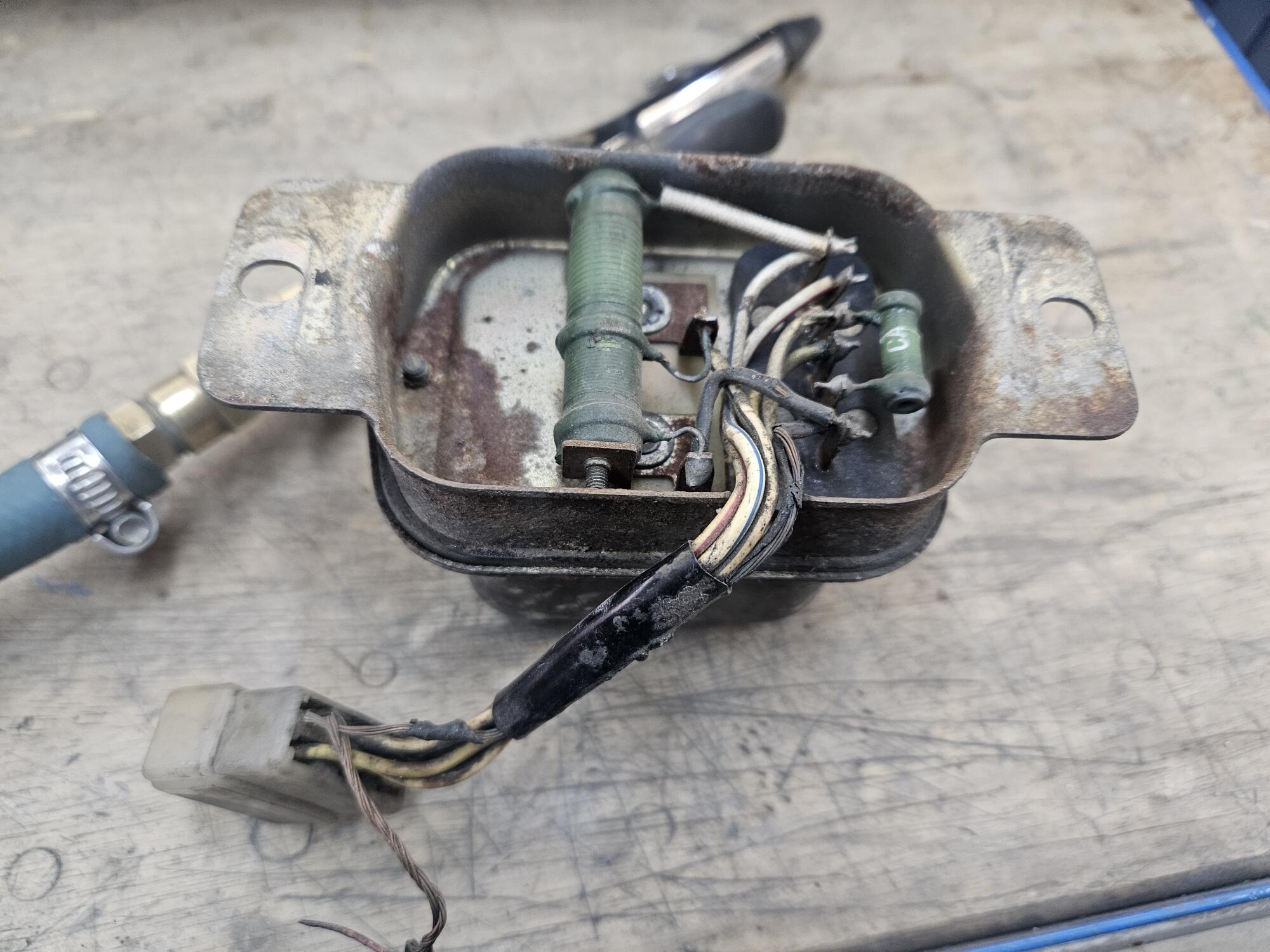

I reworked the black wire on this voltage regulator

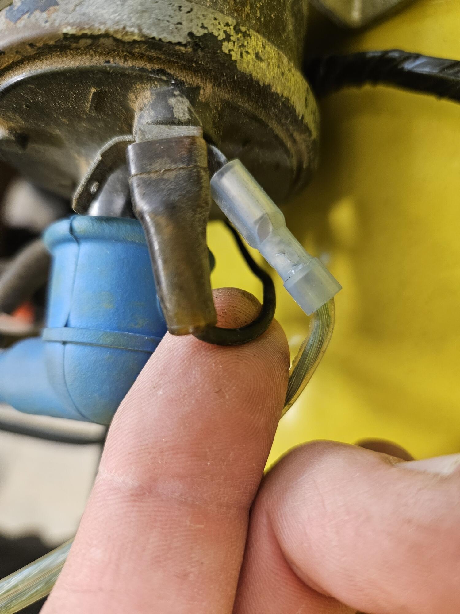

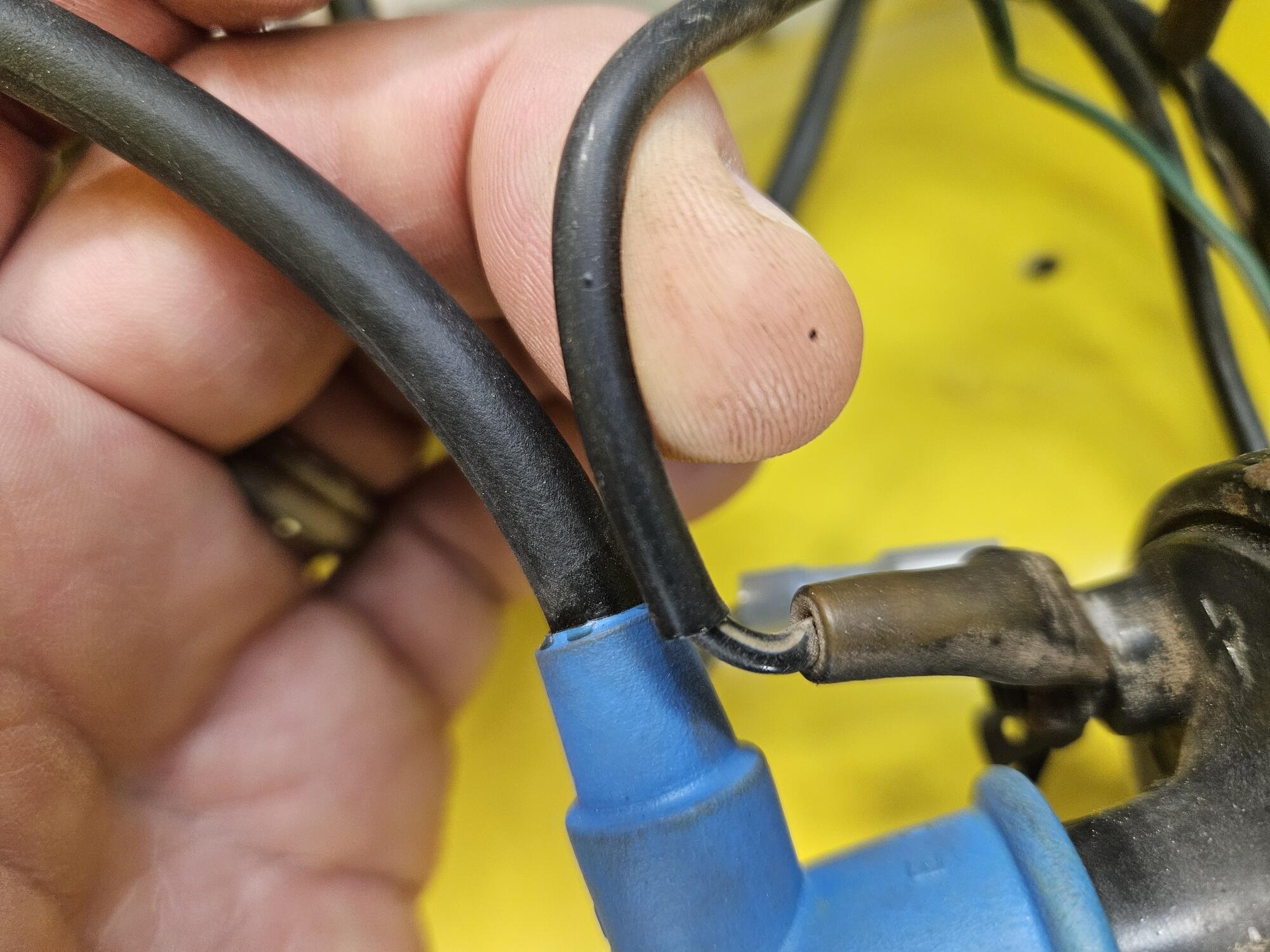

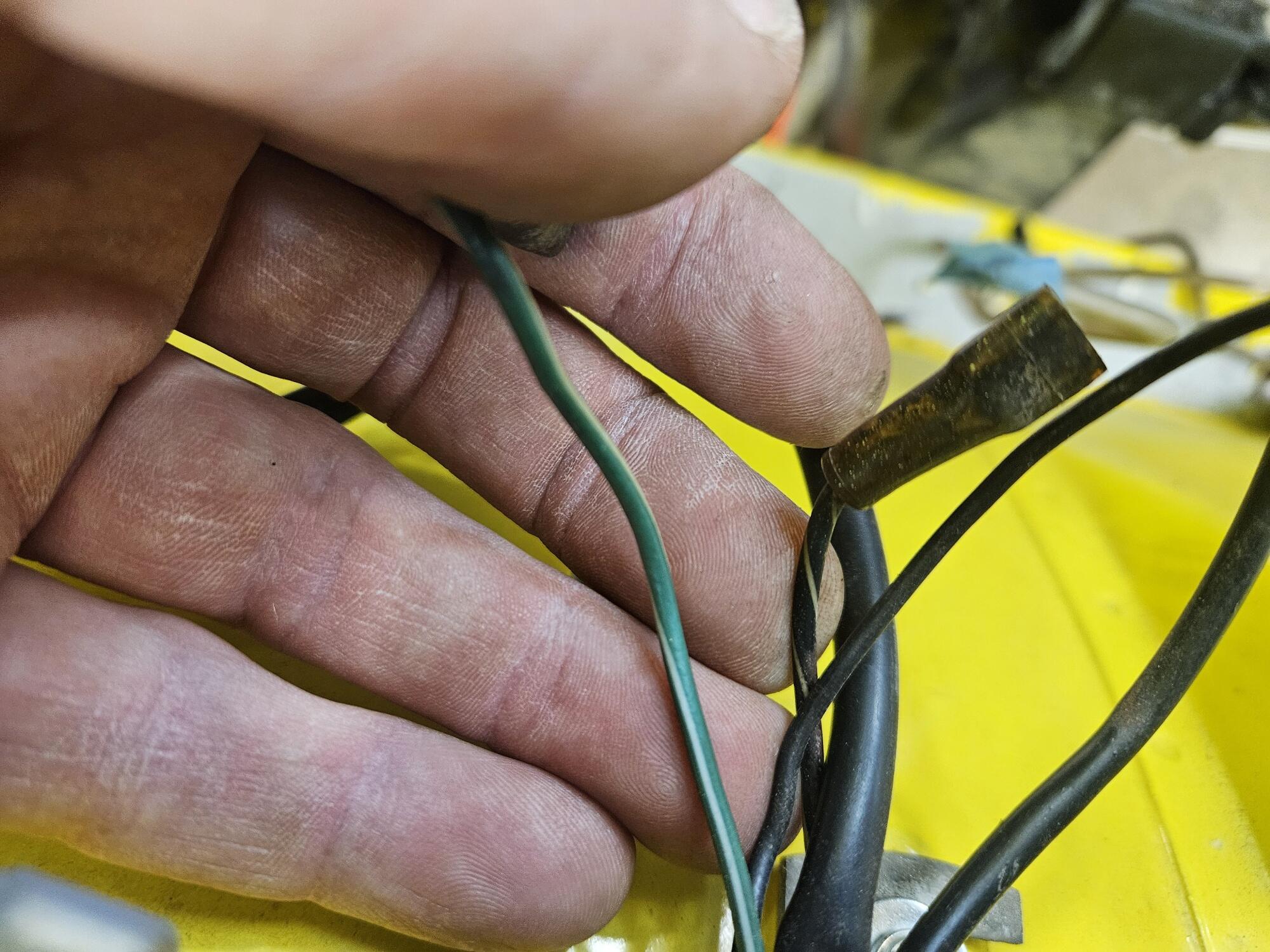

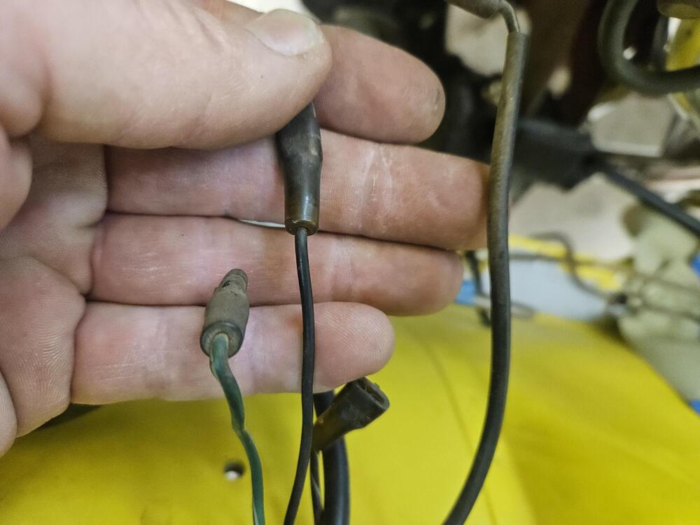

Can someone give me a short course on how these should go to the coil for a 280zx matchbox setup??
I grabbed a picture of a later ZX ICM, but this will work.
Coil positive to the +. Coil negative to the -. Coil negative should only have one wire going to the ICM.

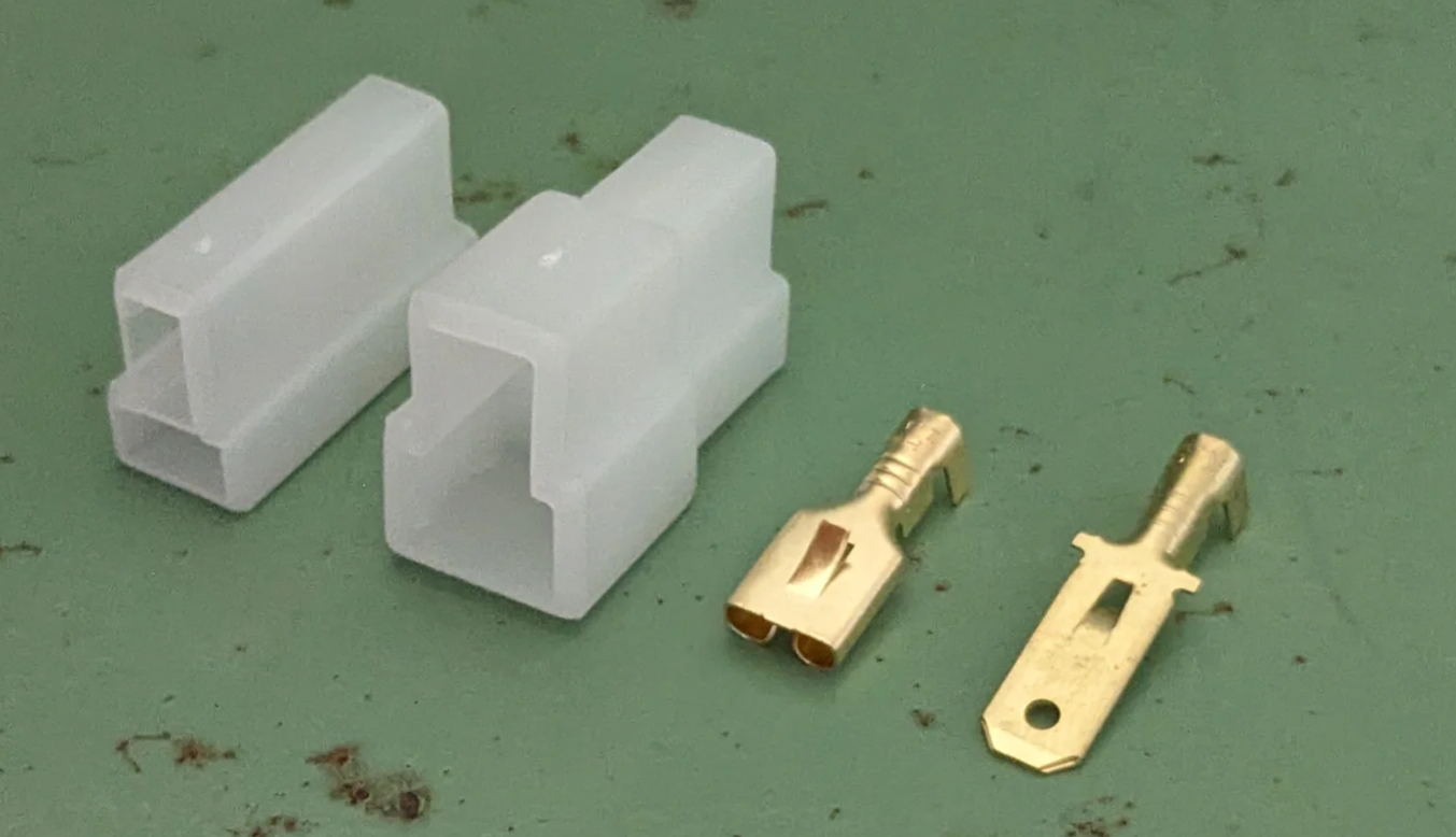

I believe the non-latching 2 pin 6.3mm connector from Vintage Connections should plug into it. https://www.vintageconnections.com/products/6-3mm-connectors?variant=46131501138241
Yeah, I have that part wired. It's the factory harness wires to the coil I am unsure of

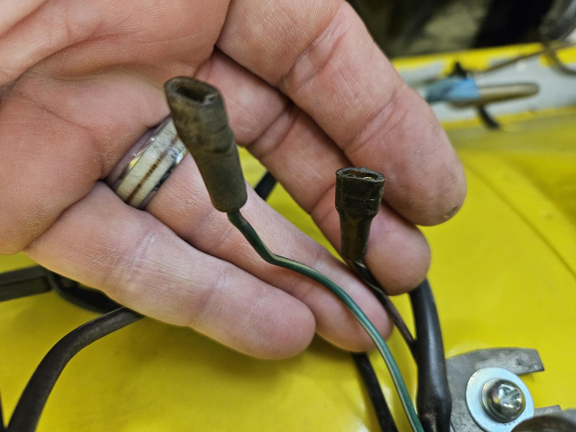

I figured out where the 2 of the 4 wires at the coil go. I have 2 left. I'm not sure what to do with them. I believe the Green one feeds the Tach which is currently INOP. I could use help with that so I don't damage anything

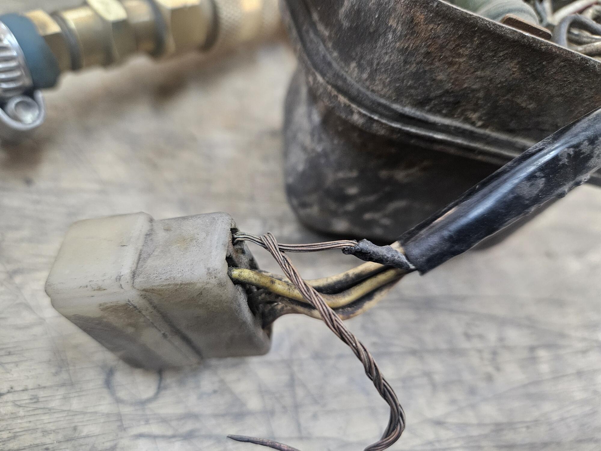

Its making noise!! Thats a milestone for sure. You may want to check the connectors in the passenger footwell that feed the dash. I had a wire that had backed out of the connector and even though the connector was plugged in the wires weren't connected. I think I have a large laminated wiring diagram if that might help, let me know and I can send it to you.
