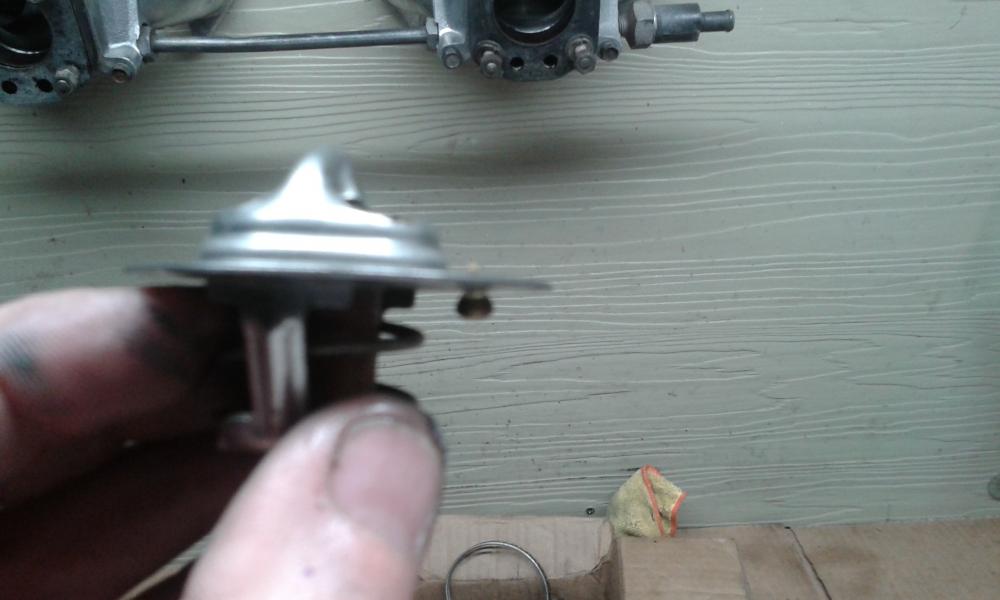

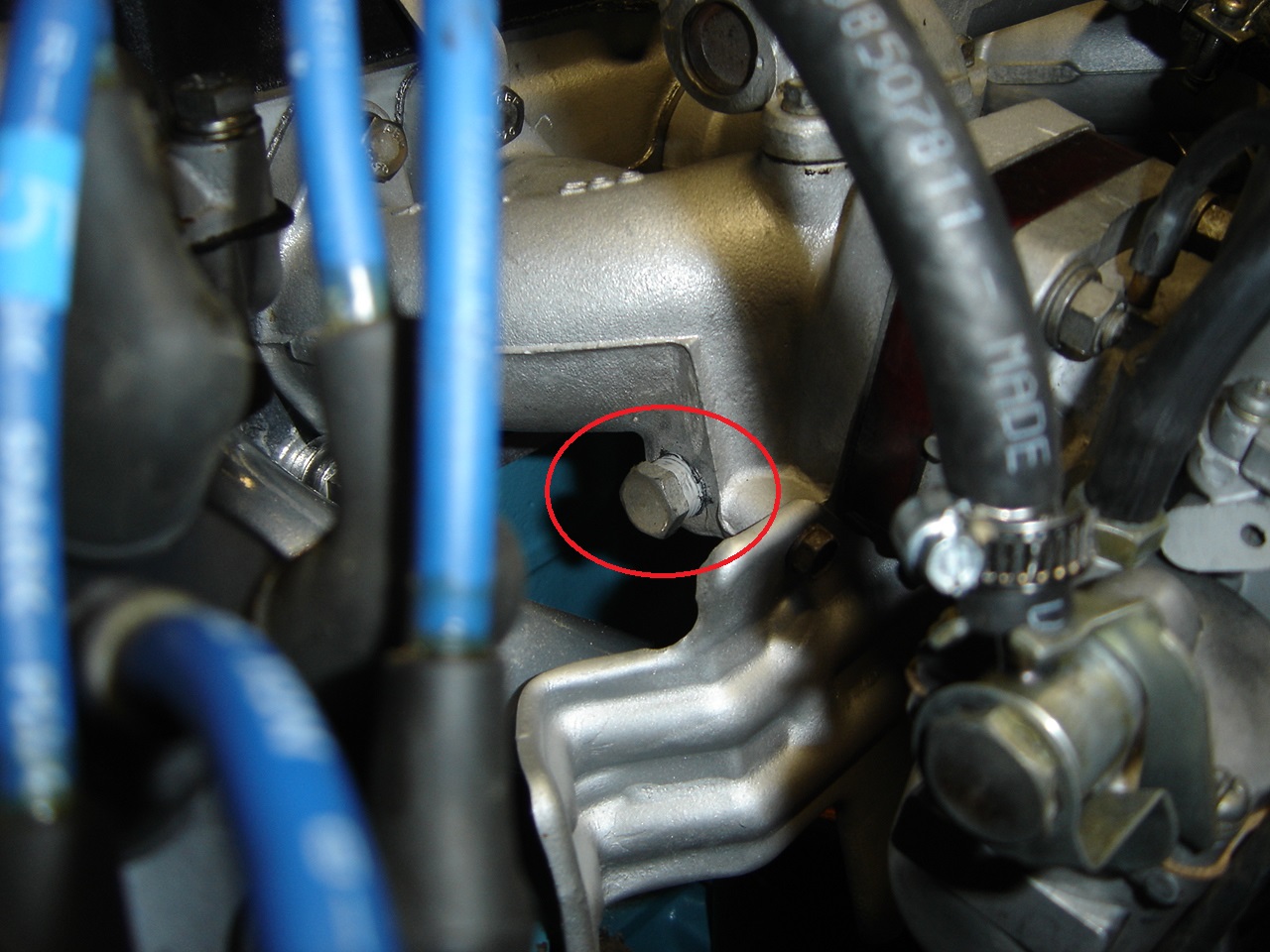

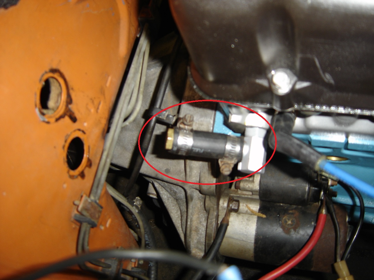

Could you tell me whether or not I should drill a small hole into my thermostat other than the small one it has now?  The one that has some type of lug hanging down and points away from the engine.
Thank you for any advice.

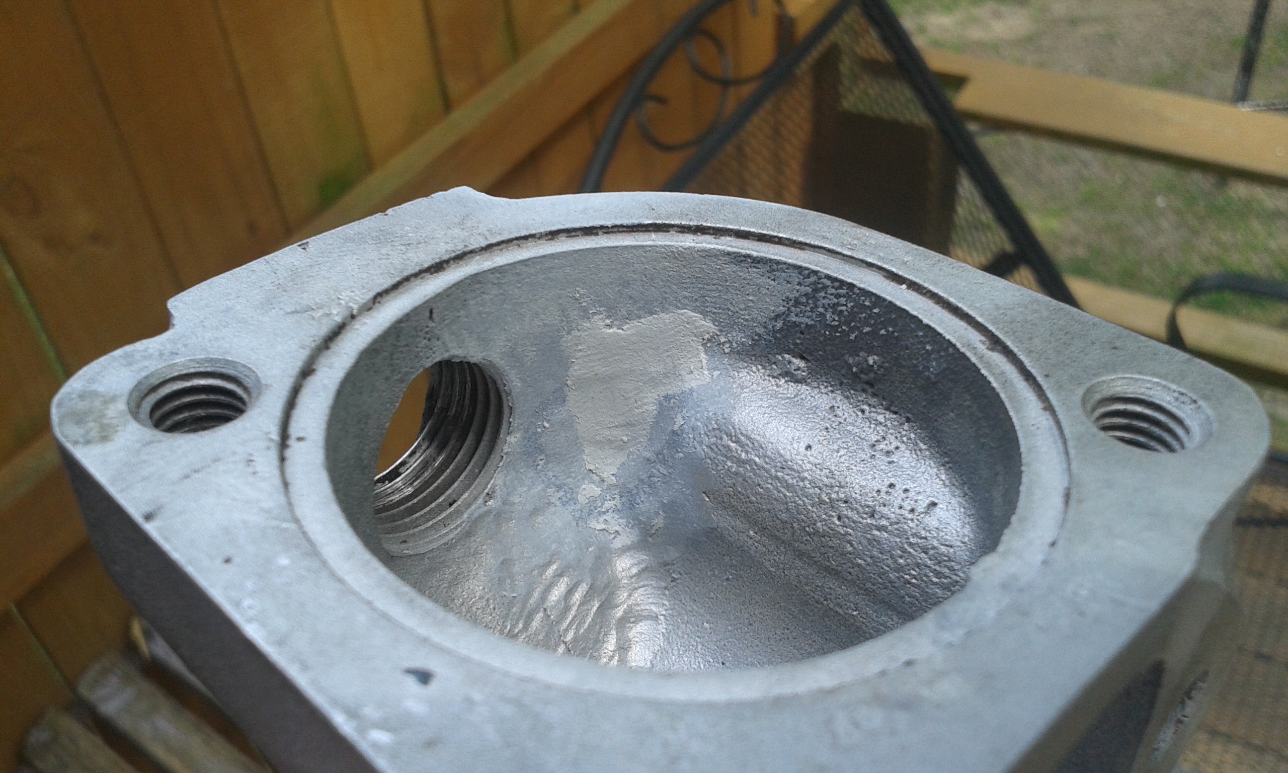

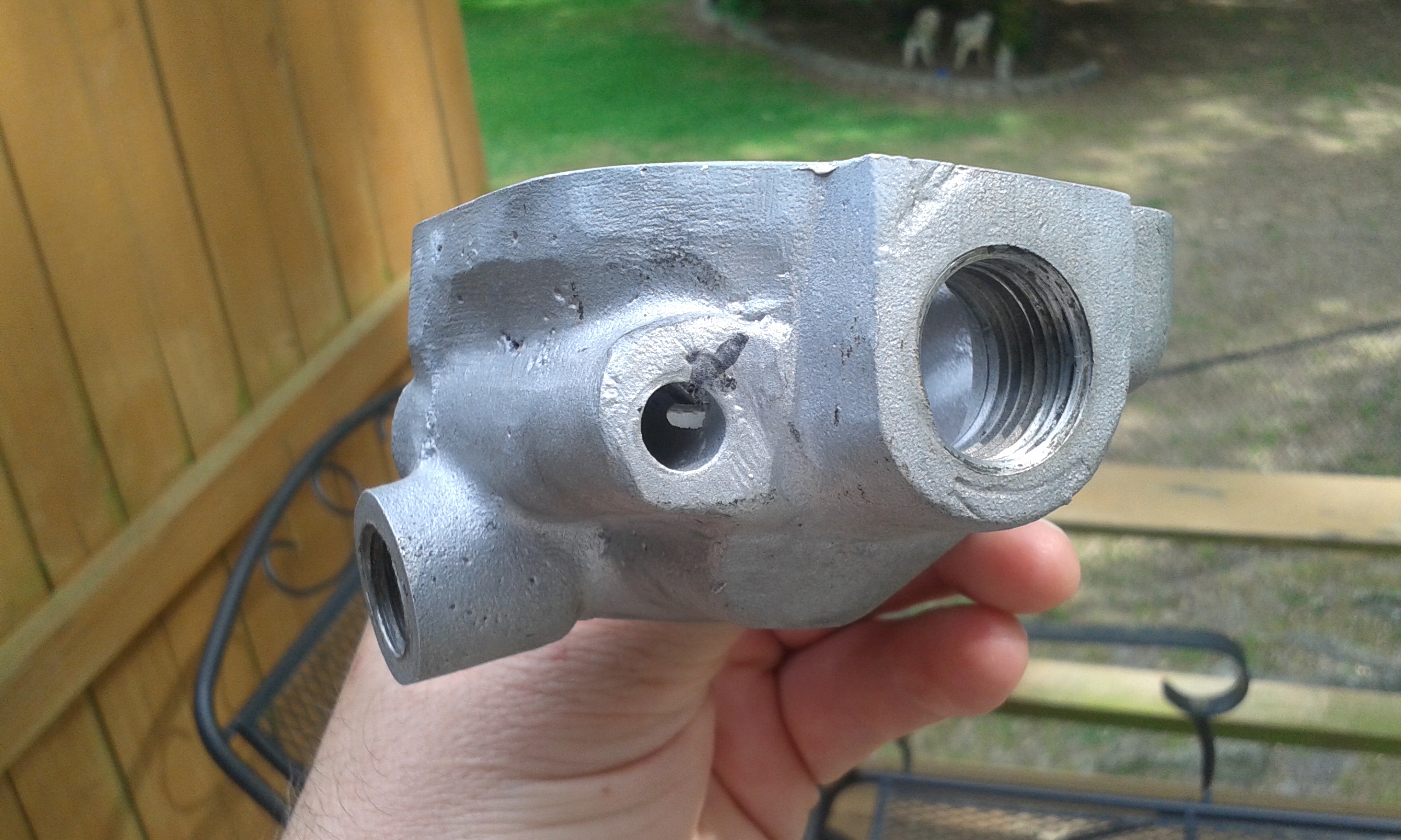

I filed my radiator this morning and clamped the over flow hose off then blew into the cap hole until my eyes started watering.  And lucky me found a leak I never knew about before. The lower thermostat housing had a pin hole that leaked oh so slightly. I filled it with water resistant epoxy  putty.  I'm waiting for it to harden then will sand and file the excess off.  Thanks again.

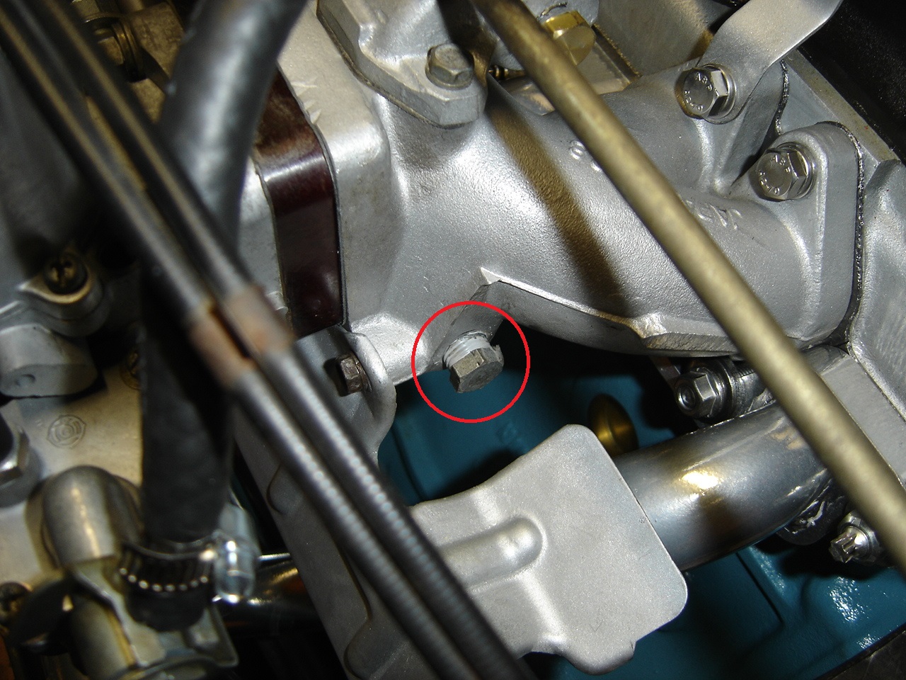

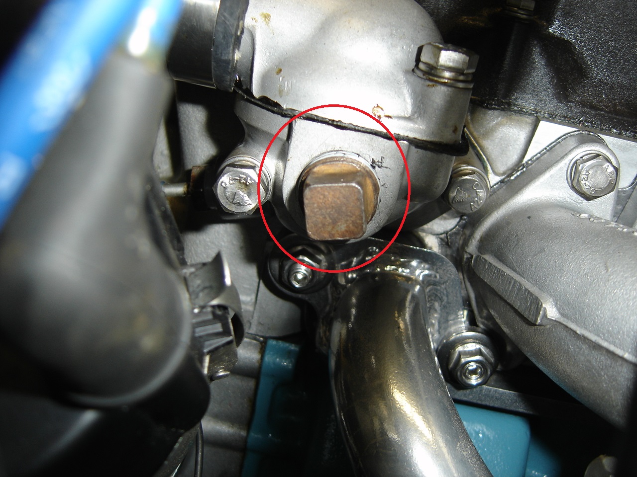

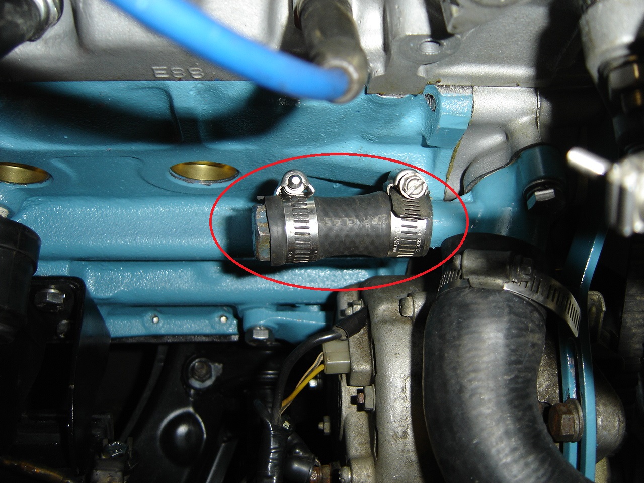

The chest pounder says that some flow back to the pump when the thermostat is closed is necessary to prevent cavitation.  Since you've closed off the manifold/carb route maybe another line is needed.  I wonder if How to Modify book has some suggestions.
Edit - nothing there.  They run open flow restrictors.  I don't even know why that "jiggle valve" piece is there.
