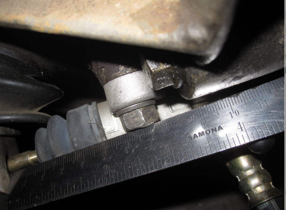

Okay gang, I got the transmission back up into the car ( @Dave WM your prediction came true!) ... but before I put everything back together and install my new exhaust, I wanted to check with you guys on the subject of clutch engagement.
I took some pictures of where the slave cylinder is sitting, because I can still push the fork lever in with room to spare... and I'm not sure that's normal... The slave cylinder used to press right up against the fork lever... it was tight... Granted, before all of this, the clutch didn't start to grab until the pedal was near the very top of its travel, so maybe with it like this it'll be more toward the middle.

With a new clutch assembly, the Clutch fork position will move towards the rear of the car when compared to a used clutch This is normal. Once you bleed the clutch, all should be fine. I'd bleed it and try it out first before yanking the tranny again.

If you had the wrong TOB collar you could have problems, either getting the clutch to disengage or to engage fully.  Your slave piston starting pont doesn't look bad.  Bleeding the clutch is very easy and you can tell if it's working by turning the shaft by hand, with a helper on the pedal.
I took a measurement of my fork distance from a reference point, just for people to check if they run in to a clutch problem.  It tells you if the fork angle is right.  About 58 mm to the head of the bolt. I also have extra room in the slave cylinder to push the piston back like you're doing.

I posted the measurement for a slighty used (20,000km) clutch in post #17 in this thread. It should be around 110 - 120mm from the front of the bellhousing to the clutch fork. Yours being new might be a little more than 120mm. I not sure what you are measuring in your photo, but you are on the right track.
You will be able to push the rod into the slave cylinder at least a couple of centermeters when the clutcb is new.

Notice also in EuroDat's picture that the fork is centered in the hole, like yours.  I took my picture from above reaching down with my camera.  The car was drive-ready, in the garage.
If I draw a mental arc in my mental image of Chas's pciture I get a mental 58 mm to the bolt head.  Yours is going to be fine, I can feel it.  Where's Dave's magical prediction?
interesting I did the same measurement (nut to fork) and only came up with 49mm, but the fork looks like a 90 to the housing. Will double check but 10mm seems like a big difference esp if the forks are in the same approx. position. I feel a mystery coming on, gotta think like Lt. Columbo and tie up some loose ends. I guess given the mechanical advantage the fork provides, even small variation is clutch plate thickness could cause sizable variation of the fork position (at rest, pedal NOT pressed down).

Okay, if it's normal for the fork to be able to move back into the transmission a bit with a new clutch then I won't worry too much about it.
