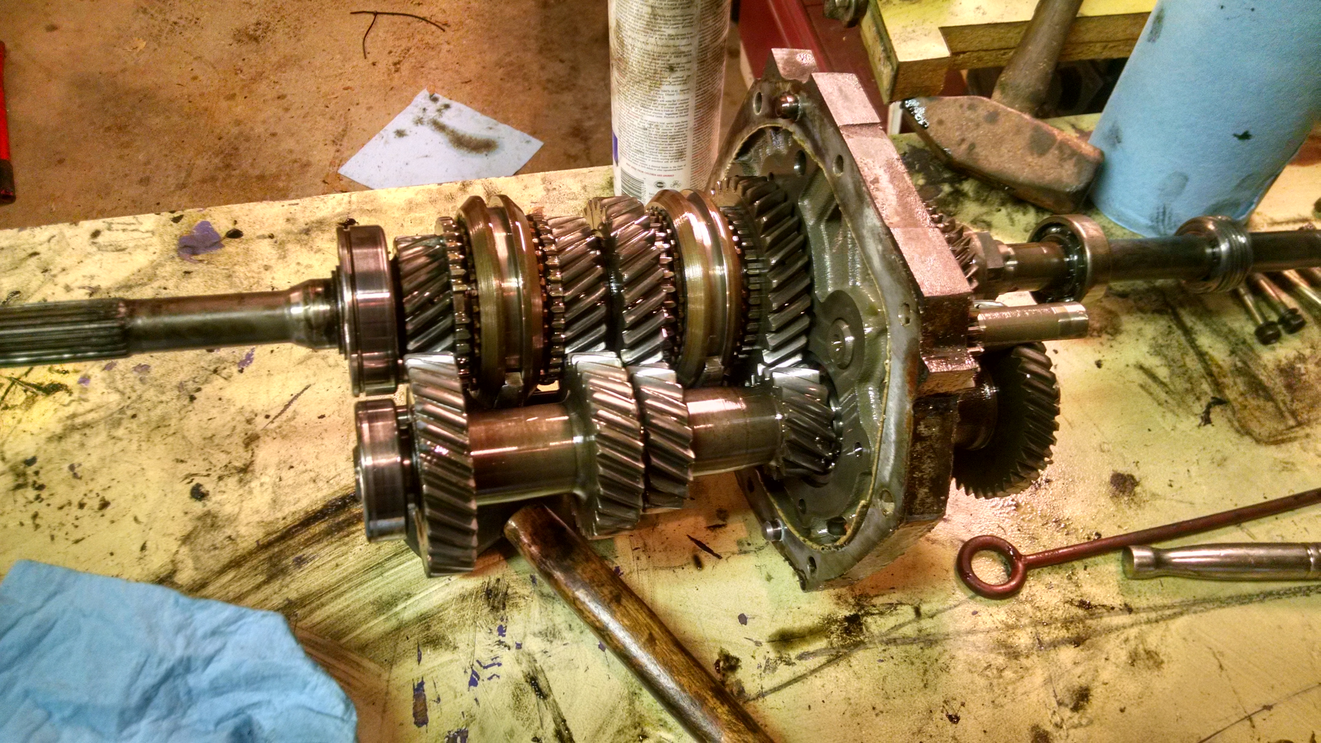

I've started dis-assembly, and I've reached a bit of an impass with the front cover -- I got all the bolts off, but I can't get the cover itself to budge.
I got the back cover off (I can see two of the bearings/cages and so far these ones look ok) -- and I can see some starbit/hex bolts ... do those need to come off to get the front cover off?
Also, I think I found my busted bearing culprit... It's the one right in the middle down below (second pic) ... is that the countershaft?

That looks like the bearing that commonly falls apart.  Good luck.

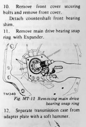

Here's an example.  The 1978 5 speed instructions will work.  Maxima manuals are hard to find.
Look in the forums Download area.  I'd post a link but the site is turtle slow today.

I've got the chapter for the FSM pulled up, there just aren't a lot of pics. In my last post, my 'stuck' place was the cover, and because the snapring for the shaft is underneath I can't pull the case off yet. I'm asking a lot of questions to make sure I don't beat on something that isn't meant to be beat on, or that I'm not taking something apart that isn't meant to be taken apart. Also since there's a question mark on what kind of tranny this even is, I'm just trying to be slow and methodical.
Thanks for the pic btw, I think I've got some similar illustrations in my '76 FSM.

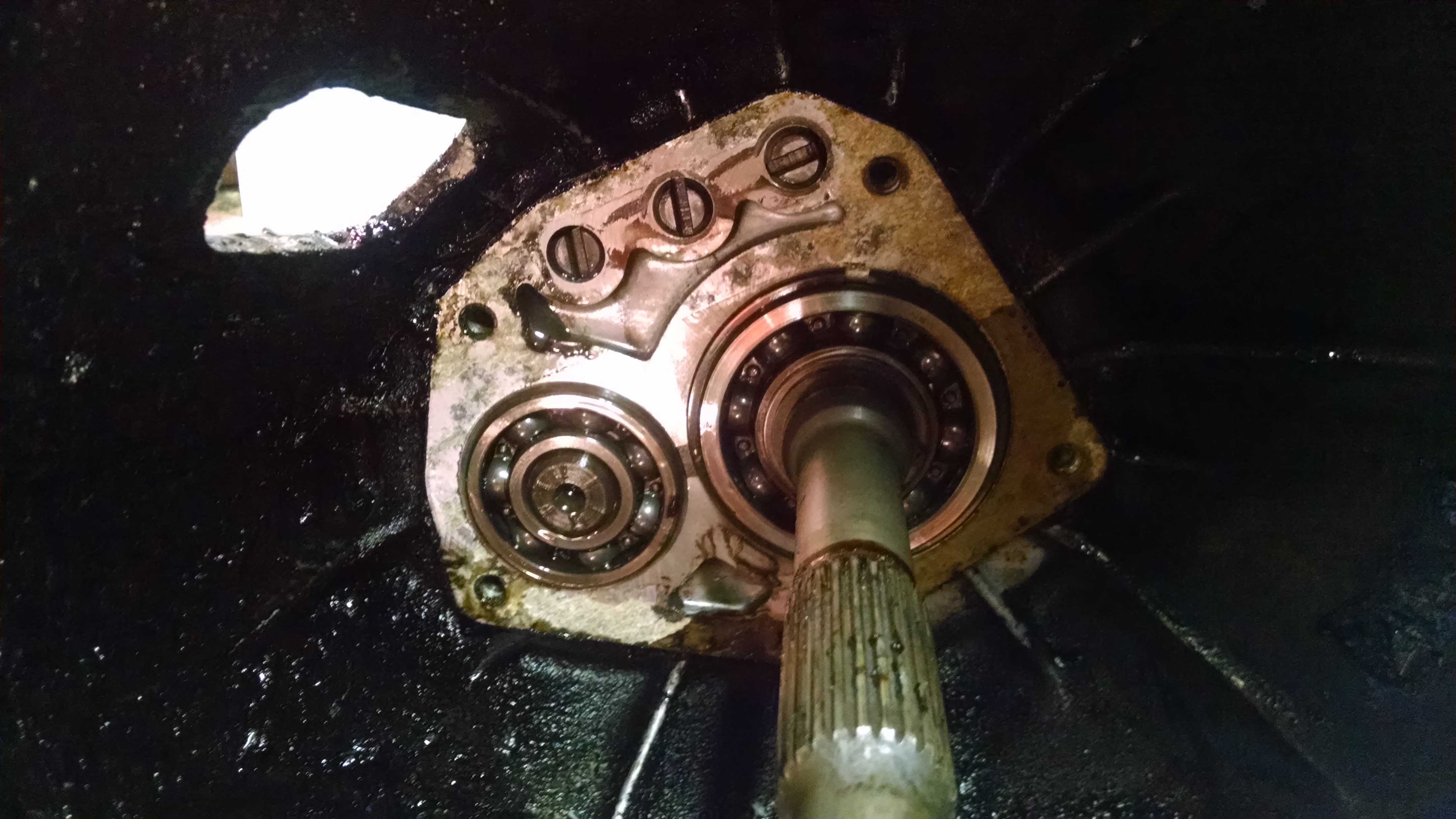

I took a few pics. Now that everything is apart, what else should I look for as far as wear is concerned? With everything free like this there is pretty substantial play in the countershaft.
Do I need to take everything apart to get to that bearing... or is there a way I can gently remove just the countershaft?

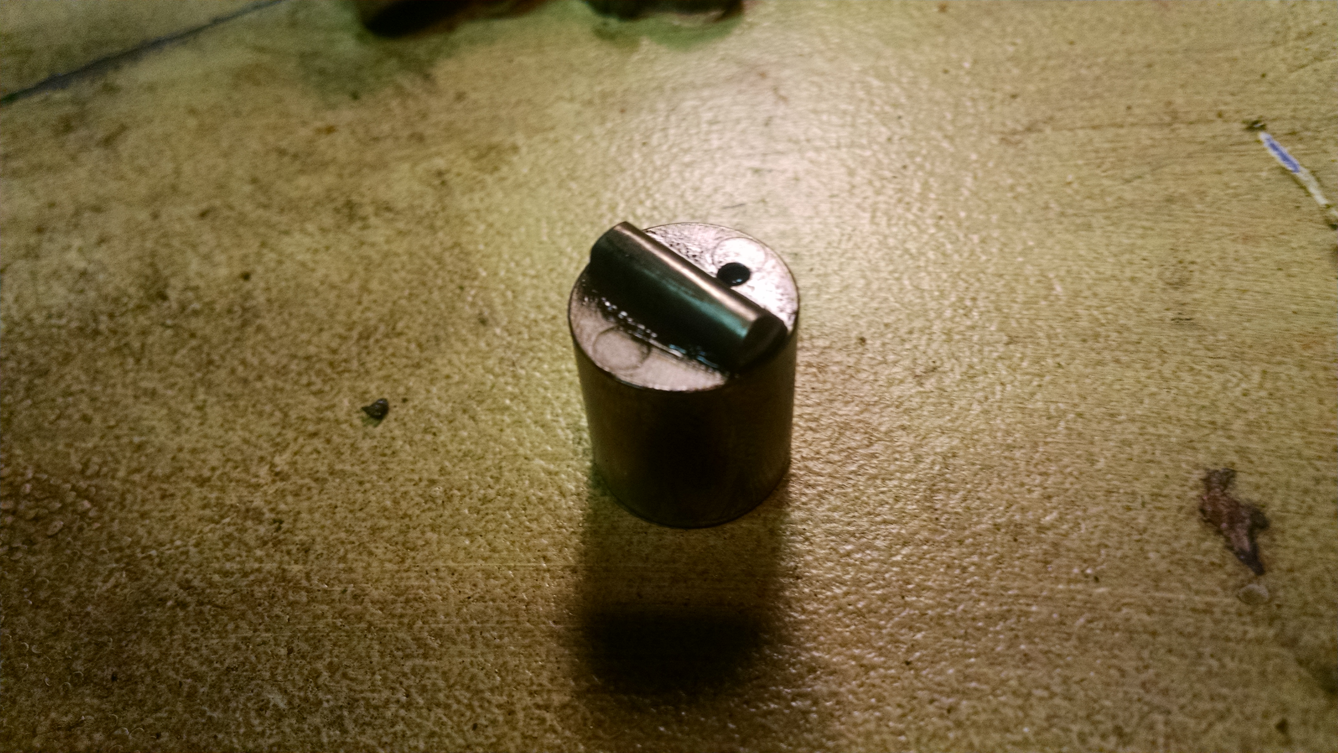

I stopped for the night because I found a part on my workbench that I don't remember removing. (Looks a bit like a cap -- I took a picture of it) ... what is it?

the unknown part to help prevent shifting from 5th to reverse on the down shift, part of the rear case. I mentioned that in my trans when I was wondering if the hole should be on the top or the bottom. should be as spring somewhere as well, hopefully still on the bolt. This mounts the side of the case, has a kind of diamond shaped housing held on with two nuts.

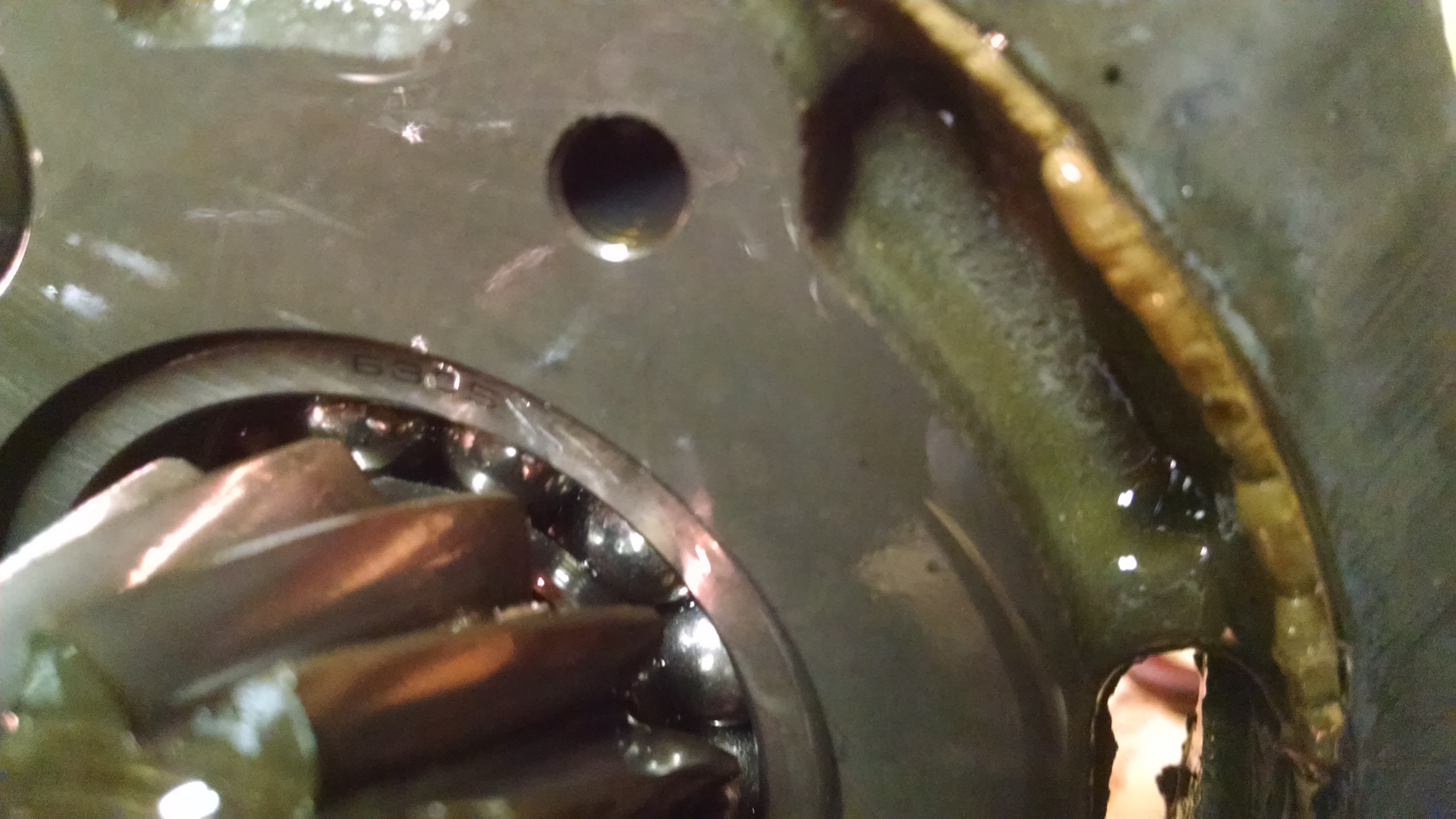

The oil gutter is missing completely on yours so you will need. I will dig around and get that part number for you, you can order from courtesy Nissan. Check the rear housing see if there is a long trough that lead all the way back to the tail, it matches up with a hole in the plate that in you pic has nothing installed.

Okay, so that part goes into the back. It would make sense that it came out -- there were still bits of chewed up bearing jingling around in the back half, so I gave it a few gentle shakes to get it all out, and must have knocked this thing loose also. I'll try to figure it out where it goes.
The back half of my trans is a different design than yours though -- I don't have that removable plate that's secured with two bolts that lets you get at that rod from the side. All things being equal, I'm probably going to leave much of the rear housing alone, save for replacing the rear-most seal. There's actually a spot on the underside of the trans tunnel on the car where you can see trans-fluid hasn't just been leaking out, but has been flung at speed, presumably for decades. Also got fluid leaking when the prop-shaft came out too.
Oh and since my rear housing is different than yours, I will definitely check for that trough, but yes if you can find me that part number that would be awesome!
