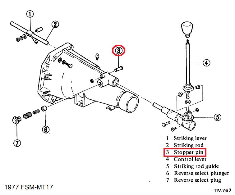

You have the neutral detent on that side back in the rear extension. Its the one with the drain hole Dave mentioned. It's purpose it to centre the selector to the 3rd, 4th line. Nissan calls it the reverse selector plunger. I don't have a good photo of it, but you can see it in this diagram as POS 6 & 7.
Note: When you put it back together cover the ends of the stopper pin with a good sealant. The is a place that can weaping oil over time and make a mess. It won't run out of there, but it will be enough to gather dust and build up over time. A drop of oil can spread a lot.

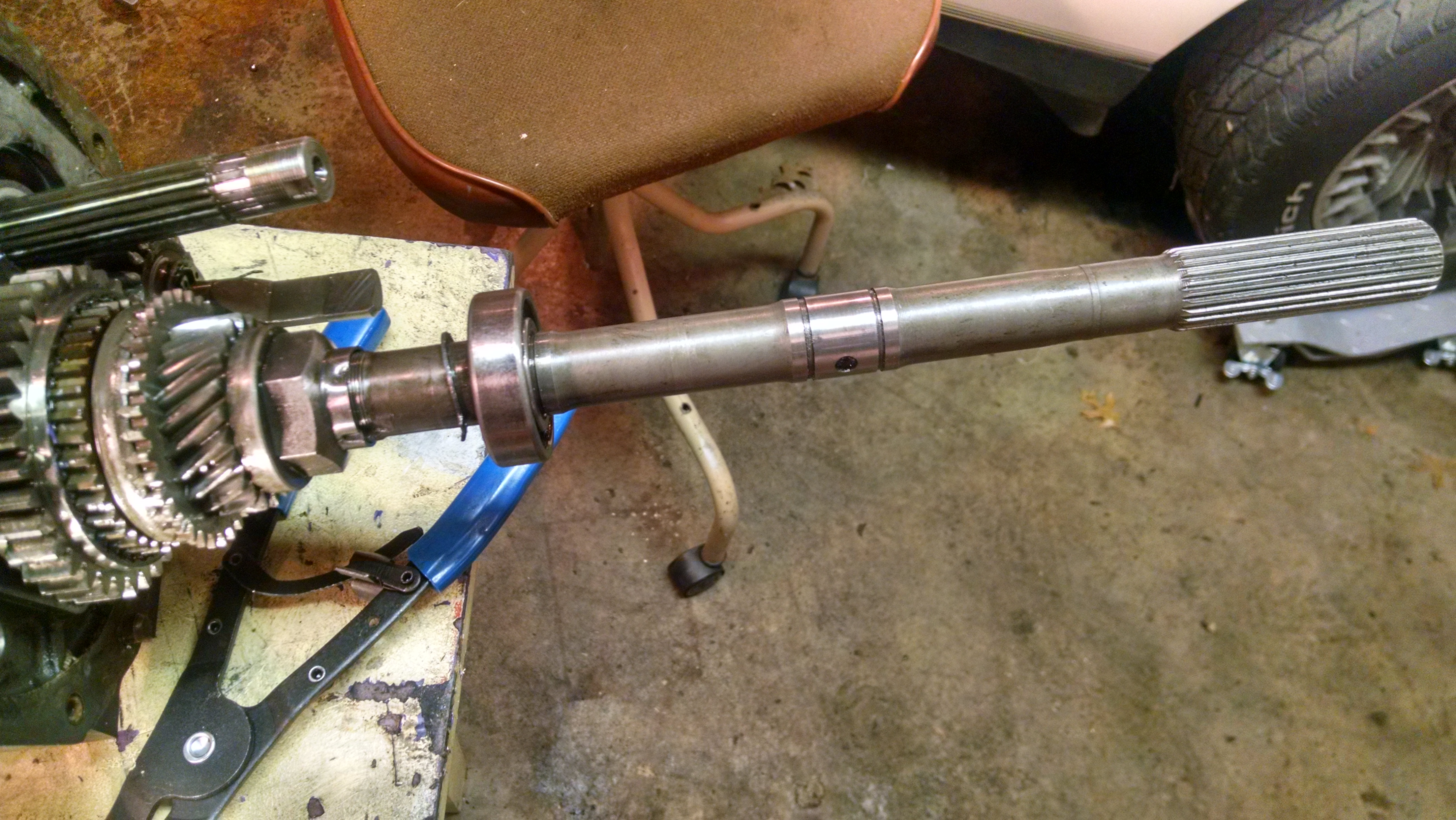

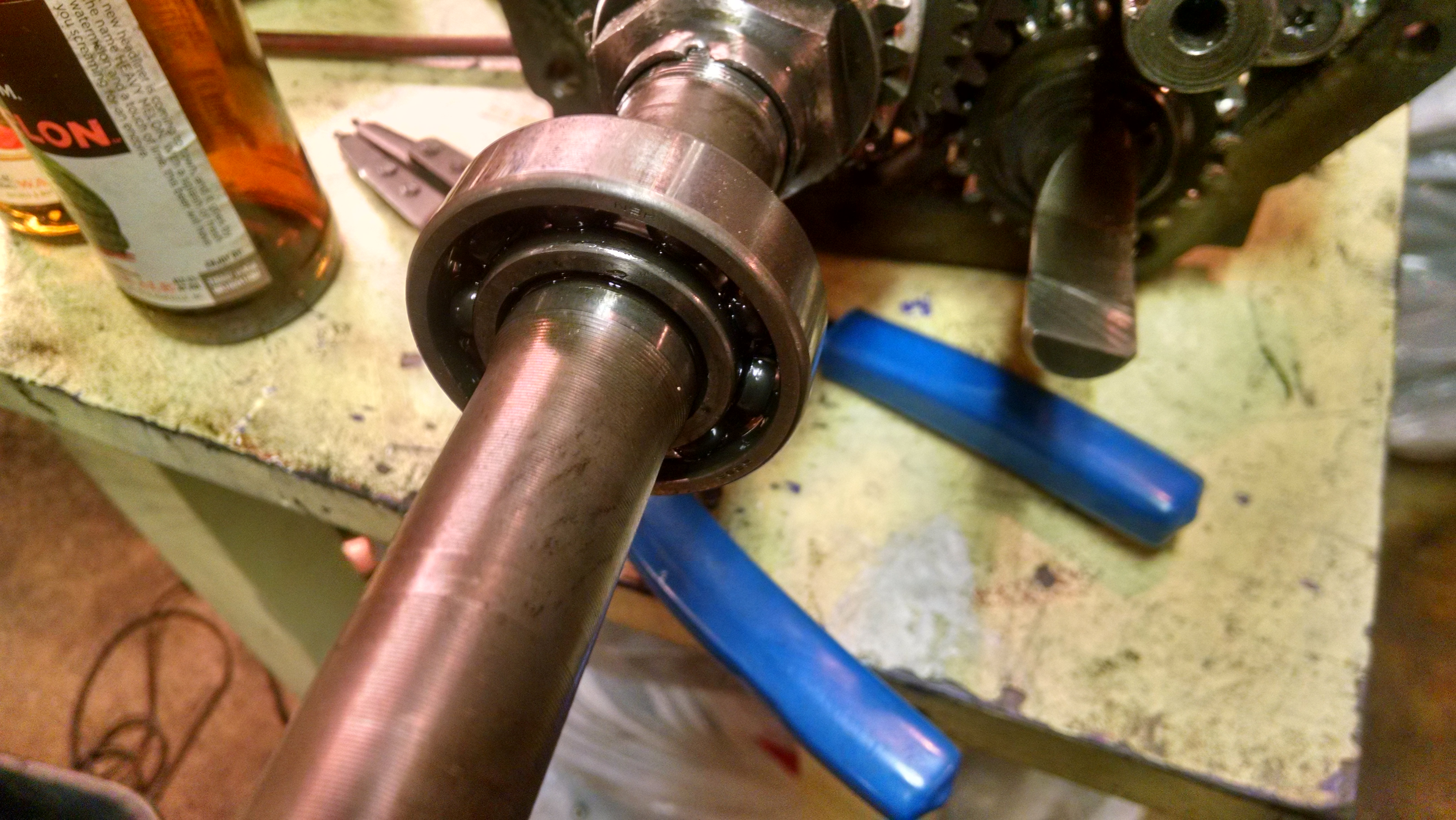

Got another quick question for the crew here. What's the best way to pull off this bearing that's kind of out here in no-man's-land on the shaft? The gear puller I've got isn't nearly long enough.
Other than that, I'm slowly getting into it.
Clutch forks and rods are out, as well as all of the little balls. I've kept everything neatly separated and labeled with a paint sharpie where and when applicable. Just need to figure out how to get this sucker off before I go any further.
Also that nut on the main-shaft, IIRC, is reverse threaded right?

there are 3 videos by the same guy. The second one starts about where you are now. If nothing else it gives you an idea of where force is needed and how much (he really whacks that main shaft to get it free from the bearing). On mine I only had to replace the rear most counter shaft bearing. I heated it up some with a 100 watt light bulb (5 min maybe sitting right on it) and it just slipped right on. heating and cooling are effective means for installing bearing if you lack presses.
I agree with Dave fully. A simple hot air gun can make all the difference.

@EuroDat Cover up the stopper-pin with some sealant? OK. That's simple advice. Thank you!

 I've removed that bearing with a little heat, a 5/16" pin punch and a hammer. Make sure you put the punch on the inner race. First hit, you'll see it move. I tap on one side, twist it 180`, give it another tap. etc.
