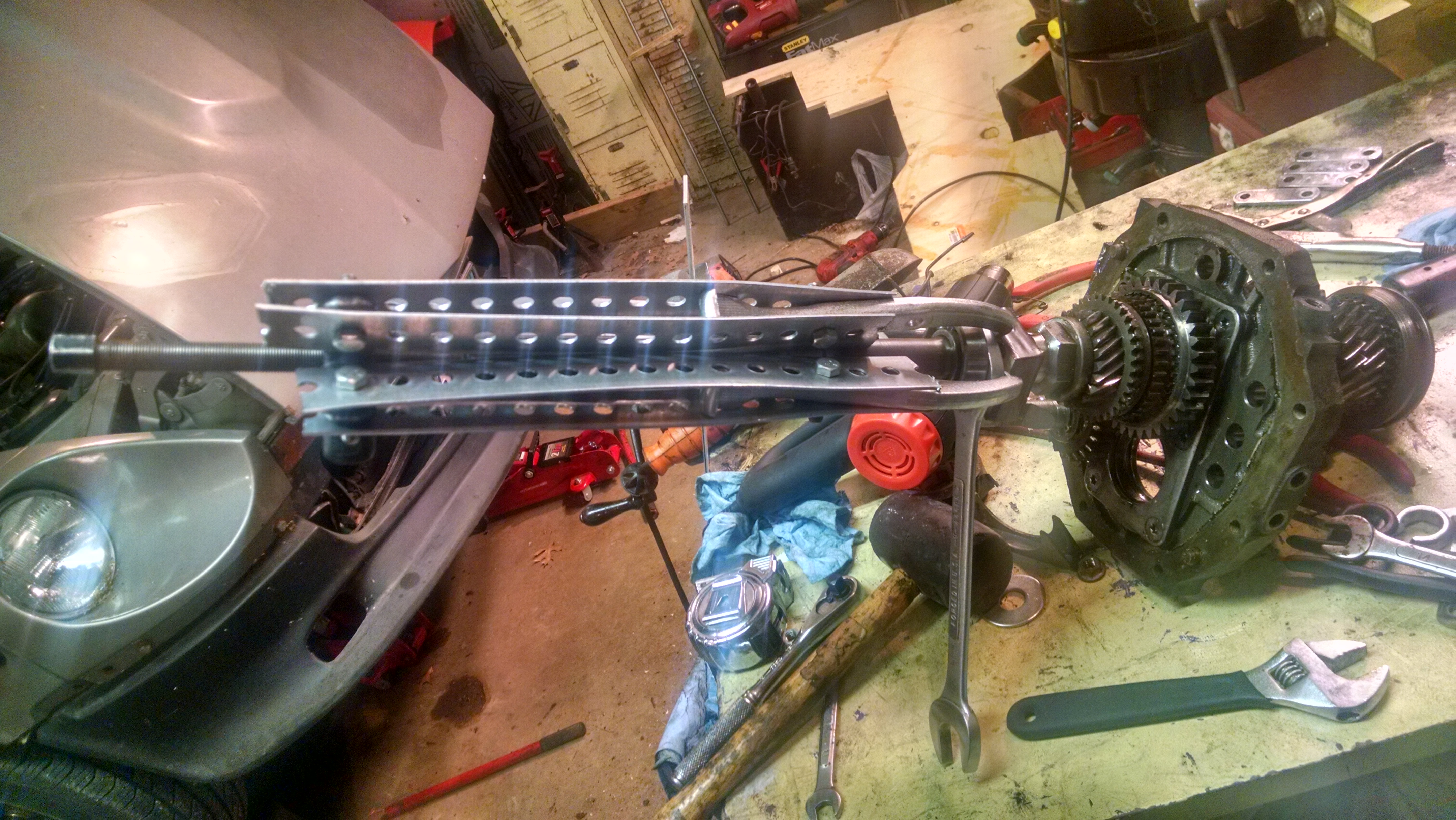

I managed to use the gear puller and "improvise" a way to get that shaft bearing off... which involved some metal pieces with pre-drilled holes (thanks to the hardware store) ... which extended it out the needed 12/13" to pull the bearing loose. I used a 1" wrench to go between the puller and the bearing so I wouldn't harm it.

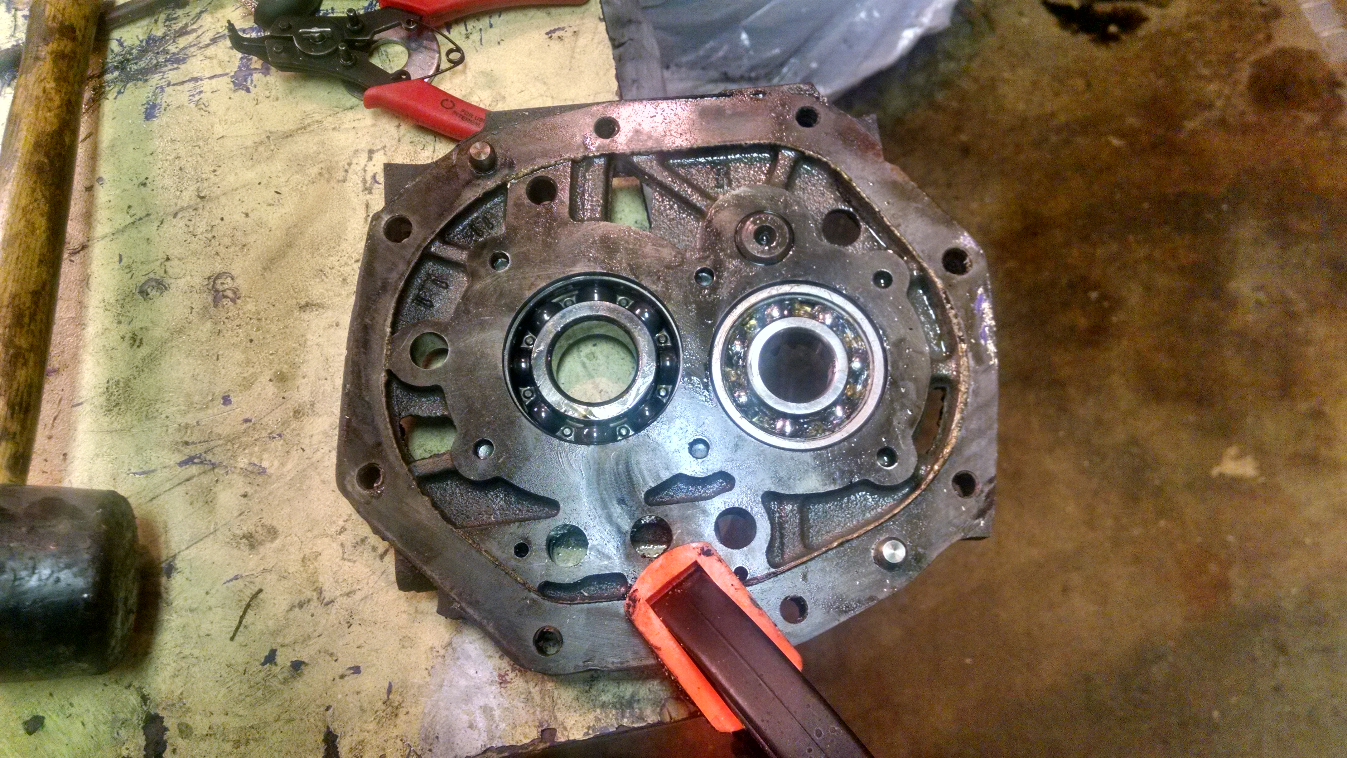

With those things both free, I got the new bearing into its home (6503 with C3 tolerance, came in the mail yesterday!) and used a punch to make sure it was seated completely around the edges. After that it was a matter of gently pushing both shafts back into their respective bearings and pounding them in all the way. I had a brief hiccup with the main-shaft, since there's a shim or washer of some kind that has to slip over a little ball-bearing lock, so I had to back out and re-align it, but once that was where it needed to be, I was home free.

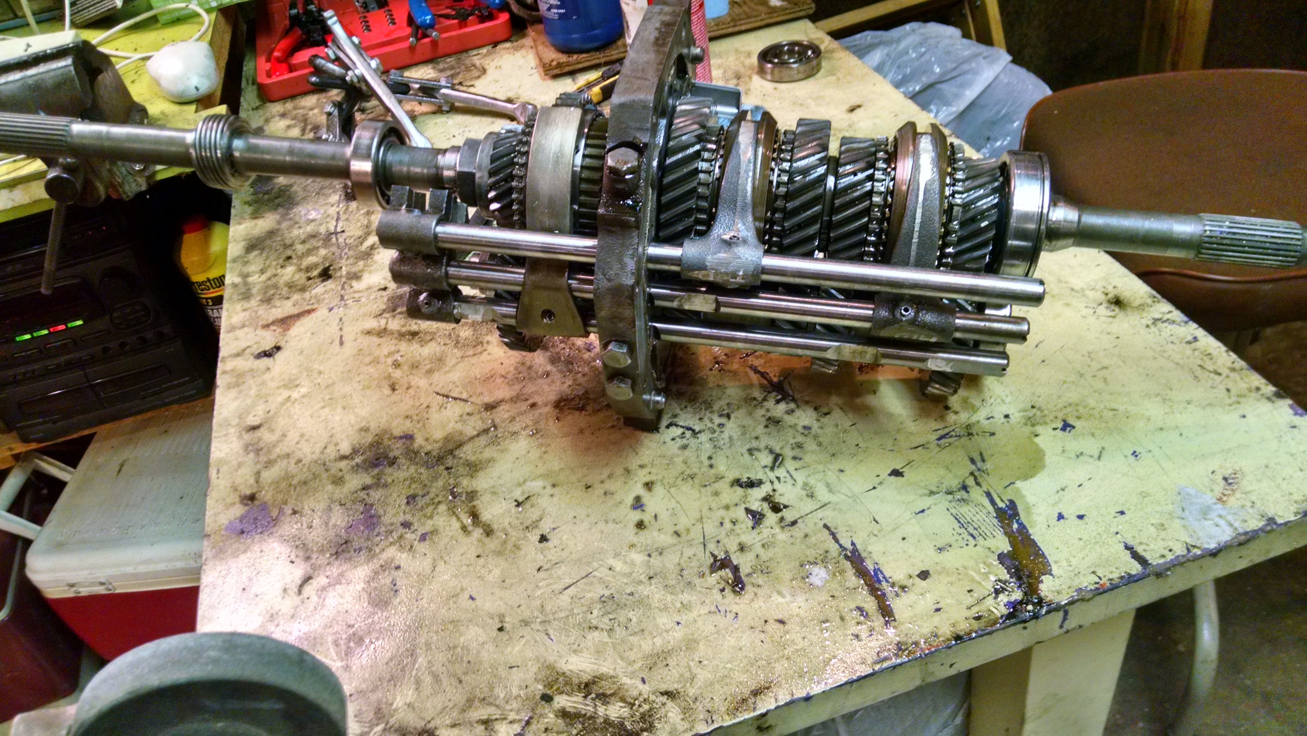

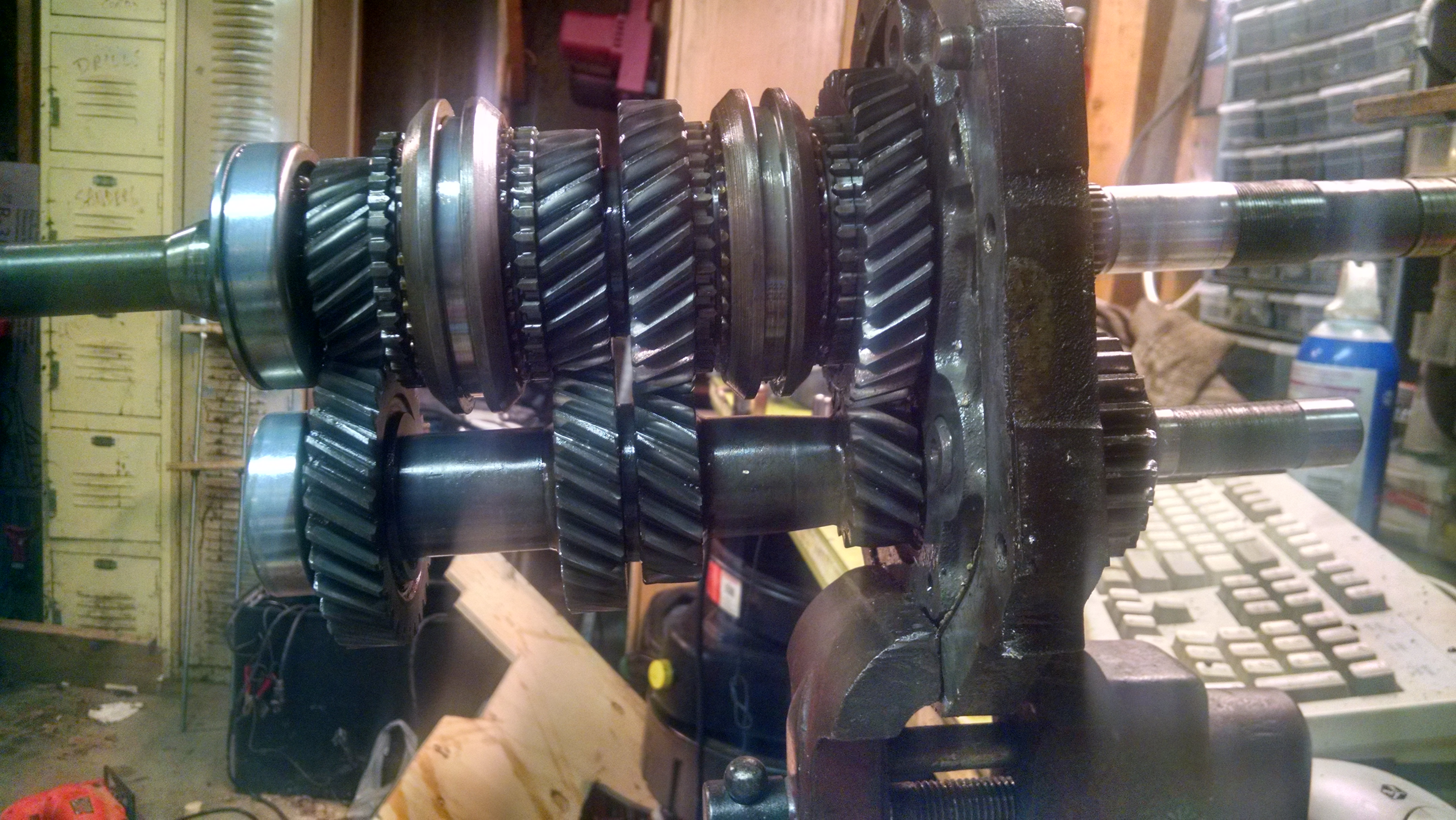

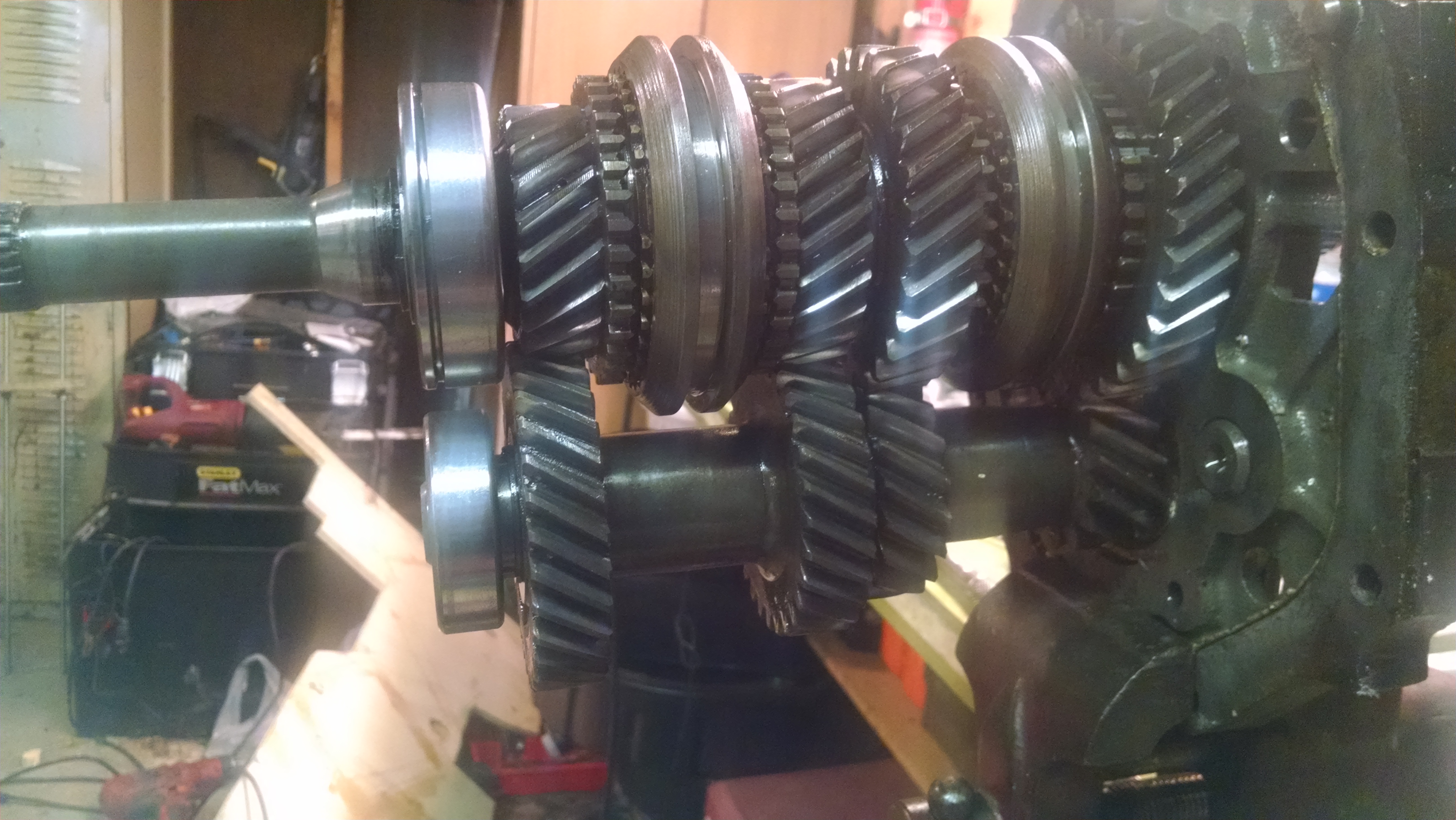

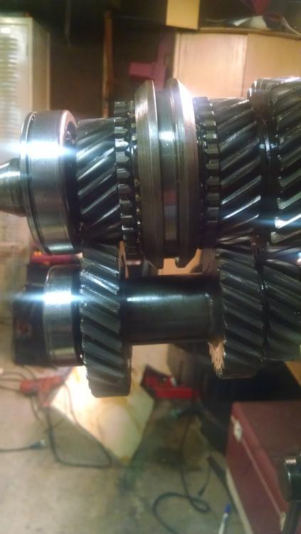

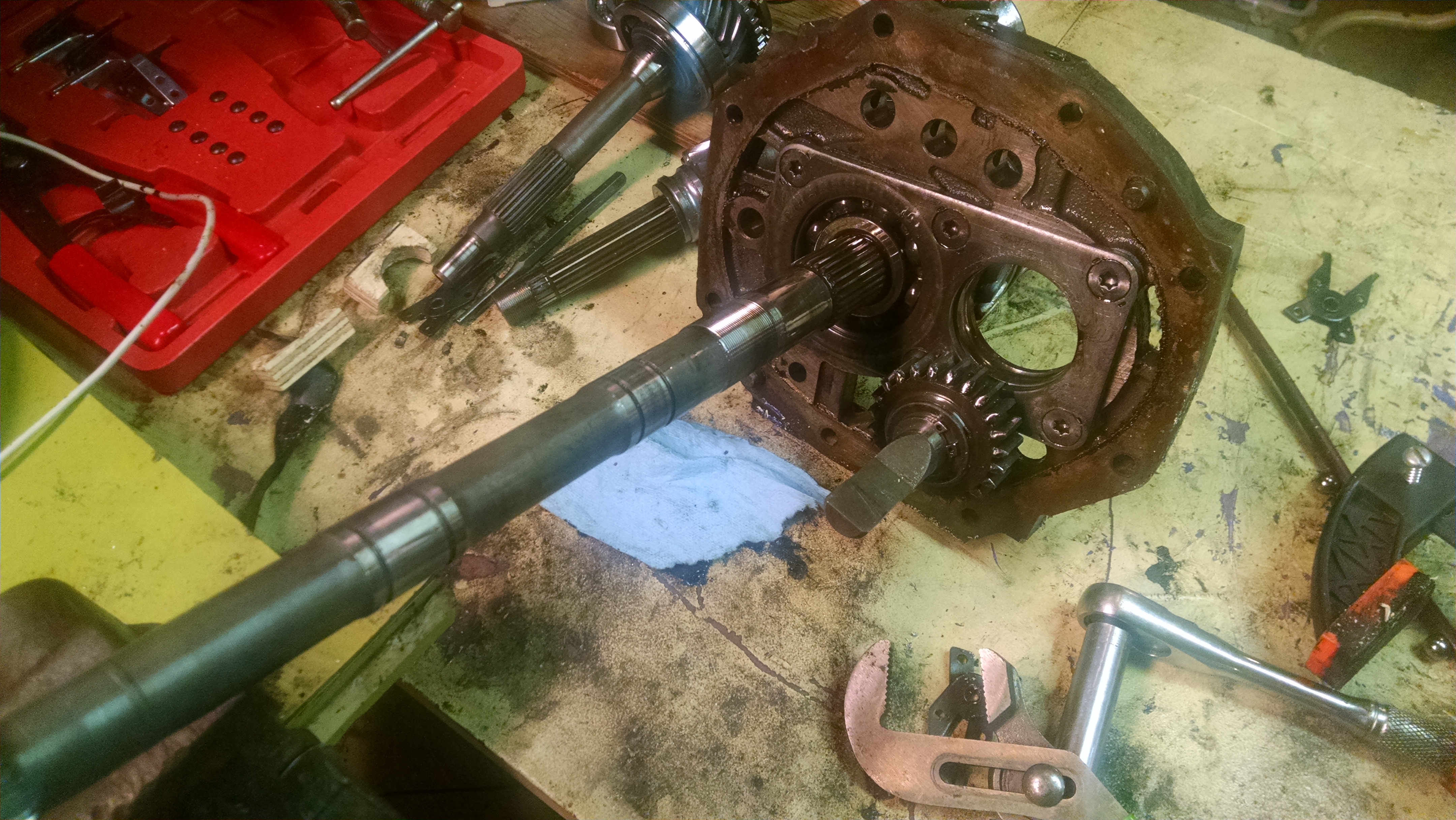

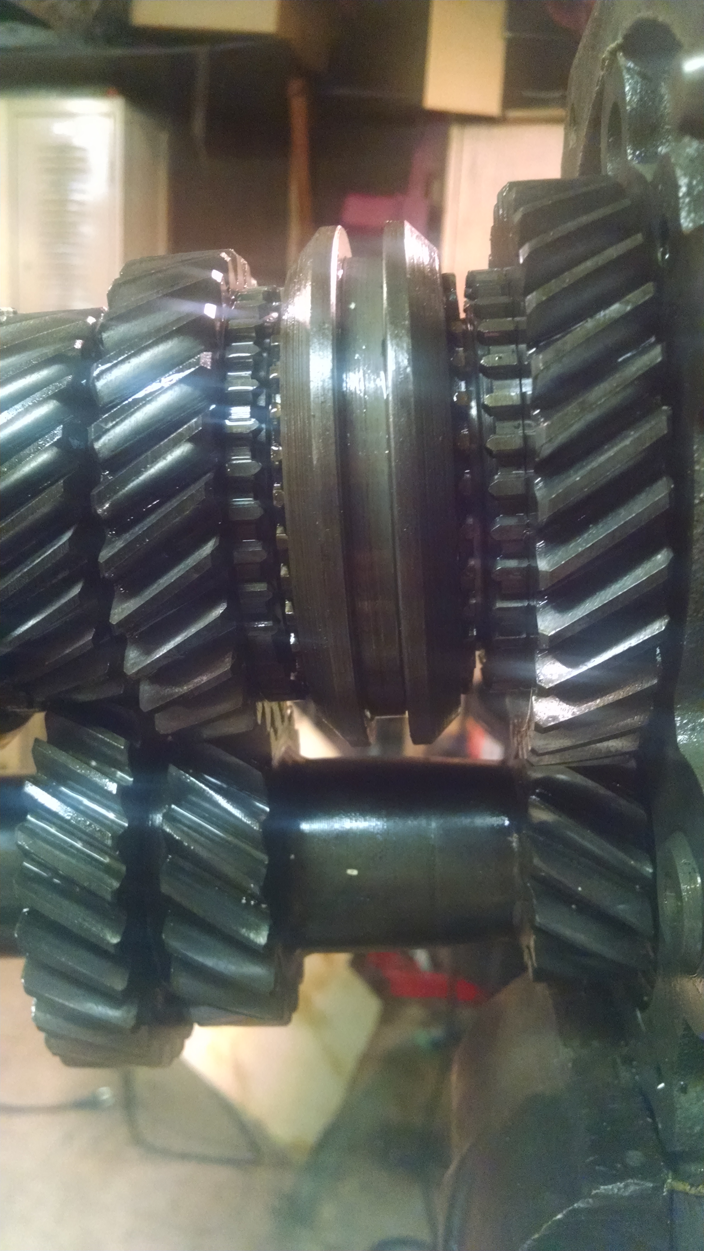

I didn't really molest or disassemble the front parts of the main-shaft nor countershaft in any way, so it should be good to go. I've attached some pics of everything meshing up. Do I look okay here?
Only hiccup is that I forgot to slide a shim over the backside of the countershaft as I slid it in... so now I have to remove the reverse idler (which I was trying to avoid) to slip it on there. D'oh!
Is there anything else I should be looking at or keeping an eye out for as this thing goes back together? Thanks again for your help so far everyone.
Alright, I've got all the gears and shafts put back together. The clutch forks are back in, and once I get some silicone sealant, I'm ready to put it back in the housing.
No extra parts - nothing missing! So far so good.

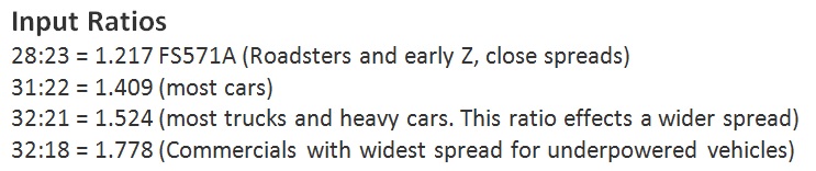

Those ratios are from a 820, but the input shaft is from the 720 truck. I think its the combination that came omn a limited number of the 720 trucks. Normally you would have a 22/31 input ratio, but you seem to have the truck version which gives you the low first gear and an odd final 5th ratio. Aarh btw I'm no expert on trucks so I'm going on approximate knowledge here if you know what I mean.
One thing I can give you is a calculator for your ratios. Its an Excel file you can play with. (Had to zip it to upload). I guesstimated the reverse for the form. If you change the input to 22/31 you get the Datsun 810 (from June 78). These transmissions are getting old and if you like to play with them, you can make some wierd combinations. It is possible someone changed the input shaft or it could be original Datsun (Not from a Zed).
BTW. Looking good. Not parts left over when you are finished is a good sign.:D

Looking at this spreadsheet (http://www.gracieland.org/cars/techtalk/gearing2.html), it looks like a the gear ratios (at least gears 1 through 4) are identical to the 240/260 transmission ( F4W71B)
The same ratios were also in the 620 it looks like (as a 5-speed) though again, I can't find anything like the ratio for my 5th gear, as you mentioned, so I suppose it's possible something got swapped around at some point. Who knows.
Thats was my conclusion as well. The problem with the 620 transmission is it has a short rear extension. Well that is what I have read about them.
The F4W71B was build for a 3.364 diff. That can explain why it uses the lower gearing. The 5 speed in the 280 wss for the 3.54 diff.
The 5th ratio just doesn't make sense in you tranny. Something must have been changed somewhere in its life.
