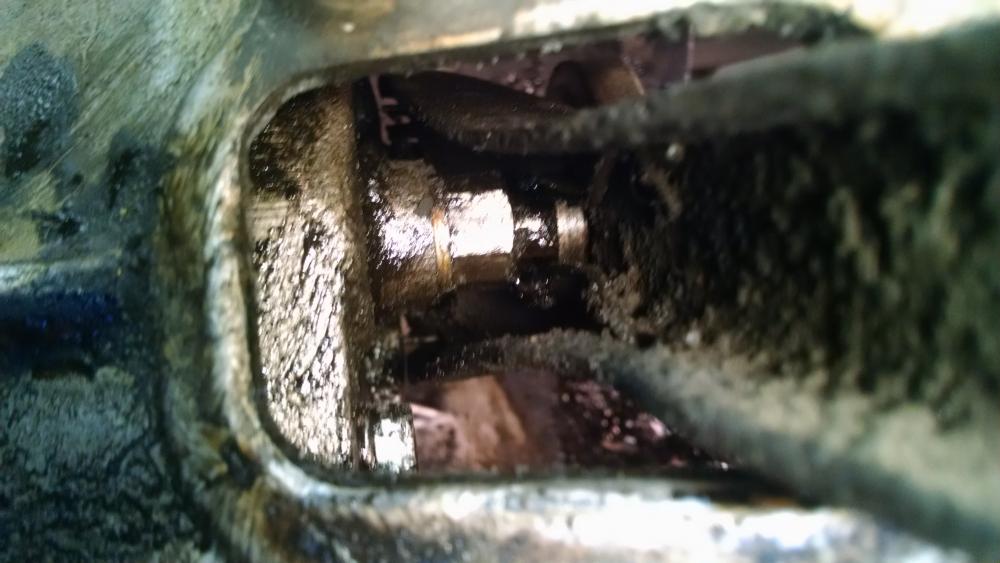

Only question I have left is about the little "fork" that pushes against the throw-out bearing.
It feels a little "wiggly" but I'm not sure if that's going to be an issue, since it's the pressure plate that keeps it all pushed back into place, right?
Yes, the fork and TO bearing are wiggly, but make sure that they are both properly clipped in to place.  The TOB on the fork, and the fork on the pivot ball. Also, did you seal the threads on the pivot ball?  I ad a transmission that leaked from there and had to pull the transmission again.  The threaded hole ends in the fluid area.
It's less wiggly now that the I have the rubber boot in place, but ok good to know on sealing where the little pivot ball is. I haven't put the transmission back into the car (yet), so I can pull that off of there and seal it up quick. You might have just saved me from yet another headache! Thank you!
