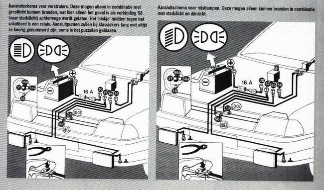

Hi lights,
are you both working with relais?
I'll attach a picture how to deal with this matter

Rolf,
Thing is, every lamp set has his own relay and own wiring. The fog beam and the far beam also. Otherwise the amperage gets to high as you already mentioned. Perhaps you could also install a dynamo of a 280ZX?
What you need is a normal kind of relay with 4 poles 30, 85, 86 and 87. With this and lots of wiring, you can use both sets at once. Even in combination with your standard headlights.
And for the headlight circuit you also have a solution to minimize the amperage.

There you find this link: 240Z Headlight Relay Circuit, this is also very useful and will kill amperage through the wires and headlight switch.
Good luck
Guus

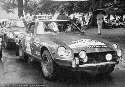

Here's a picture of Fall and Halloran in TKS 33 SU 4080 before they retired:

Jeff Beaumont and I were part of the official factory "Datsun" team (before they
changed to "Nissan") in the 1973 Southern Cross Rally. The other team members
were the late Tony Fall / Steve Halloran, Shekhar Mehta / Roger Bonhomme, all in
240Zs, and Frank Kilfoyle/ Mike Osborne (I think) in a 180BSSS. Mehta had won
the East African Safari that year. Bruce Wilkinson ran the team .
My car had been previously run in the Monte Carlo Rally that year. It was left
hand drive, had heaps of power and a lot of traction at the rear, so it was very
prone to understeer, which made it very hard to drive. Tony Fall took me for a
drive during a testing session in the Kinglake forest, and his technique was to
constantly weave the car so that it was always in a slight oversteer attritude,
even on the straights. His comment was "if the bastard understeers, your'e
dead".
The rally was one of the wettest Southern Crosses ever - only nine or ten cars
finished the course. Tony Fall hated driving the Z in the wet, and more or less
indicted that the sooner he retired the better. Sure enough he rolled near the
end of the first night, and was last seen disappearing into a caravan with an
attractive girl. The rest of the team soldiered on, but Andrew Cowan inevitably
won in a Mitsubishi Lancer (one of his 5 Sothern Cross wins). . Kilfoyle
finished seventh, I think we were ninth and only one other car finished behind
us. Conditions were atrocious, and I must say it was one of the scariest and
most difficult drives of my career, wrestling with a very powerful left hand
drive factory car in pouring rain and slippery mud. I have some photos of the
car, but there was so much mud around that the number plates were probably
unreadable. I will check. I know the plates had Japanese registration.
Nissan finally won the Southern Cross in 1977, Rauno Aaltonen was first, Harry
Kallstrom was second (both in twin cam 710s) and I finished third with Peter
Godden in a Gerry Ball single cam 710.
Bob.
