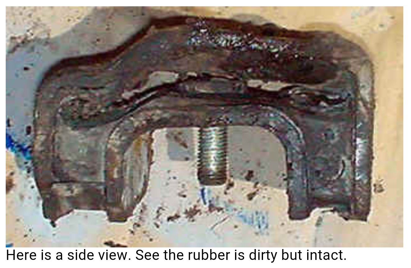

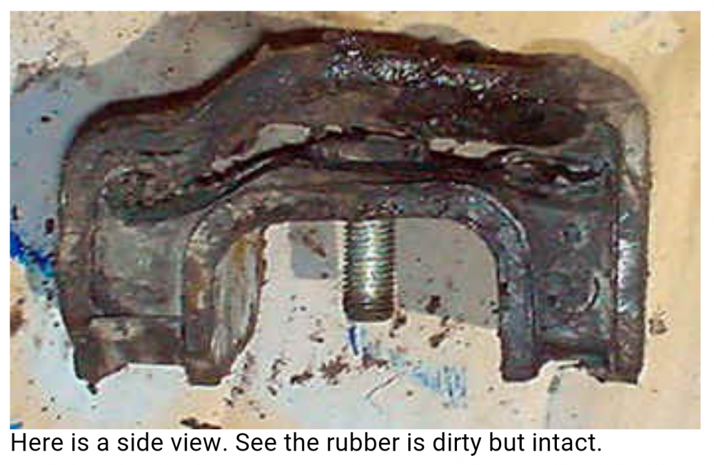

Check the selector for excessive movement and the transmission mount. Check wwwatlanticz.ca in the replacing diff mount tech tips for an examlle of a bad mount. Its a diff mount, but gives you an idea of the problem.
First thing I did when I bought the car was replace the diff and trans mount. Did it before and after installing new mounts. No noises no "ill" effects from it that I've noticed. Just unusual to see a shifter moving up and down while still in gear during acceleration. New mounts iv checked the shifter mounts its the series 1 style before it got changed. I also forgot to mention it is a 1/71 Series 1. My trans mount bracket does not have that leaf spring looking piece on it nor looks anything like that but the mount itself looks the same. Funny cuz the one every auto parts shows has 4 bolts coming out of it had to buy mine from zcardepot.

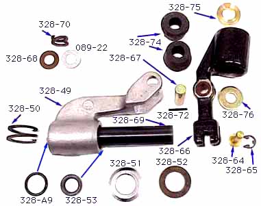

Mine does not have that plastic bushing at the base like other shifters it has an open end somewhat like a bracket at the base where a pin goes and has a metal pin going through it with a C clip connecting it to the rod that goes into the transmission. Iv tried finding a pic of it but this is the only one i could find. And at the middle pin there is 0 play at all. And besides that middle one wouldn't be the case since it moves up and down not side to side or at random directions.
Here we go. This is what the part looks like without the shifter knob rod bolted to it. shifter_parts_1600.jpg
number 328-66 is where pin 328-64 goes through at the open end at the bottom connecting it to the rod that's in the transmission. Like I said very early design on the 240z's
the shifter is pretty solid. almost 0 play up and down just side to side a little due to the early design of the bottom end of the shifter
