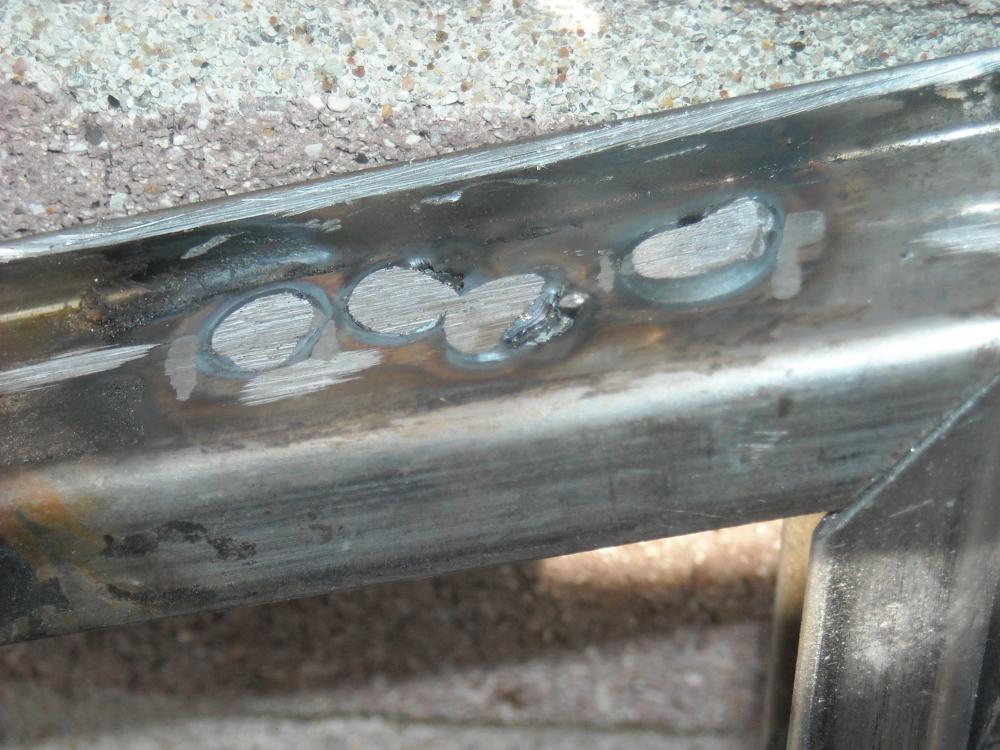

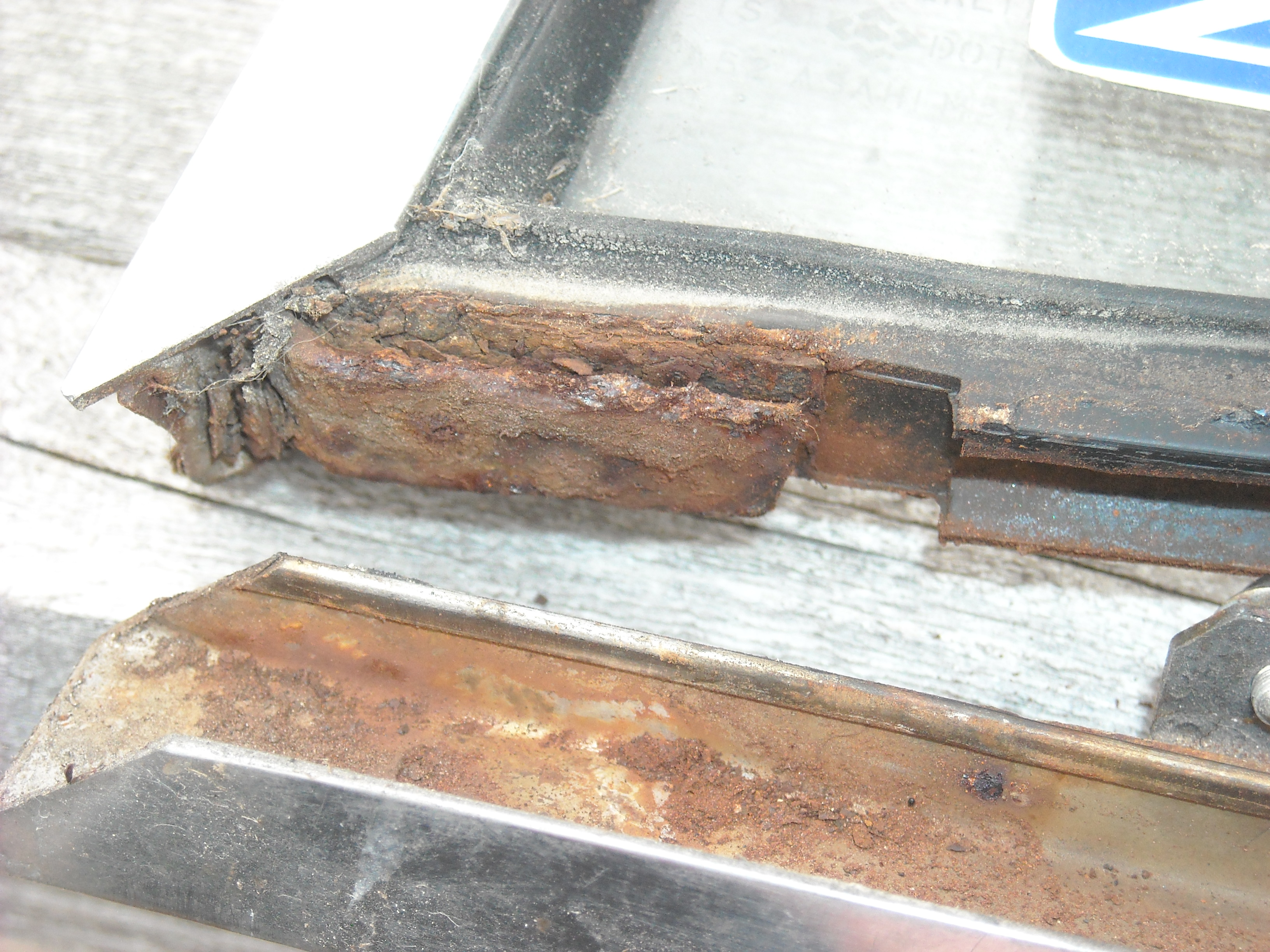

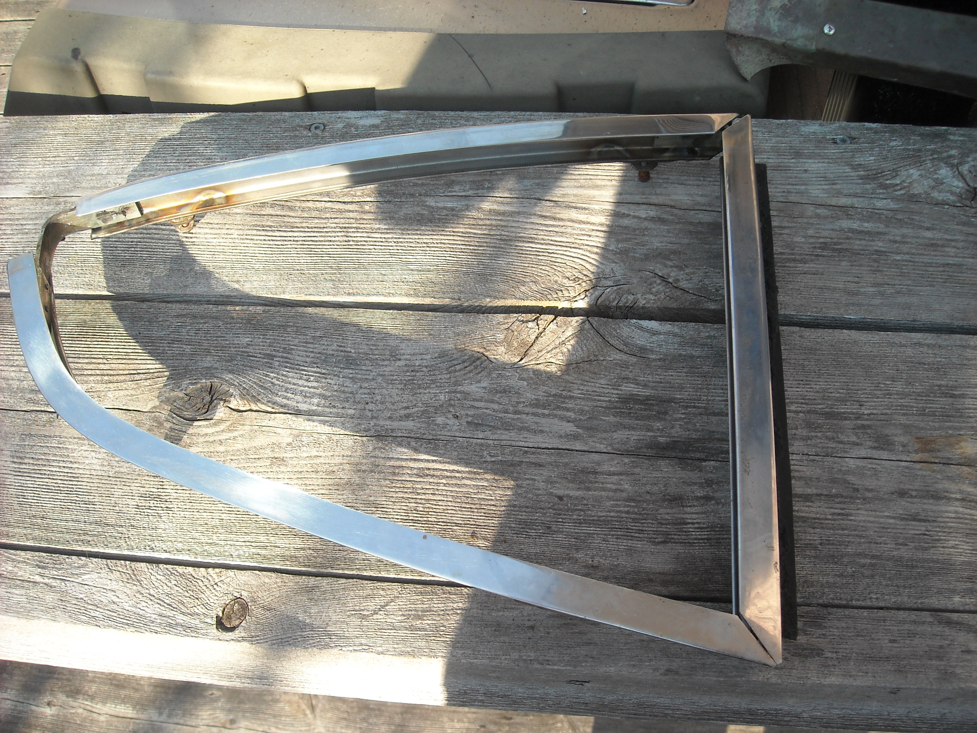

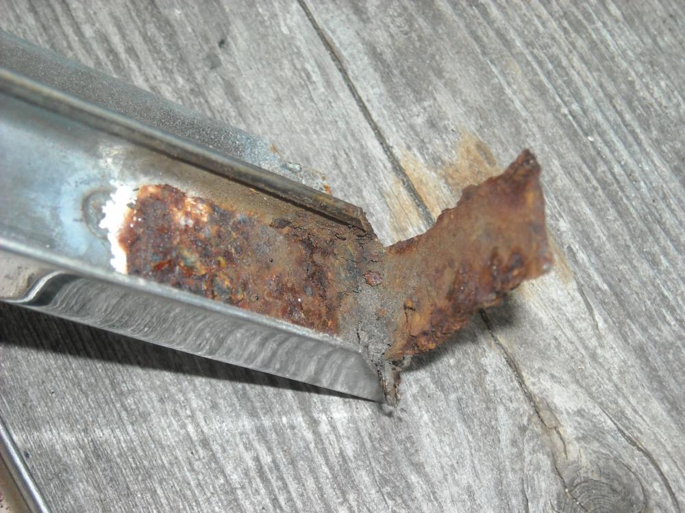

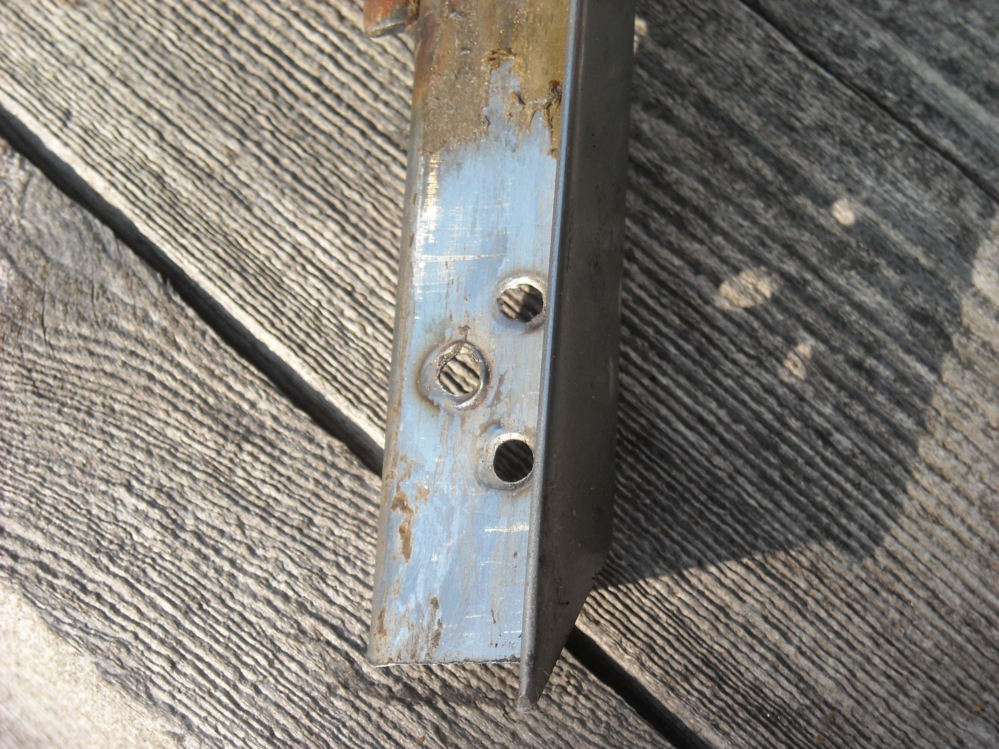

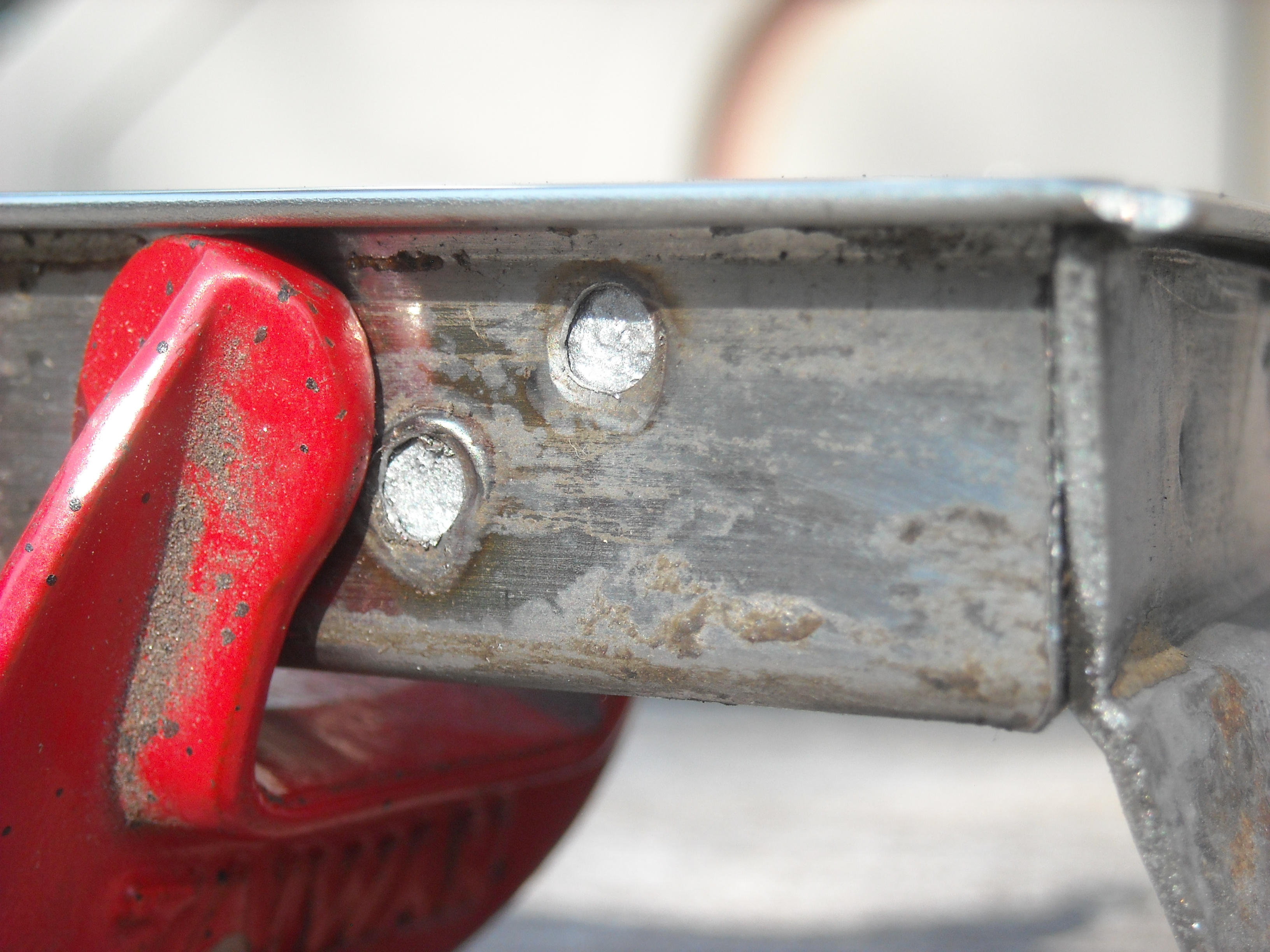

I started work on the quarter windows, the fixed corner at the bottom of the frame is where water can accumulate and rot out the steel brace that is welded to the stainless steel frame. After soaking the brace in Evaporust I drilled through the spot welds and Mig welded it the frame back together and sealed it all back together.
The brace really should be SS as well and maybe before it all goes back together I'll grind out that old peice and replace it with SS.

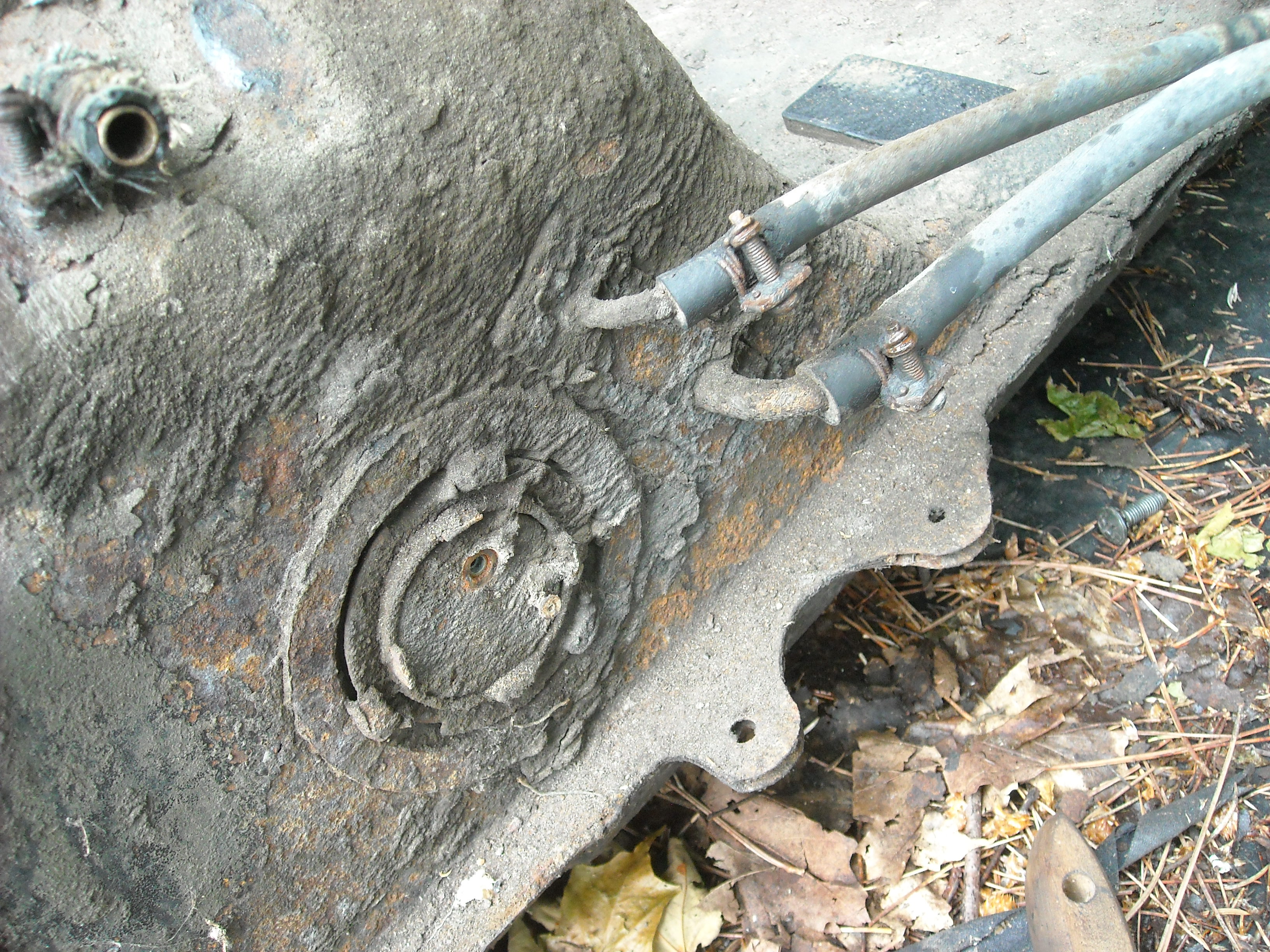

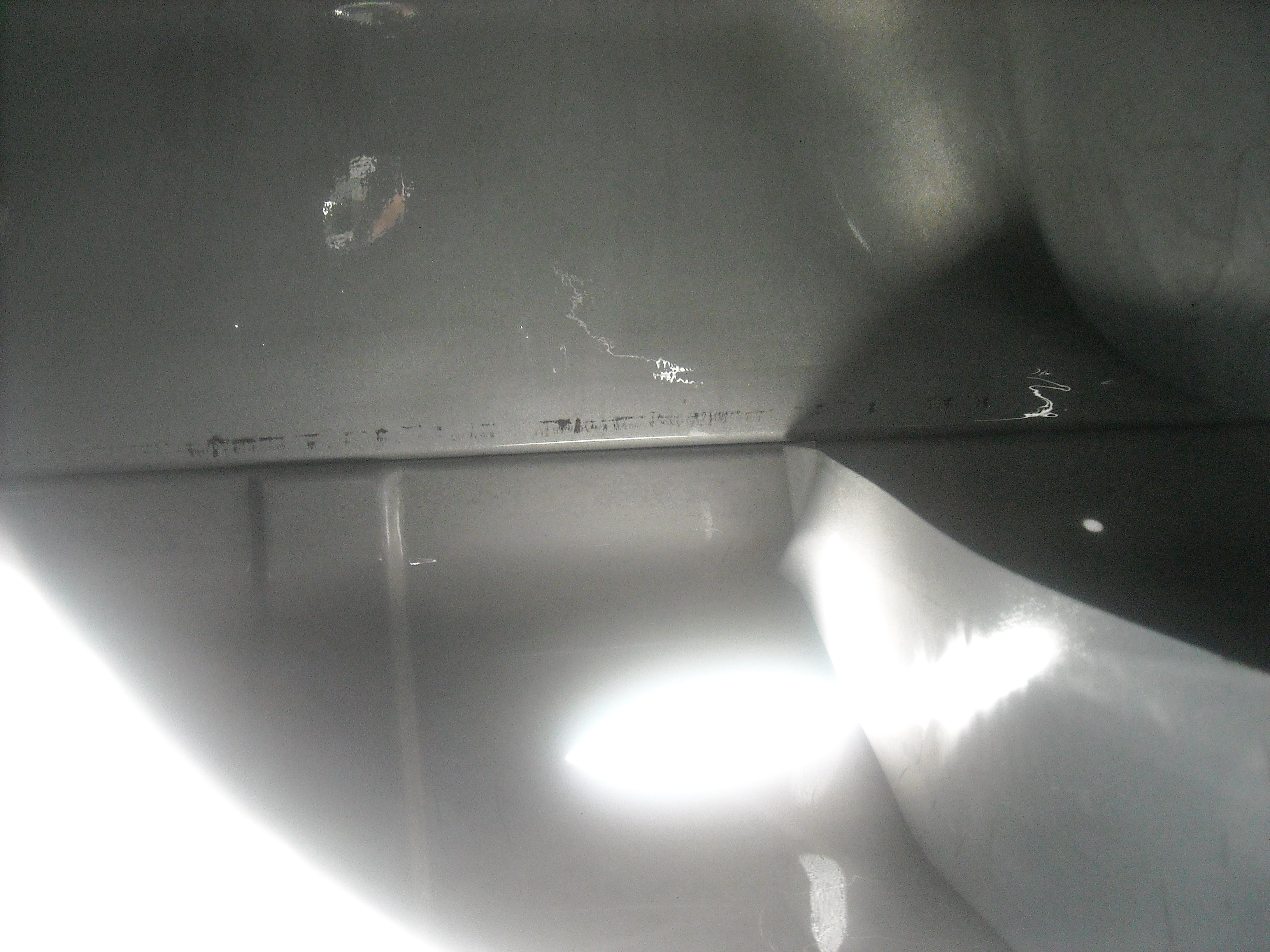

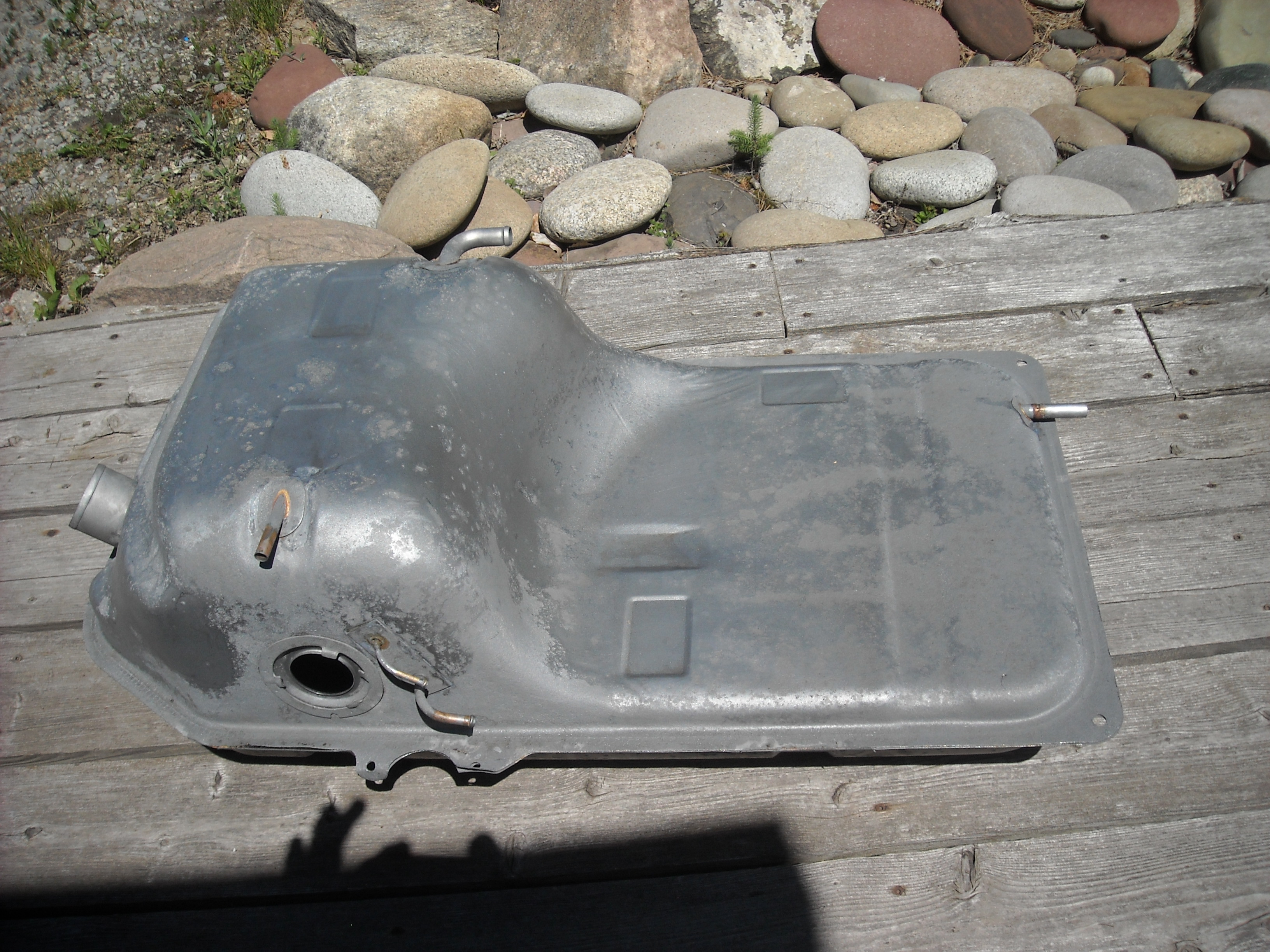

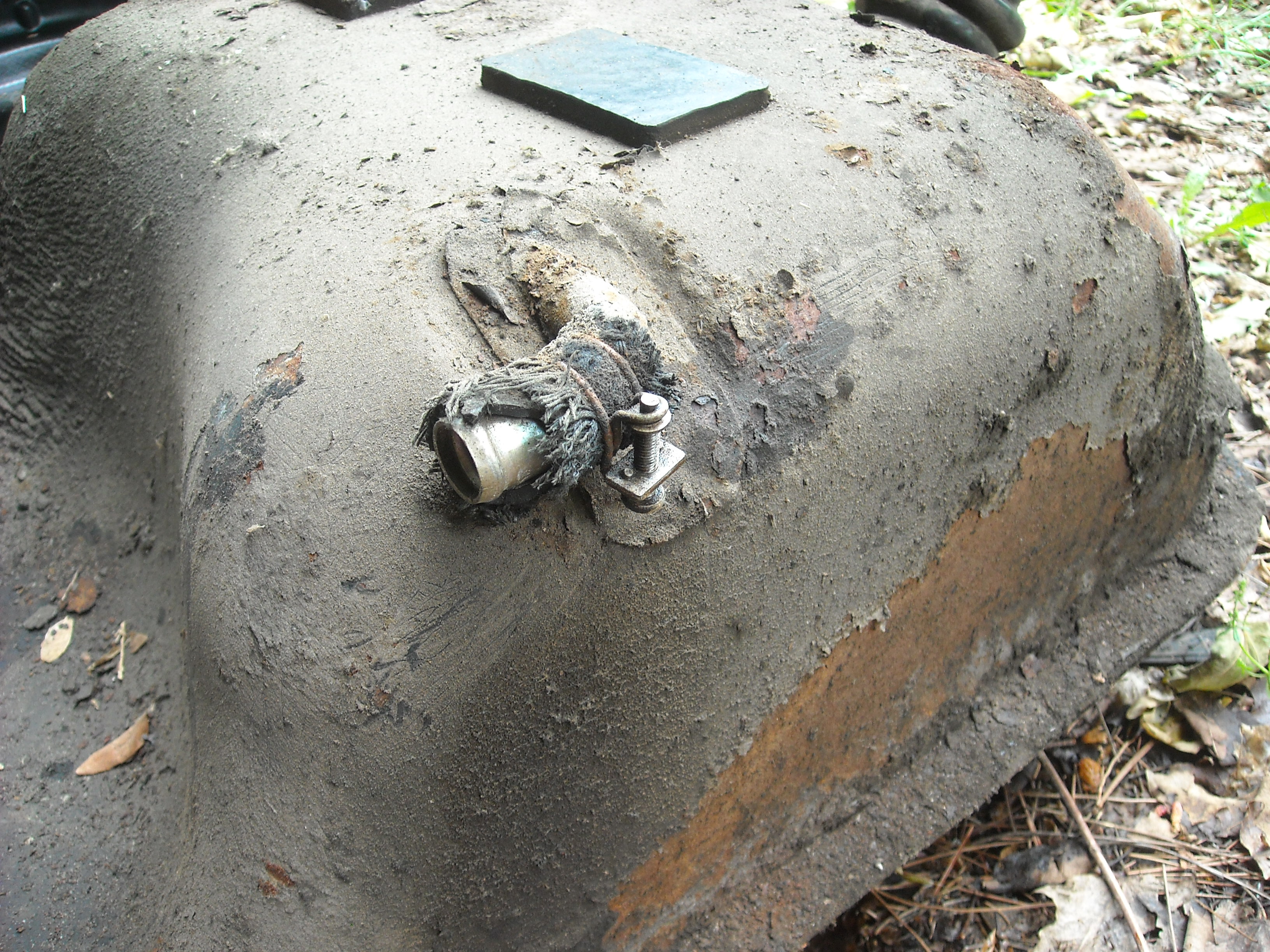

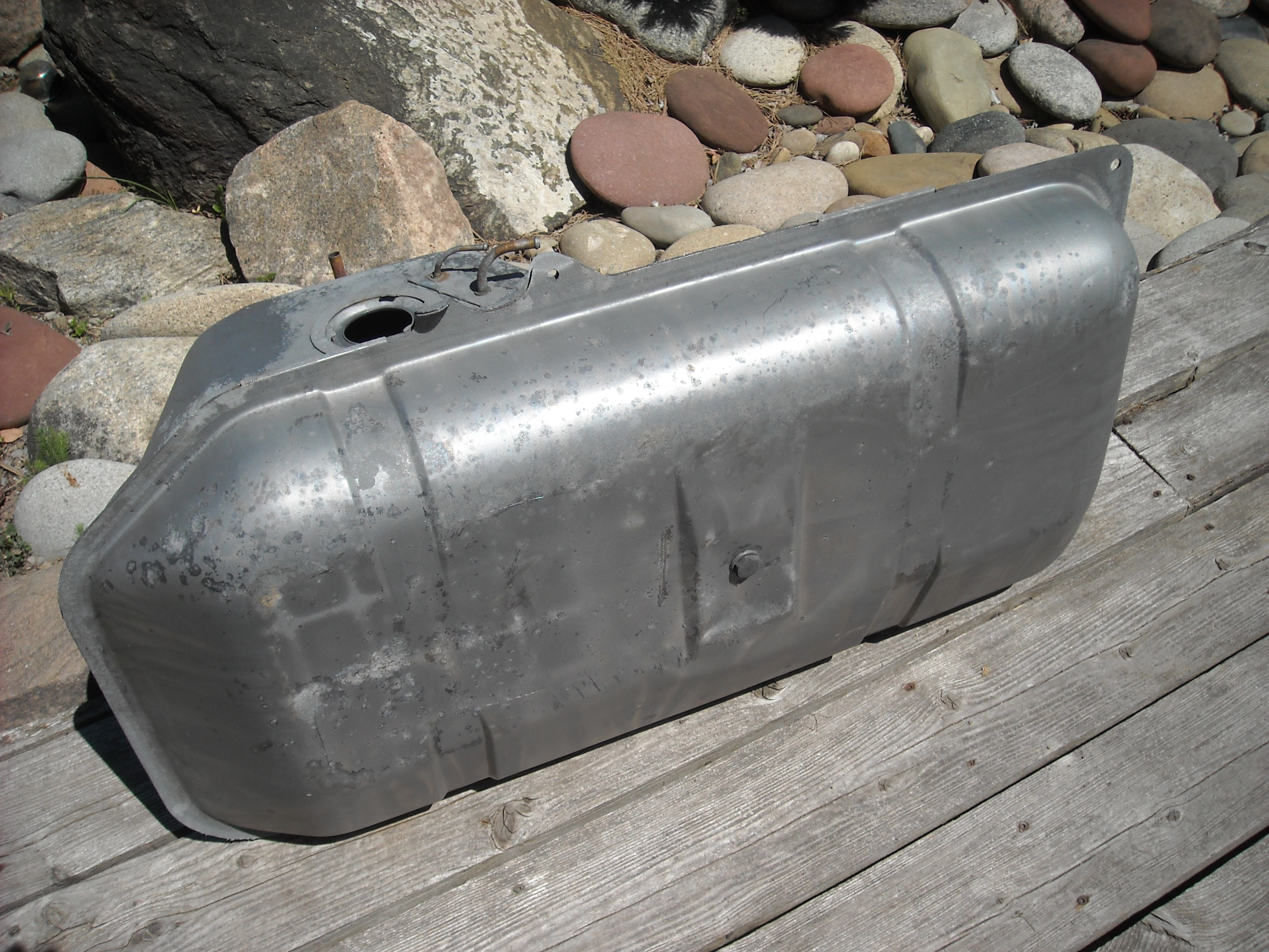

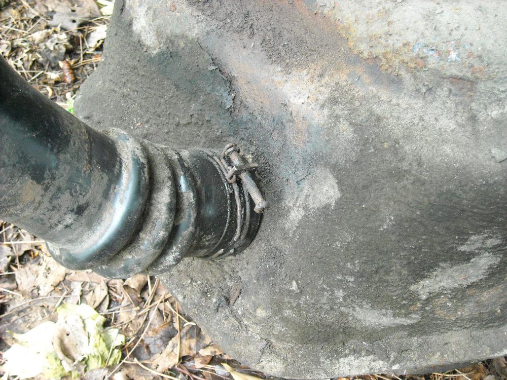

I wish I had taken some pics of the inside of this gas tank before I took it down for chemical stripping, it was nasty in there. Here are a few pics of the outside, you get the idea.DSCN0148.JPGDSCN0151.JPGDSCN0152.JPGand this is how it turned out, this is the same company that is going to dip the whole car for me.DSCN0167.JPGDSCN0168.JPGDSCN0172.JPG I poured some Eastwood's After Blast, phosphoric acid inside and out to keep the rust off.
I took it to Techno strip, a chemical dip company in Etobicoke south of me,http://technostrip.com/restoration.html they have these chemical vats 20ftx8ftx6ft. Mostly they do industrial stuff but they also do brisk business in auto restoration. They can put the whole vehicle in at one time, grease, rubber,seam sealer, paint and rust are gone. All you get back is clean metal with a water soluble rust inhibitor sprayed on. So far I've used them for the frame of a Triumph TR6 and this gas tank, both came back perfect.
