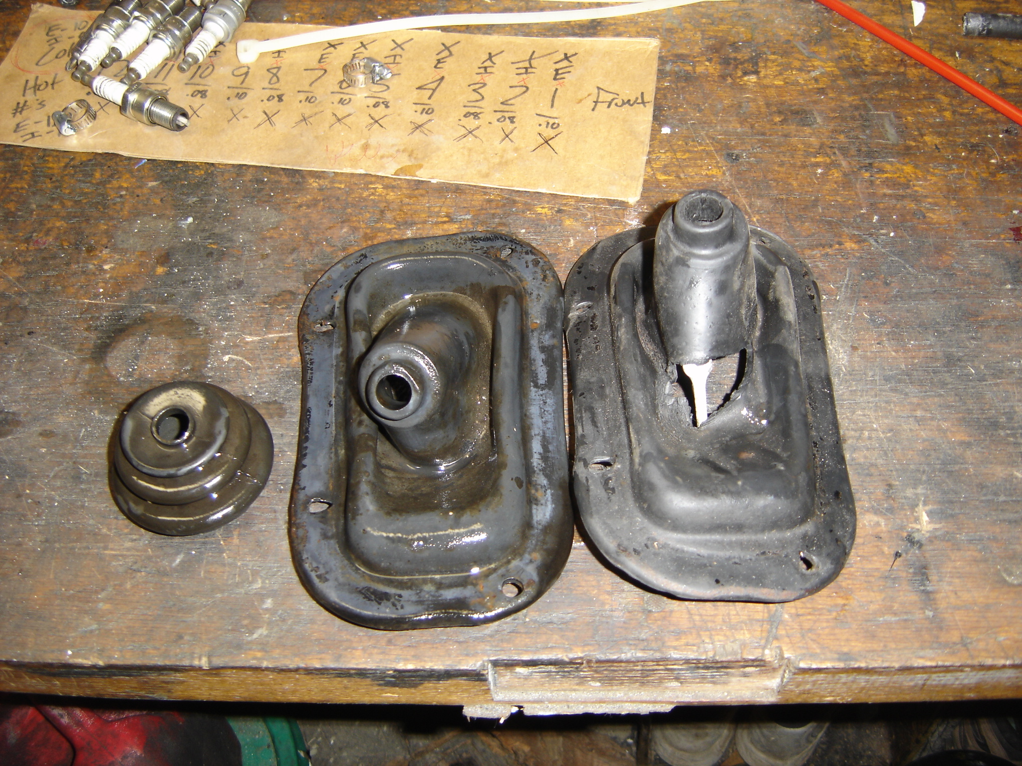

Have been at the mosquito infested junkyard all day. I have a good rubber boot now so no fumes can get in. Also got a couple of shifters to experiment with.

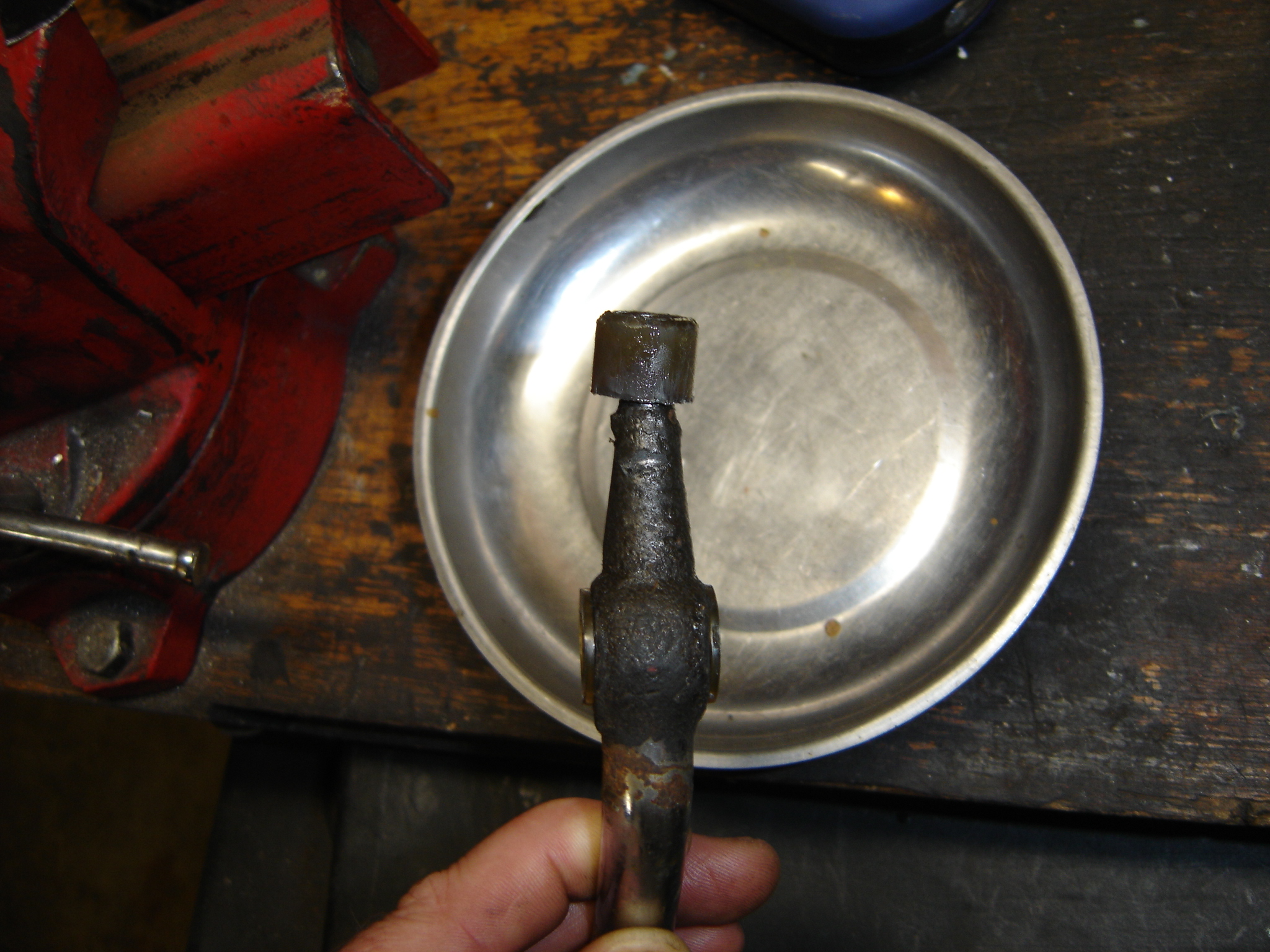

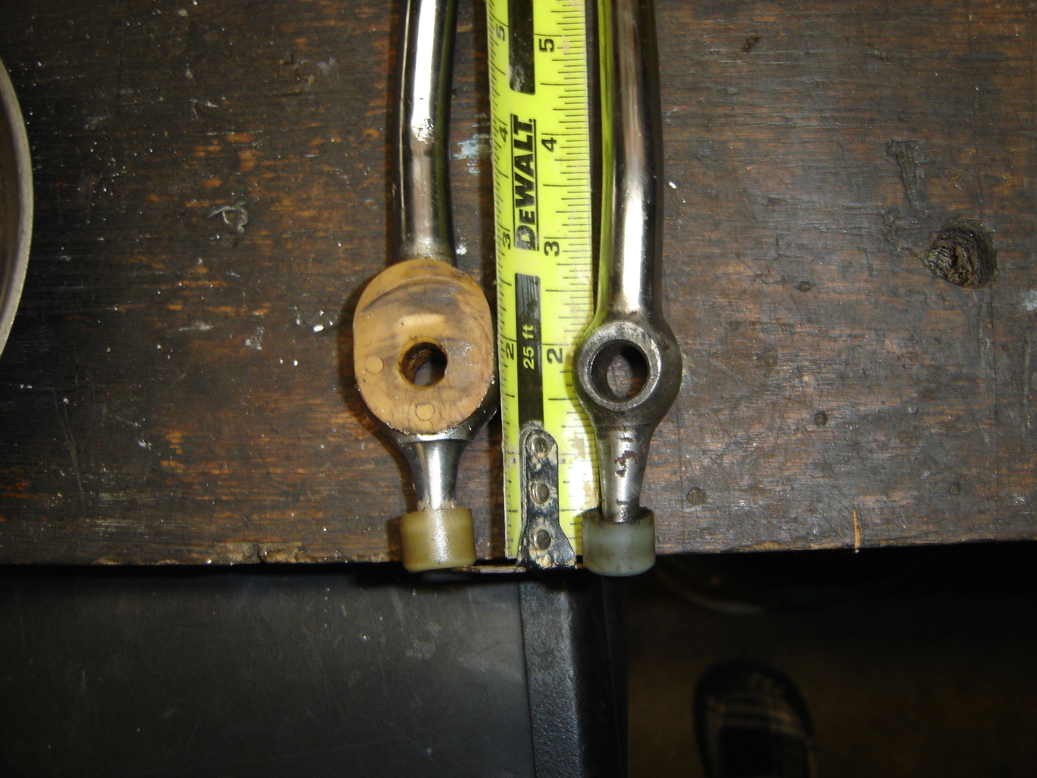

My transmission is a wide 5spd with two exhaust hangers at the tail. I can't explain why but it only works with the short snout shifter or fifth gear only works with the shorter one.
I'm going to grind the junkyard one where the scratches are and see if that'll work. If not I will have them cut and welded together.
Everything I've read says the long snout will work fine. I don't understand why mine won't? It only works with the close ratio shifter with the short snout.

Hmmm...  Well here's something to worry about then - maybe the nut on the shaft really is coming loose and the ZX shifter is just allowing it to work.  Pushng the synchro sleeve farther so that it grabs the gear,which is trying to get away.  I don't know how you'd diagnose that.  Maybe a bore scope through the speedo gear hole.  Better keep an ear on things.
OR, the long shaft lever is for 4 speeds only.  If you get some good measurements I can see if I have a long shaft or short shaft wide-ratio bent lever, that worked with my early wide-ratio 5 speed.

ok I get it completely now, saw the same marks, used a dermal drum sander to reshape along the problem areas. Remove a little bit go check do again.
Now I can shift and clearly see the detents are locking in before the shifter comes into contact with the oval hole on the striker rod head (that is where the marks come from. Glad I did this before installing, its much easier to see what happening with a bright light and getting close in.

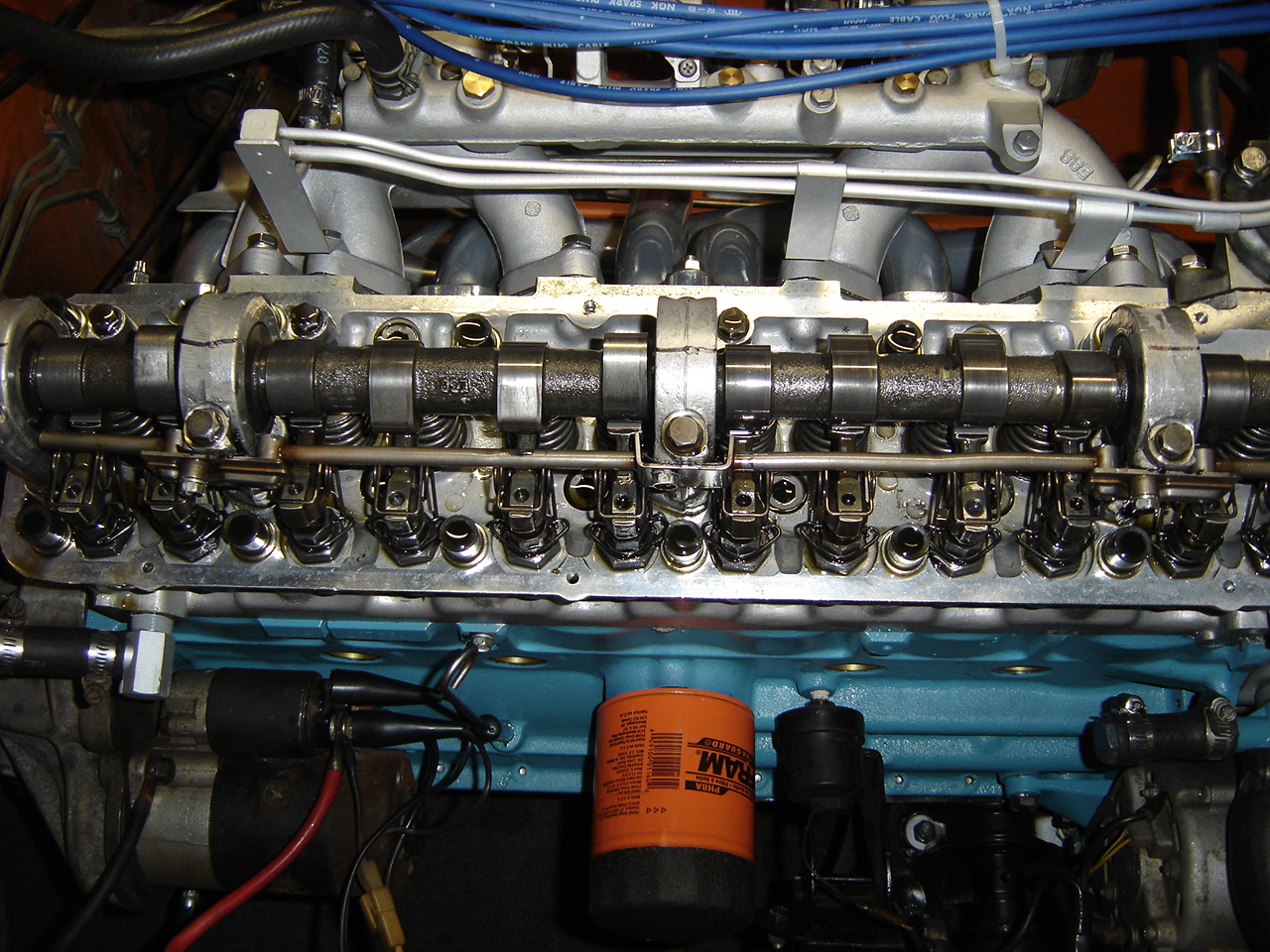

If I had listened to Dave WM's post here I would be waaaay ahead of the game.  I'm a little slow to try things like he did but that is exactly what fixed mine.  I got a rusty spare to experiment with at the junkyard and ground a little, went 4 feet before it popped out of 5th.  Ground some more, 12ft.  Ground some more, touchdown!  Adjusted the valves too, head looked good.  Thanks for everybodies input, it's tough helping a hard headed guy like me.  I'm trying!
Here's the final grinding that worked,
