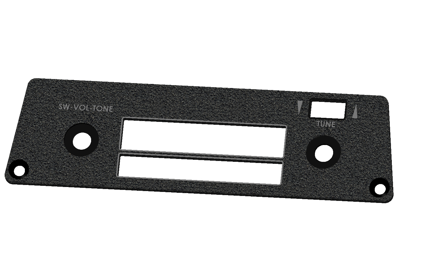

I finally drank enough beer to get up the nerve to paint the lettering on my face plate.  The paint pen @psdenno recommended works great.  I'm going to put a couple of coats over the next day or two.
Thanks for the Face Plate Pics.  I may try and 3-D model that and print the part.  I cant make the texture, but I can do the rest.
Anything I can do to help, glad to.  I've got a scanner and would be happy to do that and send you the image.  Let me know. 8^)

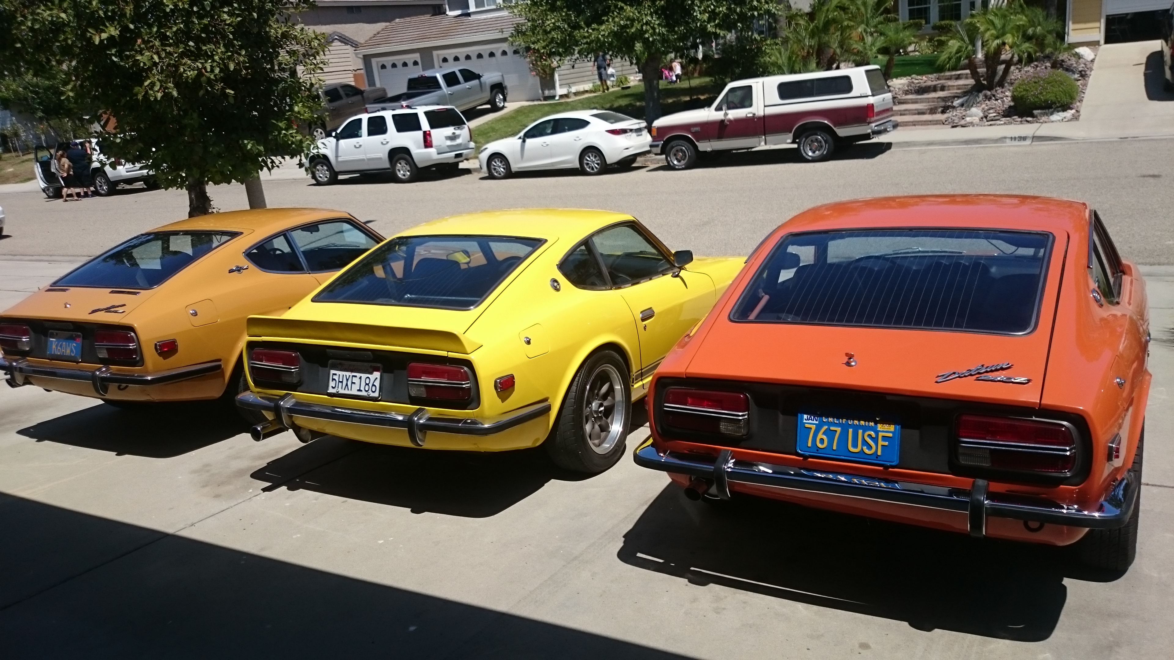

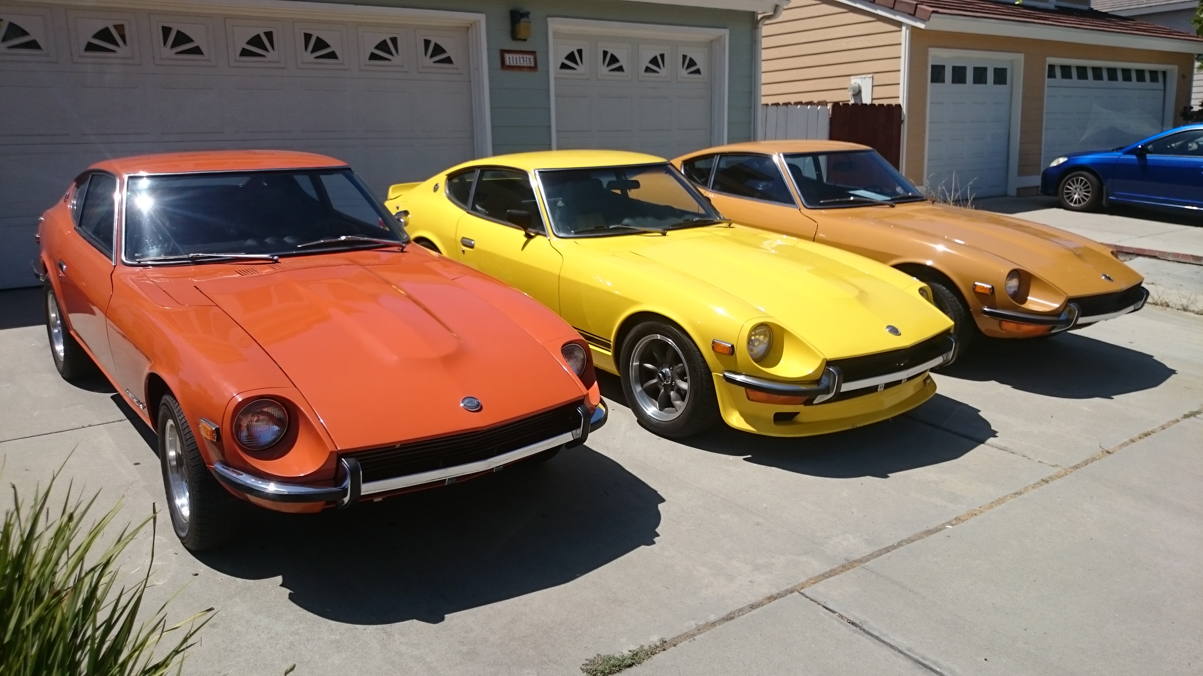

Got the electrical figured out, WooHoo!  I had the Black/white wire and Black yellow wire swapped in the four pin engine connector.  Once I swapped the contacts it worked perfect.  Just thrilled about that.  I put in new diff fluid and trans fluid (Valvoline full synthentic 75-90).  Got the clutch working and brakes kind of working (needs more bleeding).  Took it for a short spin in the cul-de-sac and lined it up for a group photo Op.  Here is a little California Sunshine.
I don't care for the mags on the persimmon car at all.  Will put the hubcaps on next month.  That should be much better
Rich
Hey Rich, What coating did you use on the center spokes on the wheels on the yellow car? They sort of look like the old-school EMPI wheels I had on my first Zed back in '75. I've currently got shiny silver-painted centers on my Rota RBs and would like to re-create that center spoke mag look. Time machine stuff...
Cheers, Mike
