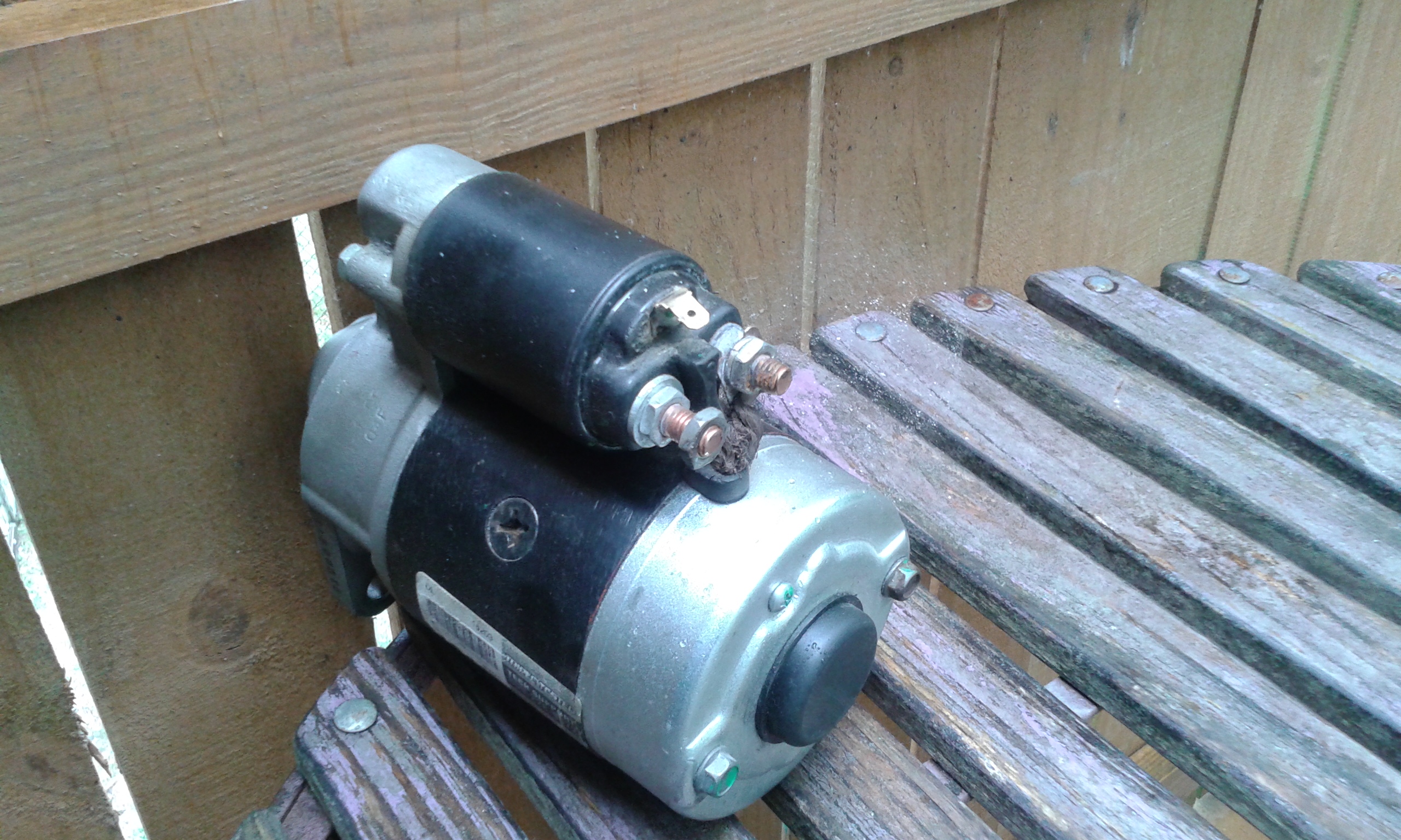

The neg side of the battery goes to the top starter bolt. The positive goes to the solenoid post that's closet to the battery, not the closet to the block with the visable copper braided ground wire.
The remote starter goes on the positive post of the solenoid. The other clips onto spade plug in the middle, pull the small wire off first though.
