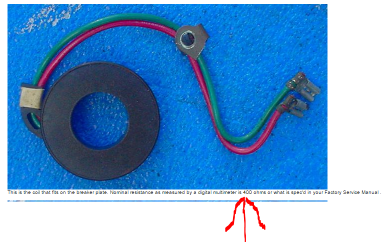

The part that many people seem to have the most difficulty with on these cars is the need to do lots of measuring and adjusting or fixing if the measurements are wrong.  At least you have a meter and are using it.  You just need to go deeper.
You didn't mention pickup coil resistance or the air gap setting.  The electronic module won't work right if it doesn't get the correct signal from the pickup coil.  Your coil and wires seem fine, it's the triggering system that's not working.

Awesome! Thanks for the input! I will check resistance of pickup coil and measure air gaps. I will also repeat the test as you suggested. Should the spark be weak?
And what resistance should the pickup coil have?
