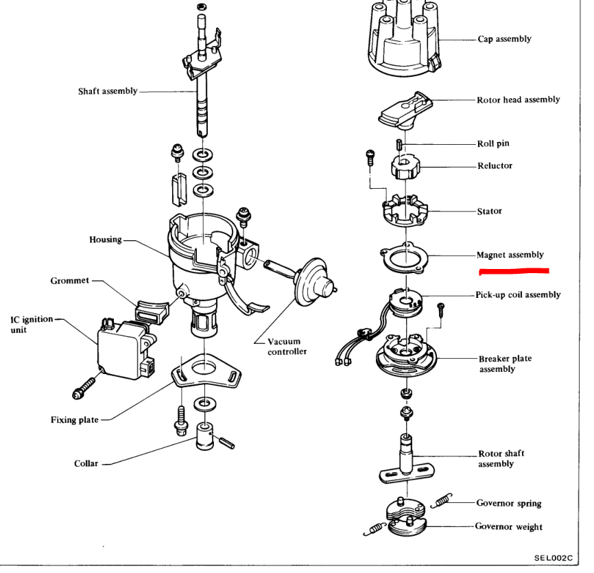

Pretty sure the E12-80 has the modern current-limiting (dwell control) so the Blaster 2 coil should work fine.  He has all of the parts, I'm betting that the distributor needs a little work.  Whenever I find a ZX or Maxima distributor in the wrecking yard they're always mis-adjusted and have broken magnets.  I don't think that they're very durable.  Rockauto sells a replacement bushing for the shaft.

is this the broken magnet you were referring to?

I believe- working off of memory here- the broken part in your pic is just a spacer. The stator usually cracks and won't hold the gap setting when you tighten the screws. I wish I had mine in front of me but I made it work by properly spacing the stator ring . I will try and dig it up.
ive since given up on distributors :)
The workings of the 280ZX distributor are definitely more mysterious than the 280Z's.  But they do call it a magnet in the manual.  I guess the real question is "does the magnet need to be intact to work at full function?".  Apparently, they still work when broken, but how well?
