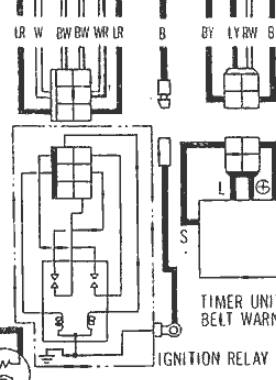

And did you replace the actual ignition relay (passenger foot well) or the fuel injection relay (above hood release handle)?  And are they new parts or used parts?  The click from the passenger foot well is probably the ignition relay.  The ignition relays are in a bad spot for moisture.
Are the battery connections clean and tight?  A loose or dirty connection will open up when current heats it.  Same with a fusible link connection.  Check those.  When you turn the key to On, more current flows.  It also flows through a different portion of the ignition relay.  I just realized though that I don't understand Nissan's schematic for the ignition relay at all.  I assume that four triangles are showing two relays.  Anyway, a separate circuit for Acc and On.
Finally, after "everything goes out", does everything come back when you move the key back to Acc?  You could jump the circuits at the plug if you wanted to check them.
Good luck.,
