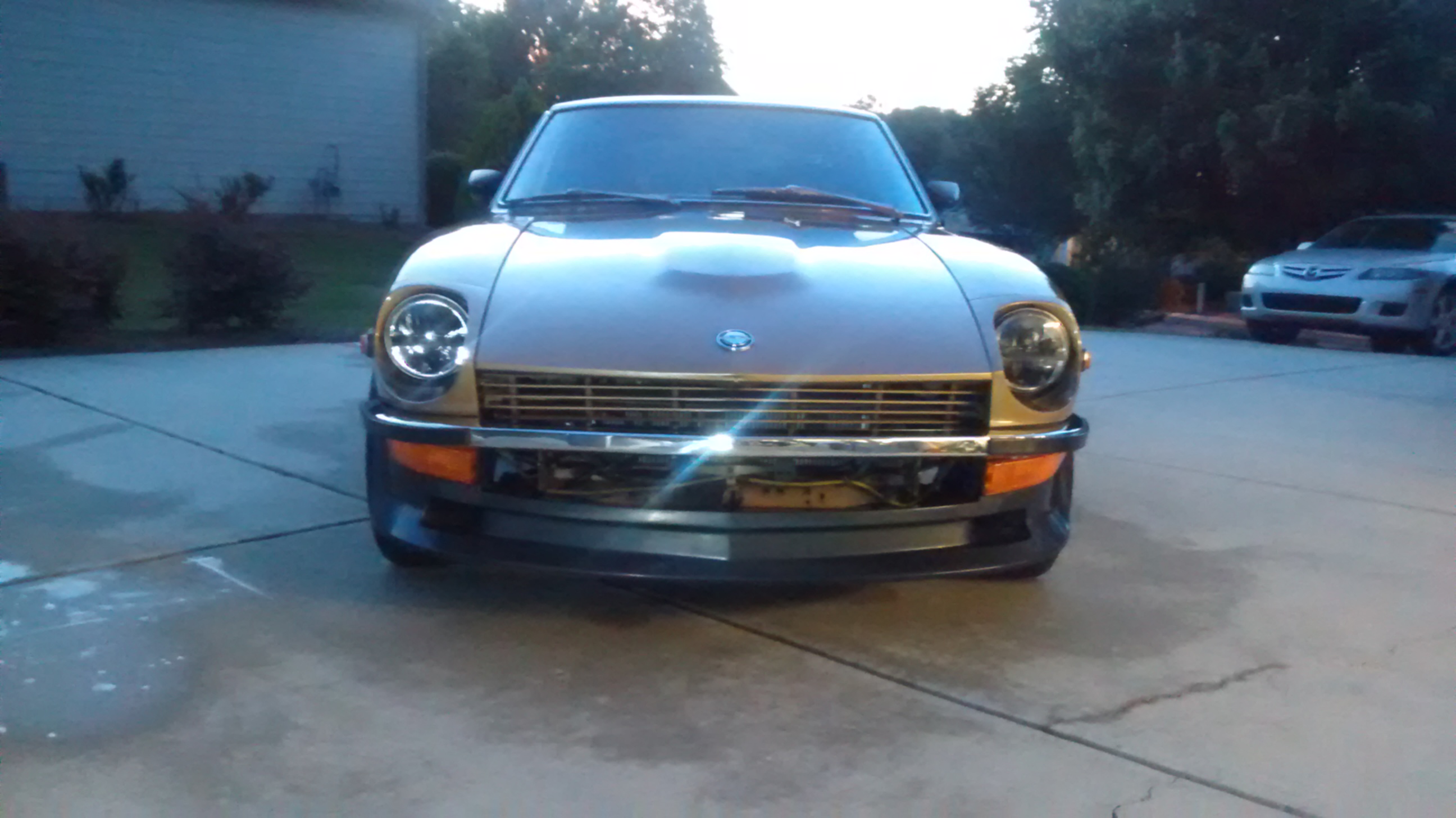

Just got my bumper pieces back from chroming and wow they look great. New rubber also. I paid $650.00 to have it done. Not sure if its a good or bad price but maybe it can be a reference for anyone else thinking about it. it was local plating company and they have good references. I'll have to wait until this winter to shell out for the front.

Looks very nice, this is one of the things on my to do list.  How does the plating on the inner surfaces look, did you need to add any other protection there?
Also are the rubbers strips new? If so where did you get them? Mine are getting quite dried out and cracked.

The inner side of the bumper had a fair amount of rust in spots, some heavy pits and you can still see them for sure but its  plated also, just not full on chrome. I took the bumper as a whole to have them check it out first and he said there was enough metal to make it work. Pretty much destroyed the studs on the old rubber taking them offf they were rusted so badly. I bought new ones from zcardepot. I thought about the stainless but I don't know if you can get the bumperettes and figured I'd keep the originals on it. Either way its a chunk of dough!!

That seems to be a standard price these days for a good plating job. A lot of the people these days are sealing up or painting the inside of the bumper black to ensure it it doesn't rust again. I know they cleaned the rust off and chromed the inside as well but it will not be as thick as the outer surface and is easy to forget about cleaning in there, just a thought.
