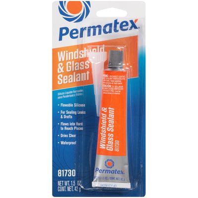

Permatex makes a special product for DIY repair of W/S rubbers. It's called flowable W/Shield and Glass sealant. It is a very thin, clear RTV that " Flows " into hidden nooks and crannies of W/Shields that are held in with Rubber gaskets. It has a special small application tip so you can slip it under the rubber and inject the sealant.
PO had replaced the rear hatch glass rubber with an aftermarket POS. It leaked like a sieve... but he never drove the car in the rain. Here on the Wet Coast I do not have that luxury. I was looking at having the rubber gasket replaced but decided to give the Permatex product a try. Gotta say it worked danged good. Hatch rubber is now sealed tight  to the worst rains and my rear trunk area now stays nice and dry.
USA Part # 81730
Canadian Part # 65AR
http://www.amazon.com/Permatex-81730-Flowable-Silicone-Windshield/dp/B000BKEBO0
