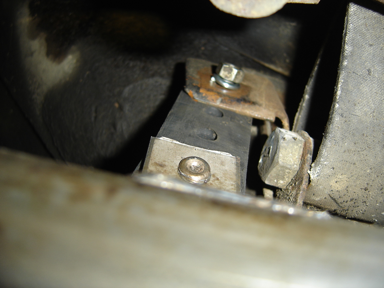

The hanger on the front of the S pipe works better attached to the driver's side of the cars bracket, you can see where I had it on the other side before and that was pulling it towards the passengers side.

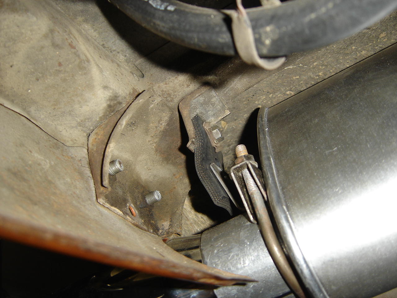

The hanger at the very back can be pushed up and held in place through the 2nd hole from the bottom, I cut the top 2 holes in the rubber off.  It pulled the chrome tip right up next to the cut out but it's not touching our rattling.

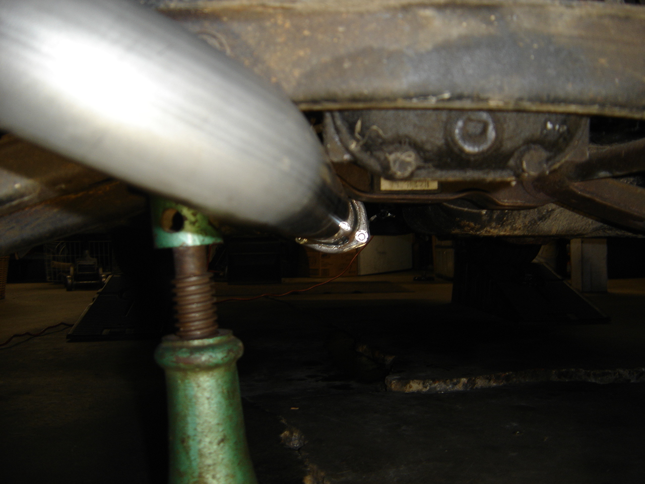

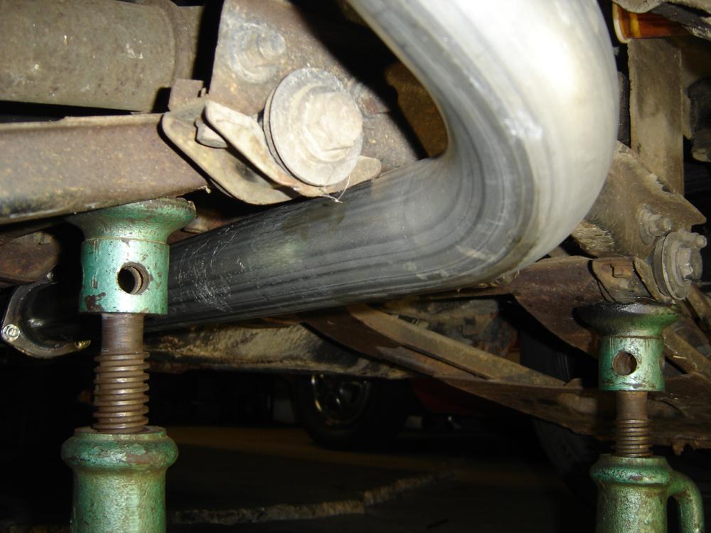

Moving the hangers up as far as I could allowed the pipe to fit snug up against the crossmember with the hump cut out.  And further back, tight up against the moustache bar?? I don't know what that's called but it's at the rear of the differential.

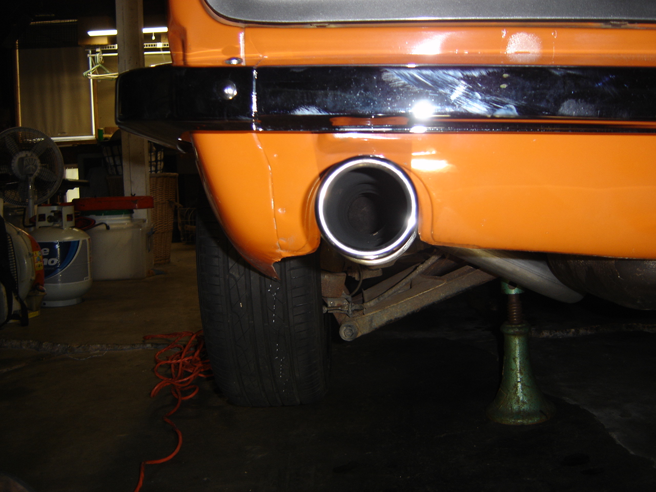

It's not perfect but damn close.  Saved me some money too. :D

Exhaust looks great Cliff. Is that a R180 diff?  My R200 is bigger and has a square corner making the pipe fit that much tougher.
