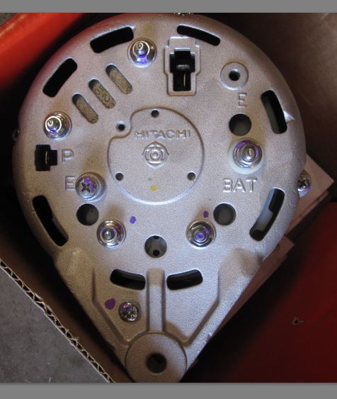

July 1, 20169 yr comment_497907 Can you find an S and an L over by the T plug?  The yellow wire and the white/black wire.  That would be the lock.  But the "P" terminal is a pretty good clue also.  I think that it only comes on the ZX alternators. Just took a picture of an OReilly Ultima alternator I had on the shelf.  Looks just like yours.  It's a ZX unit.  I'll post a picture in a second. Link to comment https://www.classiczcars.com/forums/topic/55727-alternator-not-powering-battery/?&page=4#findComment-497907 Share on other sites More sharing options...
July 1, 20169 yr comment_497908 Here it is. Â I think I took the condenser off and used it to solve a different problem, so it's not there. Â The P terminal is a tachometer signal that some ECU's use. Â Only heard of it on internally regulated units. Link to comment https://www.classiczcars.com/forums/topic/55727-alternator-not-powering-battery/?&page=4#findComment-497908 Share on other sites More sharing options...
July 1, 20169 yr comment_497910 Here's the thing though - they have to set their test machine up as either internal or external regulation, I think. Â I'd take it back and make sure you get a guy who knows what he's doing and make sure he tells you if it's internal or external. Â If you have a part number from the box it came in we could do some detective work also. Â Could be that the reman guys are packing different things in to the same cases. Link to comment https://www.classiczcars.com/forums/topic/55727-alternator-not-powering-battery/?&page=4#findComment-497910 Share on other sites More sharing options...

July 1, 20169 yr comment_497913 Good luck. Â By the way, I'm not really sure the P terminal is for. Â But it didn't show up until the 280ZX. Link to comment https://www.classiczcars.com/forums/topic/55727-alternator-not-powering-battery/?&page=4#findComment-497913 Share on other sites More sharing options...
July 1, 20169 yr Author comment_497915 Just spoke with oreilys..... He said that the alt they have sold me is the only one their computer calls for. He also said that it is a 60 amp externally regulated counter clockwise unit. He said he is 100% sure it's the right alt????? Link to comment https://www.classiczcars.com/forums/topic/55727-alternator-not-powering-battery/?&page=4#findComment-497915 Share on other sites More sharing options...
July 2, 20169 yr comment_497917 Dave WM's has the P terminal also, in his video, I see. Â The reman companies have consolidated their parts lists down so that just a few will cover a lot of cars. Â Looks like they're putting the P terminal everywhere now. Â Sorry about the misdirection. Â If you post some part numbers.... Â Can't emphasize enough how untrained the typical parts store employee is. Â All they know to do is key letters and numbers in to their computer and do what it tells them to do. Â Occasionally somebody will actually know some car stuff, but the majority don't. Â It's just the way things are. In the meantime, the Factory Service Manual has all of the testing procedures for the stock system. Â Your mechanic really needs to go there. Â It's free! http://www.classiczcars.com/files/file/22-1975-280z-factory-service-manual/ Â Link to comment https://www.classiczcars.com/forums/topic/55727-alternator-not-powering-battery/?&page=4#findComment-497917 Share on other sites More sharing options...
