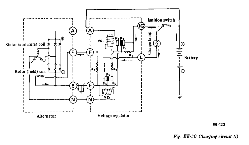

That's a good idea about the Charge light.  On the internally regulated alternators, the Charge light would not light if the L wire was disconnected, and charging would stop.  But with externally regulated systems L runs to the VR.  Looks like F comes straight through from Ignition and the charge light just indicates the balnce between A and the battery.  So, it should light if charging stops, I'd think.
So, good question - what is the Charge light doing?
