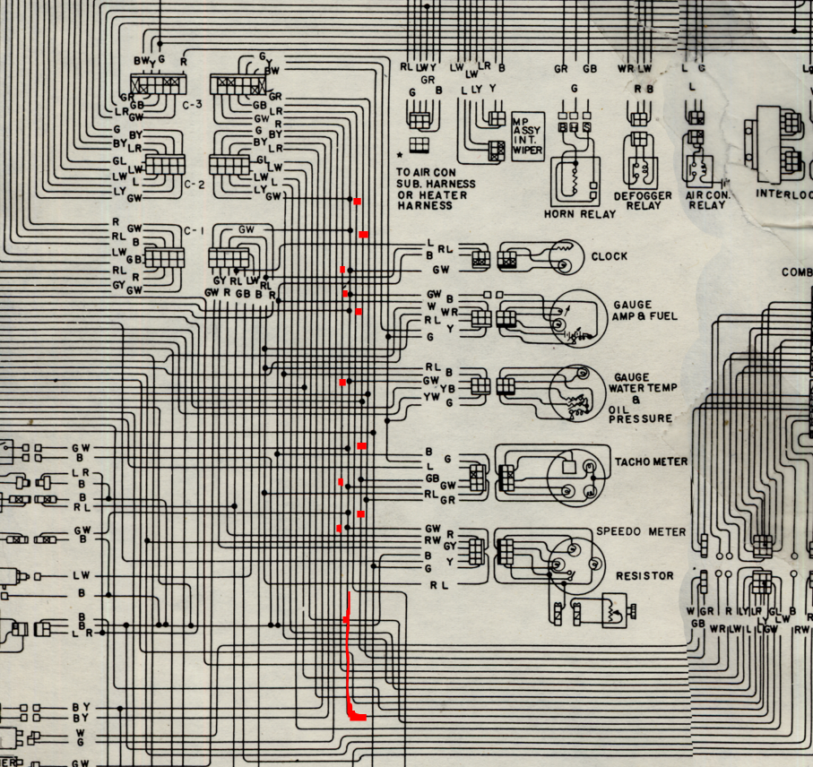

Take a look at this fragment of a diagram I copied.  The GW wire that gets hot feeds many small lights.  Any single one of which could be your short.  It also shows why C-3 didn't turn everything off.  I put a red dot next to each branch.  I think that you were on the right track by unplugging things.  You just need to keep unplugging until the problem goes away.  Here's one diagram source, a GIF file from atlanticz - http://atlanticz.ca/zclub/techtips/electrical.htm
I used the pdf version from here -  http://www.nicoclub.com/FSM/260z/1974/
