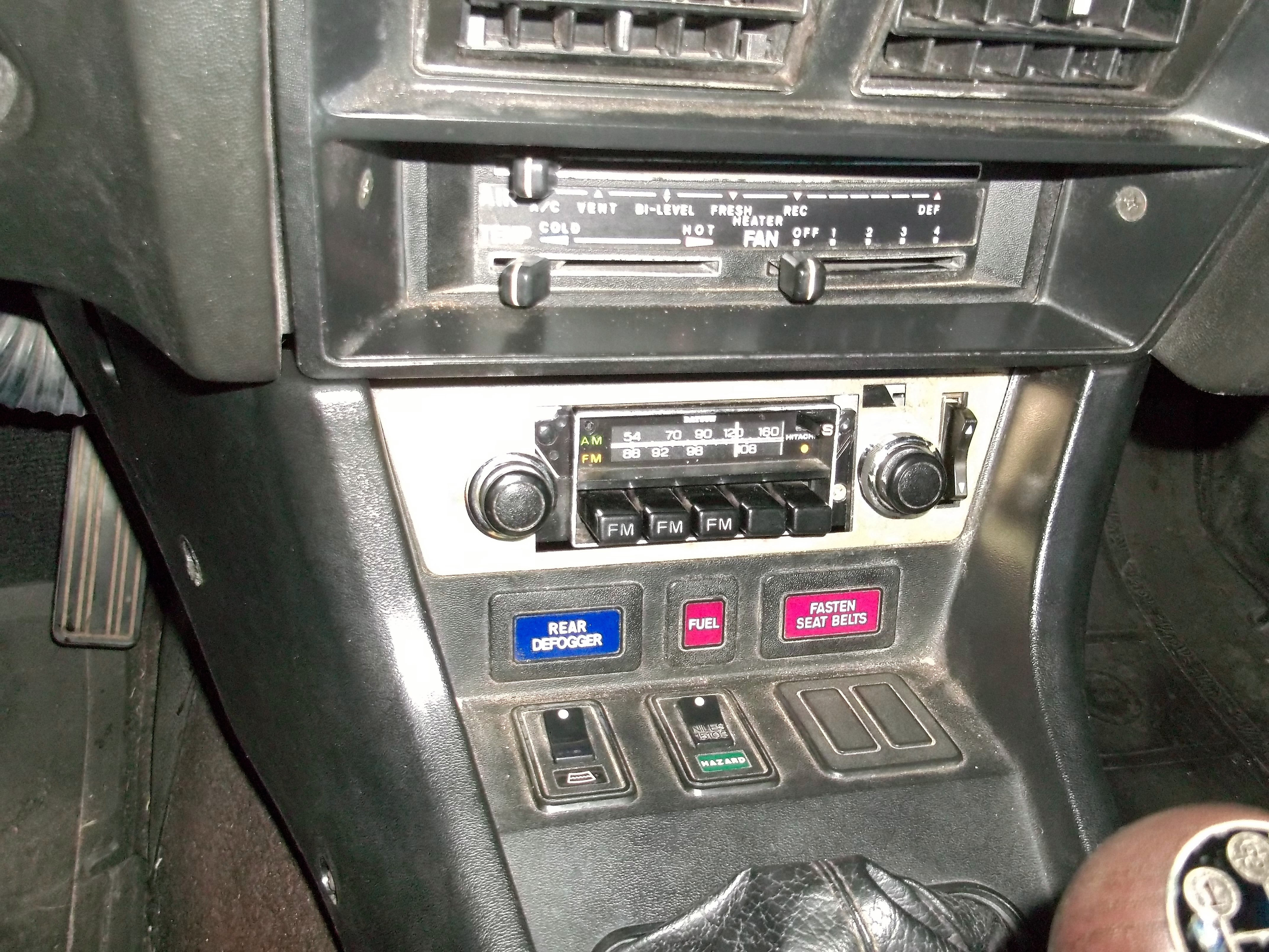

I've always thought that the metal plate goes directly behind the plastic faceplate to protect it from distorting.
But... looking at the manual for the 78 with the clarion, it shows no metal plate. Perhaps an oversight in the manual?
My 78 had the metal plate when I got the car and it was directly behind the plastic faceplate.

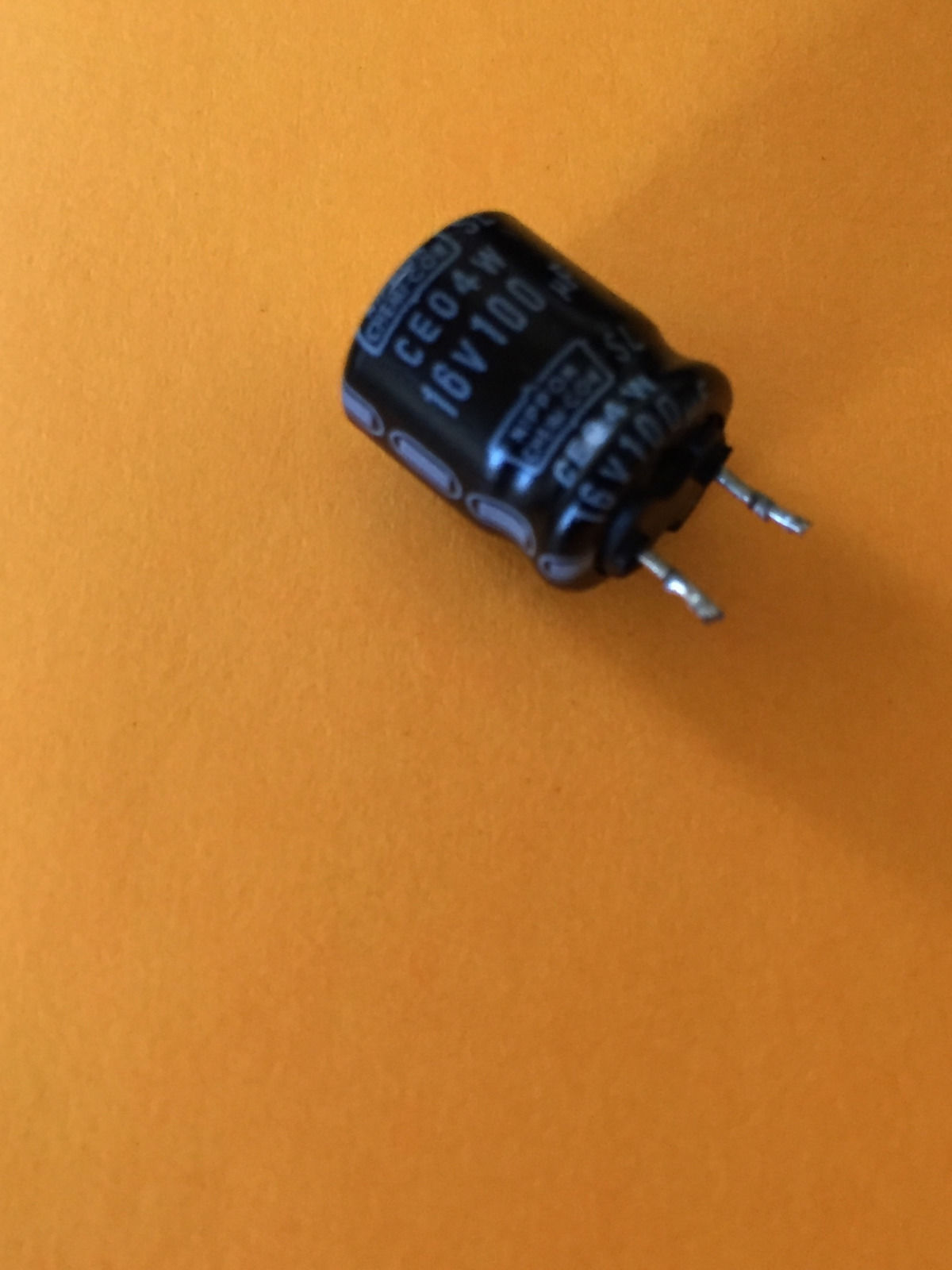

speaking of bad caps... I just repaired a 78 quartz clock with a bad cap. The top looked ok but the bottom was bulging and the clock was dead.

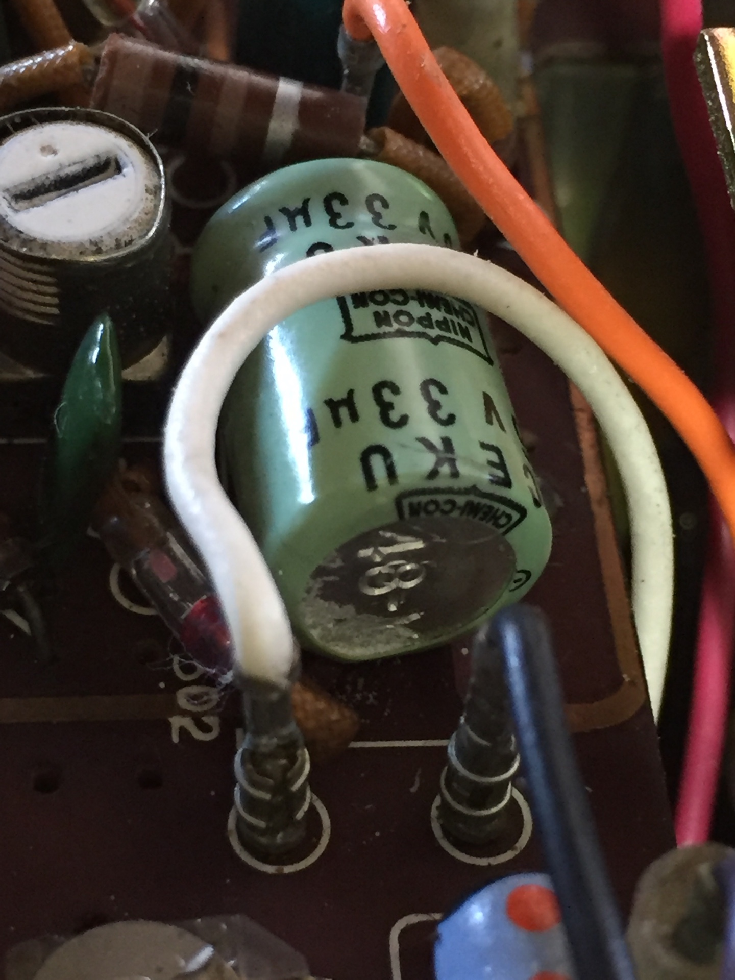

Also on my hitachi 8 track i noticed this cap is leaking and will need to be replaced.
They're both chemi-con capacitors.  Lots of these caps in the 70's electronics.  I'm on the fence where this is concerned.
If there is no signs of leaking or bulging and the radio sounds good, should you change all of them anyways?
you could try sweeping them with an ESR meter, they can be used in circuit. My buddy just uses an audio source and feeds a signal thru them and test by ear (again in circuit). But if they are easy to get at, I would just replace them. I am sure they are way past any expected service life. I generally will not replace a part unless I am pretty sure its bad but on caps like those, if you have one bad then good chance the others of same brand/make are suspect.

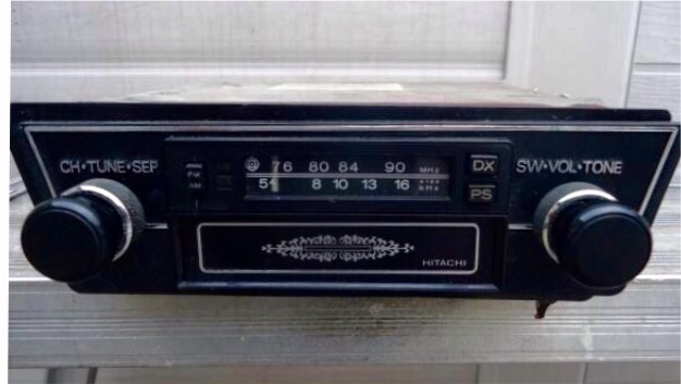

My latest toy, a 77 fairlady hitachi am fm 8 track thats
stereo. This is my first one so im curious of all its functions.
I think i'm going to make a silicone mold of the faceplate
so i can reproduce it at a later date as these are pretty rare.
