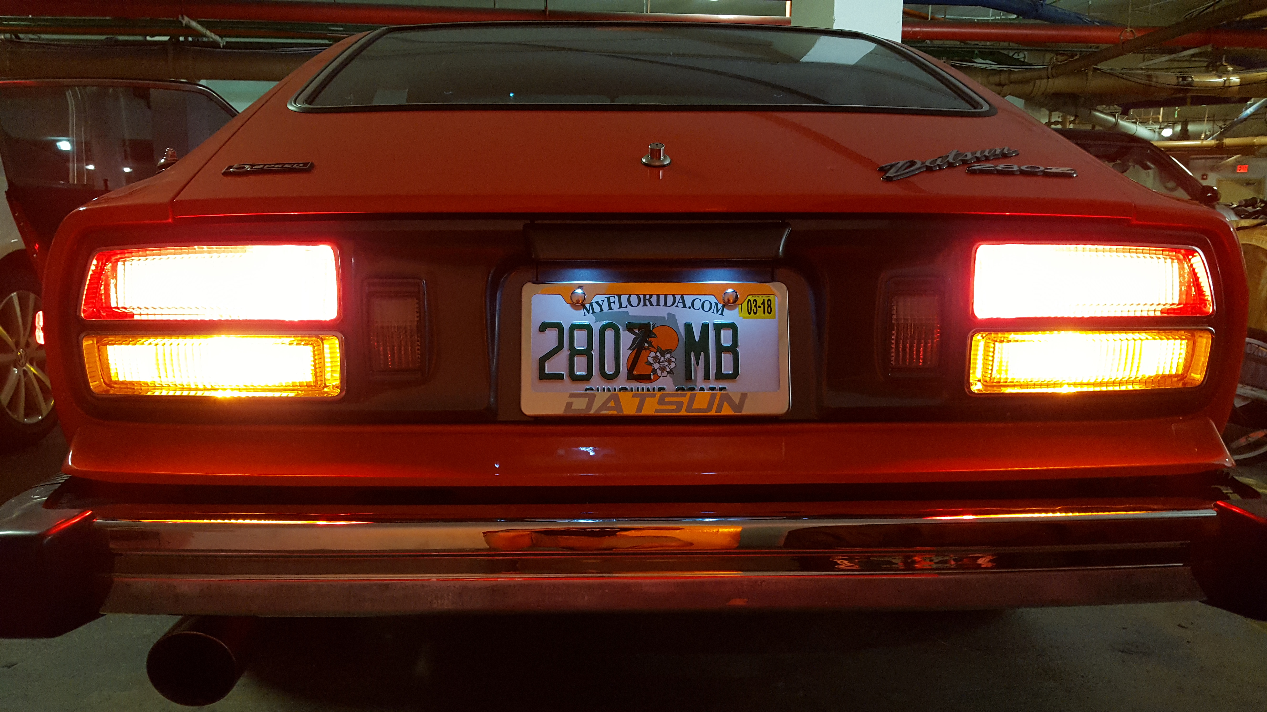

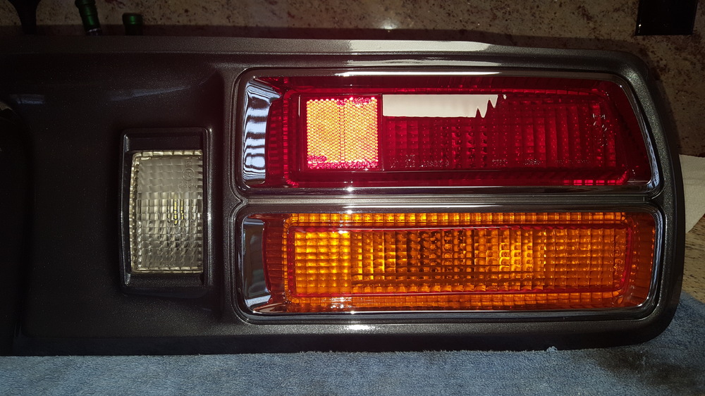

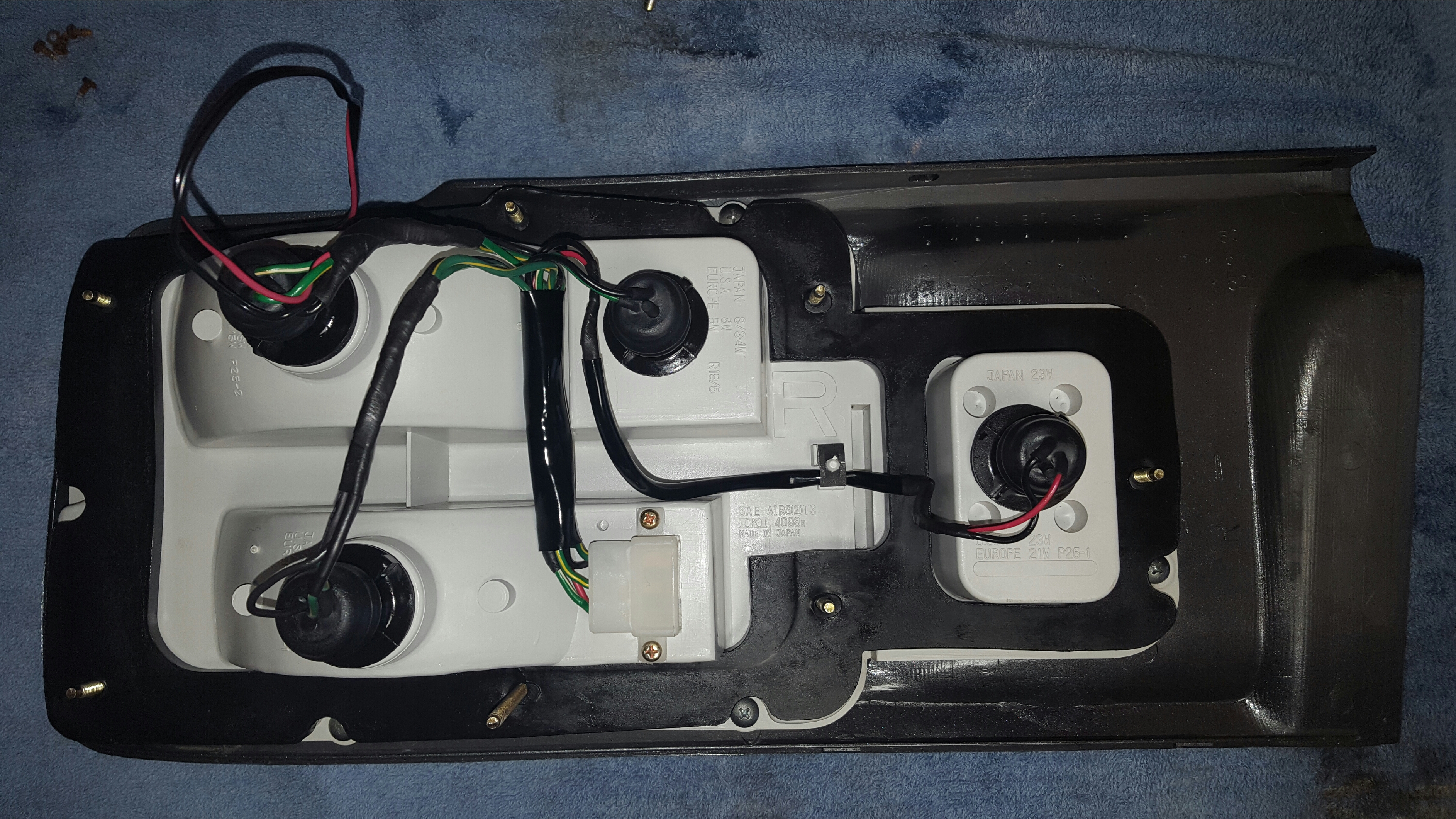

Finally got around to installing a set of JDM tail lights (thanks HR369) after freshening them up a bit.

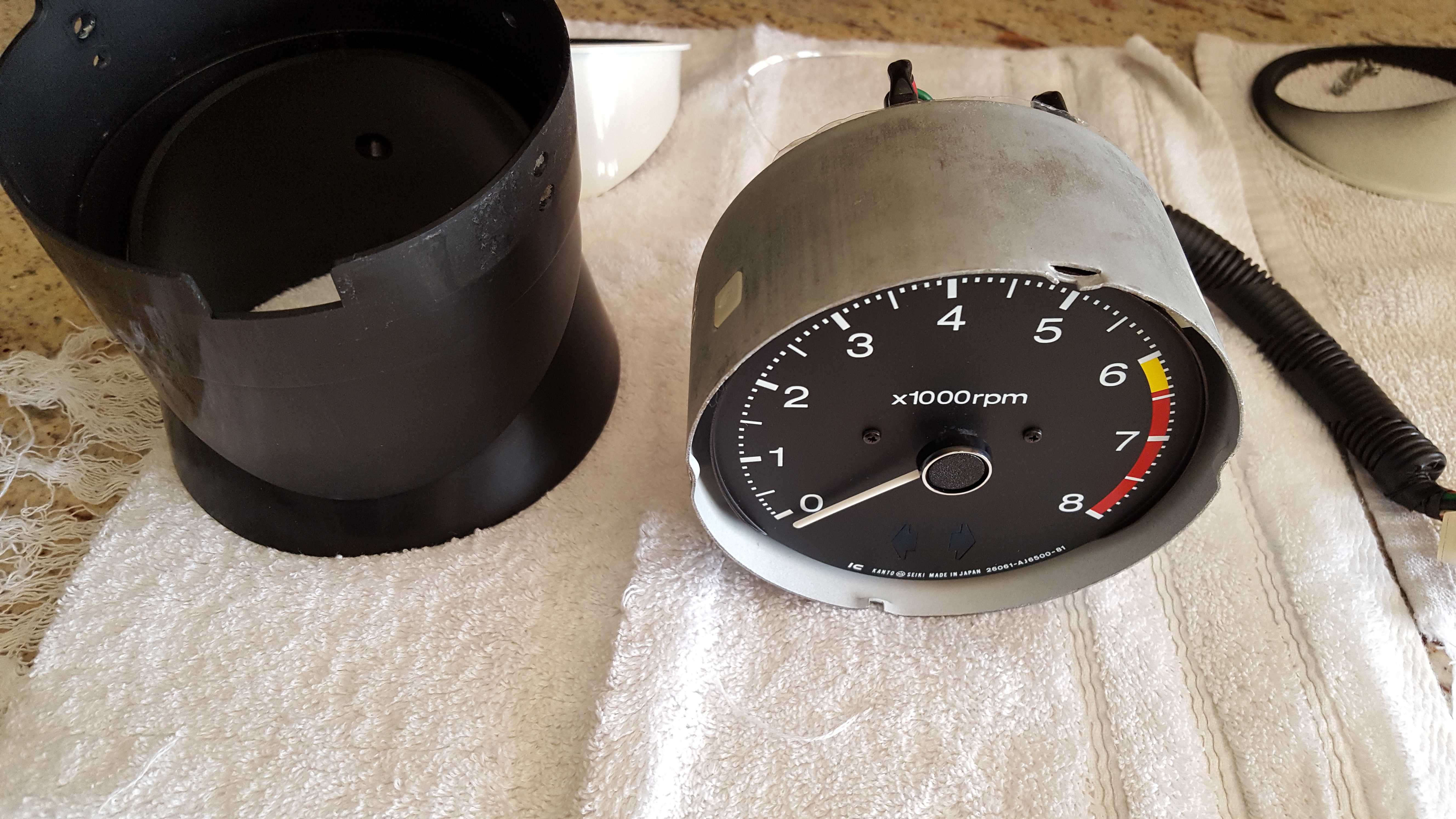

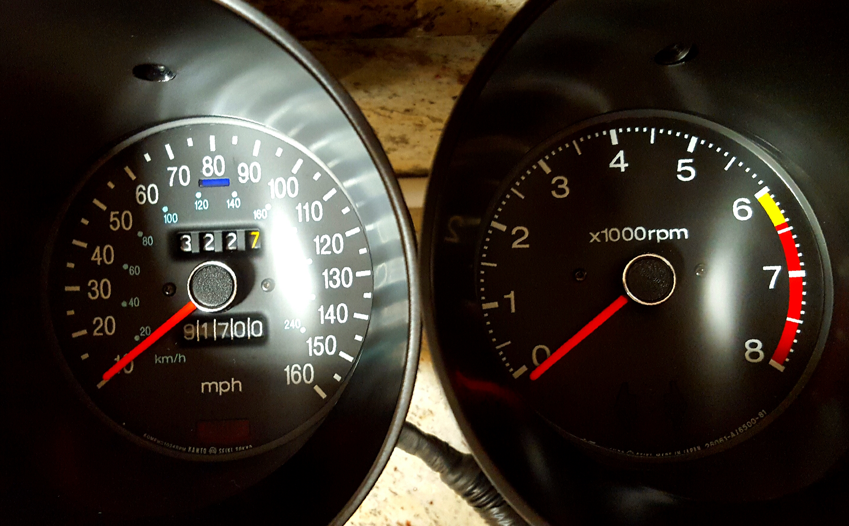

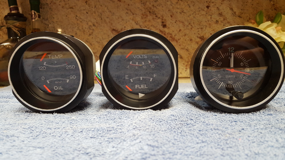

Also freshened up a calendar clock I obtained from Greg as well and put that in my instrument cluster with a few "details" done to match the instruments.
20160707_210651.jpg20160707_210255.jpg20160707_212133.jpg20160707_214304.jpg20160708_171341.jpg

5 hours ago, Mike said:
Nice work on the lights and the gauges!  I've never seen that charge LED before, what does it do?
Thanks!
That charge light is stock on the 77 and 78 Zs. Not sure about all 280s. Lights up to alert charging failure.

Good job. I might try clear coating the set on my car.
Thanks Greg. The current 2 part clears are much more resistant to the elements and UV radiation than the 40 year old plastic lenses so no matter how much you polish  them the end result will be much better and durable if you clear coat them. Go for it pal.
7 hours ago, sweatybetty said:
i wonder if the voltage gauge would fit where the amp gauge is in a 72? anyone seen that?
Yes, it would. You have to join the ends of the ammeter wires together, though. Otherwise your car won't run. Make it a good splice, too, so it doesn't overheat and catch fire in your dash.

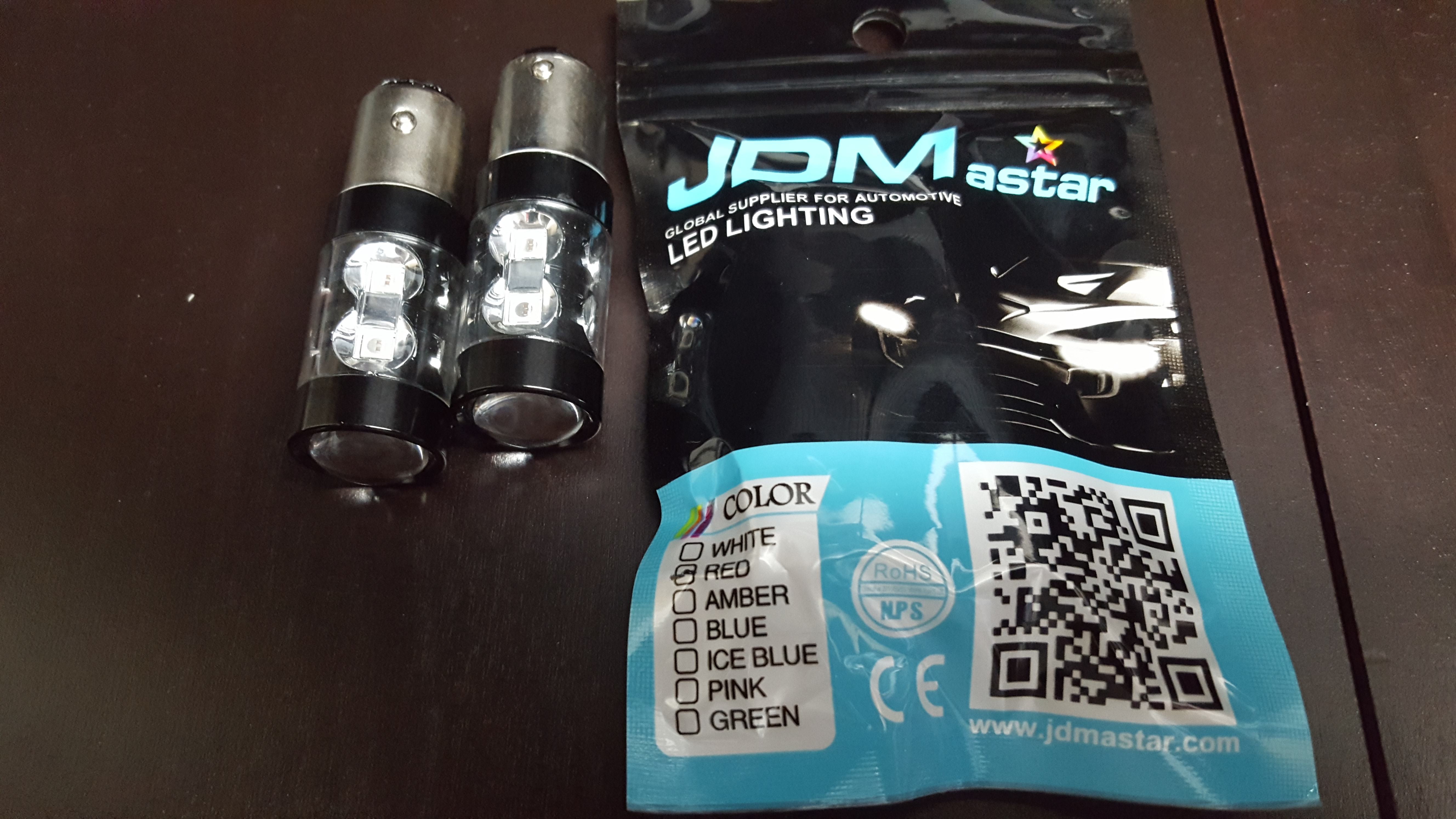

Got LED's in those lights?
