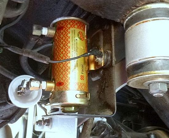

This is my pump. I love it. Makes noise like the others but when I am driving I can't even hear it.
The best part is it bolts directly to the factory pump bracket that came on my Z. I measure 3.5 psi right at the Carbs.
Brand and Specs:    FACET Fuel Pumps
Maximum fuel delivery 36 gallons per hour. Maximum pressure 4 to 5 psi. Typical flow 23 gallons per hour at 2 psi. 1/8 NPT female ports. Negative ground (12v) only. This pump is also sold under Kohler part number 247076. Military NSN number 2910-00-915-4818.
For the higher fuel volume requirements of larger engines (above about 150 horsepower), the high-performance Facet Cylindrical pumps can deliver. This pump is appropriate for engines in the range of 200-250 hp. Pumps can also be combined in series or parallel to achieve any required pressure or flow. Facet fuel pumps have low power requirements (about 1 amp at 12 volts) and operate without troublesome seals or diaphragms. Built-in pressure relief means no flooding after shutting down a hot engine.
This pump has no anti-siphon valve, so fuel can be drawn through when the pump is off. It also has no internal one-way valve, so fuel can flow backwards through the pump when off (draining back to the tank). An internal 74 micron filter is already installed. Facet pump number 476087 (E). This pump can also replace Facet pump number 476410 (E), 478360 (E), 480516 (E)*, and 480591 (E)*.
Note: The Facet "Interruptor" style pumps now feature reliable solid-state technology instead of points!
