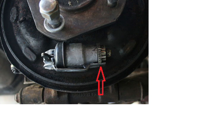

It's pretty simple.  Take the hubcap off and line up the hole in the drum with a slot on the wheel.  Insert a screwdriver and turn the wheel until your hand brake is tight when it's half way up.  I've done it, should be super simple for you.
i didnt know there is a hole in the drum. the only adjustments ive ever seen were through the back plate. this is my first import ;)
