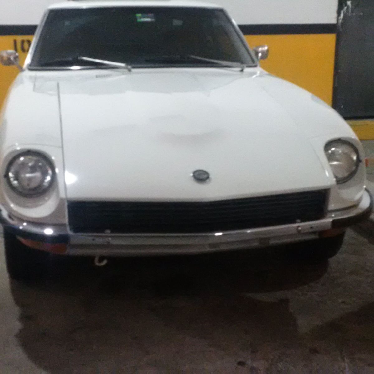

THe paint shop i hired to restore my car with 904 White PPG paint did a great job. However there are still some issues that were not solved such as:

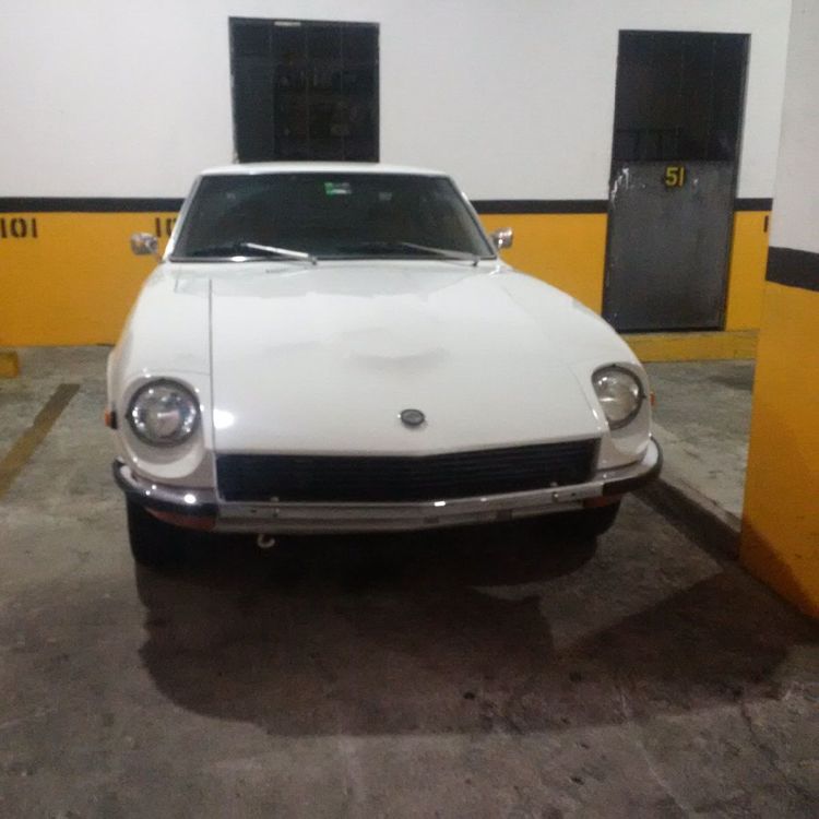

1. They cannot fit the front bumper guards in the new front bumper i bought! Really weird. I have attached pictures of the bumper without the guards. I bought this bumper on EBay and was shipped from Canada. Shop argues there is some slight difference between the original front bumper and this one and that there is not enough clearance between the bumper guards and the front Hood. if the Hood is opened it touches the bumper guards.

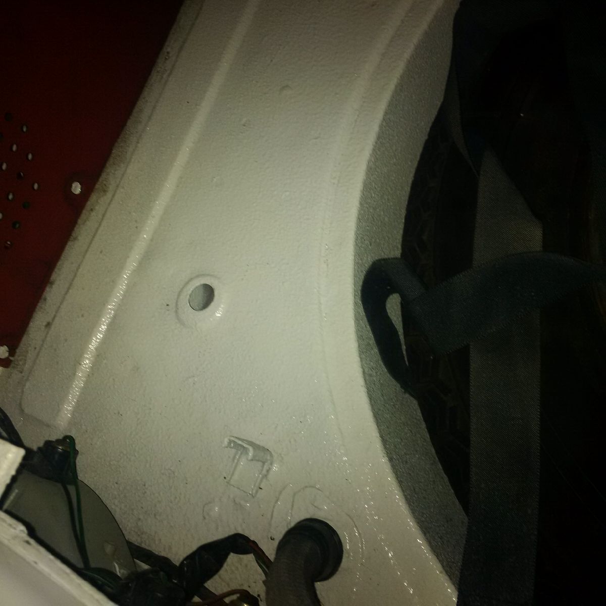

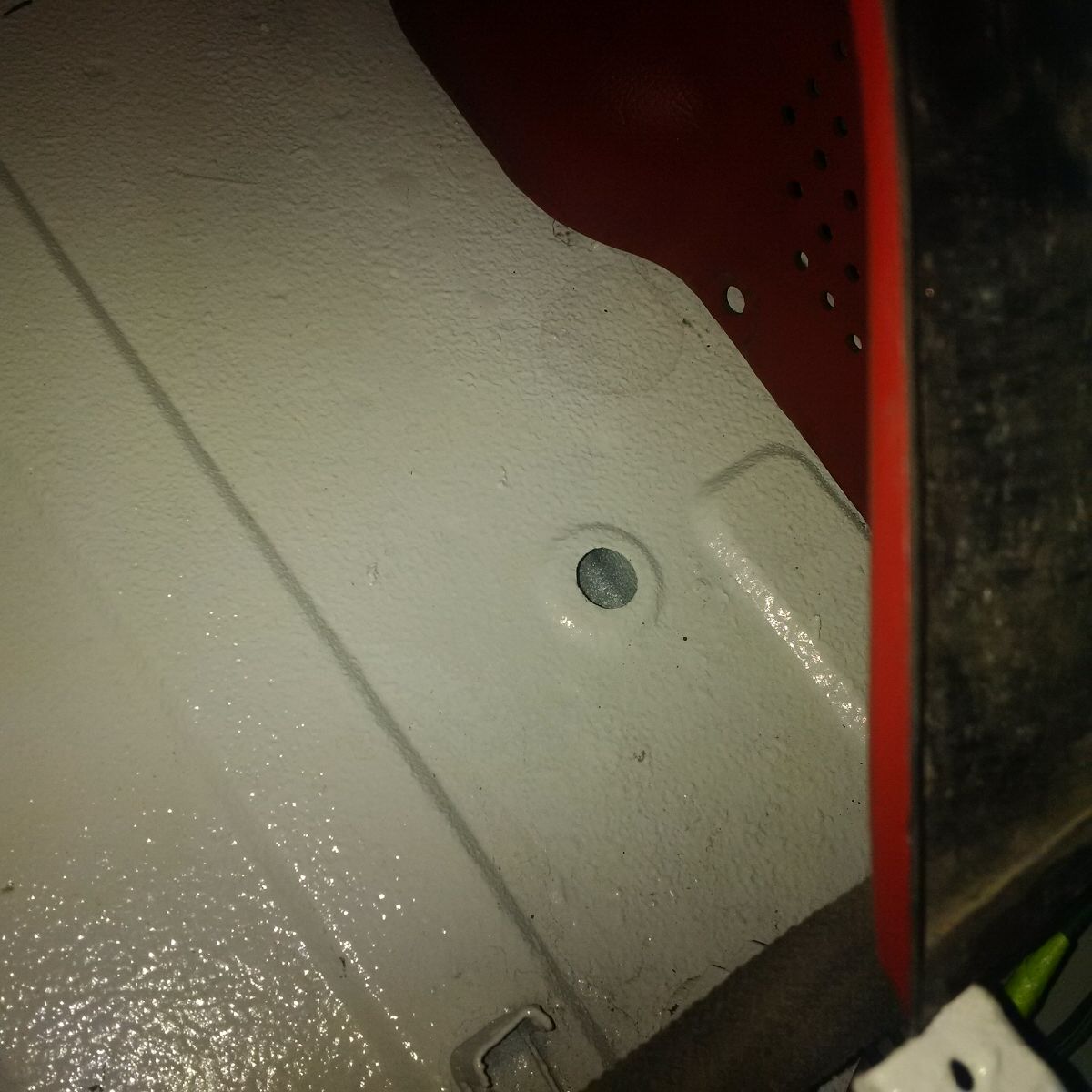

3. They argue that the inner hatch seal does not fit correctly around the hatch.

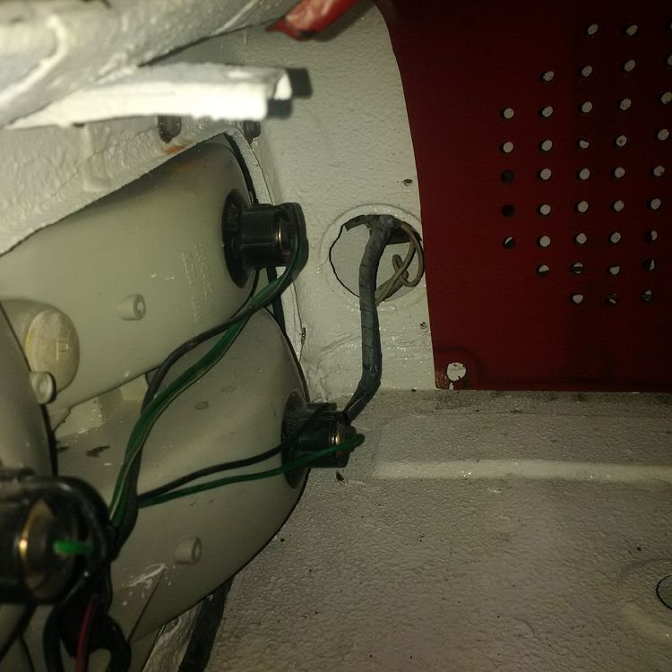

4. Some of the trunk plugs are missing.  where do i get them? What size are they?

In Europe those bumperguards never existed..  (In my opinion it looks much better without those stupid.....)  Also in Japan there were no guards! so why bother?
The holes were closed with a special little round rubber..

and those rubber plugs... measure the hole and get them in a auto store

Regarding filling the holes in the bumper where the vertical override pieces go. Go to a hardware store or marine store and pick up some SS carage bolts. Remove the square corners under the panhead and polish the panhead.....they look really good. Bettrer than rubber plugs IMO anyway.

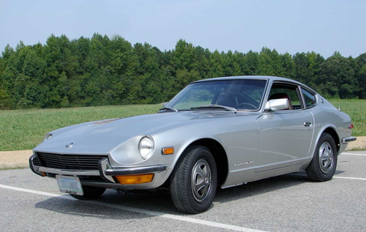

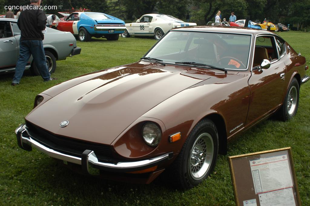

I think I know the answer to your front bumper issue.  Based on the location of the holes you have a '73 240z or '74 260z bumper.  In '73 and '74 the vertical guards were closer together and the bumper stuck out further from the car.  '70-'72 240z front bumpers had the vertical guards spread wider apart and the bumper was closer to the car.  Check out the pictures below, '73 on top, '72 on bottom.
