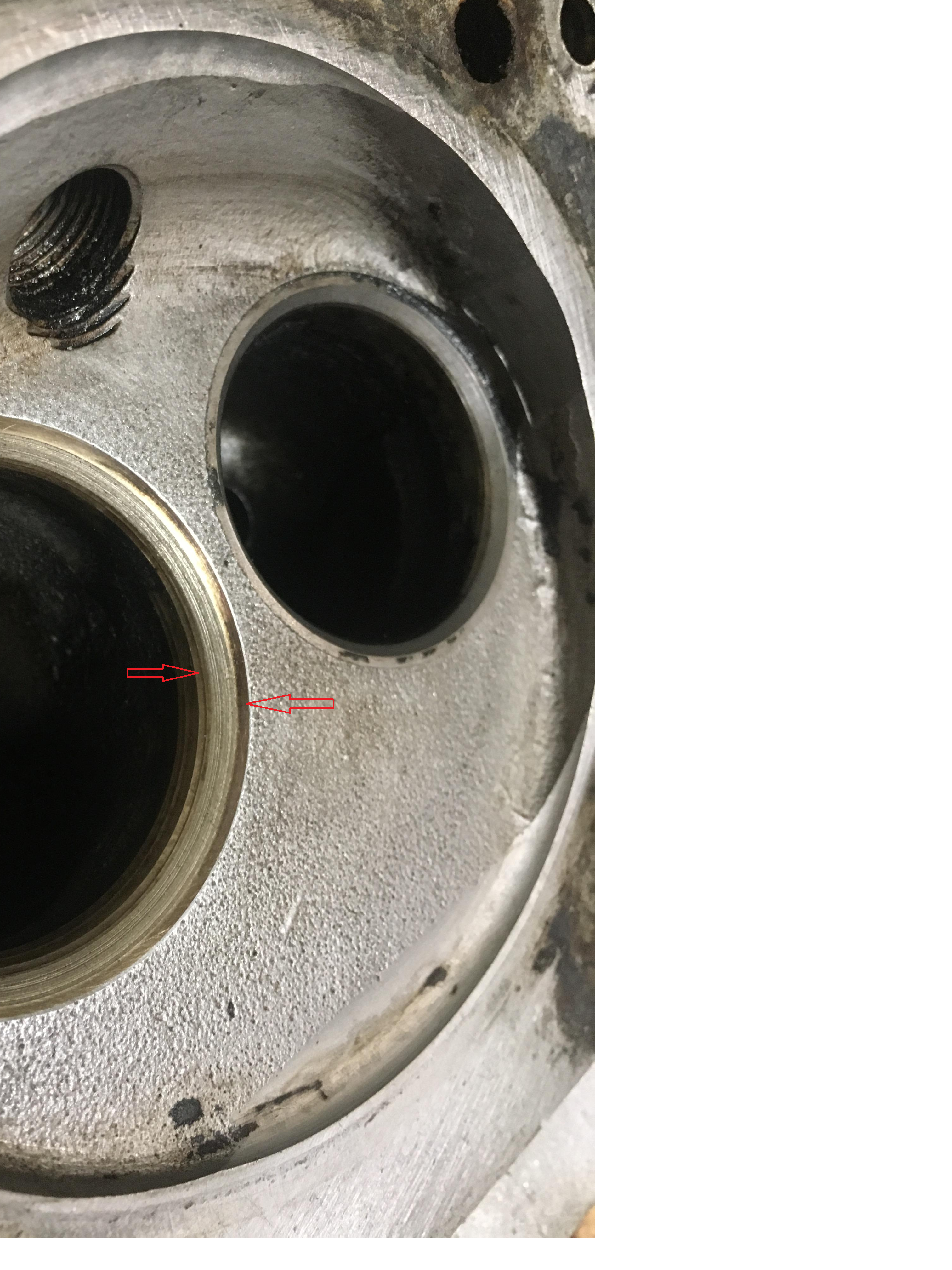

I got out the calipers and measured the stem diameter. They seem like they are within the upperbound (not super worn out) for what is allowed per the service manual.
There was very little runout throughout the multiple measurements that i took along the length of the stem, because of this i would believe that the tapering within the guide would also be at a minimum. However guessing is bad, and ill need to locate a tiny bore measuring tool...  this is getting kinda fun :P
Your valve seats should "mate" to the valves, like staking ice cream cones.
Comparing your intake seats to the exhaust seats you can see the "steps" in the soft bronze the valves have caused over the years, it's a lot softer than steel.  I don't think you'll get them out hand lapping them.  If you could take the head and a valve to a machinist and let them at least look they might could face them $50?  You've already taken everything off.
I took them to my local shop, he was asking $375 for getting new seats,  replacing seats, and cutting them. He was saying that the exhaust valve seat is going to get distorted when the new ones are placed in, so they also need to be cut :mellow:

My machinist cut out the bronze intakes and pressed in the new steel seats then faced them to match the valves that I carried him.  I'm almost positive he charged me $70 or $75 and I gave him $100, he always says he hasn't worked on an L head in 20 years but that he had done as many of them as anything back in their day.  Onery acting older guy but really just playing around.  He has a lot of money making stuff to do and works on mine when he has extra time.
I don't understand how it could distort the exhaust seats, that's news to me.  I know there is a way to heat the head up in an old oven and they'll pop out but that's not something a machine shop would do, that's something my my tight wad Dad would try. LOL

I think that just replacing a few valve seats can distort the others because the seats are cut to fit the valves after they're all installed.  The seats are an interference fit so they distort the aluminum around them.  One thing leads to another...
