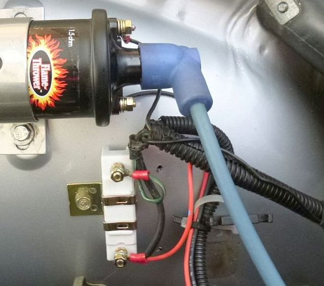

Just did a Pertronix ignition swap on a 72 automatic trans. It had the dual points dizzy but I swapped out with a single point before doing ignition swap. Engine runs fantastic, but I've lost the tach somewhere in this . The auto has additional wires that might be part of my issue. I did away with the ballast and tied those wires together . They seem to have no bearing on whether the engine runs or the tach works- which kind of confused me. The autos also had this relay set up for the secondary points, not sure if they are tied in somehow to the tach . Any insight would be appreciated

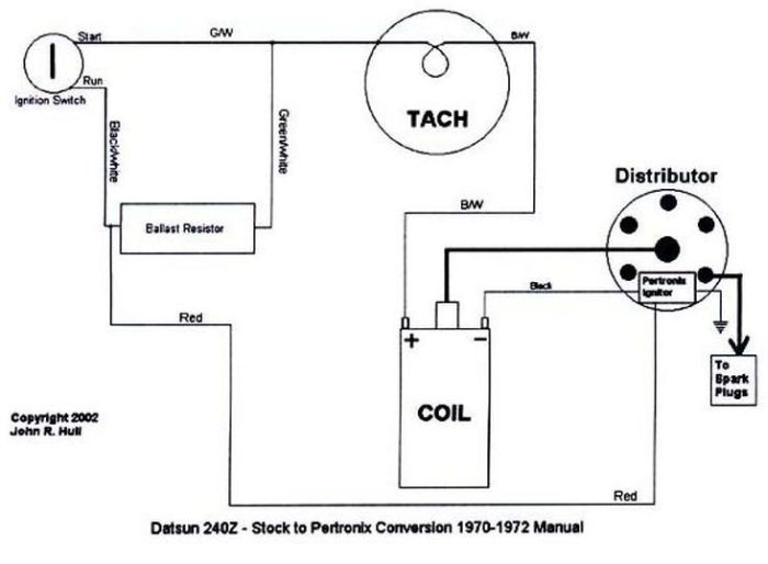

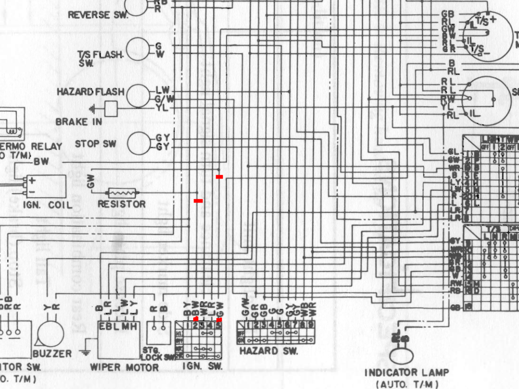

The diagram shows a G/W and a B/W.  But, either way, that kind of shows that current flow has an effect.  If you had them switched from correct then you would have had more current than design, since the resistor is not used for Starting.  You probably had Start switched with Run.  Too much current kept your tach from working.  Maybe.
