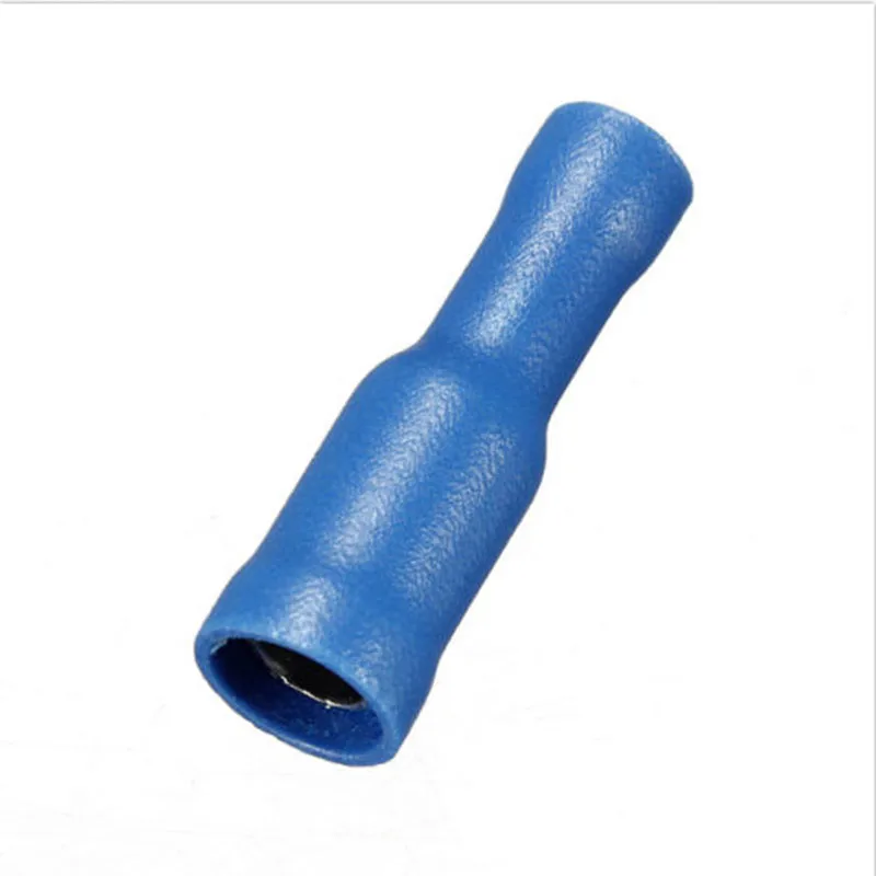

Has something like this on there now
2016Hot-Sale-New-100pcs-Male-Female-Insu
