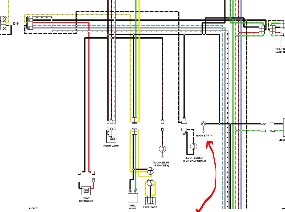

Good that you have a solution path now.  I actually might be trusting that diagram too much, it shows a connection along the way, but who knows.  It could be two separate wires to a ground point.  Knowing a little about how cars are designed to be manufactured, the end of the wire might actually be back at the starting point.  But the big diagram shows all of the things in the back half of the car ending at the same ground point.  They're all behind the C-8 connector though, and C-8 is the one by the passenger seat, I believe.  Maybe under the passenger seat?  I'll go take a look in my 90 degree garage.  Where the car sits when it's over 90 outside.

Too cramped.  I would look in a spot that could get wet.  That would be why the corrosion started.  There's a relay under the passenger seat, bolted to the seat mount rail.  That would be a good spot for it, since Nissan thought it would be a dry spot.  But it fills with water if there's a leak..
A final thought - I might be assuming that the central ground point is like the EFI harness, which does have several grounds ganged in to one point.  But it might be that there are many grounds dispersed around the harness in the back.
Somebody just posted recently about a ground point buried back there for the fuel tank sending unit.  They shined it up and reinstalled it.  So there are probably several points.  The diagram just combines them for ease of drawing.  Good hunting.  Note that the wires will be black.
